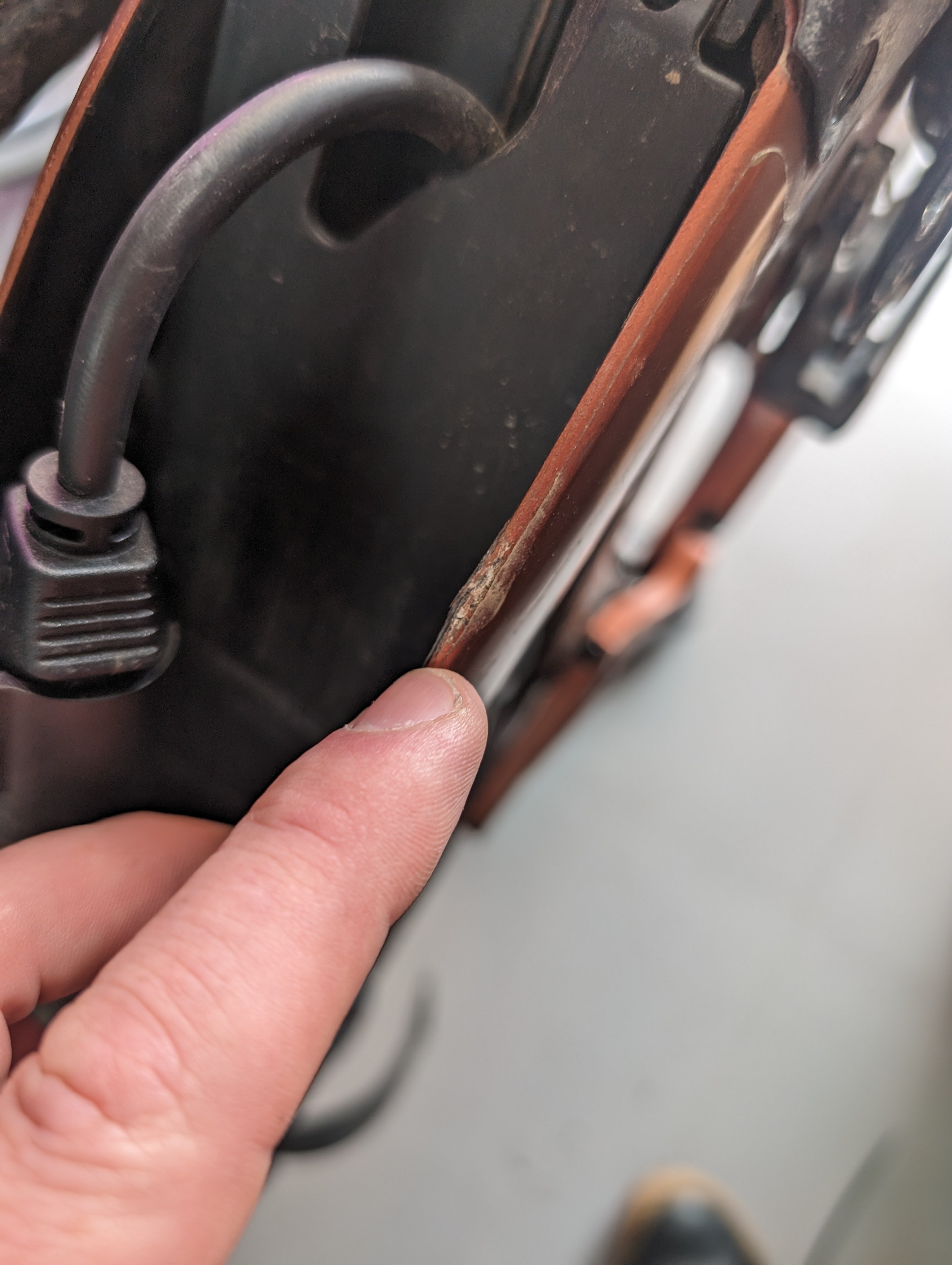

Just removed the battery cover on my fuel exe 9.7 and it looks like there may be some damage to the frame. The carbon is super thin behind the plastic cover and it looks like it's taken a direct hit on the edge of the carbon.
Wondering if anyone else has had a similar problem as downtube protection around this area seems minimal?

Yes, my wife's bike had a hit like that in the early days and a cut in the cover. Nothing has developed further.
Thanks good to know. I'll keep an eye on it and maybe use a little araldite to stop it getting worse.
It does seem a very exposed area, should it take a direct hit.
Unfortunately, the only part of the bike where the invisi tape doesn't cover and it's been caught 😕

Years ago in Moab I cased a rock step-down and cracked a Chinese DH carbon rim clear through. Being carbon, the wheel was relatively true. I removed the tire and rim tap and dumped superglue all the way around the crack. Rode the rim for another 6 weeks (until the warranty rim arrived) and had no issues.
I’d keep an eye on that but looks purely cosmetic.
