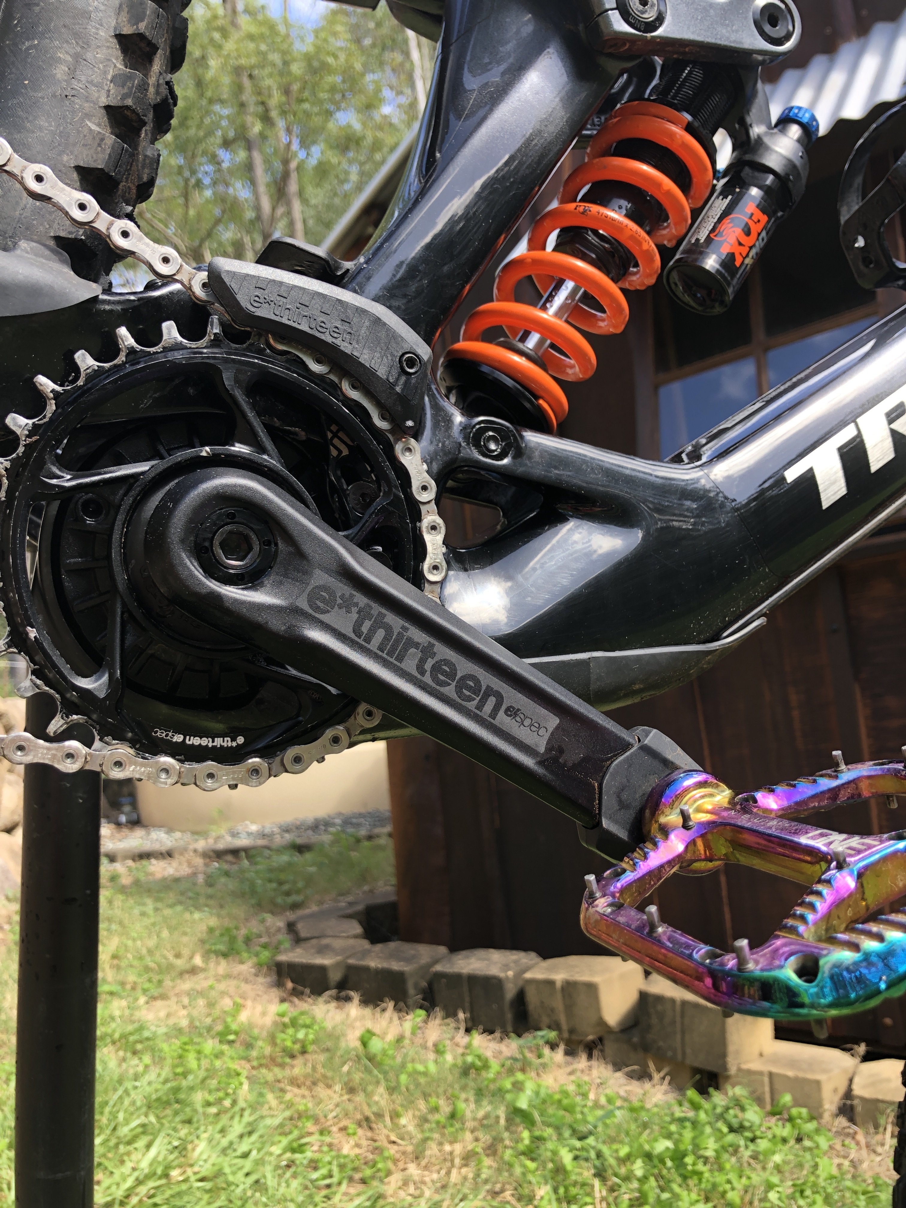

Put on a set of E13 155mm cranks a while back (the ~$90 version). Hip preservation mitigation primarily. Easy to spin up and makes you shift a bit more frequently but rock strikes are way down and you can get a bit more drop on the seatpost if needed. Like them so far.
I too got the same ones and have ridden them for around 10 hours. I was surprised how good they felt. Like you said, better on body mechanics - especially on my knees (I am only 5'10). Climbing is easier, especially when you need to get power down, jumping is also better - more pop (even with me running a coil).

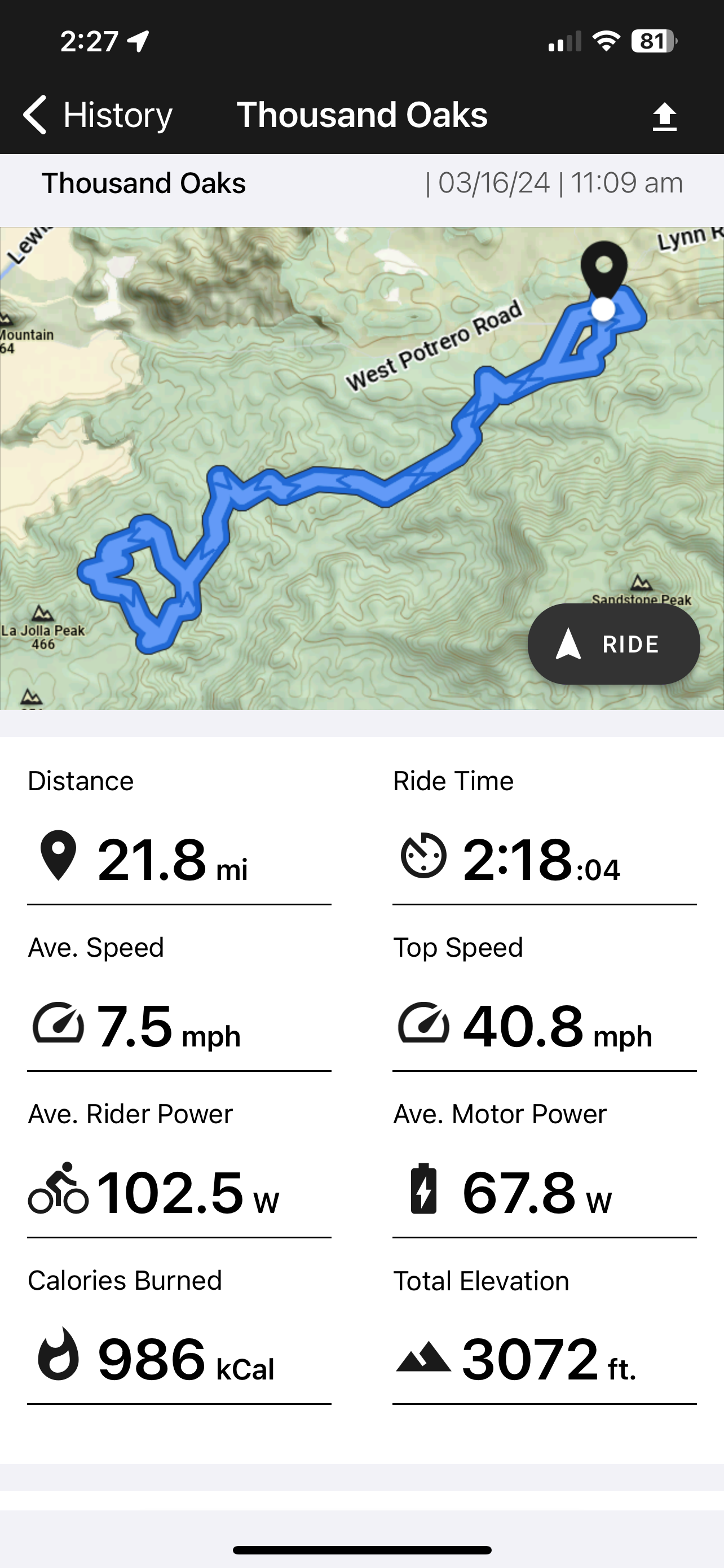

I got pretty decent range today. I had 12% battery left, when I got back home. I wish the app could tell us how much time we spend in which power mode. But, I’m going to guess 70% in low, 20% in medium and 10% in high mode. I ran into a couple with EXes. So, that was nice to see. I’m still recovering from 5 broken ribs. So, my average speed is a like slow. I’m usually around 10.1 mph. It’s getting better with every ride though.
