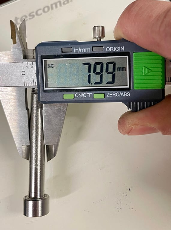

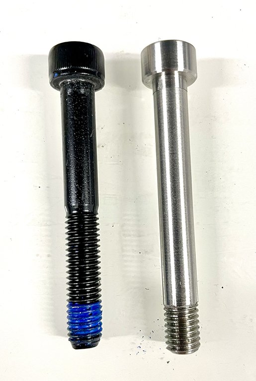

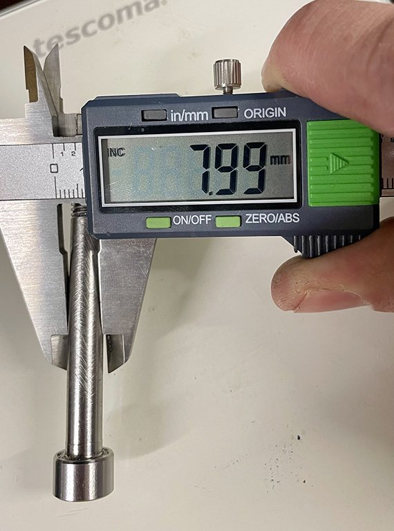

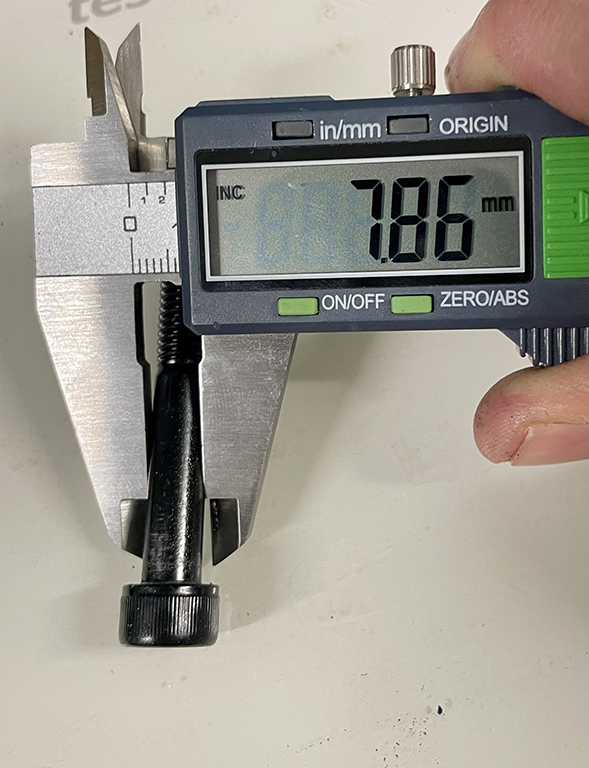

There was written a lot about shock mount knocking. This is why low shock mount starts to knock after a while. Original shock bolt is only 7,86mm diamenter, while every shock bushing is 8,0 mm inner diameter (does not matter if its RS, Fox, Ohlins....). So there is 0,14mm gap. To solve this prob just with higher tightening torque of this original bold will cause frame damage finally.
My solution was to ask local garage for custom precise 7,99mm bolt. Fits well, no gap, no micromovement, no too high bolt torque, no knocking.

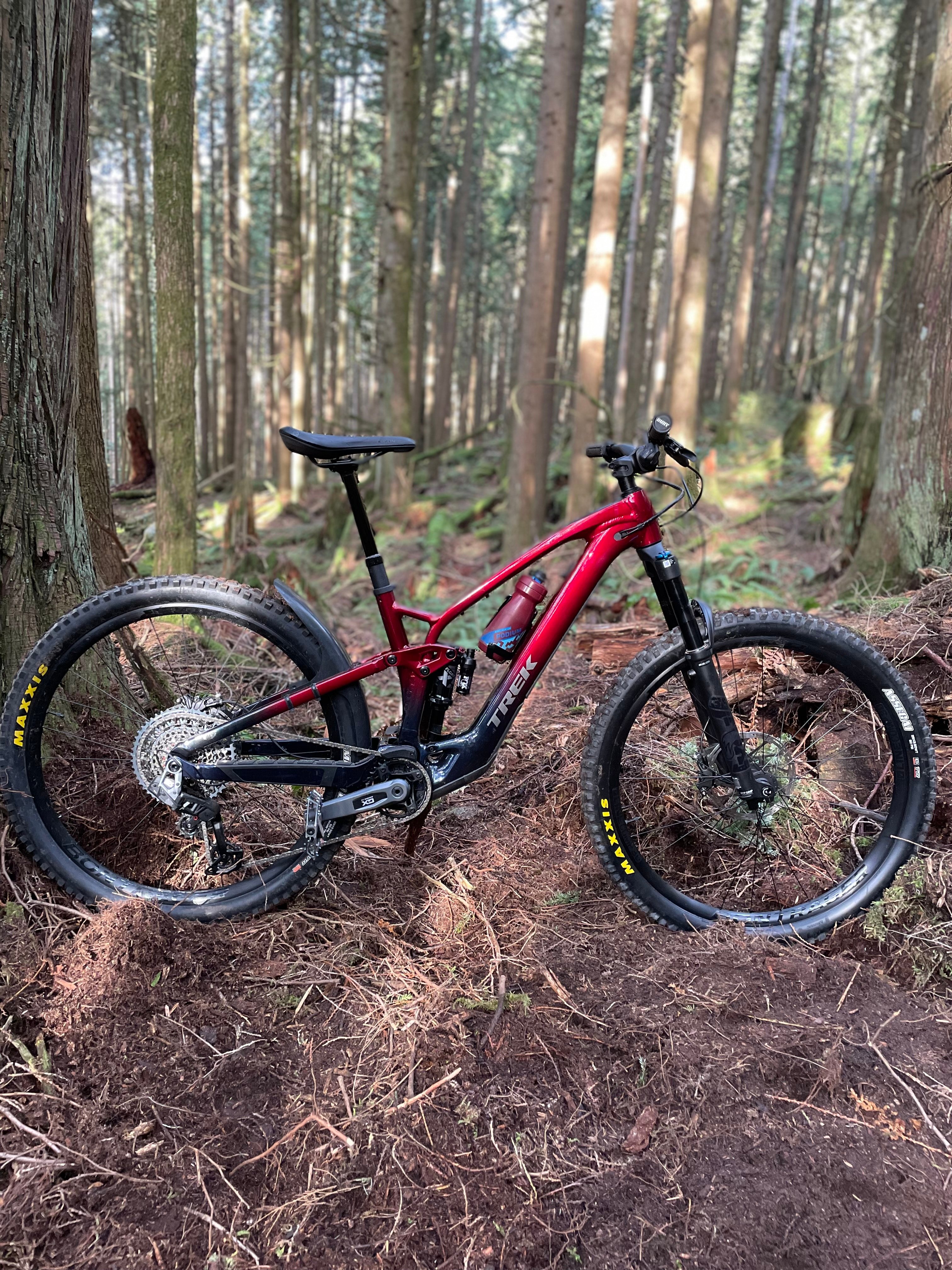

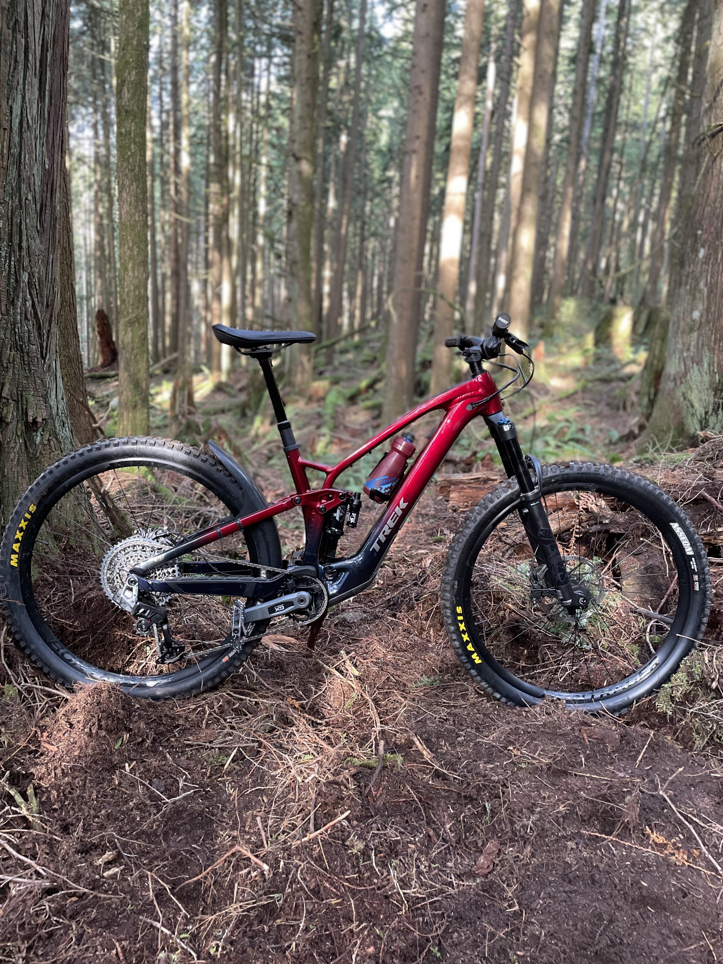

Finally pulled the trigger on this bike a few weeks ago. The Powerfly HT in my stable had to go. My kid used it as much as I did so I could strip the good stuff off and he’d still have a great bike for his needs.

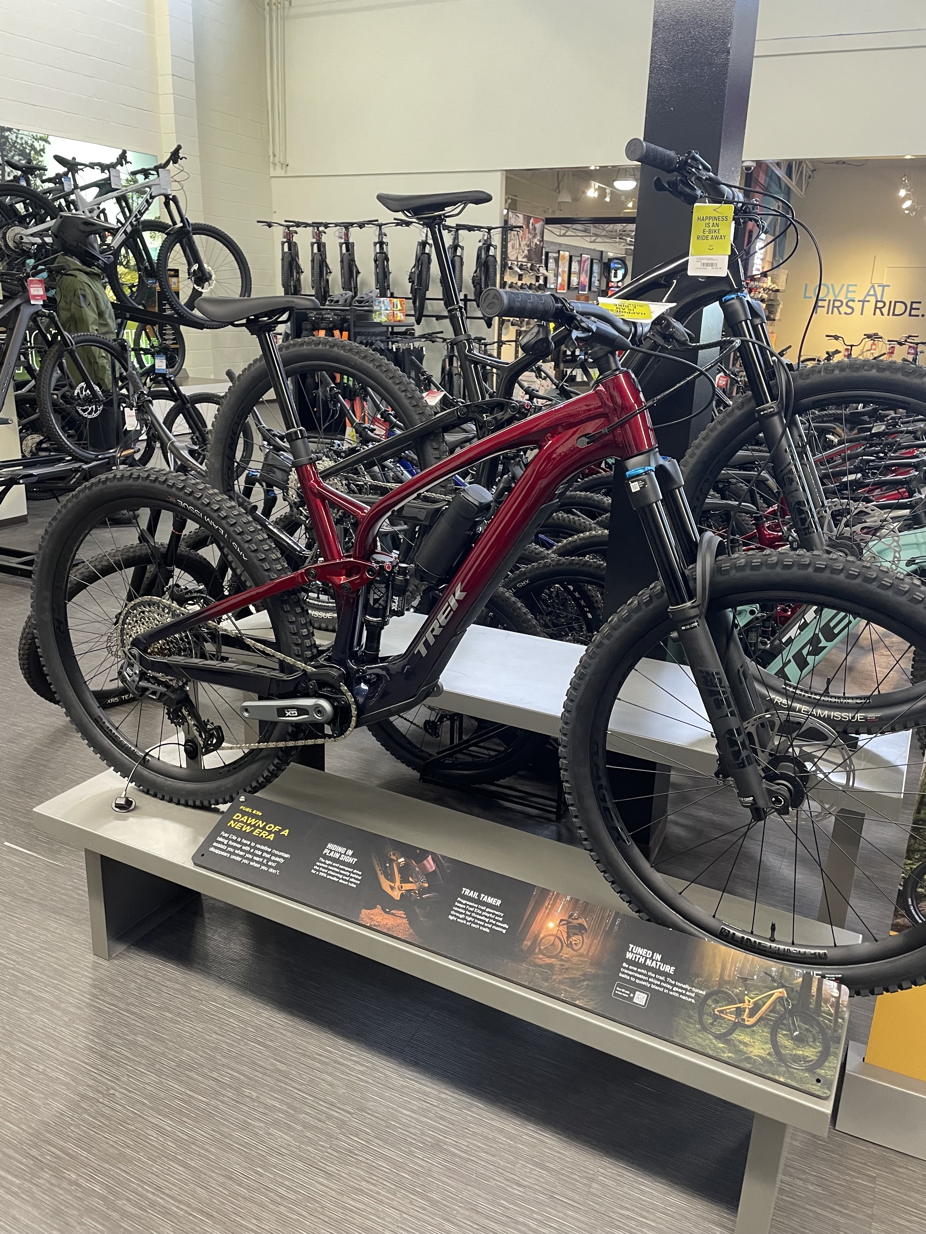

I lured the wife into the Trek dealer and eventually wandered over the Fuel EXE display. I stopped and stared at them for several minutes.
“Why don’t you buy it?” She said. I played the “It’s too expensive” card. We left. IMG_7293.jpeg
Alloy and Carbon models displayed here.
In the car she suggested that the Powerfly HT would be great for our son. My evil plan was working 🤞.
The next day I ordered a medium Fuel EXE 8, 2024, T-type transmission, 170mm dropper, etc…I’d add my upgrades to it. (Seat, carbon bar, magnetic peddles, Maxxis tires, Oury grips, and Ride Wrap.
When I received the bike a few days later, during the Ride Wrap installation process, I noticed that something was wrong. When retightening the rear axle to 10nm, things didn’t move freely. Back to the LBS. Four of us carefully watched the movement and assembly of the T-type transmission.
It was a young sales guy that noticed the threaded bushing for the axle was installed backwards. Problem solved. All the shop mechanics watched the YouTube setup procedure for this T-type derailer/transmision and I was on my way.
Since then I’ve ridden this bike almost every day. I can’t believe the smooth shifting and I’m getting use to the Sram brakes. I also realize how out-of-shape I was/am.
I haven’t seen another Fuel EXE in the wild…or maybe I never noticed. But the Down-Hill-Gravity assist level is amazing.
I can’t stop looking at it.…or using it. 🤩

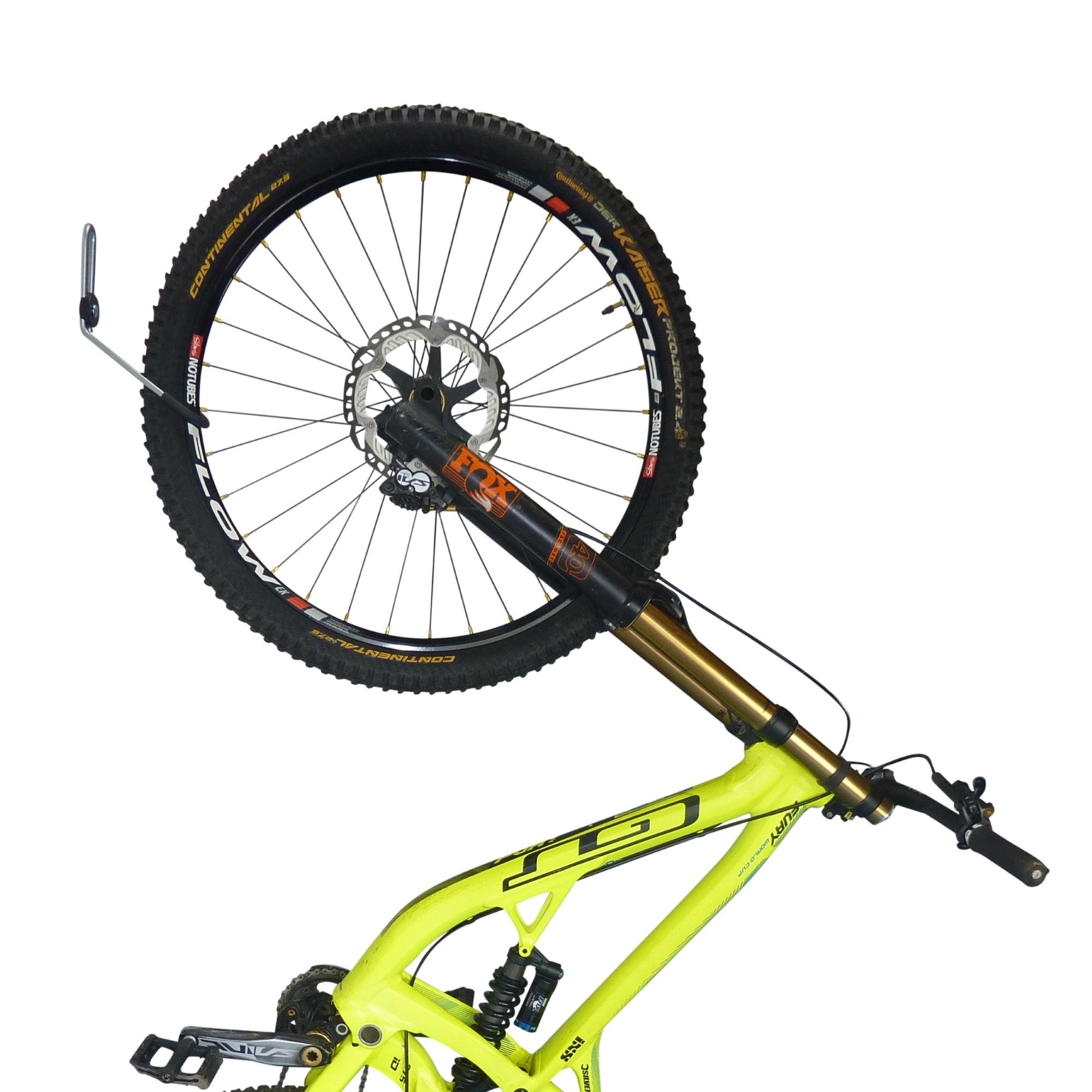

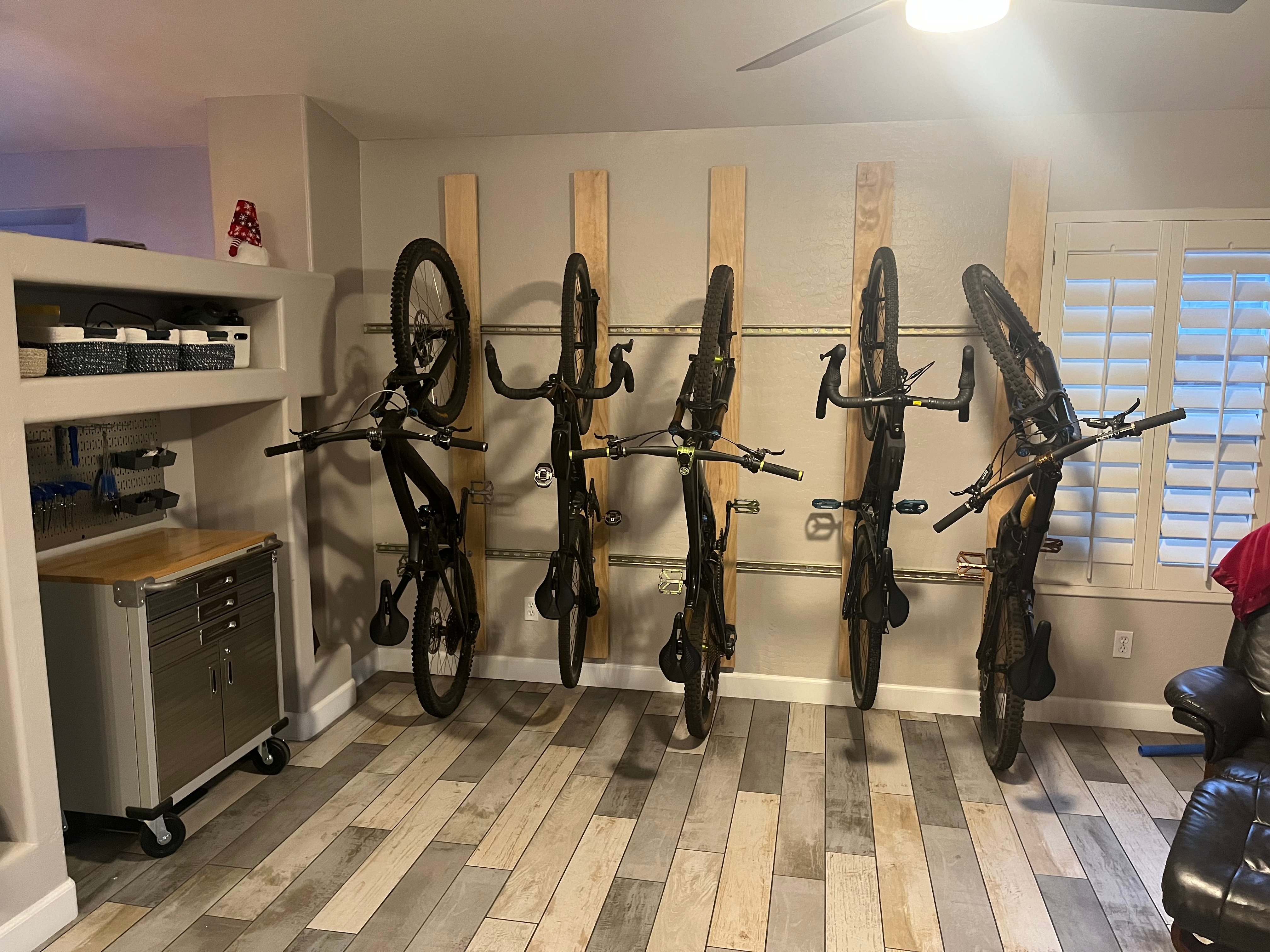

Anyone have a bike rack that hangs their fuel exe vertically? Is that ok to do that? The garage is accumulating some bikes and we are thinking getting a rack for better storage, any recommendations is appreciated.
I hang mine on one of these. You can wheel it up on its back wheel so you don't have to lift it.
“Why don’t you buy it?” She said. I played the “It’s too expensive” card. We left. View attachment 134183
I hang mine, but all the weight is supported on the back wheel on my MTB’s. My gravel bikes just hang.
