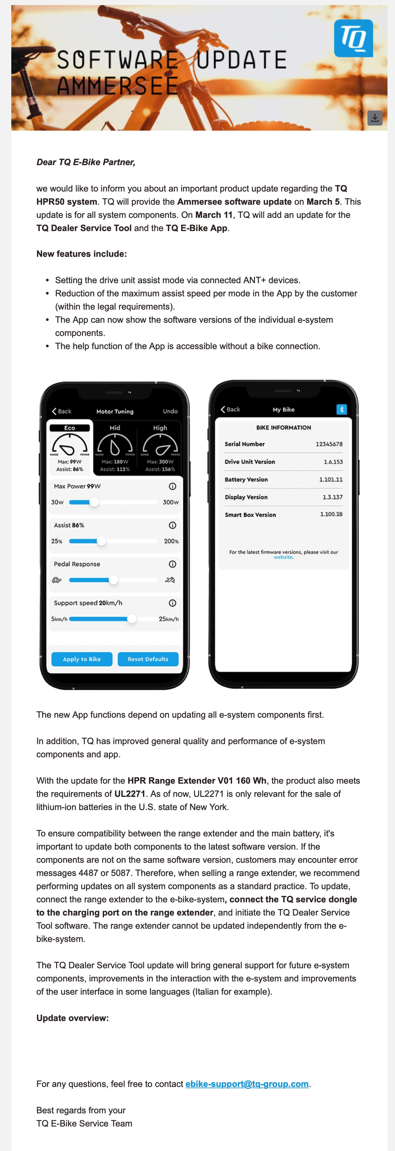

Looks like a round of TQ updates are on the way.
Curious what "Reduction of the maximum assist speed per mode in the App by the customer (within the legal requirements)." will mean in real life.
Also curious if the trek app will be ready for the updates when they are available.

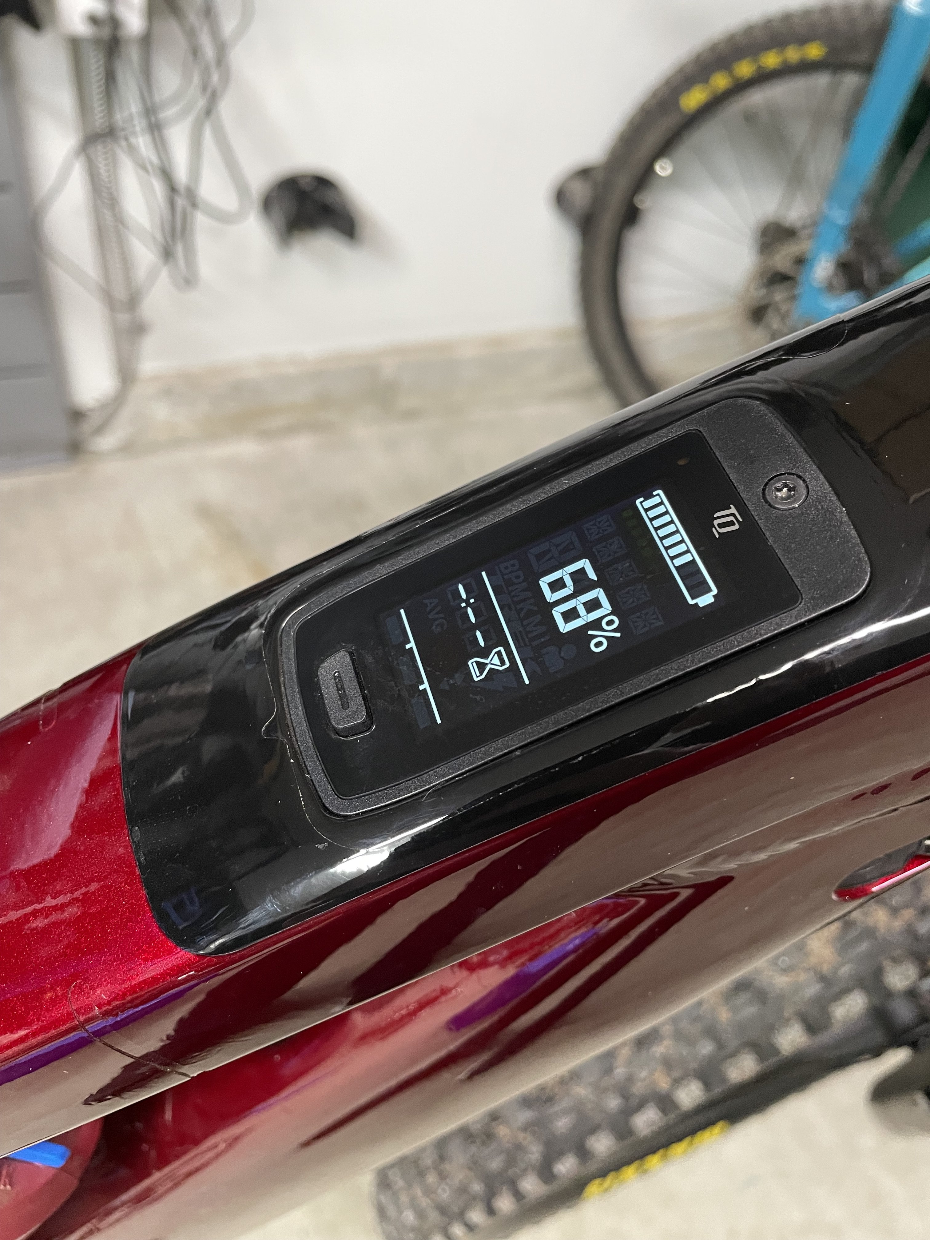

Hi
Just picked up a fuel exe 9.9. It’s not brand new - was a demo bike and has 400 miles on the clock.
One thing that’s irritating is the tq display on the top tube doesn’t sit quite flush. The top end nearest the headset is flush as it is screwed to the frame, but the lower end has a slight gap between the display module and the top of the frame. I’ve fettled the wiring below to create more space and it is sitting slightly better, but now i’m aware of it, it’s just not a great seal and i’m in the UK so it’s only going to let moisture in.
Is this a known issue?
Sorry not checked the entire thread as it’s quite long 😜😁

Hi
My display does not have a gap and sits flush. I did crack the LCD screen due to the location. It was my fault. I’d prefer to have no display, just an on button. I use a Garmin Edge 830 for all my information as it reads all my AXS shifting. I really like seeing which gear I am in. It provides much more info too. The LCD is easily replaced if something happens. I think the next step in the evolution of displays will be to partner with companies like Garmin or Strava to provide maps and other data. I guess we will see.
My display doesn’t have a gap either …but I have the alloy frame.
You can see that I applied Invisa-Frame also.
I wonder if during the layup process there was a slight movement which caused an imperfection in the LED opening? I assume that alloy frames are stamp-cut …maybe?
Carefully inspect the inside ridge, maybe a slight sanding in that area could be necessary. I wouldn’t want water ingress at that point.

Where I live, it is so wet so much of the year, I put invisiframe over the entire display. I worry less about water than the mud and scratching up the display. The bubble around the button goes away after several days.
Same here, also electrical tape over the seams between display & top tube (invisible on a black bike)
PNW Wet riding and weekly hose-offs all last winter, no issues....

Thanks, those replies are helpful. The gap in mine is much more pronounced so at least I know for sure it’s not right. Cheers again
