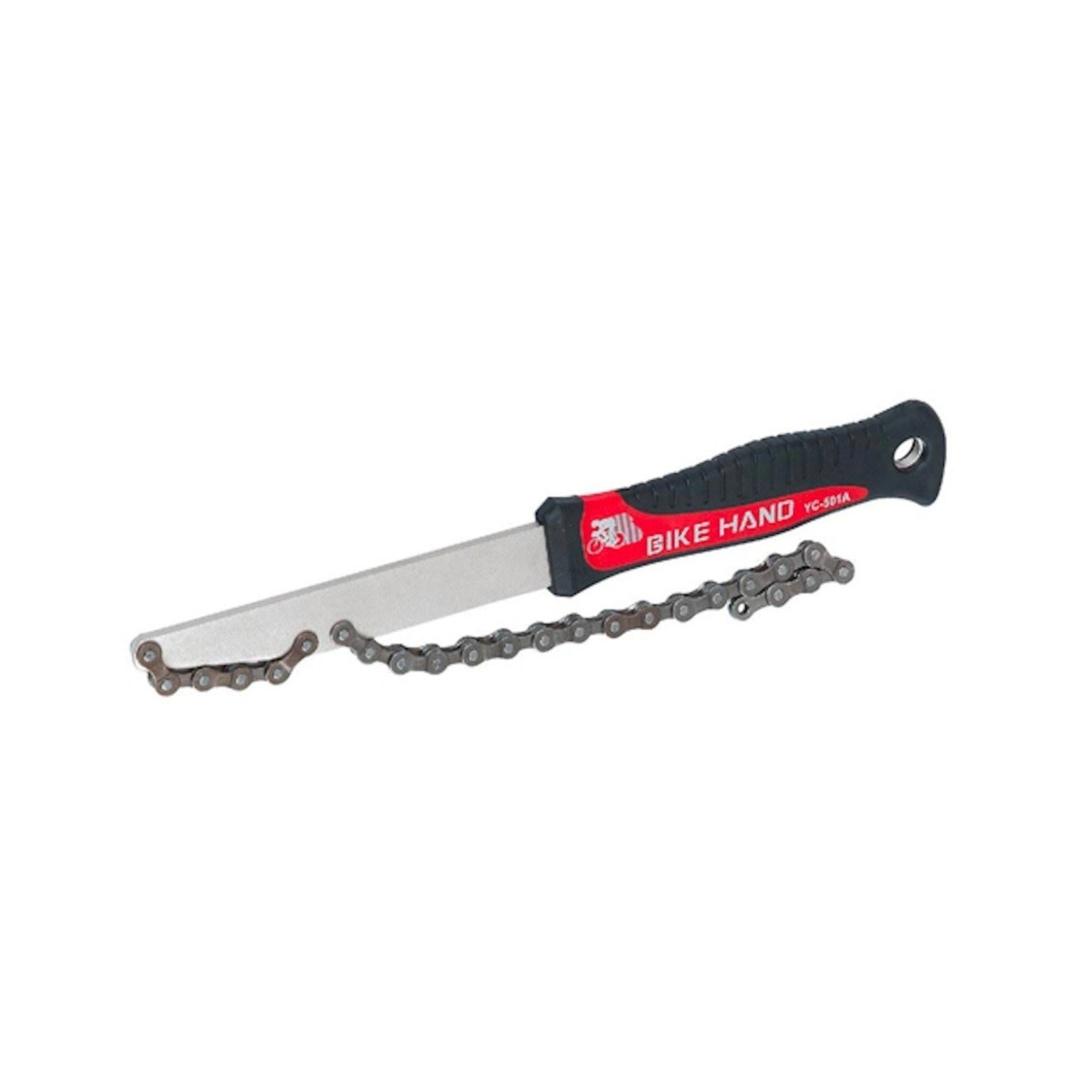

Folks, when you remove the front chainring spider lockring, how do you lock the spider in place to keep it from spinning? I feel bad having to tension the chain and wheel so much for this...
Cassette removal tool is easy to hold the chainring.

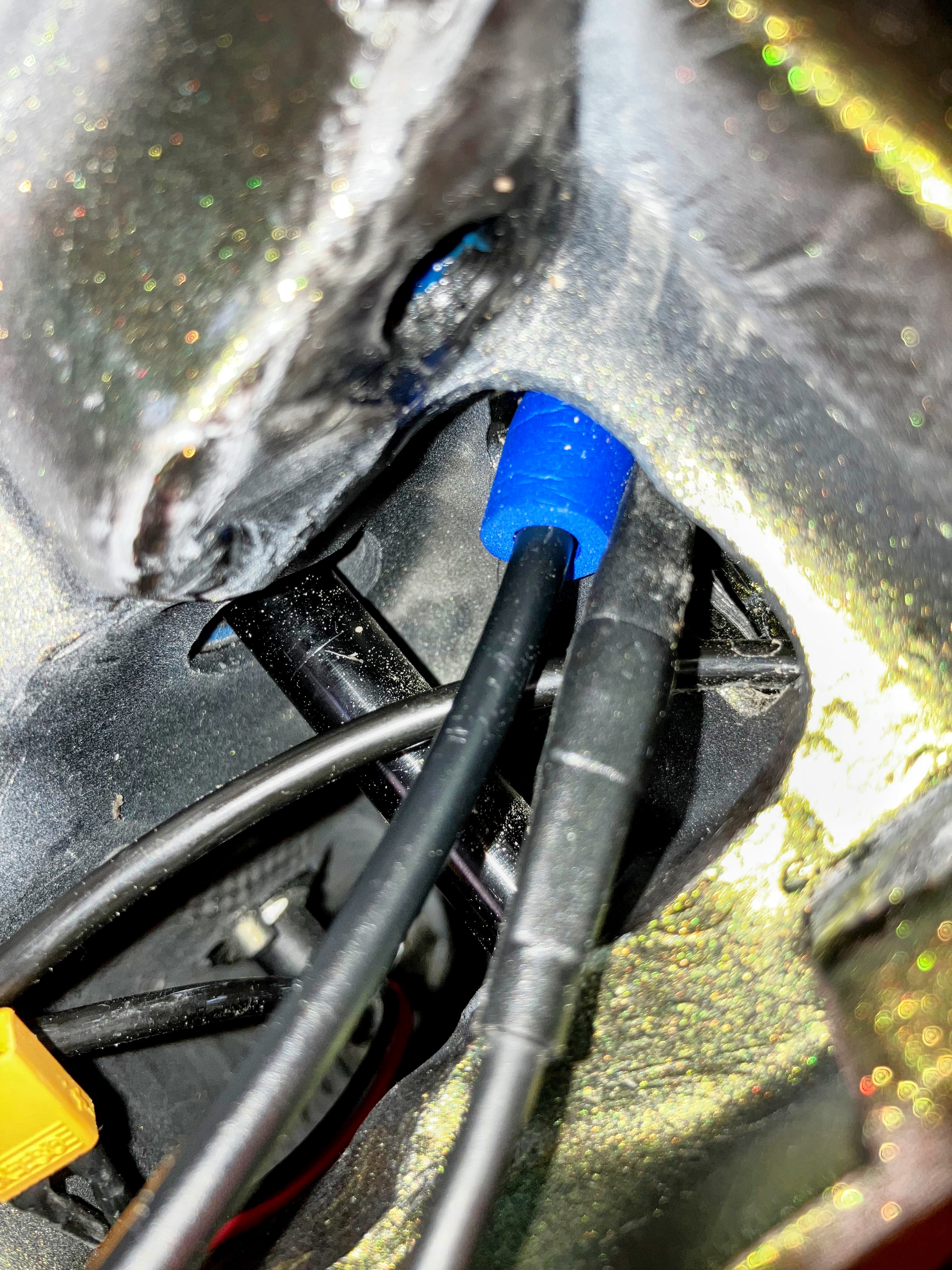

For those of you with diy batteries. What do you do about the battery canbus? Originally I was sent the wrong cable and there was nothing to plug my battery canbus into. This made my bike go to a deep sleep after about an hour. I had to plug it into the charger to wake it up. Do those of you with diy batteries suffer from this too then?
I was afraid of something like this, but haven’t had any issues. Only thing missing is the battery information, charge cycles etc. Battery percentage can be seen on the display, but that is probably straight from voltage.

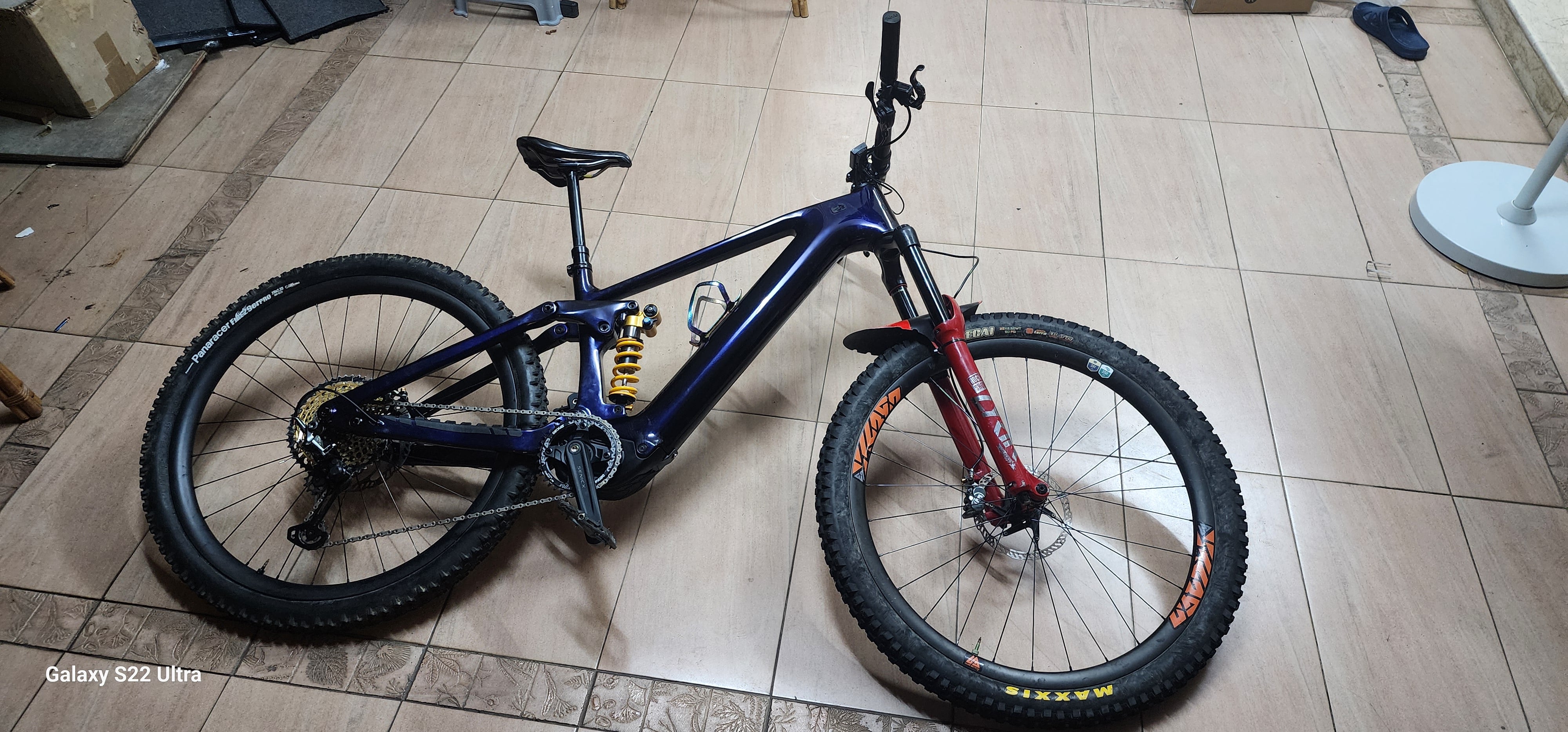

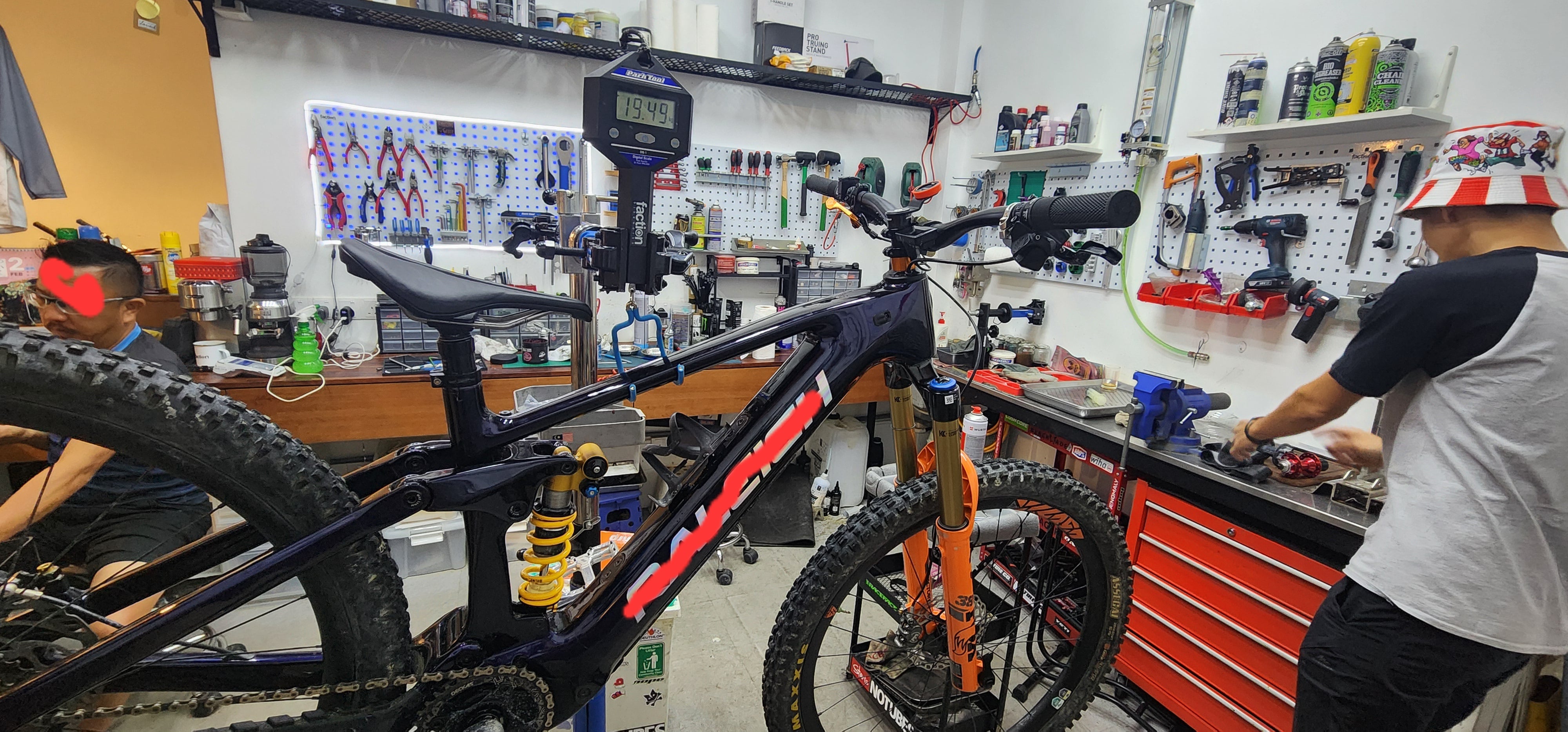

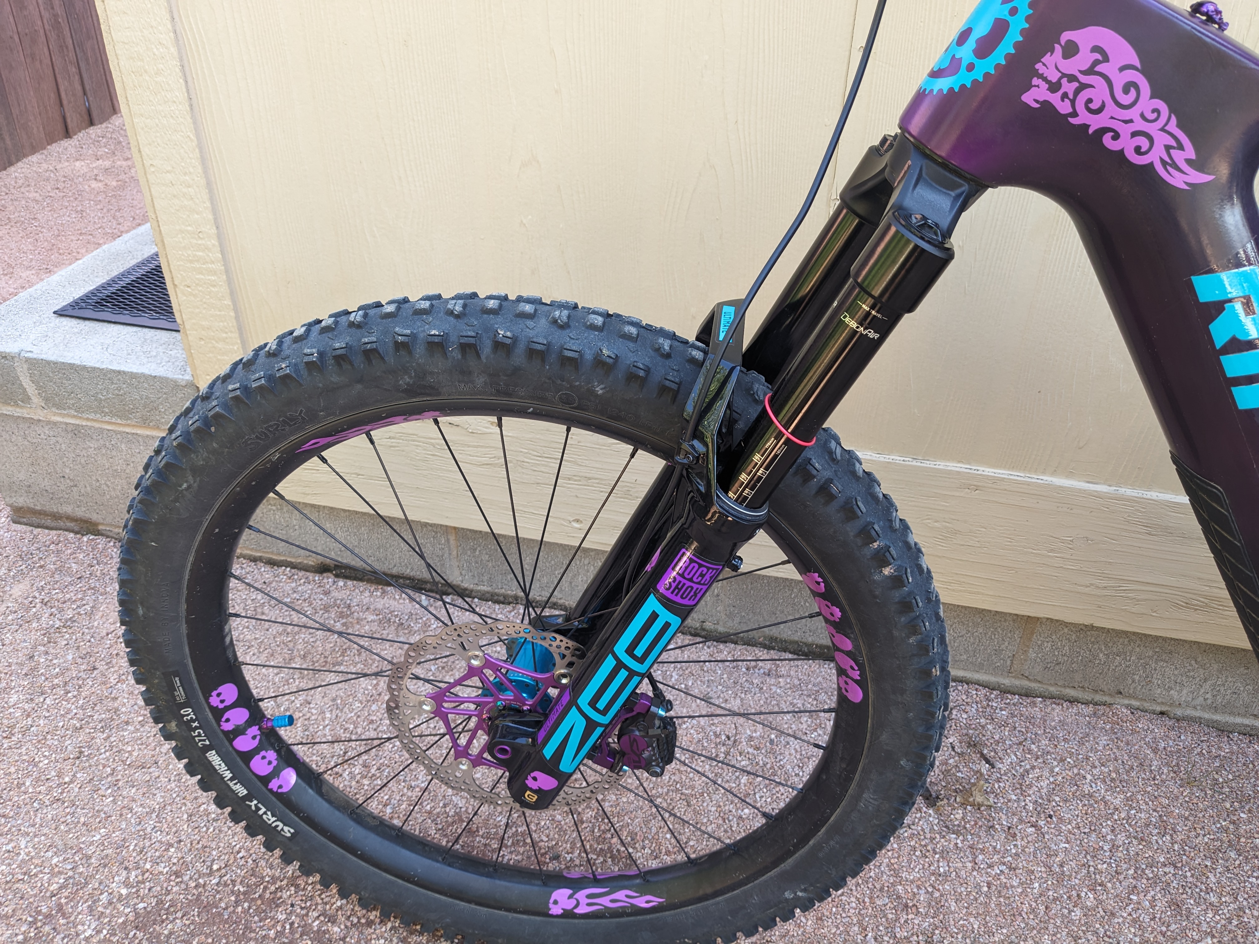

calvintys
Sep 12, 2023
276
272
Malaysia
I try lyrik ultimate before then swap to fox 38, my bike handling feel totally different. Will be getting ohlin 38 this weekend. Hopefully will feel better. Lyrik n zeb weight difference only 200 gram. I will go for zeb after test out lyrics for 1 months. Again its all depends what of trail u are riding. My its mostly technical with lot of rock. 30% sag n use up 80% travel most of the time. So i stiffness allow me to more confident.

CarolinaCrawler
View attachment 136151 View attachment 136152
Your build really fascinates me. I would love to know the full build specs. Truly incredible getting that spec under 20kg!

calvintys
Sep 12, 2023
276
272
Malaysia
First i upgrade my carbon to T800 grade initially was 700 standard that was 200 gram saving then include carbon 480wh battery.
Wheelset = dtswiss 240 + 350 sapim cxray spoke + oem carbon rim
Groupset xx1 cassette + xo axs
Dropper one up v1 170mm
Handle bar OneUp rise 35
Stem Renthal Apex
Pedal Deity Tmax
Brake Magura combo F caliper MT7 + R caliper MT8 + lever MT5 + HC3
Saddle OEM specialized power saddle titanium rail.
Chainring china aluminium 34T
Invisible frame protection about 200gram full wrap.
Shock ohlin coil
Fork 38 factory
Cushcore on rear wheel.
Tire assegai front n panaracer enduro rear tire.
Weight = 19.5kg, without pedal n invisible frame protection should be sub 19kg.

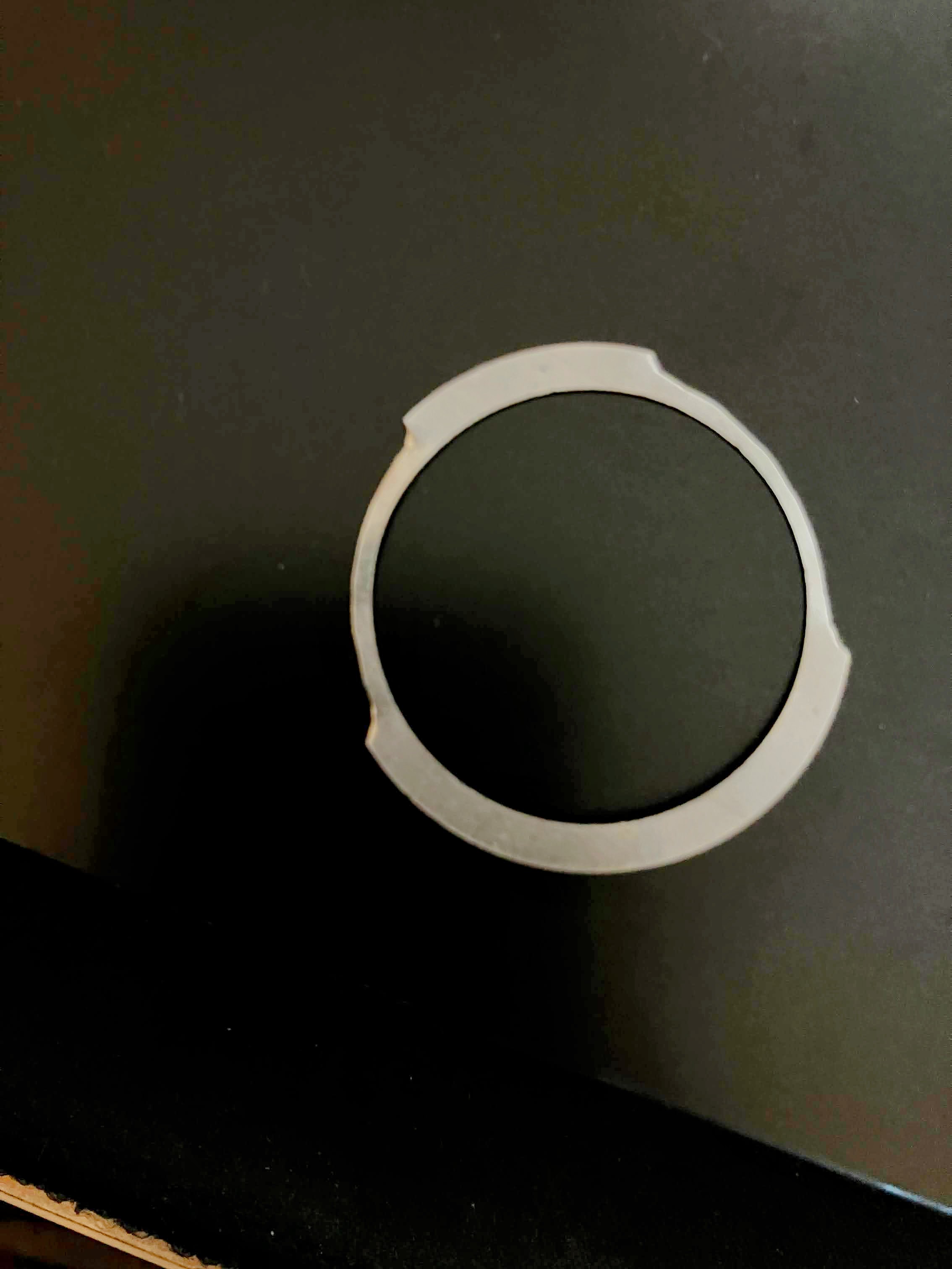

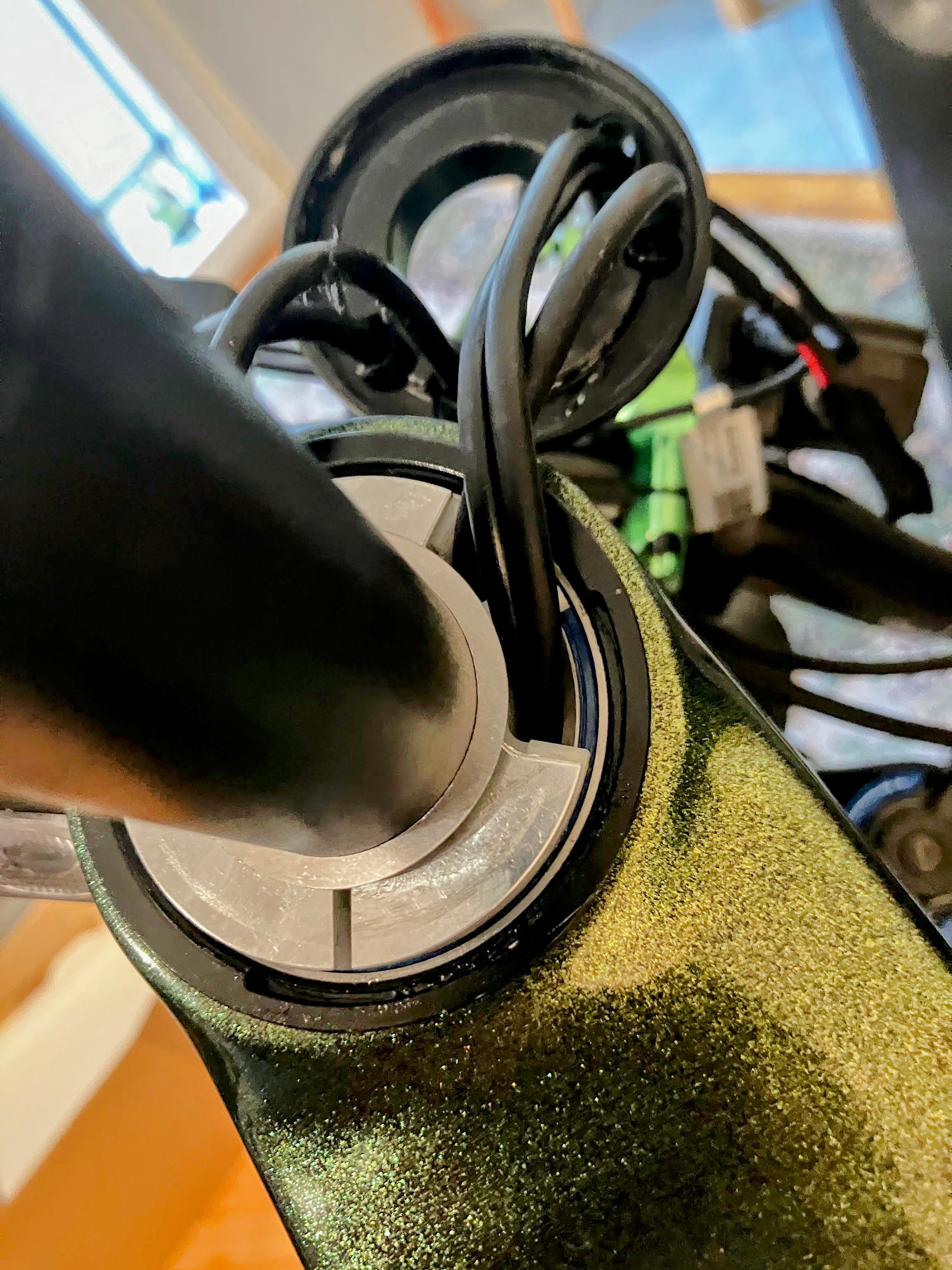

when I add headset spacer between plastic-alu cone and headset cover, I make a cutout with scissors similar to the alu element underneath it. otherwise it will definitely cut into the cables (esp. the electrical ones). one 0.25mm spacer is not enough, 2 or 3 will be needed

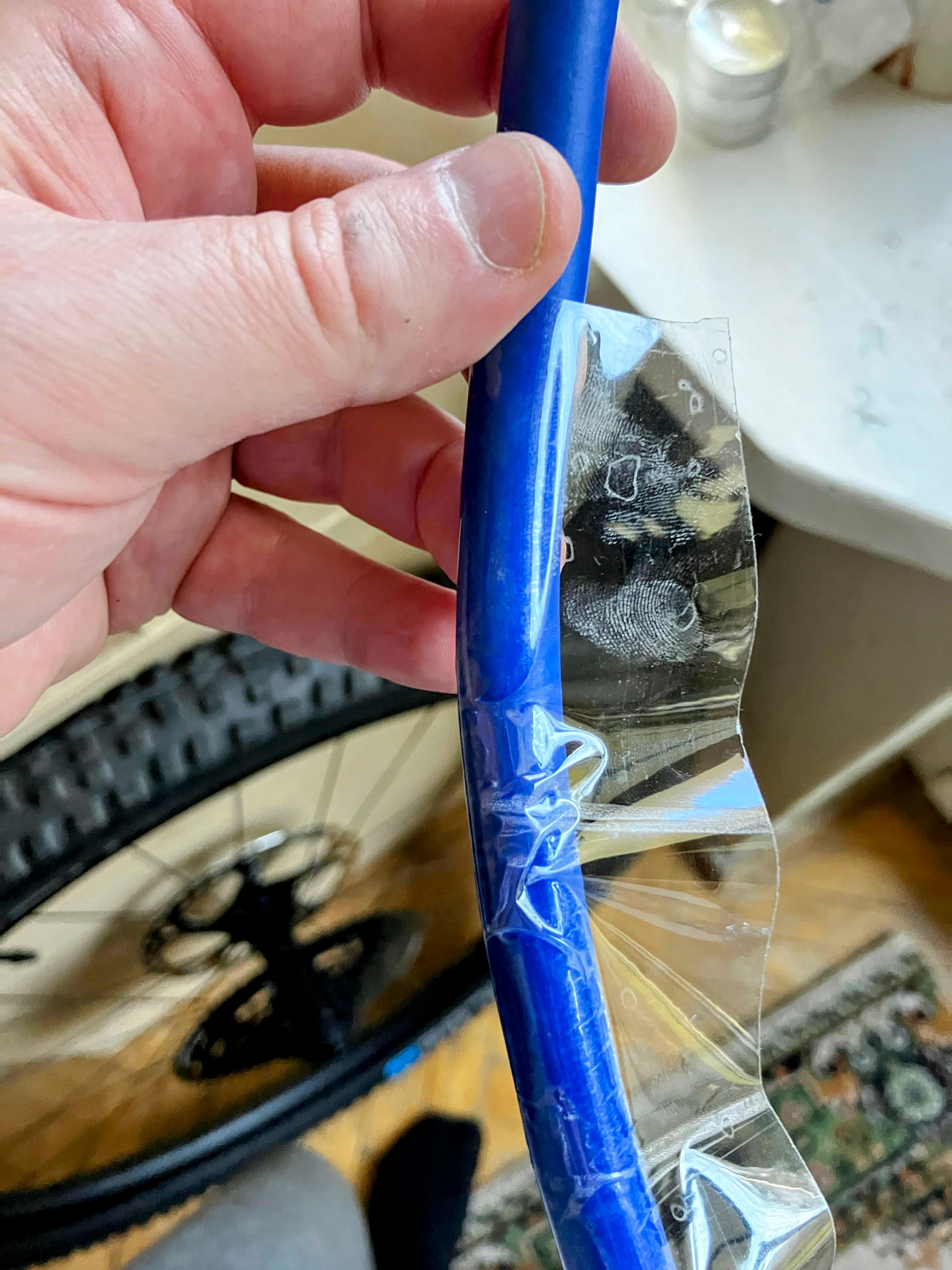

it took almost whole day but I finally managed to squeeze the foam tubing into the chainstays to prevent the cables from rattling. here's a trick I used: I wrap the tube in the slick office tape to decrease friction with rough inner carbon/resin surface. I put some PTFE grease on the outside of the tube, slide the tube down the cable and then rotate it into a spiral around the cable, decreasing its diameter and increasing stiffness, making it less likely to slide on the cable. then, I pull the cable together with the tube into the chainstay, pushing the tube from the engine side.
it was probably the most exhausting part of the build, but cable rattling is gone. the problem I see is that it is a single-use solution, so changing the cables will require removing the foam and then going through all this pain again (but once I discovered the "algorithm" it's not that hard). there's also a possibility the tubes might get stuck...
