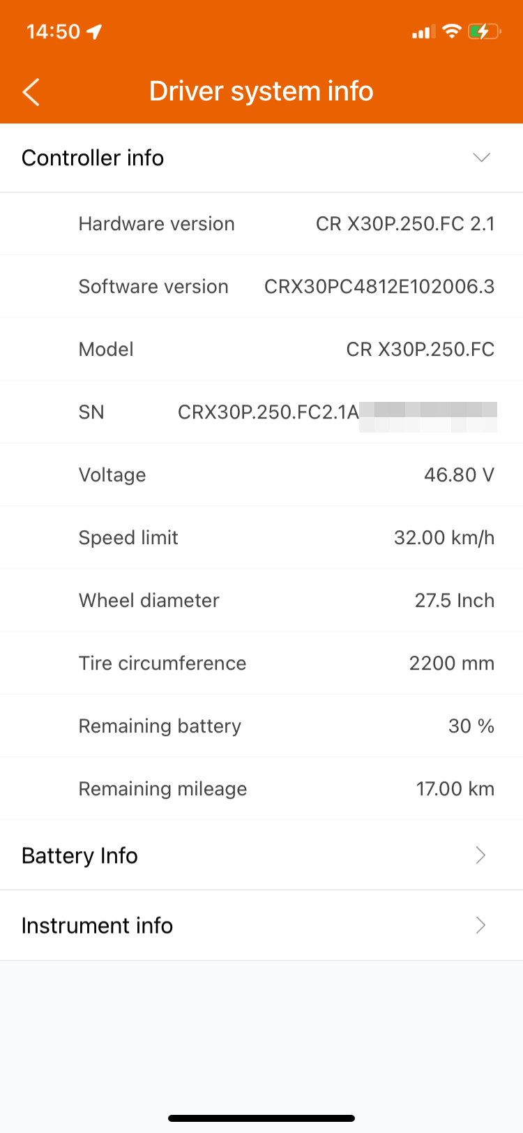

My CEF50, which arrived in January 2024, had a speed limit of 32km/h. Settings cannot be changed on bafang GO+.

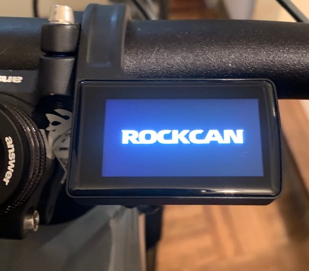

View attachment 134974 By the way, my startup screen is "ROCKCAN", but is everyone else's too?
Yes my 48v its ROCKCAN too.

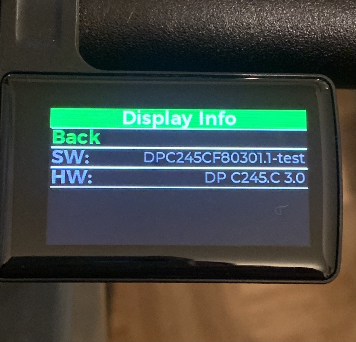

No, neither your software 4812. Can you ask to recovery this controller software (and share) from you supplier ?
If you compare your HMI datas with user book of DPC245, do you see differences ?
We have spoken to the supplier and are awaiting a response. I think the normal "BAFANG" startup screen would be better.
This may be the case with 48v specifications.

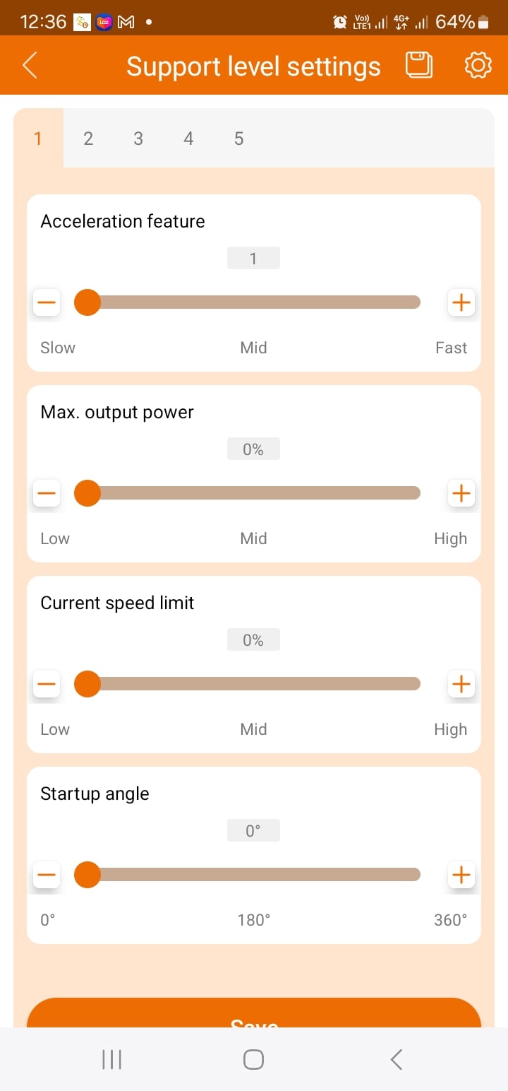

So i cant change these settings? When im not connected over BT, it says i need to connect to device. When i am connected, it says operation failed and i cant even see that window.

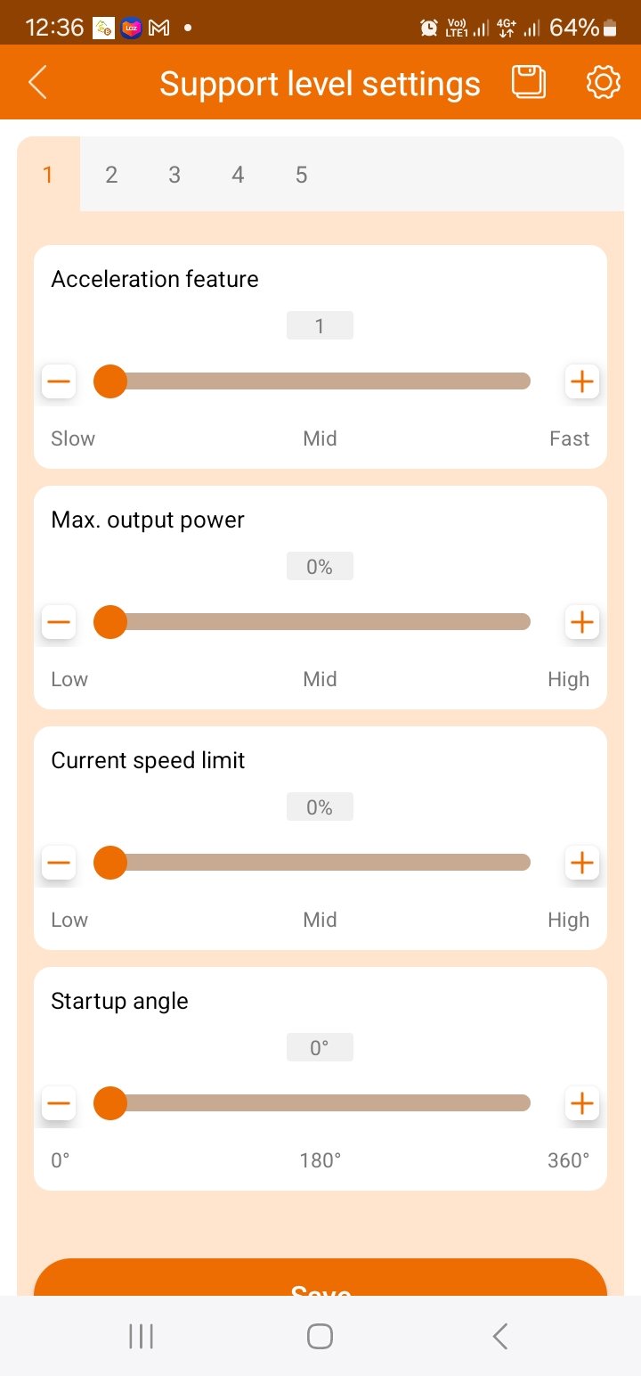

@Phatty In general you can't mix and match chargers. That is what typically leads to a headline about a fire. Chargers are all different. Some are simply a pair of wires for voltage. Some have temperature sensing, some are canbus and monitor everything about the battery. You must have a charger designed for your battery. The charge voltage needs to be a few volts above the battery voltage or current will not flow from the charger to the battery. But if the voltage is too high it will damage the battery unless a smart BMS steps in and cuts off the voltage source. Most BMS are not smart enough to change the incoming voltage, they can be very simple devices. Some can be smart enough to balance the voltage of the cells inside the battery. So you really need to be careful when changing chargers on an ebike.
@92se-r The Go+ app is limited in what it can change. It can change the assist levels and the acceleration but it can't change the country settings for max speed allowed etc. It's can't change the wheel size, because it affects the max speed.
You need the Besst Pro tool to do those thing and it is designed as a dealer tool. You can easily buy the hardware but you need a password and ID to use it. You can't get one of those unless you are a dealer, or use a work-around.

Yup understood, sorry i have 2 issues. I have the speed issue which I am working with Jean on. However i cannot go into the setting to adjust motor peak power, acceleration, etc when connected over bluetooth, it keeps saying operation failed. If i am disconnected every once in a while it lets me go into the screen. Otherwise it just tells me to connect to device.
Once you open GO+ the windows connecting will pop up just click cancel and you can browse to this windows.
