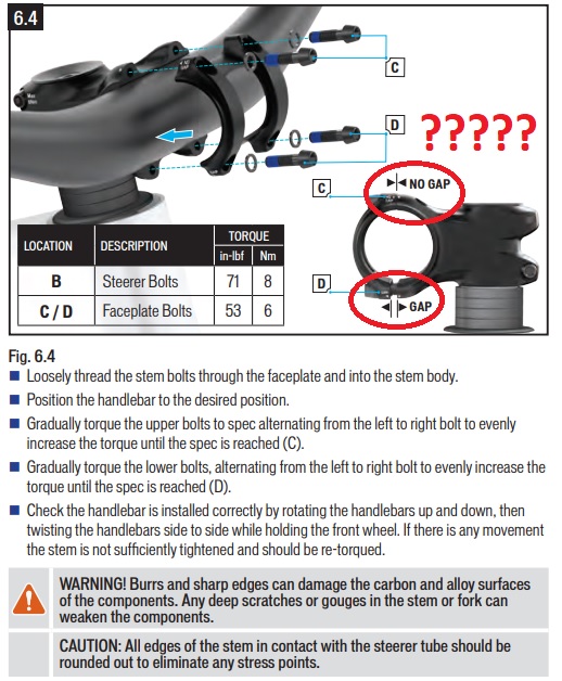

Just read the manual .. It's a nice manual ! Lots of useful information.
For the TCU's I guess they need some additional specification change between the lower models and the higher models.
From everything I'd read in the manual, there was no mention of anything being different for Alloy or Carbon models - so I was concluding that even the base models were going to be carbon - however on the last page there's this :

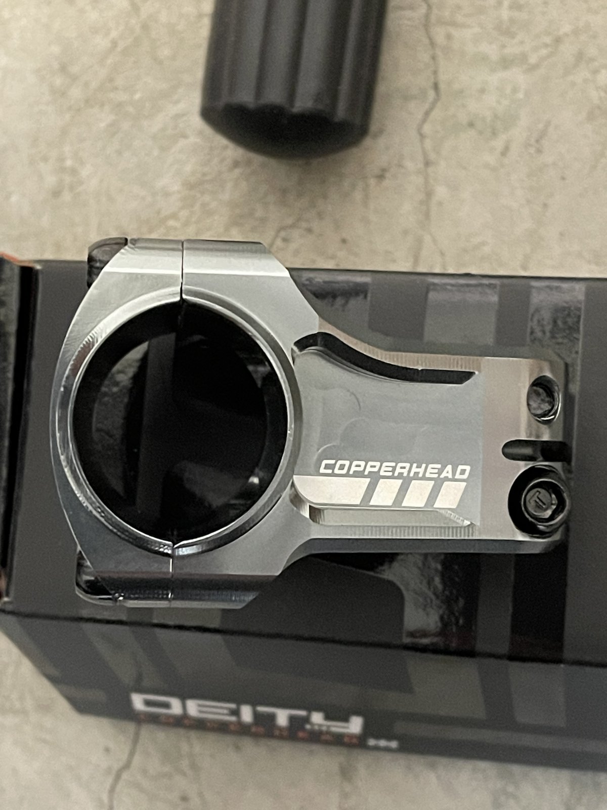

Do you think this recommendation present in the manual , is also valid for the Deity Copperhead mounted on the PRO version?
There is nothing written on the Deity website.
