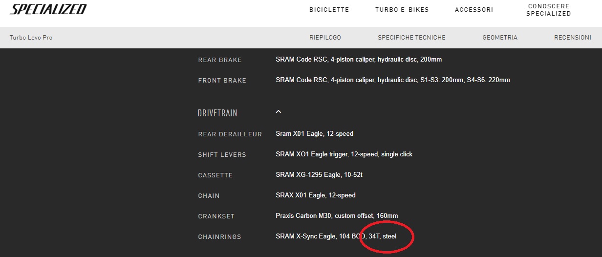

34" chainring is to make up for the lower ratio 27.5 rear wheel.
2021 model had 32" but had 29 rear wheel.
My comparison was between the data of the PRO version 2022, reported on the official website, and the data reported by @Rob Rides EMTB ( post #113) of the Expert 2022 version.
Both 2022 models are Mullet but have different chainring

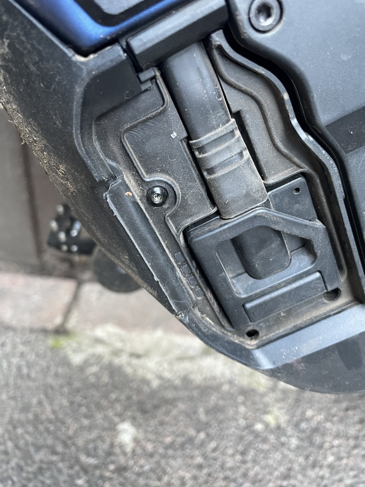

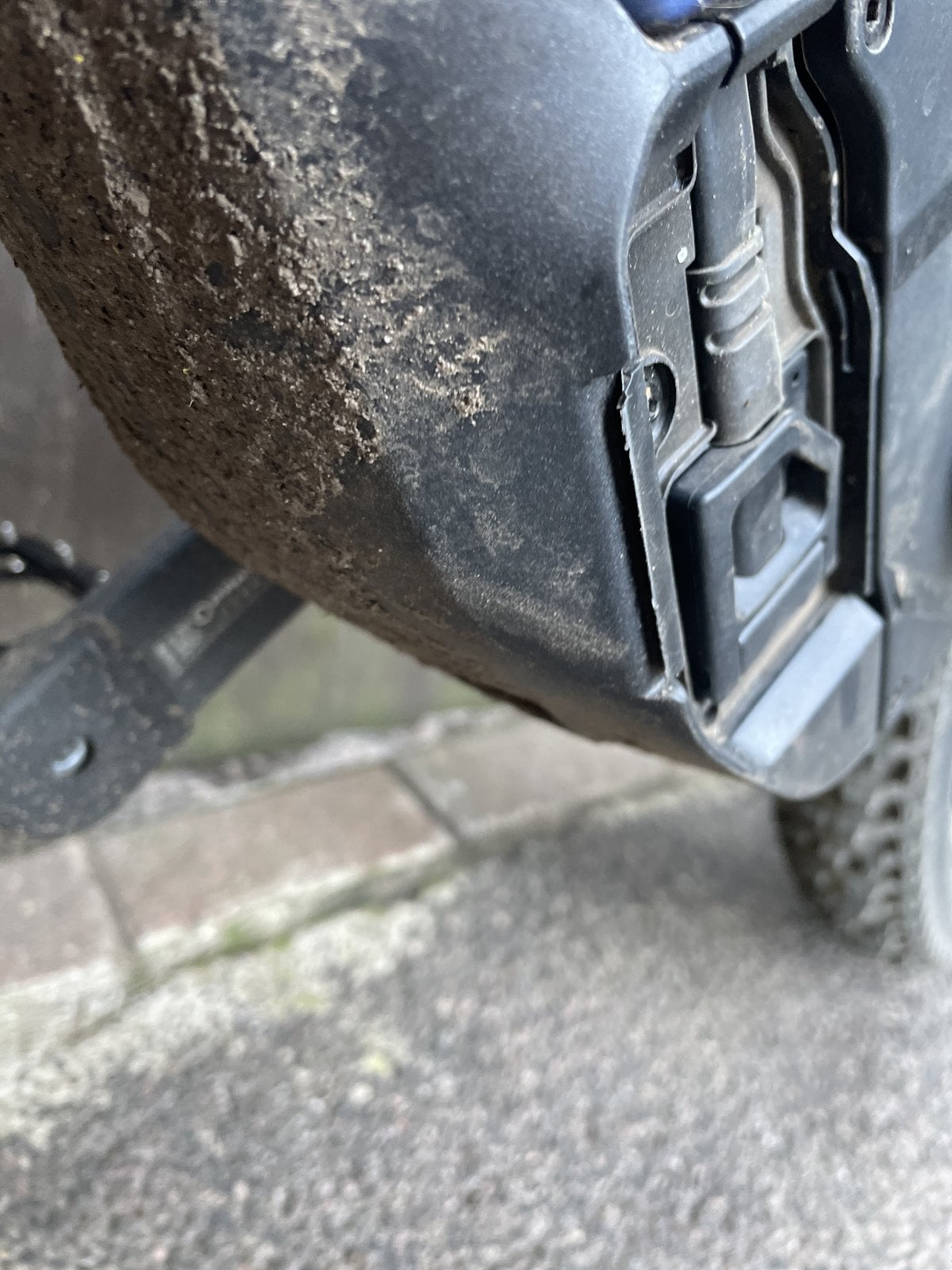

Whist I love the bike, this is going to get some serious use. But came to charge it for this afternoons ride and noticed that for some reason the little door that protects the charge point has some how fallen off on the last ride.
14,057
20,857
Whist I love the bike, this is going to get some serious use. But came to charge it for this afternoons ride and noticed that for some reason the little door that protects the charge point has some how fallen off on the last ride. View attachment 57648

To be fair I did go through a lot of rough low bushes yesterday, so it could have very easily have got caught. Bike still works fine the plug it self feels very secure.

In Robs initial review he did say a small hinge, and the image you have posted makes it look like a thin hinge.
The little door could be opened by a shrub / bush / root / rock from underneath as it unlocks upwards ?
Then when the little door opens mid ride the crank could sheer the door off ?

I'm sure they've tested it with many thousands of openings. But it was fairly obvious that for some people it's going to break. I'm sure we've all had something in life with a similar flexible plastic hinge which eventually just tears off after repeated flexings and that's without bashing/rubbing it on rocks, trees, shrubs and so on.

I suspect that this is what has happened. It’s not a problem not stopping use of the bike, and sure Spz will sort early next week, the service I have received on my last 2 S Works EMTBs over the years has been brilliant.

Will find out Tuesday when Spz store is open. It looks like a small part would be surprised if Spz U.K. don’t have access to a replacement here in U.K. Does not affect rides in any way.

I actually think it’s a really good design and should solve the water ingress problem on these bikes. Who knows I might not have even locked the cover after the charge. Things like this can happen. Sure Spz store will sort ASAP tomorrow. Yes have some wide waterproof tape that fits perfectly until it’s fixed.

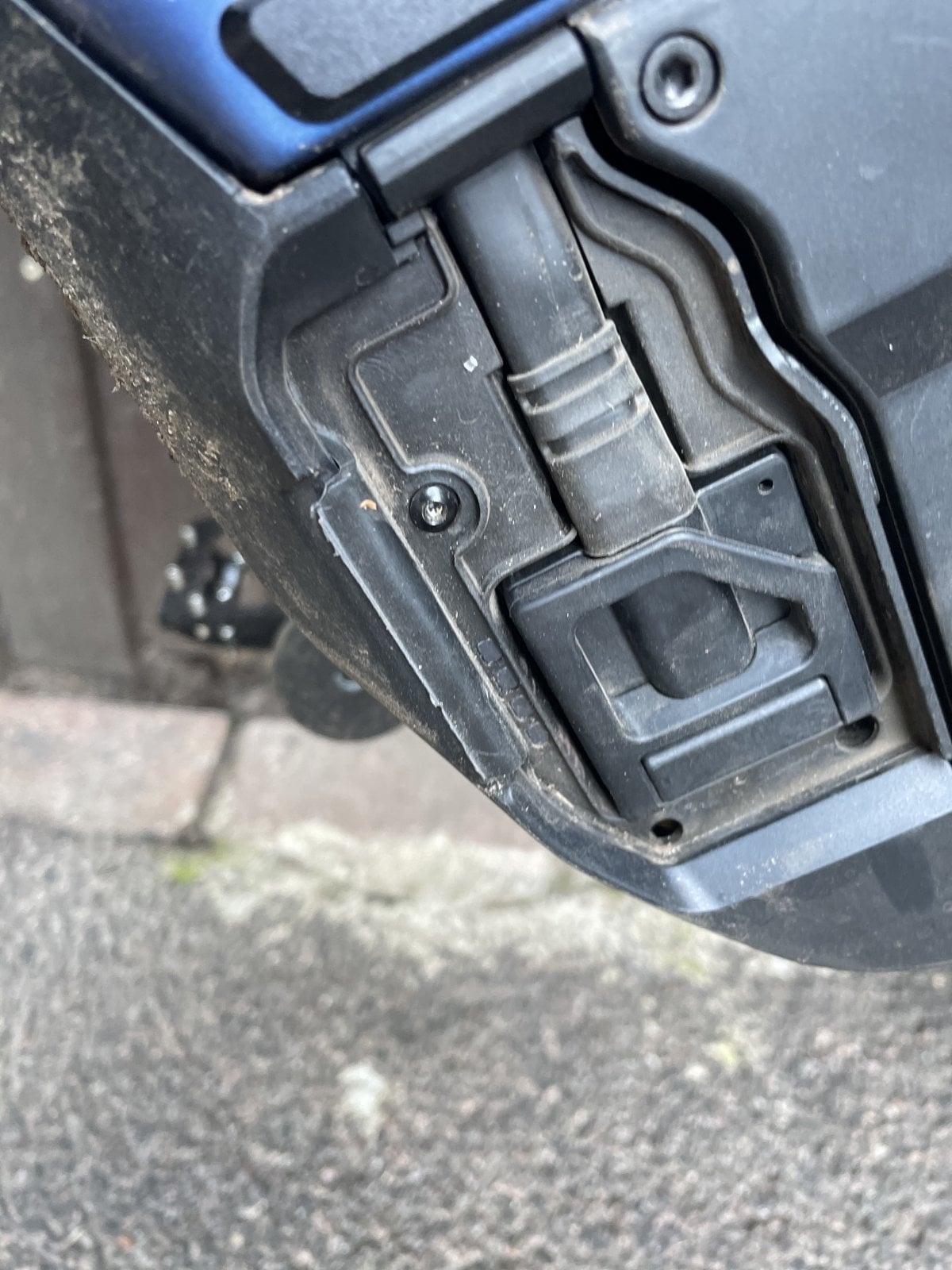

Sorry to say this, but looks to me like you might have sheared off the clip to the rhs of the port as well? Must admit, when i saw the original pics, first thing in my mind was "that'd be the first thing i break then"

No it’s 100% just the flap clean at were it folds over , it’s very thin plastic.

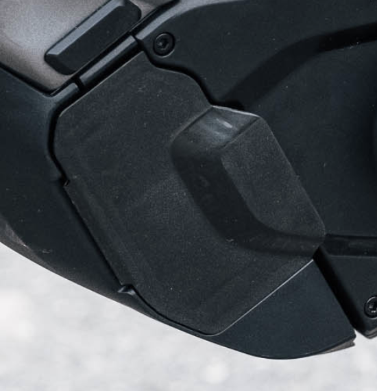

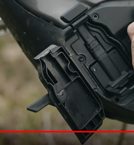

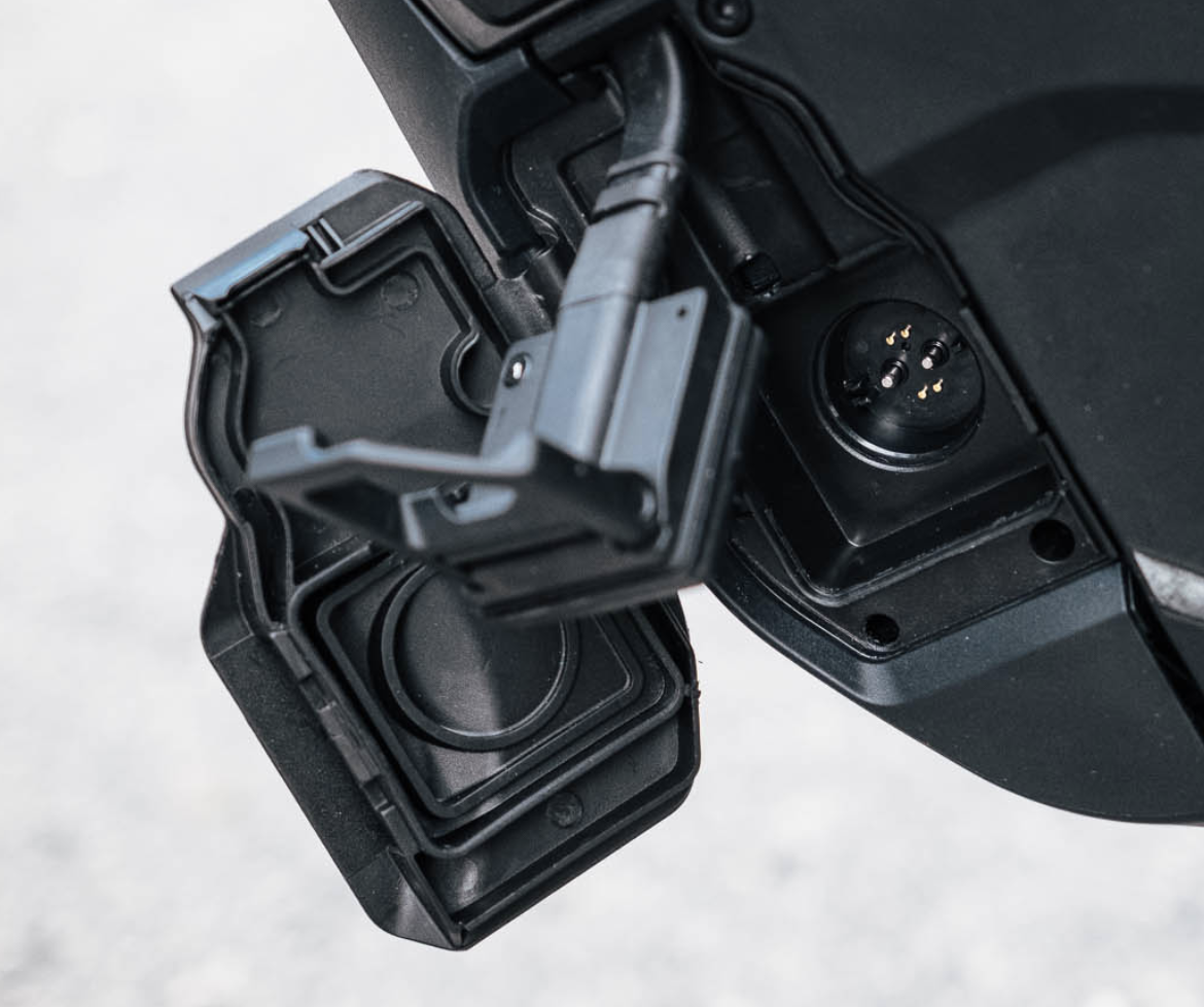

The ebike-mtb.com review has a very different cover to the one in Robs review ?
Robs review is the first photo. ( Pinkbike got the same type as did theloamwolf )
ebike-mtb.com review the 2nd and 3rd photo where they have removed the switch ( also here Specialized - S-Works Turbo Levo 2022 Gen3 - Zero G Chamonix and Specialized Turbo Levo 2022: eMTB enduro geometrie variabili and SPECIALIZED Turbo Levo Pro Satin Redwood/Smoke/Black 2022 - VELOsprint )
In the promo photo of the red bike on the tredz website there was no front cover so suggests the cover might have been a last minute design and might have had limited testing.

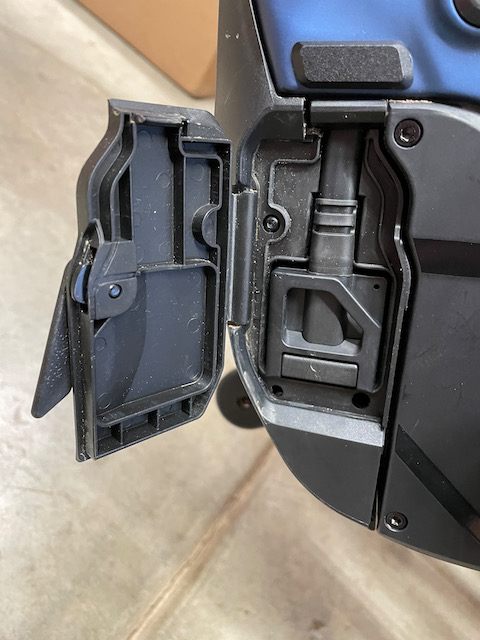

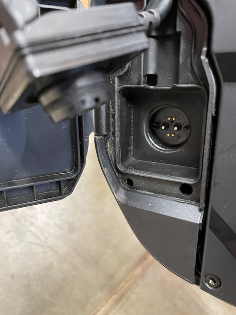

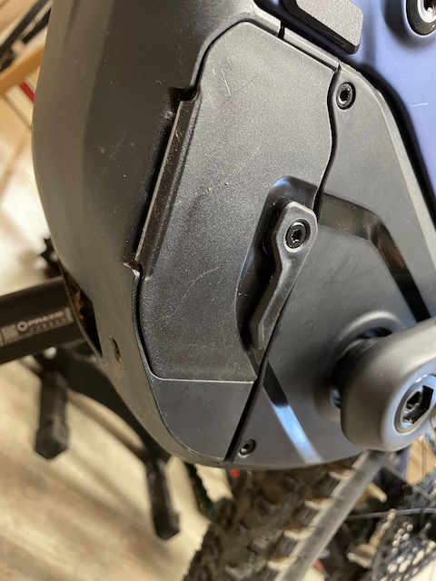

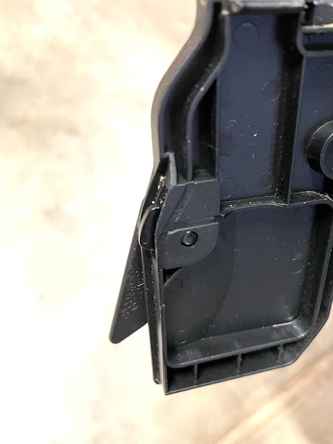

The outer battery cover (door) is just hinged and has a small plastic blade that the lever moves to lock the door shut. No magnets that I can see or feel. The charging port plug/lid does not use a magnet either that I can tell. Its a snug friction fit with the water seals. The little flippy lever that folds out to aid the removal of the plug/lid does have a magnet that neatly holds the little flippy lever in the closed position. I have not had min come open on a ride yet but can see that the door lever should be recessed a bit more and have a stronger detent to keep it on the closed position.
ebike-mtb.com review the 2nd and 3rd photo where they have removed the switch ( also here Specialized - S-Works Turbo Levo 2022 Gen3 - Zero G Chamonix )
Looking at the inner moulding, it looks like the pinkbike type door was probably a prototype style which was then upgraded with the catch.
It almost looks like they tried to incorporate the square plug seal into the door originally rather than into he Rosenberg plug.
