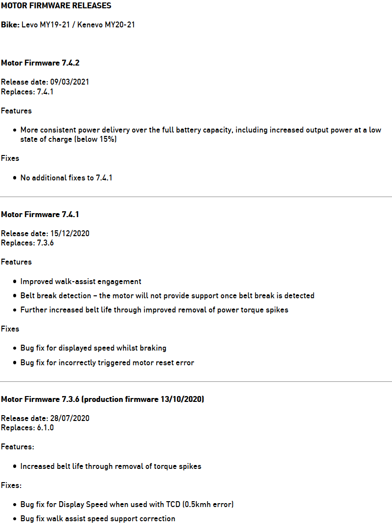

EXCITING FIRMWARE "UPDATES" (UPDATED 09/03/2021)
Thanks to the help of our beta testers once again today we released our newest motor firmware 7.4.2 for 2.1 Motors available via Mission Control Over The Air Updates. The OTA process has been further improved and firmware developed with the feedback given by our Beta testers.
To update and find out what has changed in the latest firmware install Mission Control 2.4.5, see further details below.
See previous post here regarding last 2.1 Motor firmware release and warranty extension >> warranty extension firmware update
What are over the air (OTA) updates?
Over The Air (OTA) updates will allow you to update any Levo gen 2 (MY19-21) and Kenevo gen 2 (MY20-21) TCU and 2.1 Motor to the latest available firmware using your phone, supported by IOS and Android.
How can I carry out OTA updates for my LEVO / KENEVO GEN 2?
Download and install the latest version of Mission Control, connect to your bike, navigate to > Diagnose > you will see an update icon next to "Device updates".
Enter into Device Updates and here you will see your current version of firmware and the latest available version.
To find out what has changed in this firmware version and the previous firmware versions refer to the release notes by clicking on "Find out whats new here." under the firmware table.
If you want to update then click on "Update my bike". Please read the notice information carefully before updating, also note batteries cannot be updated OTA and you will not be able to roll back to the previous firmware version.

NEW 2.1 MOTOR FIRMWARE RELEASED (09/03/2021)
New Motor firmware 7.4.2 for 2.1 motors is now released to all riders via Mission Control.
In order to install via Mission Control please refer to the updated post on this thread >>HERE<<
To find out what has changed in this latest firmware release please refer to our new firmware release notes in Mission Control under "Find out whats new here." before updating.
Please feedback on your experience on this thread!
Enjoy, Specialized Team! :)

Anyone having issues with the new firmware?
It should increase power output when stage of charge is below 15%. However in my case it looks that the whole system just shut down when this happens and for a while I can't even turn the bike on.
Battery health reported by mission control is 100% and this happened to me twice since I updated the bike. It did not happen before.
Just got home from at 2h45m ride, 55km. With the new firmware, but I did not got under 15% today. Had no problems or anything.
Did you got under 15% ?

I did not check state of charge with the app, but I saw 2 bars on TCU so yeah, it is possible that SoC was under 15%.
@head - sorry to hear, will send you a PM.
