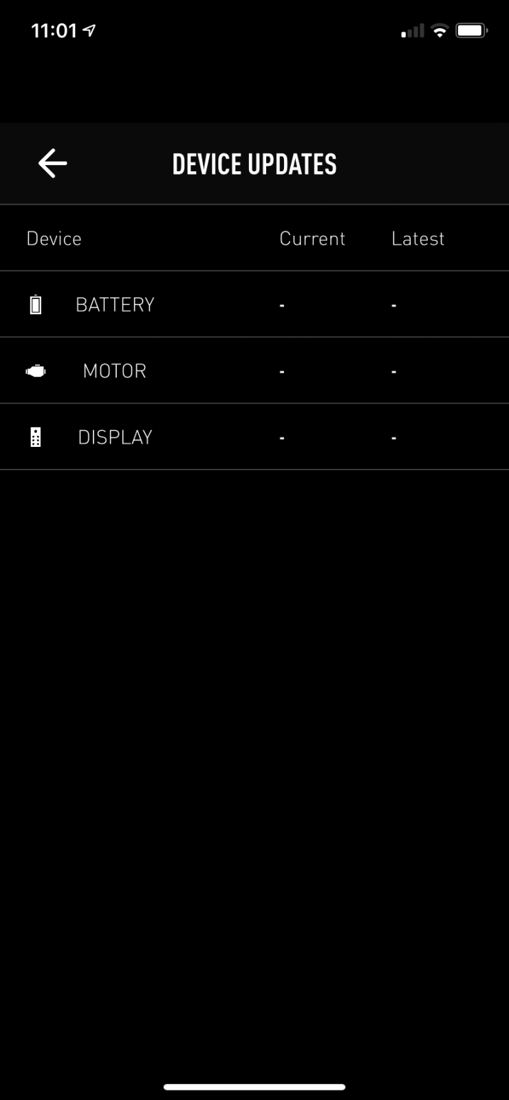

The OTA update doesn't work for me. I have a 2019 Levo Expert. I have installed Mission Control App 2.4.3 Build 75 on my Apple phone. I've tried logging out/in, as well as deleting and reinstalling the app. When I open up the Diagnose>Device Updates screen I see this.
My TCU was replaced under warranty last year and I'm wondering if that is the cause of my problem (note there is no S/N in the Diagnose screen)?

Sadly @Alan Yeung you could be correct. When the TCU is replaced your retailer needs to connect this to their diagnostic cool and re-calibrate/update the bike by entering the bike Serial number. Unless the bike has a matching SN stored inside all the components it will not allow you to update. You'll need to go back to the retailer with this one and explain the situation. If it was their error then there shouldn't be any charge for this.

I can confirm this. My 2019 Levo TCU was replaced under warranty last month, and the dealer had to use their software tool to write my existing serial number into the new TCU. At the same time, I queried whether the bike total odometer value would transfer across, but it appears this value is stored in the motor, not the TCU.
