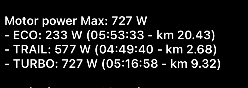

I ride 80% of time with turbo, no pity to motor. All year round. -30 to +30 celsius.
Enduro style riding. I use motor. All out:
9500km now in two years, original motor. Still going strong.
What comes to rim smashing; if you smash you rims it’s not mtb. It’s poor lines, better learn to ride ”smooth” and learn to pick your lines better. ;)
Coburn
Aug 18, 2019
82
48
Somerset
Thats actually 32.7% distance or 34% time in turbo.
