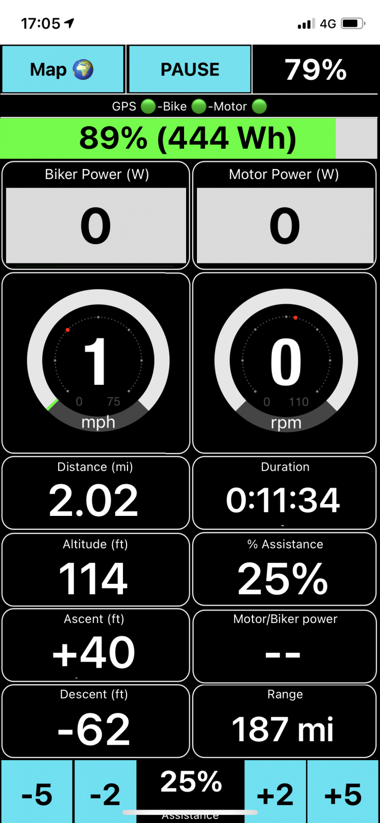

Don’t know if it is update related but I went for a ride for the first time in a month and the motor was giving very little power. So much so it has rather depressingly exposed the gulf between me and the bike. Just 7 miles of mostly flat riding but even the slightest rise, ridden on full turbo 100% knackered me.
BLEvo says motor used just 27Wh and gave support for 46% of the ride.
check out the predicted range (oddly, the previous ride was telling me I had 67miles on eco, I put it down to warm weather)
