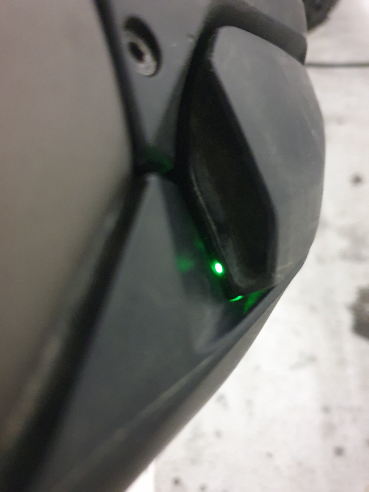

Third Motor Build Date 20.06.22, FW 7.3.6, and did 1'800km on it. This morning I was on a bike run washed and recharched it. now I can't start it! I hear a 'beeb' and the lights where you charch it they don't turn off when closing the charching plug (you can see them) There is no light on the TUC and you can't turn it on! NO motor support at all!
Did one of you also ever had such behaver?
The Plug is closed.

The power cord likely has some moisture or is damaged
i remedied the issue by opening the cover and removed the cord to completely dry (crank arm will need to be removed). This fixed the issue for the meantime. I eventually replaced the cord with the new version under warranty
the green lights on the battery were also blinking while power cord was connected when the issue occurred.

Clean the plug also if you can see the green lights it not plugged in properly I had this problem as they are magnetic it picked up small piece of swarf and stopped it going going allthe way home
