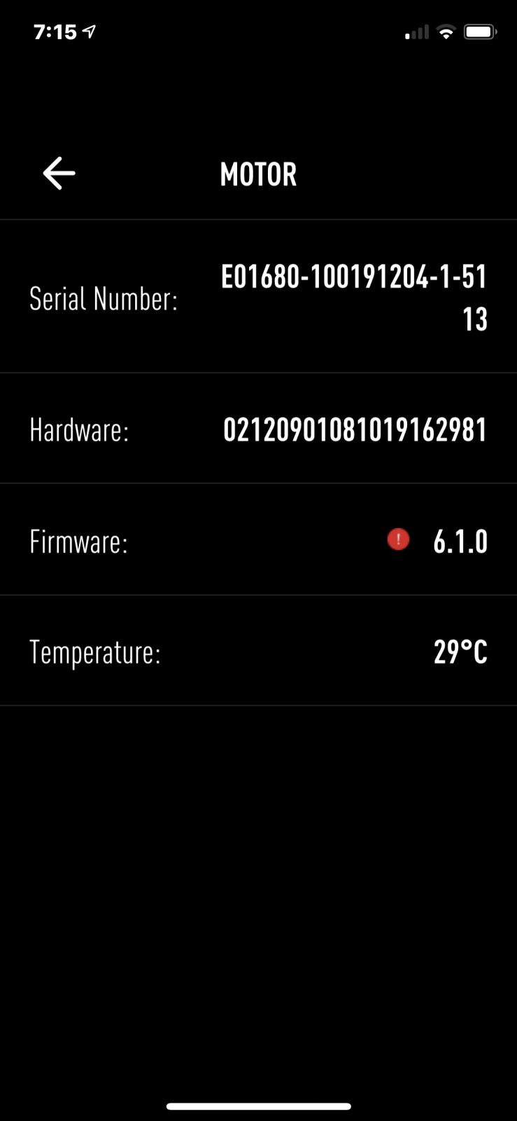

What is the motor serial number on mission control?

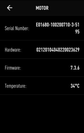

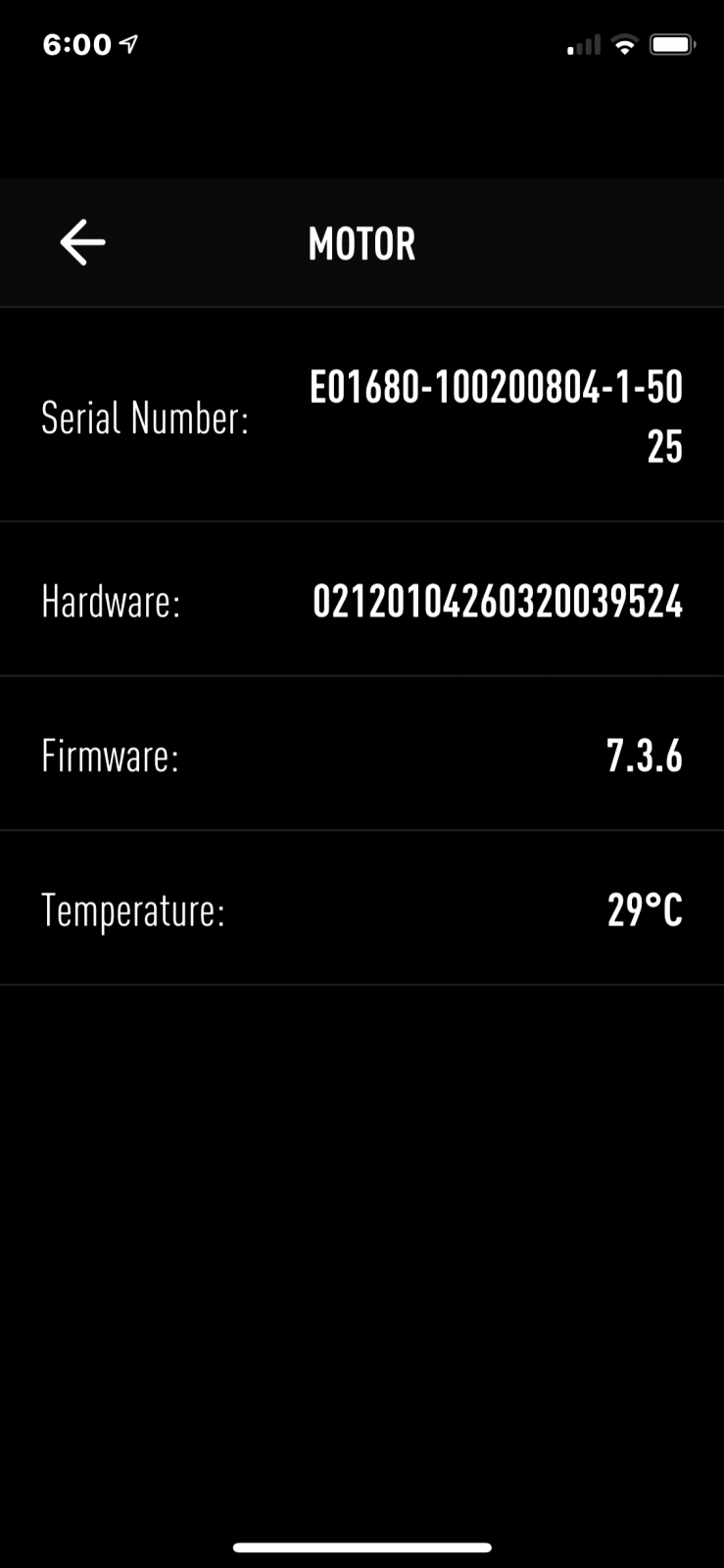

My 2021 Levo motor started making a super loud whirling type noise when ever the motor was on. In OFF position, no whirling noise while pedaling. LBS diag it as an internal concern from the motor and has placed an order for a new motor.
I think it’s a late 2019 motor, which seems strange for a 2021 bike. Or am I reading it wrong?
Just an update to my motor being super noisy, grinding type sound! Other than the noise, my motor worked perfectly and my LBS let me keep riding until the new motor came in. As you can see I started the process Sept. 23, 2020 and got word the new motor arrived to Temecula, CA Oct. 26, 2020. So a little over a month and that's with the 1st motor Specialized sent out but some how got lost with FedEx. The bike is now back to whisper quiet and I feel like I have a new bike again! Here's the latest motor #. I don't know why I can't figure out the code on my own, but I think its a 2020 motor. Please correct me if I'm wrong. All updates have been performed, my walk seems pretty useless now:(. Hopefully this motor will last way longer than the 1srt motor.
Yes, the date is 4th of August 2020
digits after xxxxxx-100-year-month-day
