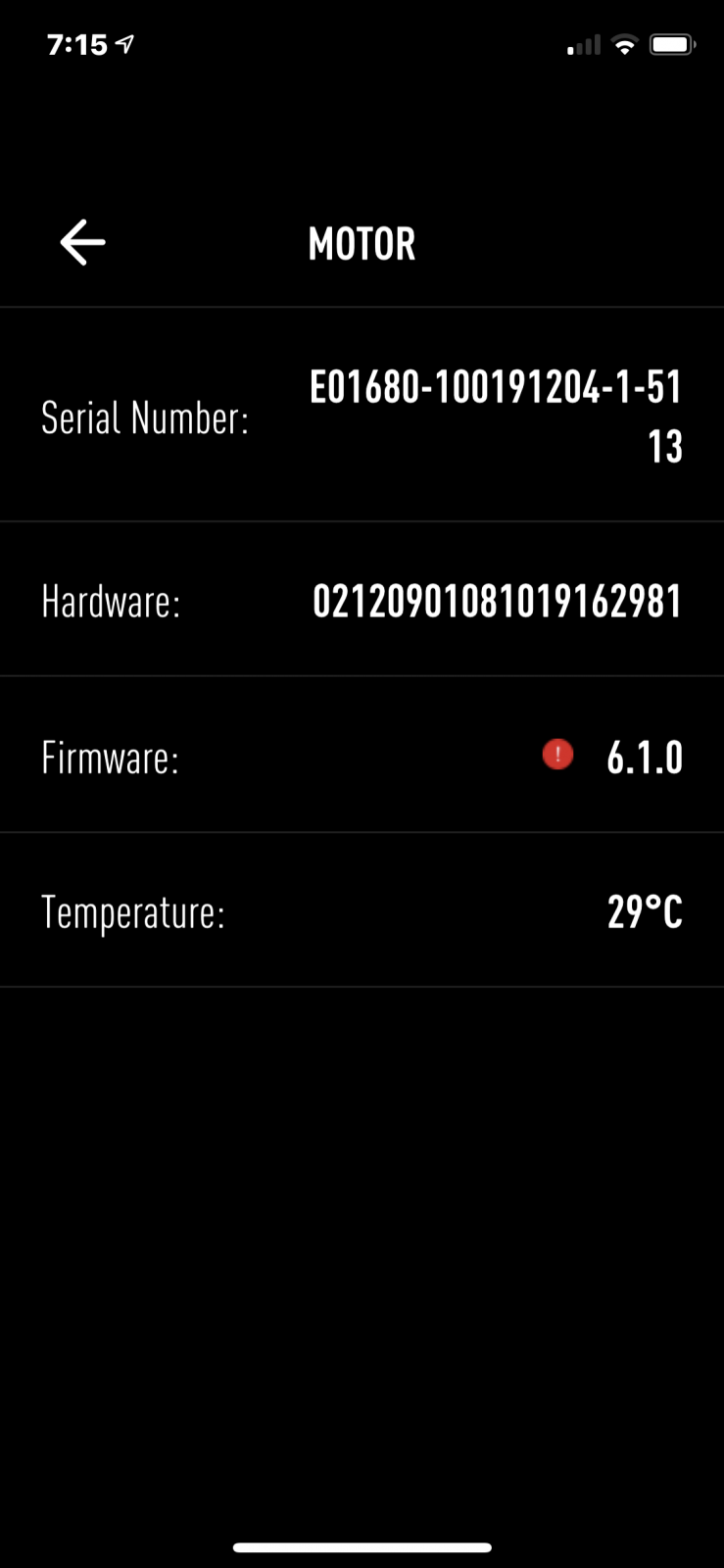

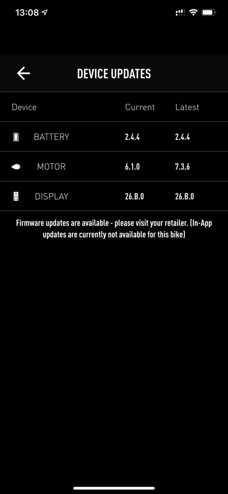

OK, so I did the firmware update this morning. I did a quick check in the parking lot and found that the walk feature has changed markedly. Now when I push the walk button nothing really seemed to happen until I started walking, and then it kicked in. I had it in the lowest gear ratio, and noticed the pedals sweeping away as the motor caught up to my walking speed. Riding around in the parking lot indicated all modes work fine. I am hoping this firmware up date is soon forgotten, and my Turbo Levo serves me well for many years without needing a new motor. ??
