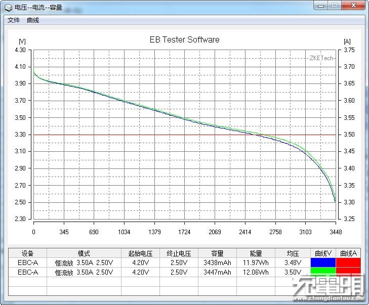

Likewise, if you're claiming that assistance drops off at 30% battery, you need some evidence of this at 35%, 30%, 25%, 20%, 15%, 10%, 5% otherwise it's just hearsay
To go along with what Zimmerfrane is saying, if you look at a discharge graph for a 3500mah 18650 lithium battery you will see that voltage decreases at pretty much a linear rate until around the last 20% of capacity where it starts dropping off sharply. Your perception of less power is therefore correct but is not due to software. It is a result of the battery not being able to supply a set voltage throughout the discharge.
Zimms suggestion of looking at the voltage and current will verify what you are "feeling".
I agree to base on evidence (see my measurements about walk mode), but if I'm pushing at about 250W (I'm 65 :() at 40% support and SUDDENLY "feel" a dramatic drop in support and then look at the battery remaining and see 15% (before this discussion, so not influenced), what should I think?

RCDallas, the graphic you show is the discharge curve of the single cell, but the battery pack is managed by a BMS, that prevents the voltage drops at the "knee" level. The minimum battery pack voltage level is definitely above the red line, and the curve is in linear zone.
The support drop is not the result of the cell voltage and intensity current drop, but the effect of the software choices.

You are correct in that power is reduced at 15% remaining capacity by the software reducing current to the motor. IMHO This is to both protect the battery as well as extend the remaining range as much as possible. The lower the current draw the higher the voltage,. The higher the voltage the more power at a given current...it is a balancing act to get the most out of the battery without causing appreciable damage.
Also, a BMS cannot increase battery voltage, it can only limit current which goes along with the statement above.
As far as the voltage drop the BMS allows is concerned. In order for a 10s4p battery to produce 504whr it would require the entire capacity of each 3500mah cell to be used at an average voltage of 36volts...10 cells in series produces ~42v when fully charged and ~25v when fully discharged and as you can see by the graph in my last post a typical cell can produce in the range of ~3400-3500mah at the rates we discharge them at.
So 4 parallel packs of 10 cells will equal ~ 14ah @ an average voltage of 36v for a total of 504whr of energy available. Of course, temperature and discharge rates over the entire discharge cycle of the battery will vary the actual available capacity of the battery during that particular cycle. This means that it will require a voltage drop of around 60% (not 10%} before the BMS cuts the battery off in order to utilize the full capacity of the battery.
