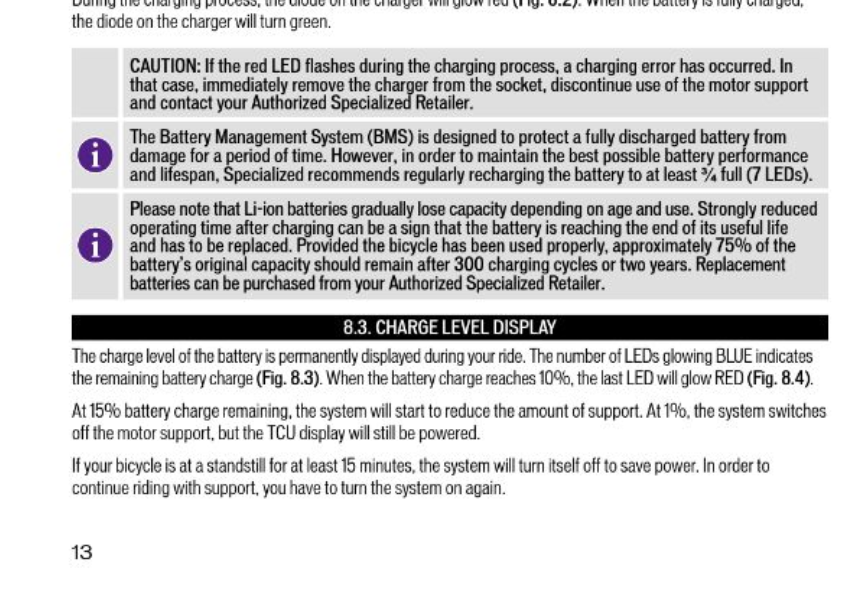

I'm still on the older firmware, but I notice a drop in support once the battery hits 30%
That doesn't sound right, according to manual support reduction starts from 15% battery remaining...
Pyr0, I agree.
No drop until 15% battery remaining, at that point big drop.
Not sure if there is another minor drop at 10%
For sure there is another drop at 5%, but the motor is still pushing: no need to check the motor power in MC, only try to go to zero support....
At 5% you are pushing as an old muscolar bike and the support just compensate the weight and the higher gear rate (feeling)

Actually the evidence is in the manual: no need to claim anything...this is for the 2019 levo:
Well done, glad to see you're on the same page as the rest of us.
Ok, so we'll ignore that there's a firmware update and we'll ignore that the 2019 manual doesn't automatically update itself using quantum layering, we'll also ignore that some people have reported reduced assistance at 30% and 20%, so we can ignore my suggestion for people to test it - using mission control - to see what it's really doing, either for their own peace of mind or so we actually have something real to talk about..

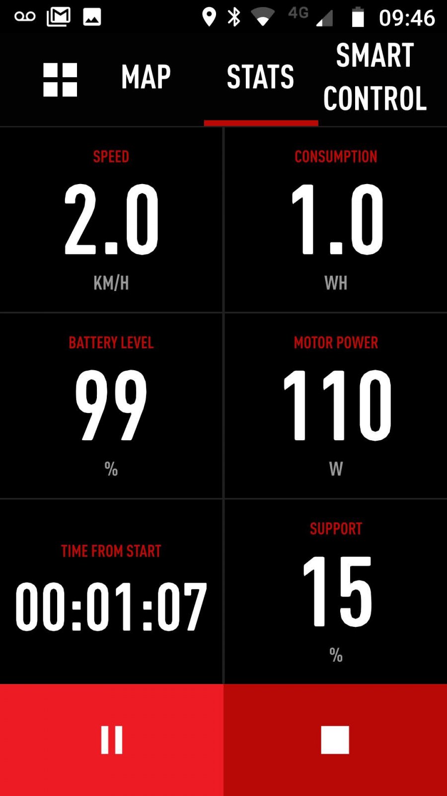

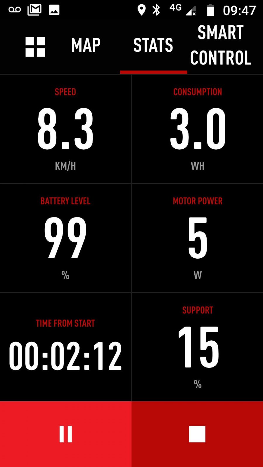

About the first one, to get out of hearsay, I made some experiences (Mag 2.1 and 7.3.6 firmware).
With rear wheel in free air, before engaging the normal walk mode (about 5 km/h) it seems the speed sensor waits for 2 passages of the magnet (I made a dozen of trials and got always the same result)
So the initial time depends on the actual position of the magnet and the selected gear.
On 42T if the magnet is just before the sensor, the normal speed is reached in about 9", if the magnet has just passed the speed sendor it takes about 18".
On 11T and the magnet just before the speed sensor I timed 3" (but, with such a gear it's difficult distinguish the exact instant between slow and normal mode)
If the bike is on the terrain, on 42T, and there is any resistance, and the magnet has just passed the speed sensor, sometimes a time limit is reached before the speed sensor detects 2 magnet passages. The walk mode stops and after few seconds you get a speed sensor error (red led and the blue just below).
Initially I got it at least 3 times, trying to find explanation to different behaviours (different engaging times, sometimes sudden engaging, sometimes error ... :cautious:)
10" is not a constant time, but probably you will use the walk mode when you can't climb any more and you are in the lowest gear, so 9-18" depending on the position of the magnet.
I agree: after the initial low speed transitory, the walk mode is the same as before.

Following my previous hypothesis I tried to "accelerate" the initial transitory speeding up 2 wheel rotation by hand: no way, it waits for his rotations.
I tried to continuously rotate the wheel by hand: after some seconds pedals stops!
So I think the software wants to "feel" resistance, in order to be sure you don't push the bike, and know the actual gear (or, better, the actual speed with the actual gear)
