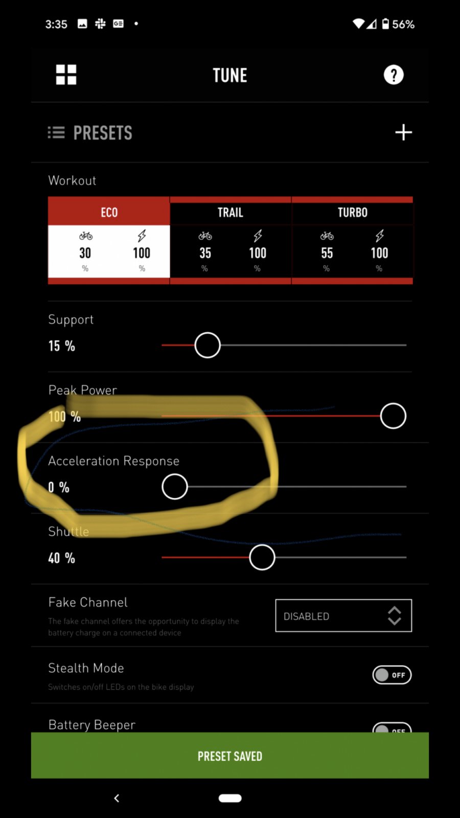

This new update dont like it they have deffo slowed the bike down it’s not as punchy in turbo now than it was , gutted I updated
There is a bug in the update process that causes "Acceleration Response" to be set to 0%. I thought it was already fixed but maybe not. Anyway the point is check your acceleration response. The default setting is 40%.
Mine was reset to 0% when I got a new motor and firmware back in August. I didn't even notice until last month so I just left it at 0. I think it works better on steep climbs and it's less wear on the motor.

Acceleration setting was unaffected, still at 40%.
