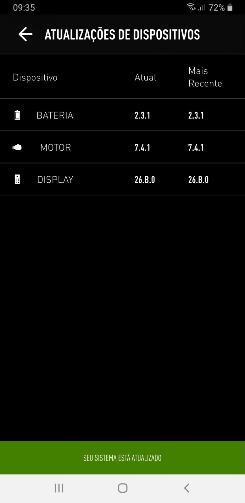

Just updated mine, toke less than 2 minutes.
This is the result.
Are this the latest versions available?
14,405
21,651
No, Before the update my acceleration was set to 0. after the update I have had to change it to 20, will try 40 , but reason I always had it 0 was to conserve battery ...
Don't know why with the new update I need to add acceleration when the bike was fine without it before.
Is it possible you had shuttle at 0 and acceleration at 40 ?
It might be that the updates (no idea what yours was before this update, so there could have been several) have influenced how the acceleration figures work. So 40% maybe nearly exactly the same as it was. But 0% might be considerably more conservative than it was before - so for you, it would achieve, by default, your aim of less battery usage.
