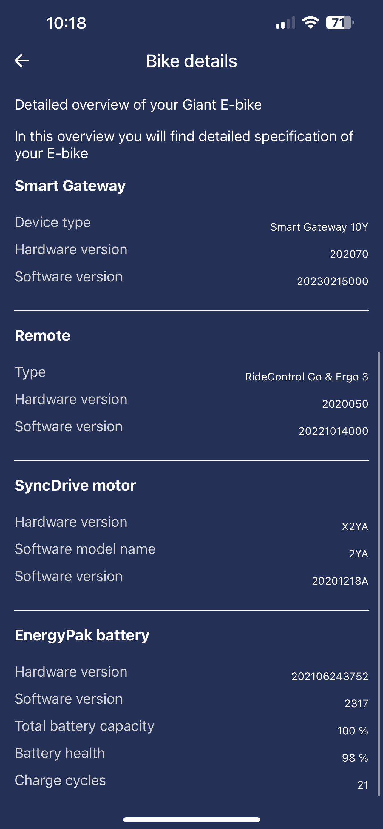

Had you noticed if it took longer to charge? I’ve recently updated via the app and my battery doesn’t seem to get to 100% even after being plugged in for hours on end..

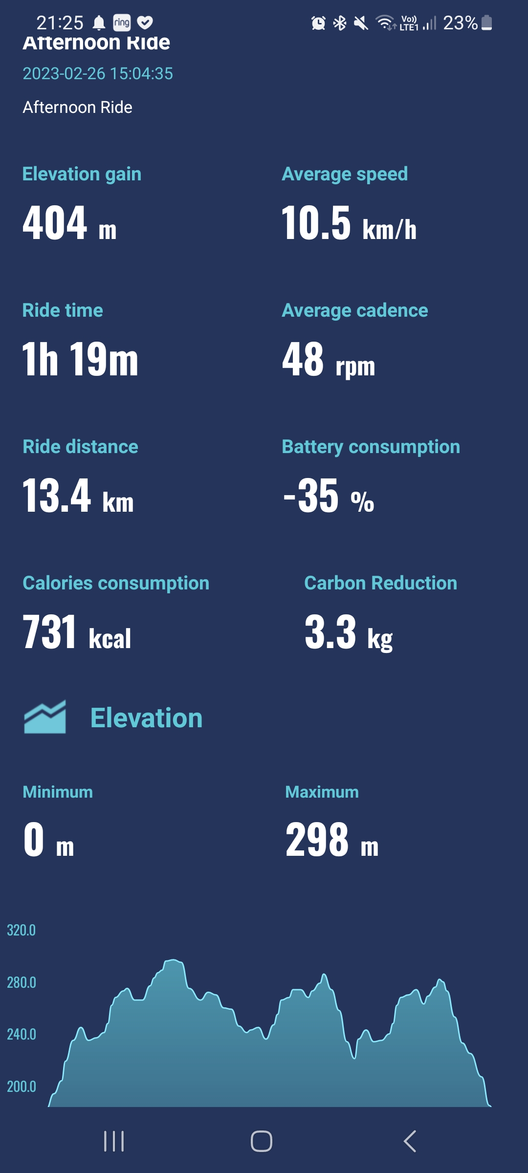

Done 15km yesterday mostly in mode 3 357m of accent used 39% of batter buy I am 116kg and had my daughter on her shotgun seat she's 18kg thought that was OK battery use wise
I have all my modes detuned to lowest assist on the ride app

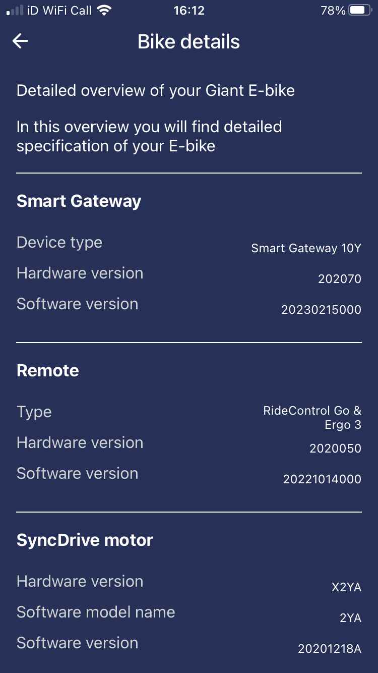

New update for me last night, installed without issue and went for a ride today. Bike feels great and riding in mode 3 felt awesome.
Not sure what the update did, will see if the charging issue is fixed when I plug it back in.

This information is supposed to be included in the details of the RideControl App after is has been updated. At least this is flow with my bikes. App is updated first, and then my bike gets new firmware.
Its a pitty that there is no official change log / release notes available to the public 😤
Chuggz
Dec 13, 2019
104
83
T
I have seen the ride control app bug fix notes but The update I installed last night didn’t have any info for the bike, as in what it was for, just said smart gateway update.
I just did it hoping it would be the charging fix.
