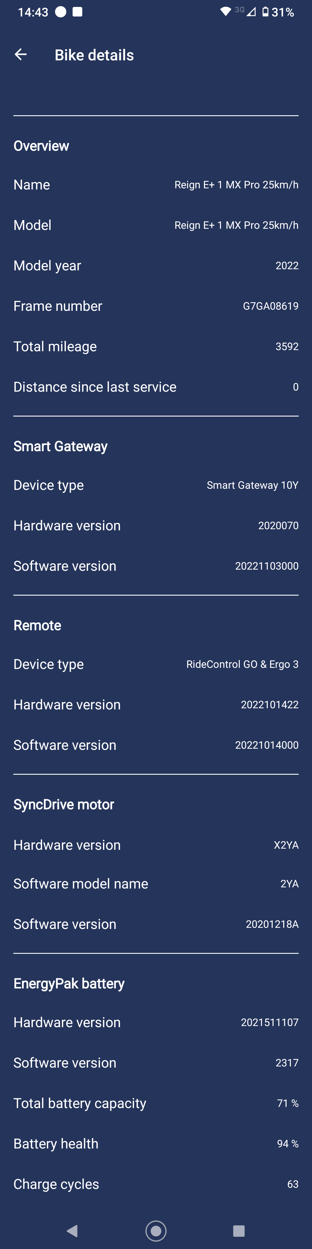

I'll give you my parameters, to see if you have the same ones, I'm still the same with the battery issue

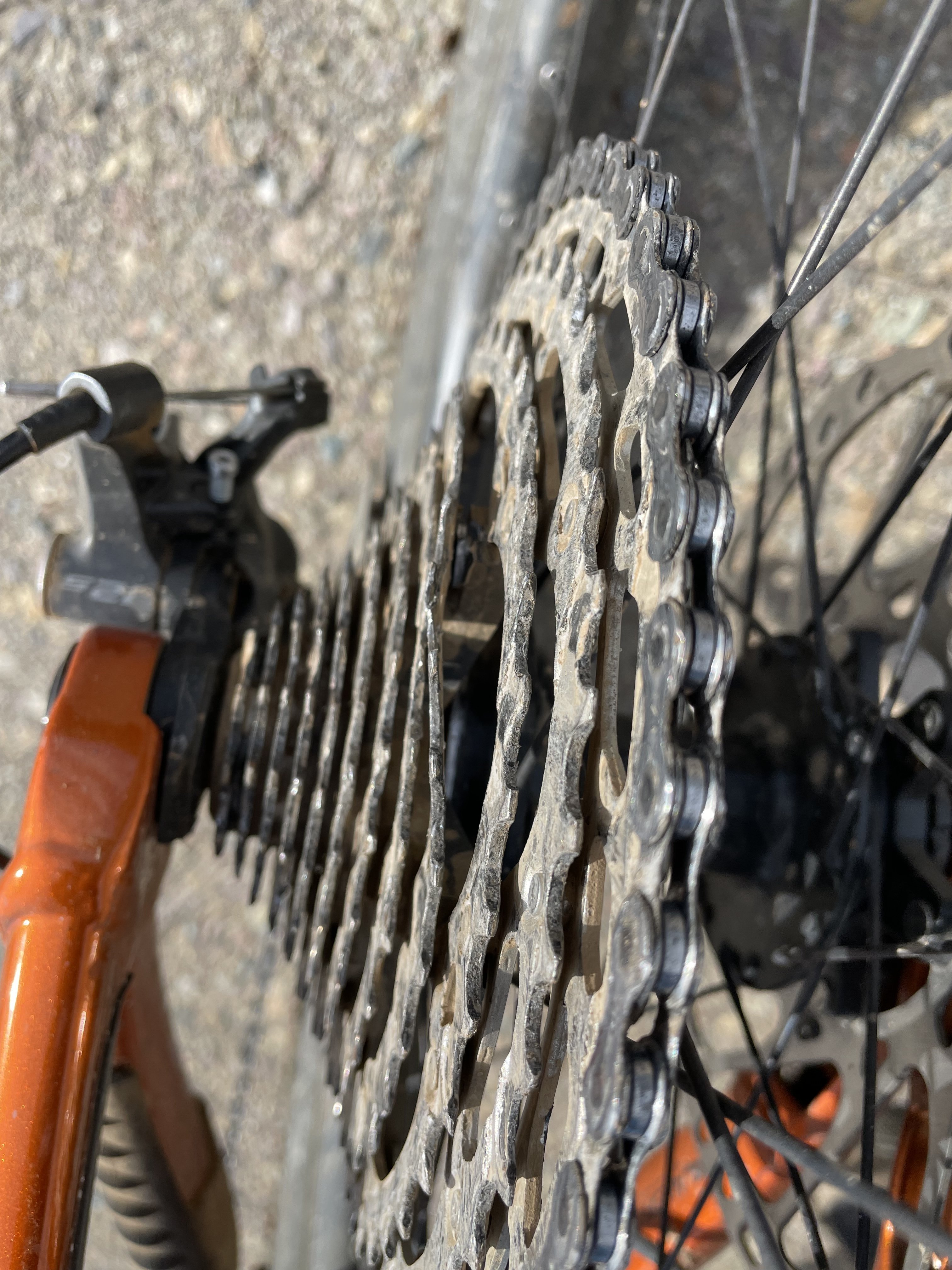

Hi there,
Can anyone help me out with this snap ring on the drive side BB? It’s obviously bent and needs replacing as it’s eating up the seal but I can’t work out what it even is supposed to do? The notch it sits in would have it not touching anything other than the crank arm? Is anyone able to take a pic of this area for me, or a parts diagram?
Thank you,
Alex

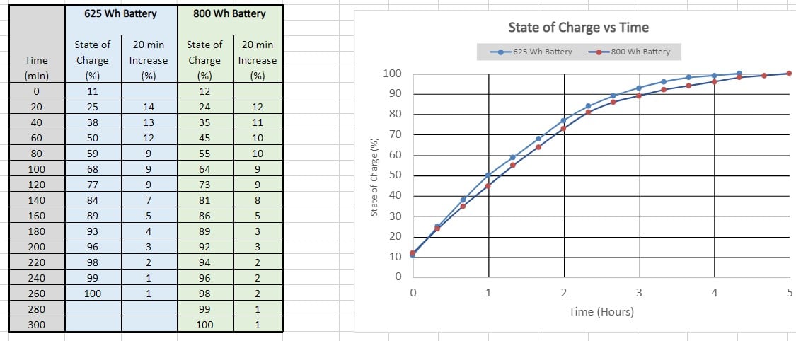

I was curious how the battery charged over time so for a 625 Wh battery and a 800 Wh battery I took charge readings every 20 min. Both batteries were reading just above 10% before I started to charge.
From the readings it looks like the charge rate gradually decreases with time until its just a trickle at the end.
For both batteries the charge increased just 4% in the last hour (2%+1%+1%). Compaired to the first hour where the charge increased 39% (625 Wh battery) and 33% (800 Wh battery).
I also charged the 625Wh off the bike and it took the same time as on the bike.
Chuggz
Dec 13, 2019
104
83
I do believe the later of the charge cycle is the bms balancing the cells, that can take some time

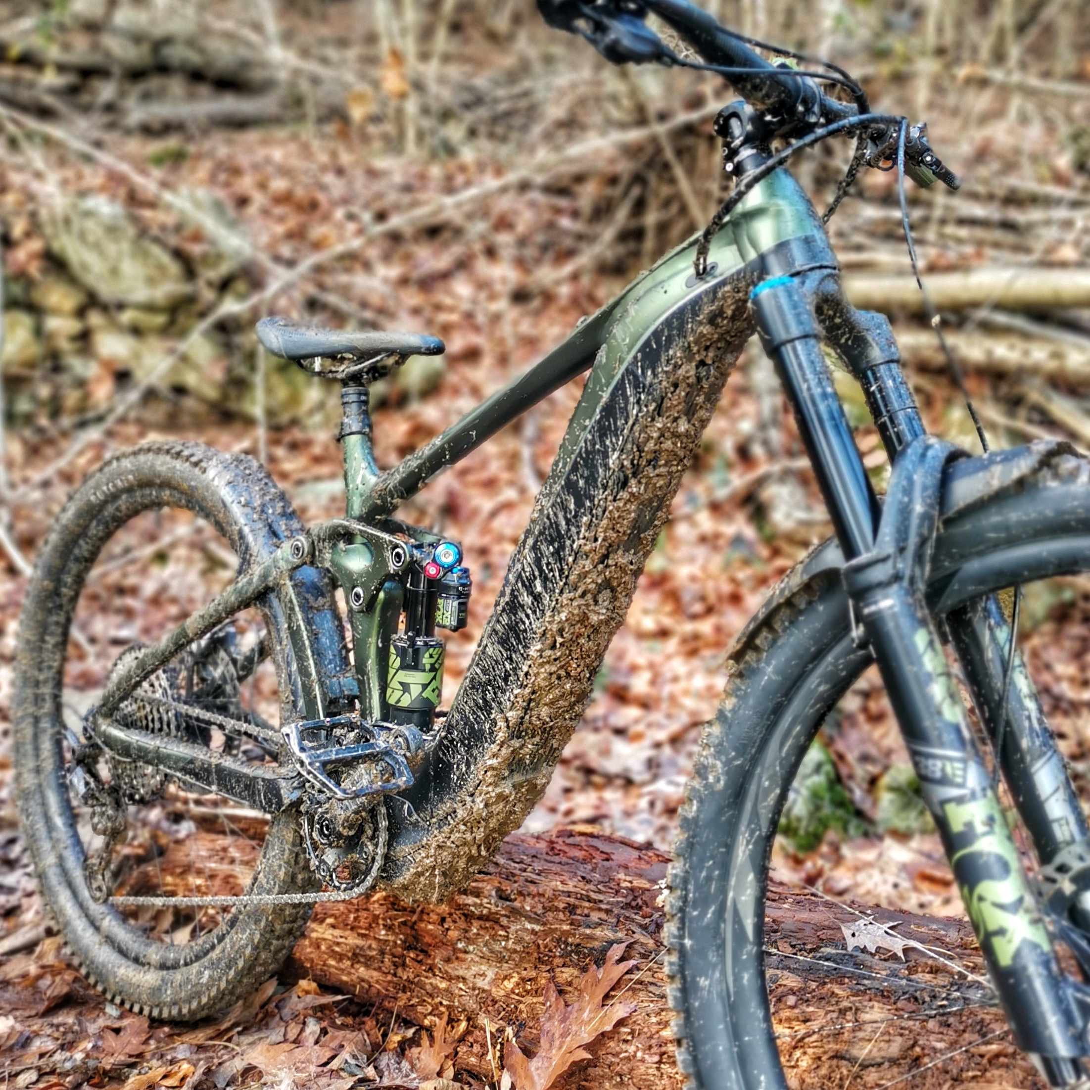

Greetings from Finale Ligure 👋
Some rain yesterday made the ride quite interesting 😁
Luckily I've upgraded to the Fox XL Mud Guard on the Front and it does it's job incredibly well. Suspension was serviced by Fox just recently, and now the bike feels so much better again.

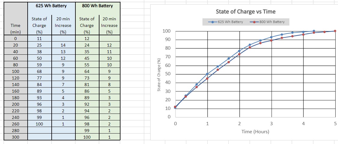

After the October firmware update, my charge rates are not at all like these figures!
More than double I'd estimate. My battery appears to only trickle charge!
Example: I put my bike on charge this morning at 10am with 15% charge, unplugged at 17h40 (7h40 on charge) and the battery is at 74% charge.
I have 2 smart chargers and both give similar charge times for on-bike charging, so, not a charger issue!
I haven't tried charging the battery off the bike yet!
Are there other users apart from vte.ktm who are experiencing these charging issues?

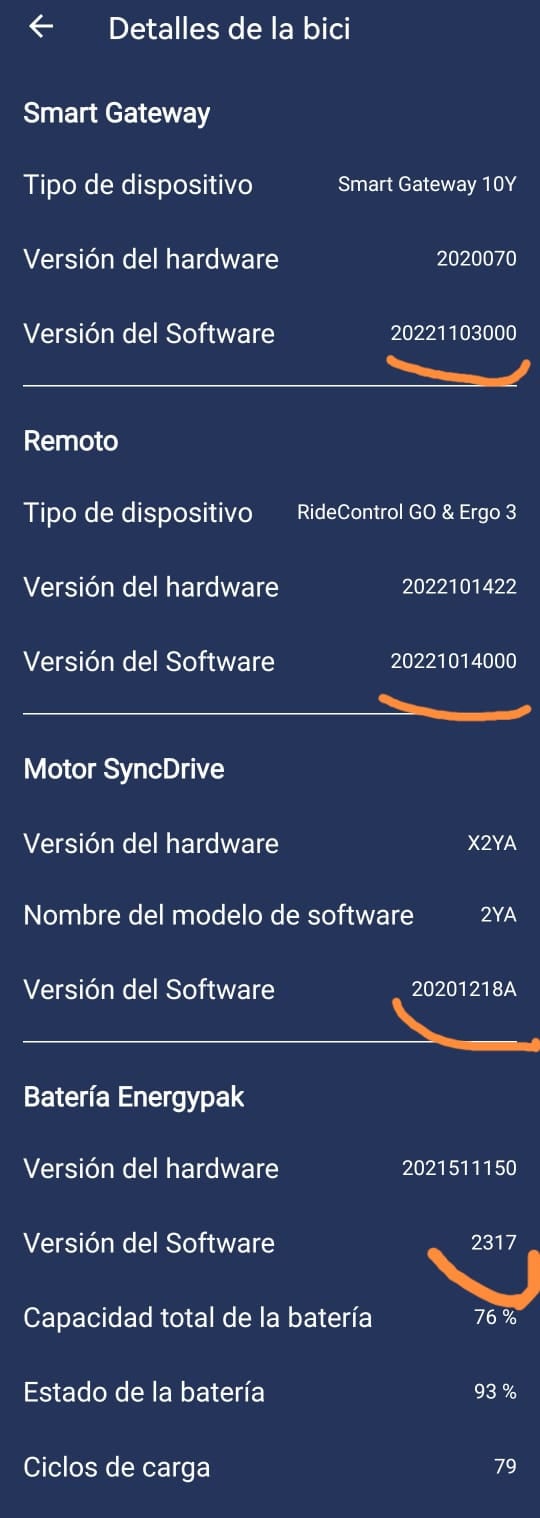

vte.ktm
Oct 30, 2021
46
51
Spain
I have identical software releases and versions as you, on-bike charging is very slow. Don't know whether to take the bike back or wait for new firmware release?
I'm still waiting for an update, for now, I charge it twice, first once all night, it stays at 76%, I disconnect the charger and reconnect it, I wait a couple of hours and it's already at 100%, but I have to do it twice
