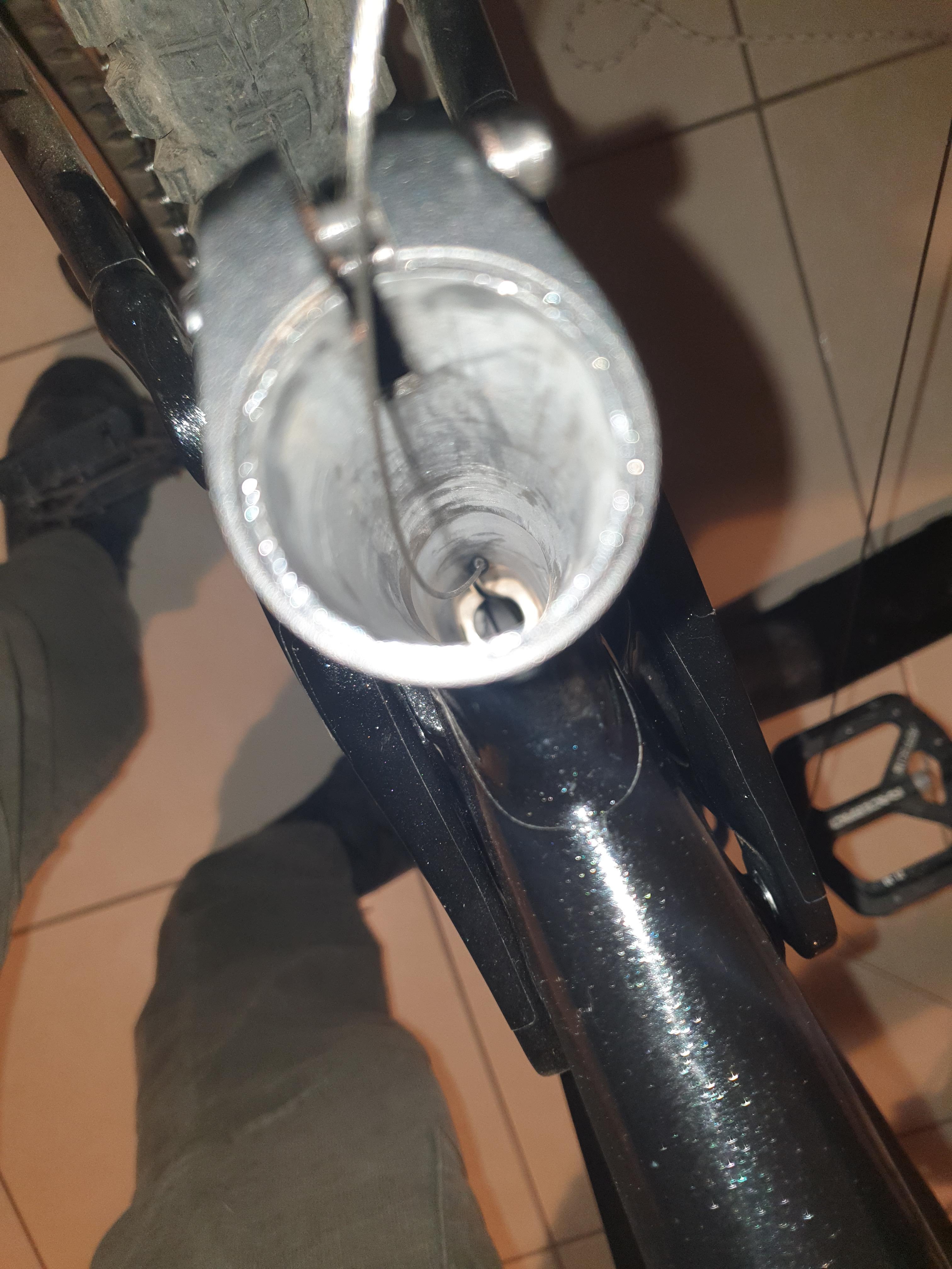

Any of you guys dealing with seat post creaks? Mines been a pain since new, I’m constantly greasing the thing?
I’ve tried the rails the seat it self the collar I’m over it?
Mine does as well, bought some proper assembly grease the other day and will let you know if it helps.
Cheers mate!
I have tried automotive grease,
I tried slick honey,
I grabbed some really thick rubber grease yesterday it’s almost like a paste,
I’m hoping this works better

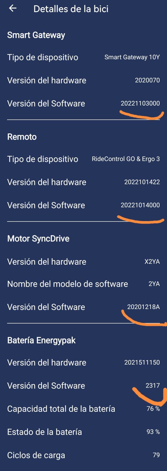

Hello, good evening, does anyone have problems charging the battery placed on the ebike...? For a couple of months if I charge the battery put in the ebike the charge takes 7 hours and when you check the charge it is at approximately 70%, you disconnect and reconnect and finish charging 4/5 hours later but without turning off the charger
On the contrary, with the battery outside, the charge is done in approximately 5 hours, everything working normally... Is something similar happening to someone...?

A pal had a similar issue, would not fully charge in the bike, but full charge when removed.

No, I don't see this behavior on my two 2022 bikes. I'm running the latest available firmware but can't tell you from the top of my head what version it is.
Have you claimed this failure qith your LBS or Giant already?

I have reported a breakdown in my shop but have also provided screenshots of reports from other people here in Spain having the same problem but here I was asking why based on what I read since the October update there are all kinds of problems with the batteries and their behavior, in fact since the charging issue failed me, the battery also behaves differently, now it takes longer to drop below 100% when I drive with it, since an update in October everything has changed. ..

.... the battery also behaves differently, now it takes longer to drop below 100% when I drive with it, since an update in October
Thats also my experience, but the total distance / altitude I'm getting from the battery remains the same. It just takes longer until the first two bars are gone.

I had this problem. The bike shop I bought it from raised a warranty issue with the charger and replaced the charger. It charged OK with the new charger but I will have to charge a few more times to make sure its OK.
Me está pasando exactamente lo mismo, y ha sido justo desde la última actualización, antes en 5 horas todo ok, ahora la dejas toda la noche, y miras y está al 70%, la vuelves a conectar, y a veces no se queda eternamente cargando, me refiero, con el display verde parpadeando, no se queda fijo, luego miro, y esta al 100%, hace cosas muy raras, imagino que deben de sacar alguna actualización para solucionarlo.
Por otra parte, y en beneficio, me da la sensación que la batería parece, que dure un poco mas.
Si tienes alguna nueva información por favor informa, que me tiene el tema un poco mosca.
un saludo.
The exact same thing is happening to me, and it has been just since the last update, before in 5 hours everything was ok, now you leave it overnight, and you look and it's at 70%, you reconnect it, and sometimes it doesn't stay charging forever , I mean, with the green display blinking, it doesn't stay fixed, then I look, and it's 100%, it does very strange things, I imagine they should release an update to fix it.
On the other hand, and for the benefit, it gives me the feeling that the battery seems to last a little longer.
If you have any new information please inform me, that the subject has a little fly for me.
a greeting.

THIS WEEK I HAVE COMMUNICATED THE PROBLEM TO MY STORE THAT THEY HAVE TALKED WITH GIANT, THEY HAVE CONTACTED ME TO TELL ME THAT GIANT IS AWARE OF THE PROBLEM AND THEY ARE WORKING ON IT TO SOLVE IT, THAT THEY WILL RELEASE AN UPDATE SOON THAT WILL SOLVE THE PROBLEM, THAT WE ARE ATTENTION TO THE SUBJECT THEY WILL REMOVE IT AS SOON AS POSSIBLE. THIS IS THE LAST INFORMATION I HAVE.

I have the same issue since the October firmware release - battery 650wh takes about 9-10 hours to charge and the smartcharger green LED blinks continuously even when the battery is at 100% - Lets hope that Giant engineers have the idea to test the next firmware release before forcing it on their clients via that shambolic "RideControl" app!
