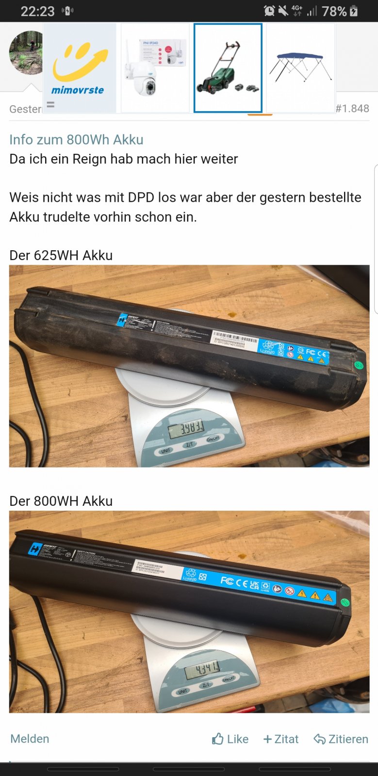

Well I've done a few rides with the 800wh now. It fitted straight in to my Reign E+2 size medium (2022). I tried to fit it into my wife's Liv intrigue e+3 (2020 model) size small, but it wouldn't fit although the
The 800 should fit to these bikes the top list 2022 without adaptations.
The list in the chart only fits with an extra bought different battery cover and some also with a software update.
I also read somewhere that some S frames don't fit.

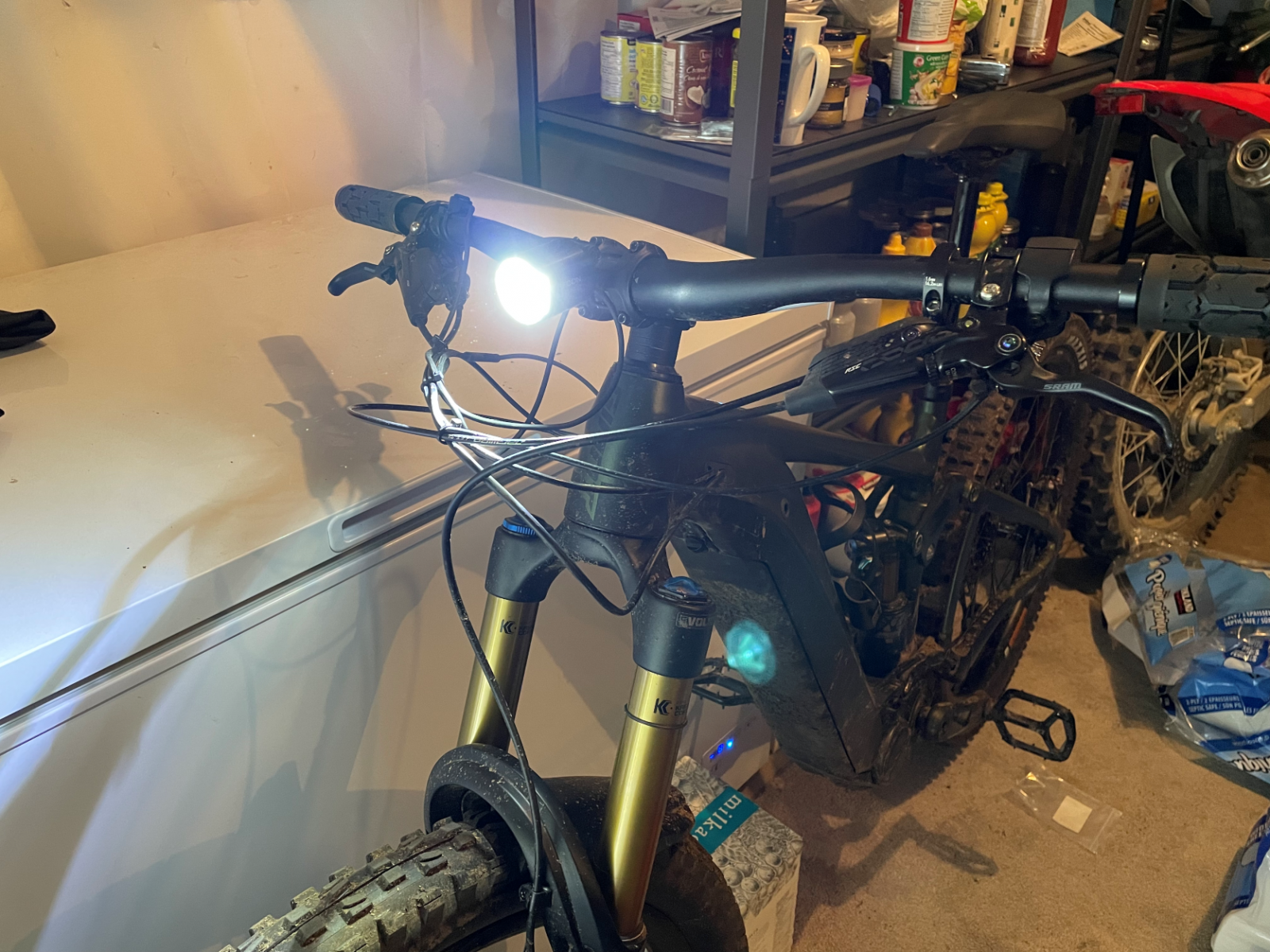

Picked up the Giant e-bike light (Recon E HL 1000). Runs off the internal battery, pretty cool! It's this one: Recon E HL 1000 | Giant Bicycles Canada
Only silly thing is it doesn't have a dedicated off switch, so I mapped it to the middle hand control button (normally for walk assist, but I never use it). Seems you can change the button mapping in the app.
Looking forward to testing it out soon, as well as a helmet-mounted light I grabbed.
Did you fit the light yourself, how easy is the cable routing and where in the bike is the connector, thinking about getting one of thease for the bike and moving my magicshine 3500 to my helmet :)

  • Battery: 625Wh (3983g / 8,78 lb), 800Wh(4341g / 9,57 lb)

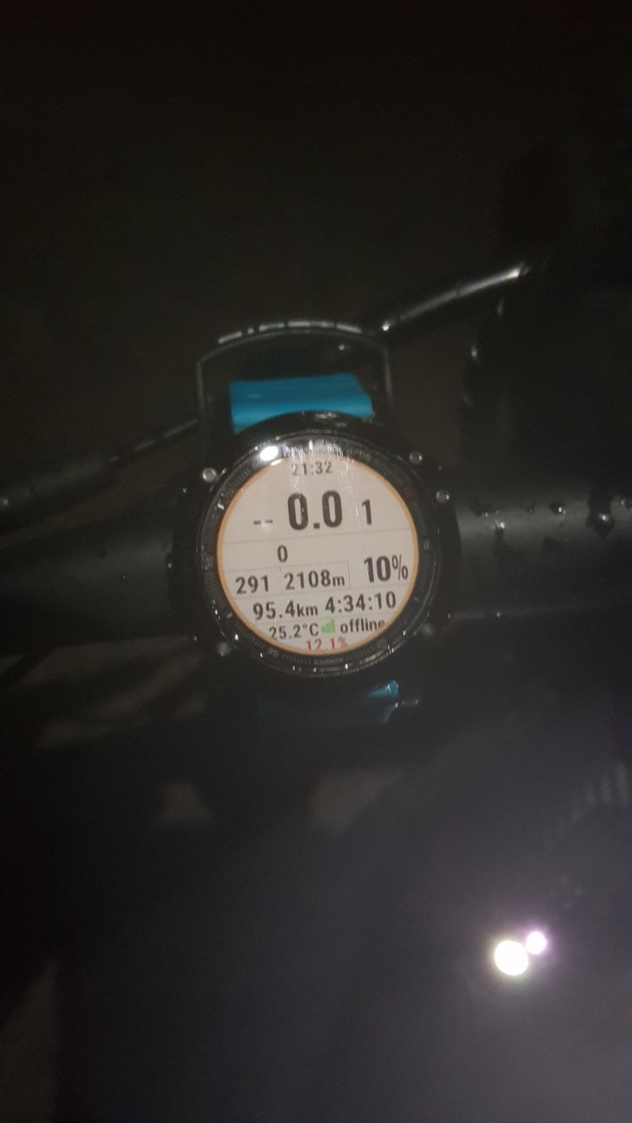

  • Longest Rides:

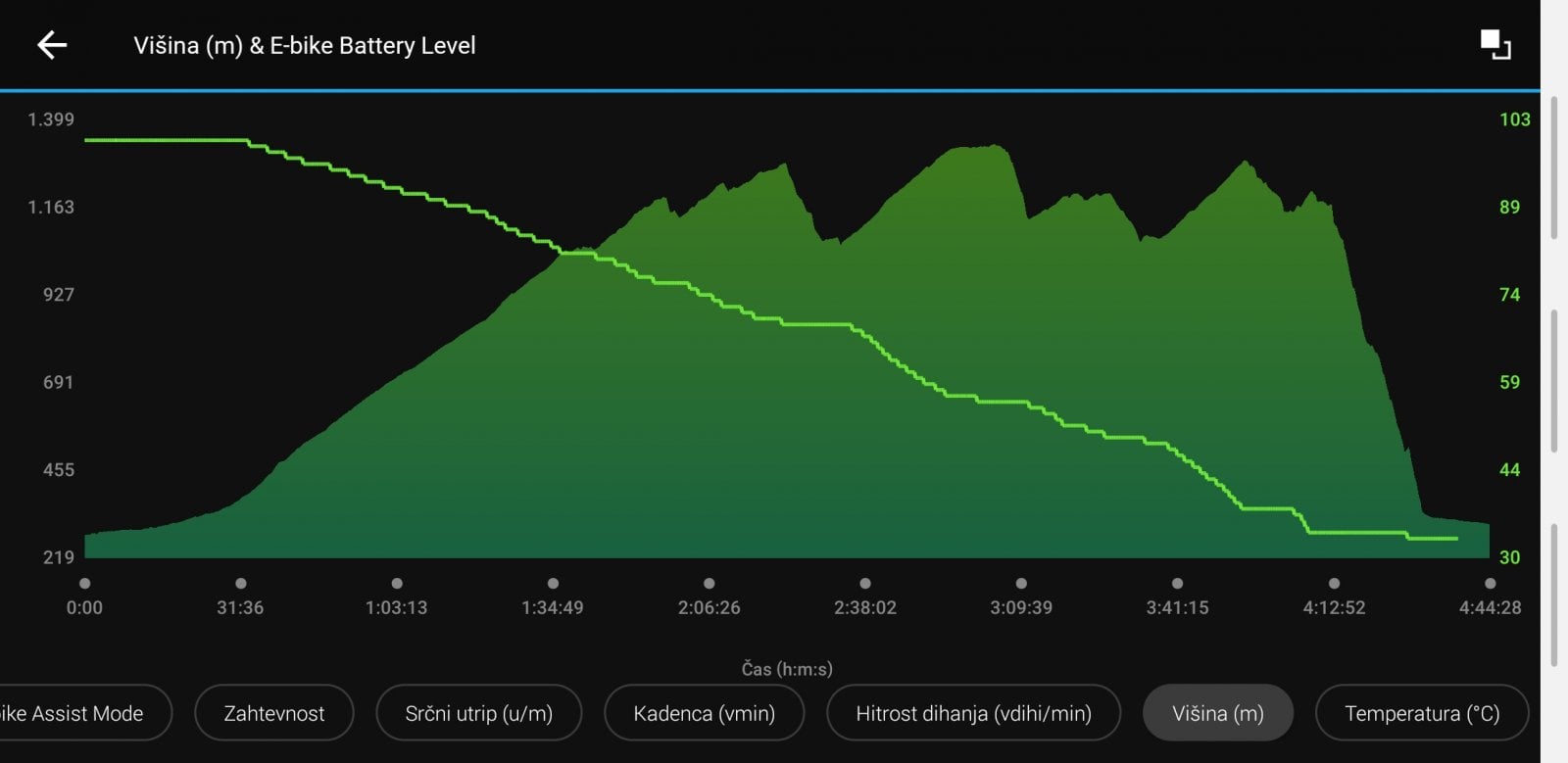

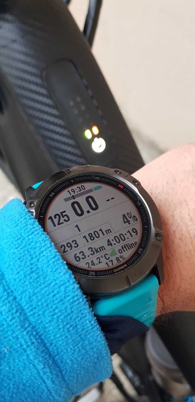

  • ( 625Wh Battery; 63,5km/39,5mi; 1745m/5725ft d+; 4h30m; 6,1 % Average Incline )
  • ( 800Wh Battery; 90,4km / 56,2mi; 2108m/6916ft d+; 4h34min; 6,2 % Average Incline )

Overall Ride Impresions are that the bike is extremely stable at higher speed(feels planted - first what came to my mind was - like a Tank with suspension), climbs up anything because of the so smoooth power delivery and almost 78° seat tube angle, If you go smaller frame also very maneuverable(you just wonder where did all the weight go). The E-tuned Fox suspension package is incredibly plush and in contrast very supportive midtravel, I think the E-Tune is a must for ebikes. Till this time I didn't have any serious problems with the motor, battery, charger, frame, suspension...so I think I can say it's been reliable for me. Would I buy it again, Yes, what you get is really a lot of bang for buck.
View attachment 96683 View attachment 96686 View attachment 96687 View attachment 96688
View attachment 96692 View attachment 96693
View attachment 96702 View attachment 96703
View attachment 96701 View attachment 96704

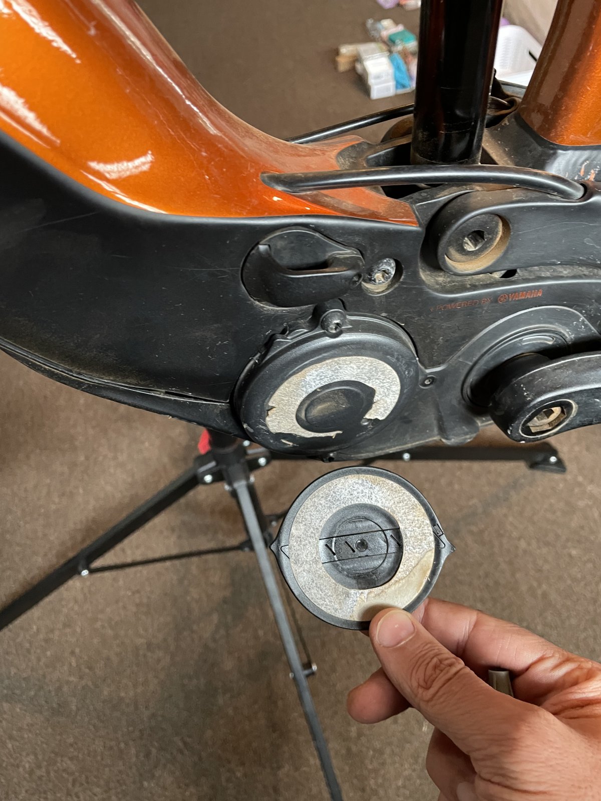

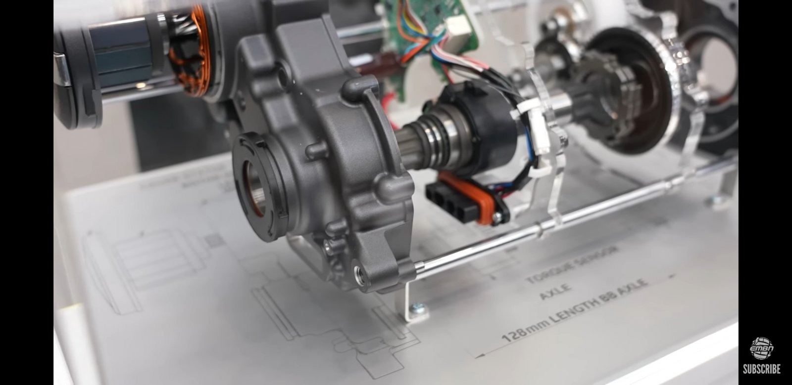

If anyone didn't see it yet also attaching some snaps of the PW-X 3 guts...
View attachment 96724 View attachment 96725

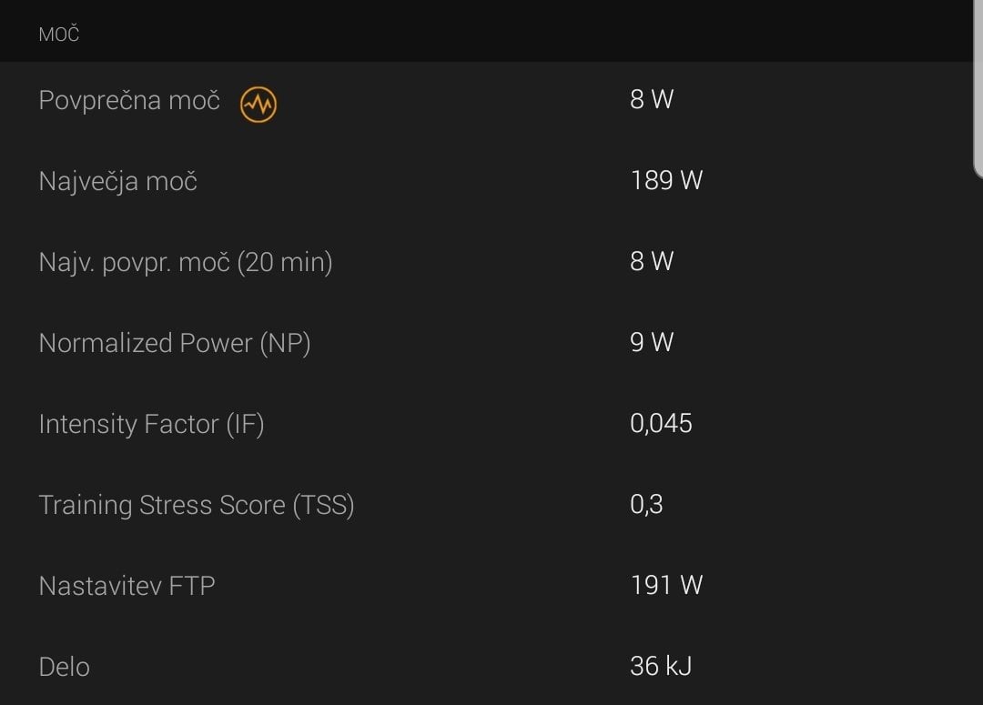

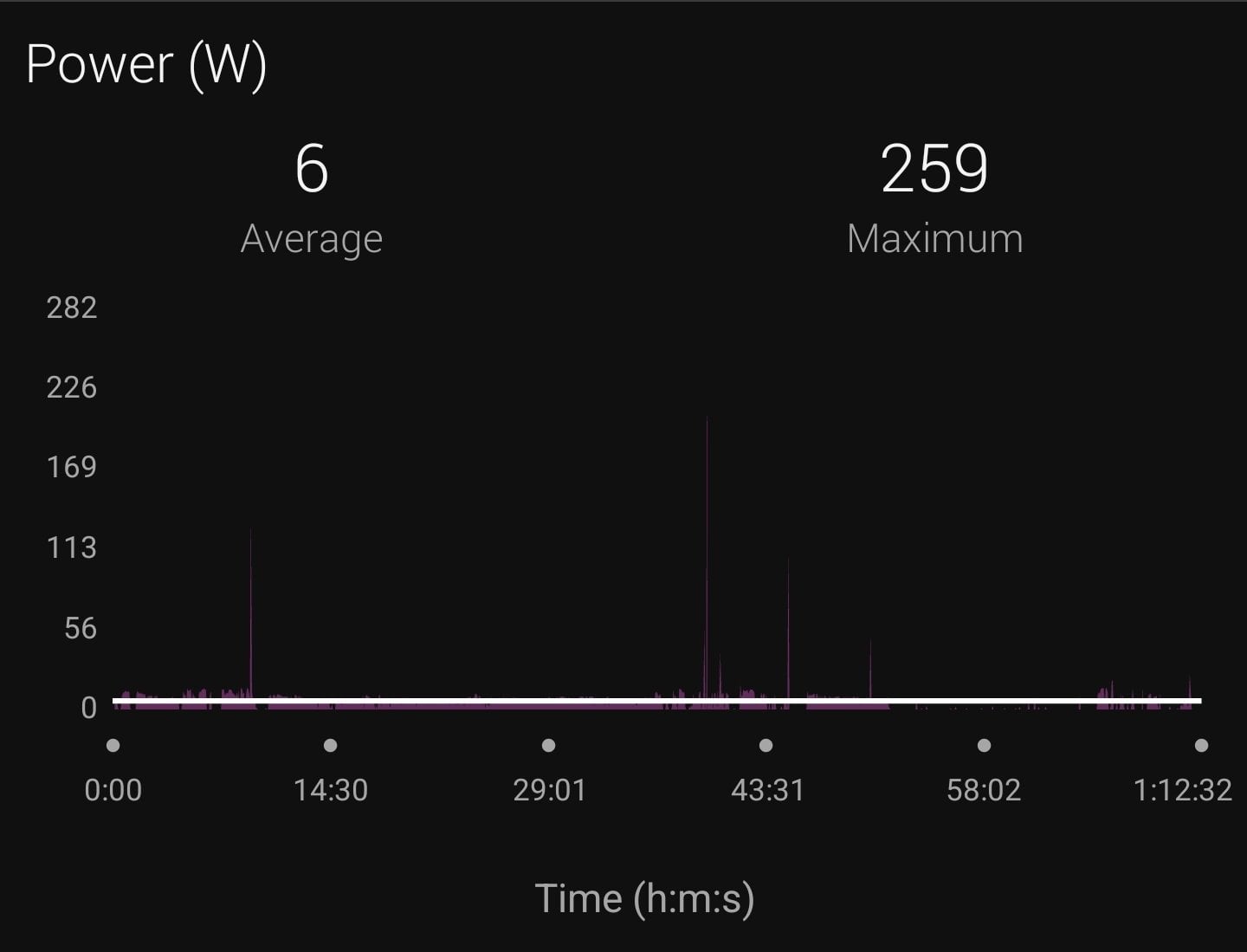

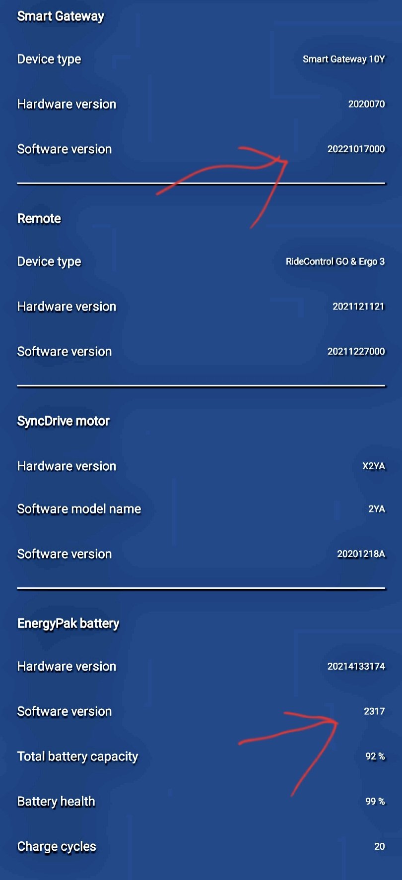

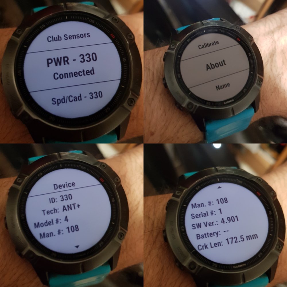

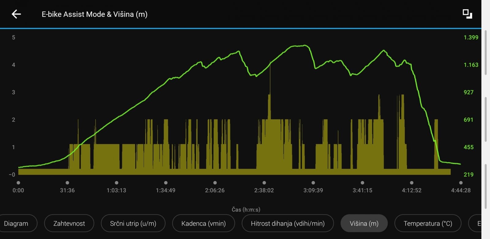

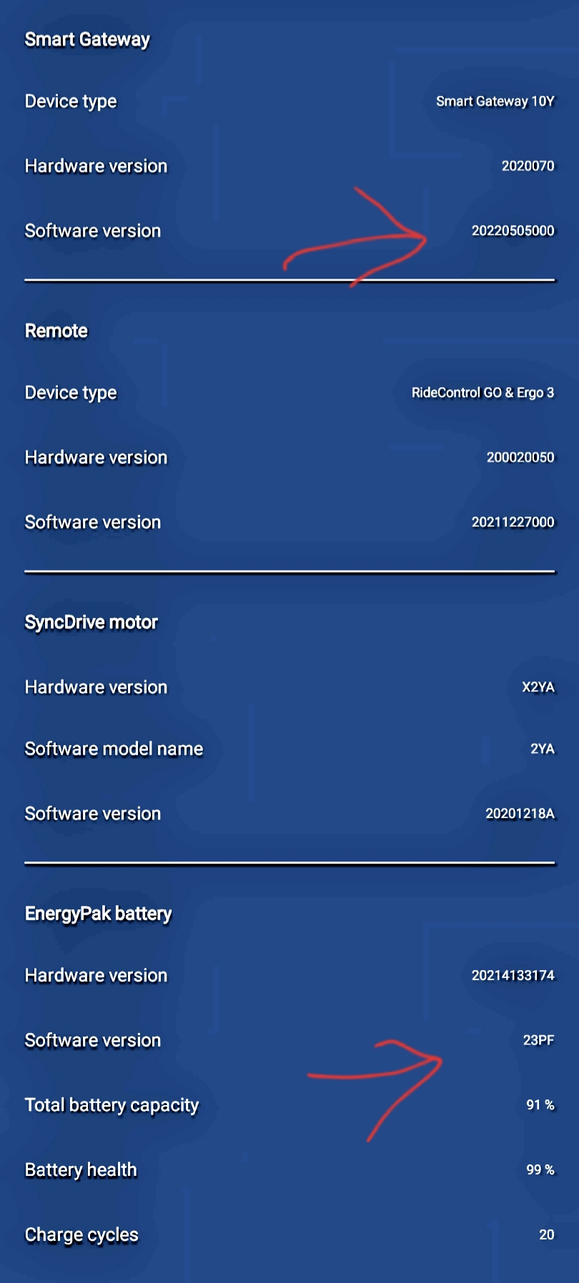

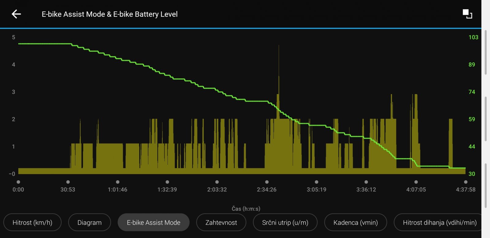

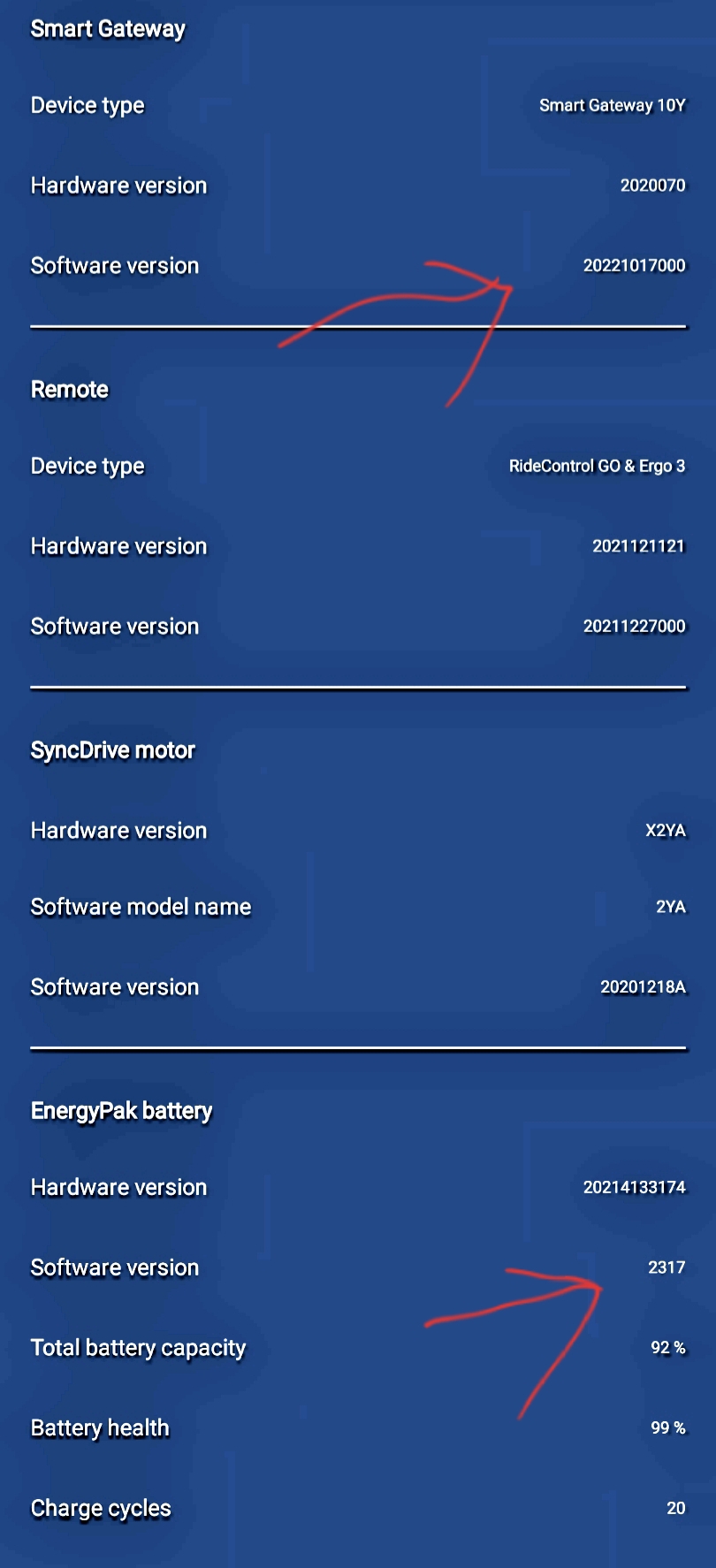

Hey guys did anyone install a Smart Gateway update via the App in the last days?
Well I got my bike back from the first service obligatory for warranty and shock rebuild and before the first ride I got a prompt from the App and did the update.
Didn't notice anything wrong with the motor everything hardware wise is working like it should etc.
It was a suprise when I opened my Garmin stats where the Power readings were extremely extremely low, average power being at 8W where usually it was around 110ish W...
I also noticed a slightly increased battery consumption, although that could have been to slippery wet ground, a lot of leaves, and to high tire pressure on a worn tire...needs more testing can't confirm it in one ride.
The other thing I noticed was the battery charging not being normal...from 43% to 93% it took 5h and it was still charging. Also after this one ride(that was an easy leisure ride) the battery health decreased by 1%...which is really weird because I started with 97% and finished with 43% so in the ballpark for lithium ion batteries and didn't push the system to its limits.

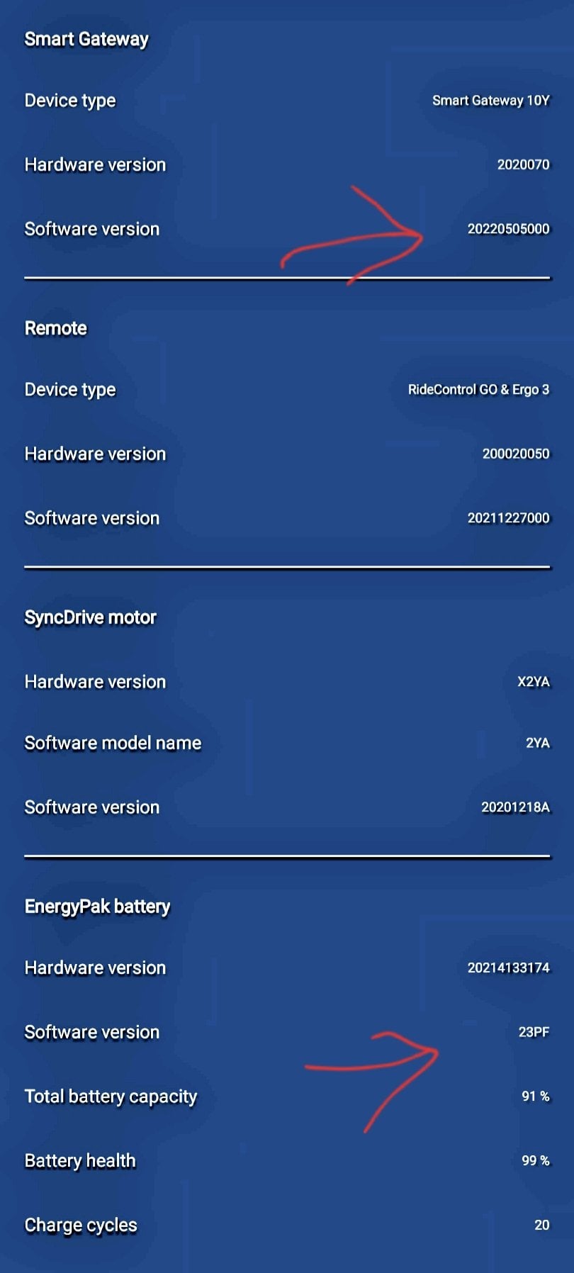

So the new Smart Gateway software is "20221017000" obviously dated 17Okt2022 vs the previous that was 20220505000 so 5May2022.
The battery 625Wh software also got updated from the previous version "23PF" to the new version "2317"
I tried repairing the sensors and using different ebike Garmin apps but the result was always the same.
Has anyone experienced something similar?
I hope it's just a glitch and that Giant didn't fuck up with this update and I need to wait for a fix...that would be annoying. ✌⚡
Heems
May 4, 2022
26
147
California, US
I applied the update a couple days ago. But I have not been out on a ride since so I can’t comment on the details you posted. The update itself went smoothly and all seems ok from a quick ride around the block. Have a proper ride coming up this weekend. Will report if I notice anything.
emtbeast
Jan 10, 2022
309
352
Slovenia
I updated and also noticed the Garmin power readings were very low.
The battery use seems to have improved slightly on mine though.
I was digging deeper today...trying different things, like disconnecting sensors, deleting sensors, different sensor combos, deleting and reinstalling Garmin apps just to rule out things. No success.
Didn't have time to try it with the 800Wh battery, tomorrow is another test ride on my usual test trail.
When you have the bike and Garmin connected there is an "about" section under the Power sensor in the Garmin device where you can see different info about it. I didn't notice this before as it was not in my interest.
What suprised me is that the crank length stated there was wrong(172,5mm). Could that be the issue for all the wrong readings...I am not a roadie so never had to work with power sensors but I would think it's important for accurate readings, or?
There are also options for wheel circumference in the Power sensor settings and in the Cadence/speed sensor settings...didn't try to set anything yet. But there is a manual and an auto option.

I have also installed the update.
What I noticed is that when I switch off the bike and want to switch it on again within 5 seconds, only the display flashes and goes out. The second attempt has always worked so far.
I don't have a Garmin but a Sigma Rox 11.1, but since the update the cadence is not displayed. reconnecting the sensor didn't help either.

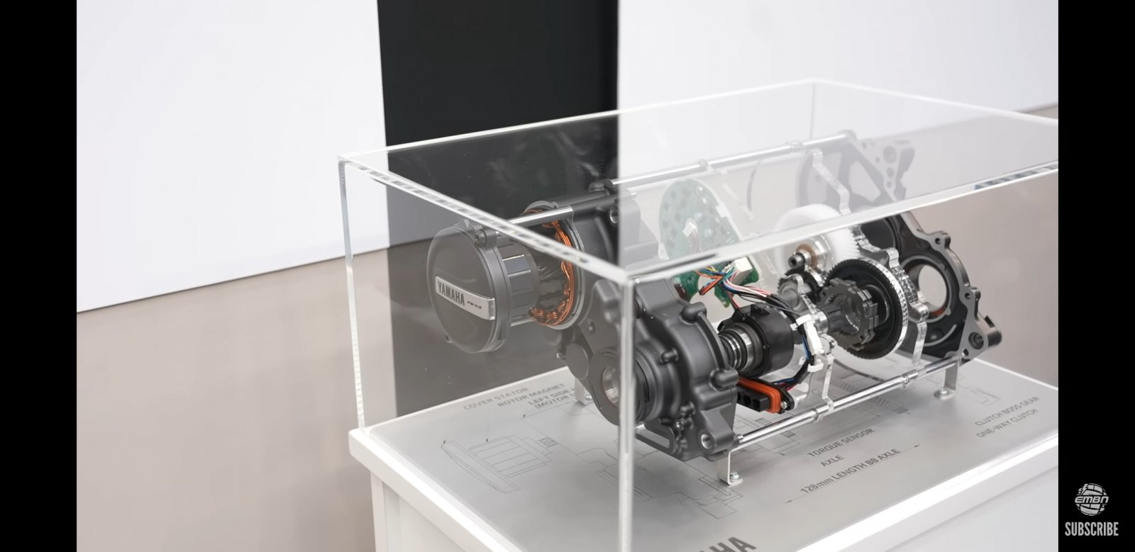

I'm a little disappointed with the new Yamaha engine because the older one was much quieter
This sound is as the shop told you characteristic for Yamaha motors, and has been talked about a lot in the thread...if the shop changed your motor they did you a favor as the didn't need to. As others have mentioned this sound happens when there is almost no or zero pressure on the pedals, so flat terrain low speed an low gearing(big cassette cogs) which let's be honest no one really ever uses...⚡
Interesting didn't have any issues like that...but could be related to the update.
This was actually my biggest fear when deciding for the Giant...their software r&d seems pretty average and so a lot of sh... can happen.
Megavolt
Jul 21, 2022
35
38
Moscow Russia
Hi,on my reign 1 happens the same thing, the brightness setting of the indicator in the frame is not fixed, always lit in night mode as I did not change it with the application!

No issues here with the latest firmware update. Never had any issues. Must just be lucky.
x2 no issues with latest update.
Also never had any single issue with the bike or problem with the motor, couldn't be more reliable and still on warranty for one more year anyway.

We are not saying that this is a big problem))) rather a bug, but it is stressful, what if something else will be more serious when we go to ride far from home))))
The bike is great, no one is arguing.
