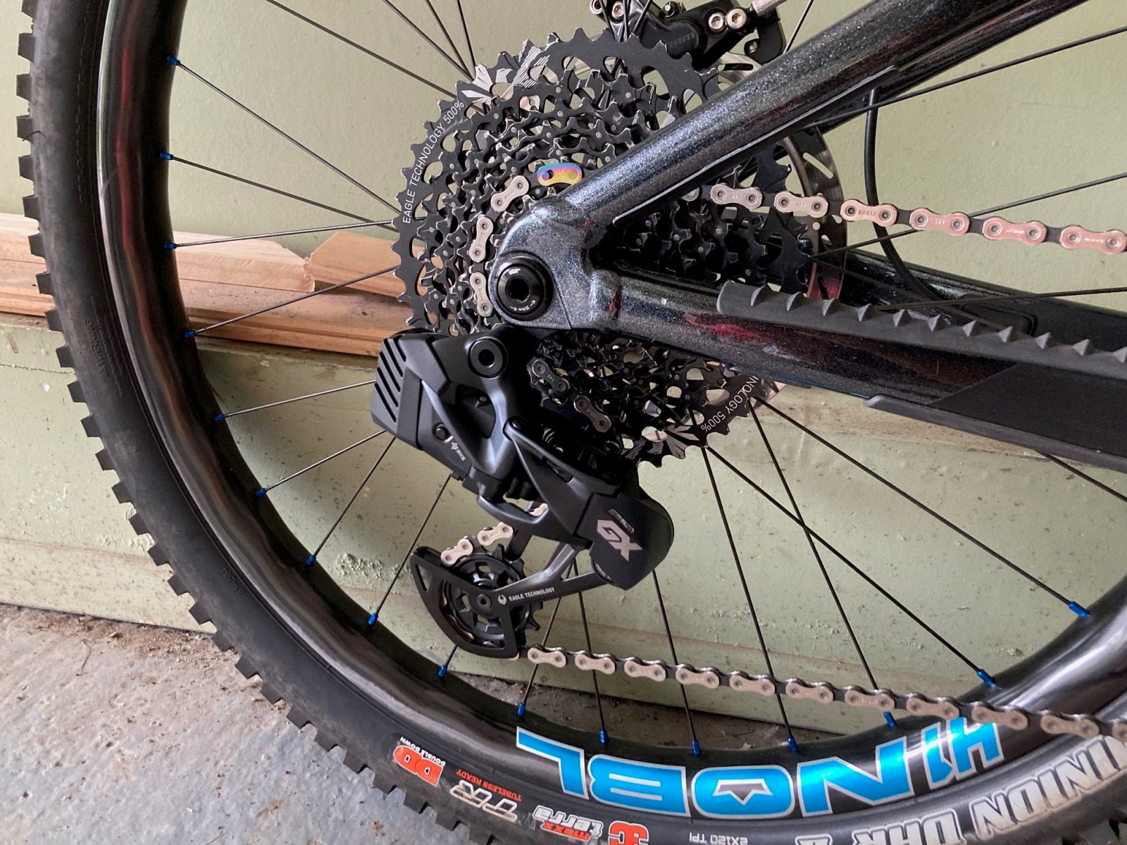

Recently swapped my regular cable GX RD for a GX AXS as SRAM have them on sale right now.
You really have to try it to understand, shifting is so fast and precise. Crisp shifting all the time and the shifter is actually nice to use, love the clicking on the paddle.
Only major issue with it is the fact that clutch is soft as hell, my bike is not as silent as before which is kind of dissapointing.
I also saw that the cable was eating the frame where the cable was exiting the downtube, I would put additional protection there if I would run a cable again.
After trying Sram mechanical and AXS after years of Shimano, I was disappointed with the clutch strength on the Sram stuff also.

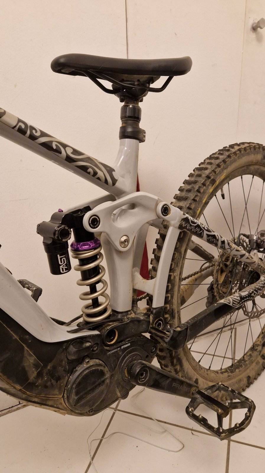

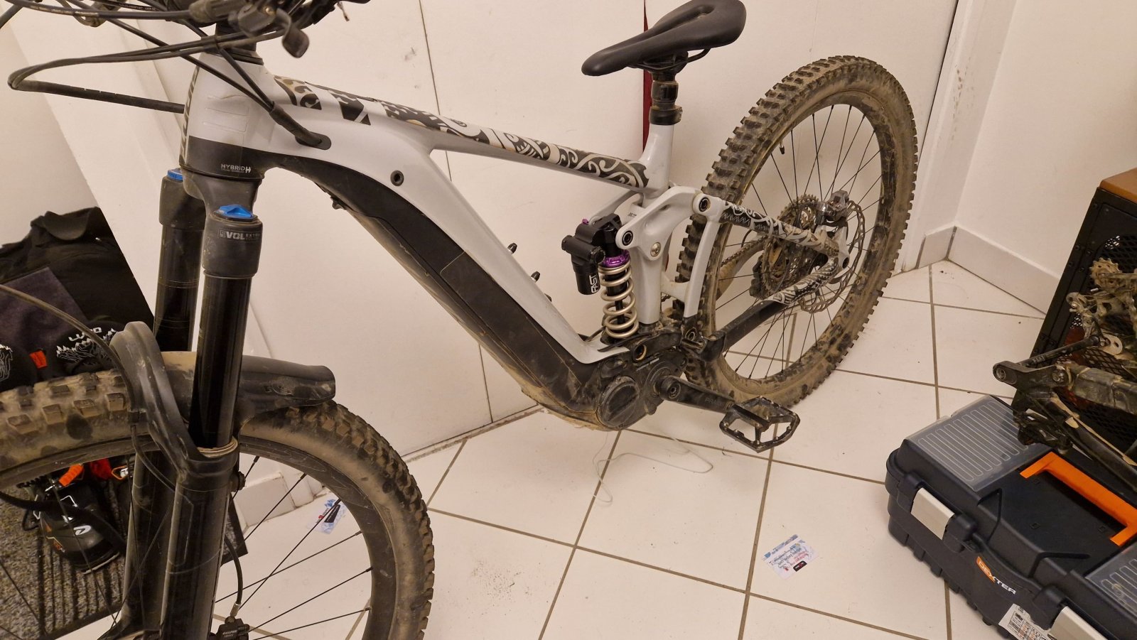

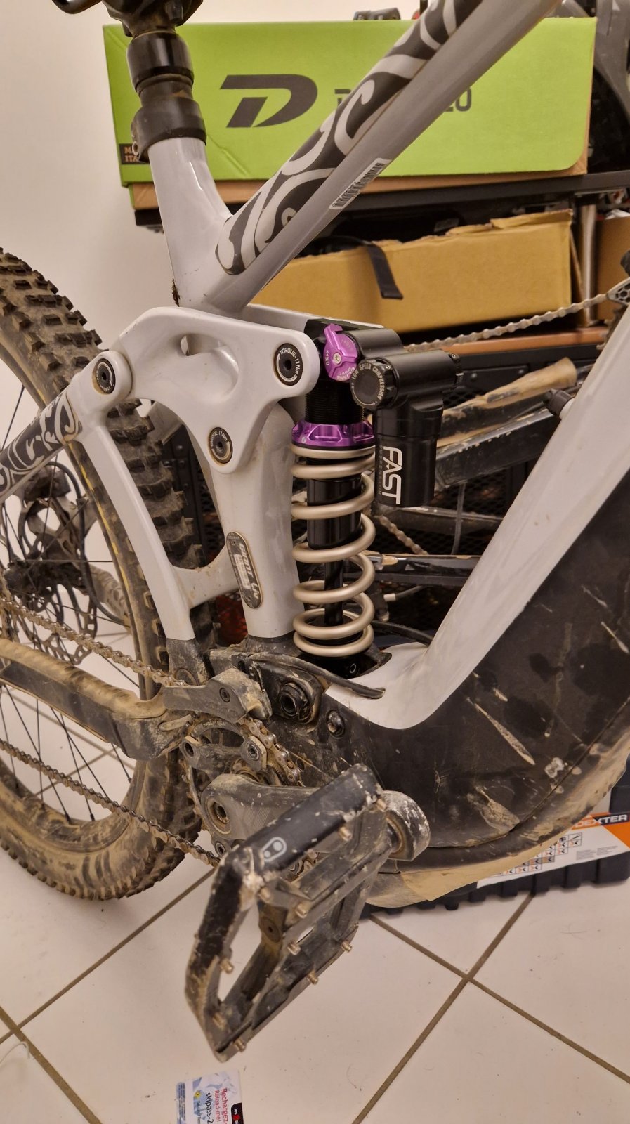

Small run down of my issues with the bike (Reign E+3) after around 1500km. Not riding it all that often in good weather, I am more on the bio bike.
- Battery rattling in the down tube. The lock seems to be loose. Sometimes it works, sometimes it rattles. Stuffed some moto foam besides the battery for now.
- Seatpost basically creaking after every other ride because of dirt getting into the seat tube.
- Front Hub (the cheap mt200). The nut to set the play for the shimano conical bearing was coming loose constantly. Front wheel has play left to right A LOT. Fixed with locktite for now.
- Base MT420 brakes changed for XT brakes with metallic pads and XTR rotors.. Way better braking.
- Constantly getting small stones down into the ditch where the shock is mounted on the downtube. Wasnt so much of a problem with the DPS shock. Got a Float X2 Perf. Elite from a guy, who has the E+1. Way harder to get those stones out from under that big reservoir.
Besides the low clearance under motor cover that I keep bashing constantly on stuff I has been a great descending bike. The only other concern I have is the big chainring up front. I would love to change that to a 32 or even 30 from the 36. Some steep uphills are pretty challenging with the 36T when running Eco a lot. Too often I have to increase supportmode. The motor even feels more punchy on a higher cadence, so the 36T just does not make that much sense to me at all.
Checked the 4 bolts on the lower battery attachment point(where the connectors are)? Mine were loose. Also the two safety bolts holding the upper locking mechanism that needs to be set spot on, not to far out or to far in.
sprousaTM
Mar 4, 2022
36
43
I have only checked on top where the lock is. As you said. When the locking mechanism is not spot on, I can move the battery quite a bit left to right. On the lower end at the connector it seems fine. The mechanism on top itself is bolted on tight. I think it is just the lock itself. If you click the battery in place and let the locking mechanism pull the battery into the frame it worked in the beginning. Now I need to push the battery myself in all the way and find the sweet spot with the lock to keep it in place tight. Last ride it seemed to work.
I ditched the X2 yesterday and ordered the new SD Coil Ultimate with a 450 and 500lbs spring to test. While riding my pals thought the sag was a little bit too much. And well, they were right. The X2 lost around 40 psi since I last pumped it up. Went down to 170psi from 210-220. Came down to 50% sag almost :D So many parts are either a love or hate relationship. And I tend to dislike Fox damper more and more.
Ok, did you try moving the locking mechanism up or down to get it perfectly right. Mine was of to the right a bit so I tried to fix that.
While I got the right/left all right, the fore/aft or up/down was off even when it looked ok at first.
The catch was that I was doing this with the bike upside down so the battery was leaning on to the lock.
I then did the alignment with the bike standing normal, a bit tedious but I got it perfect that way as the battery was like it is when riding.
Of course it could be a fault on your locking mechanism...hope u get it fixed.✌
