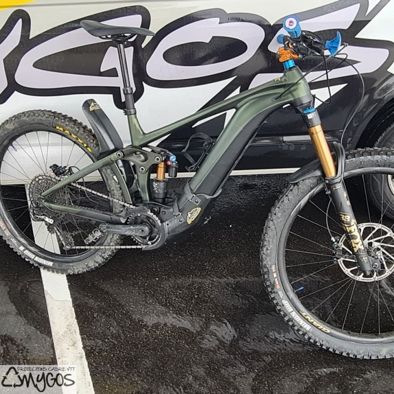

carter moteur pour Reign E+ 2022 alu , 29p -27,5 p - Amygos this french company does a solid bash guard and chain ring protector all in one
