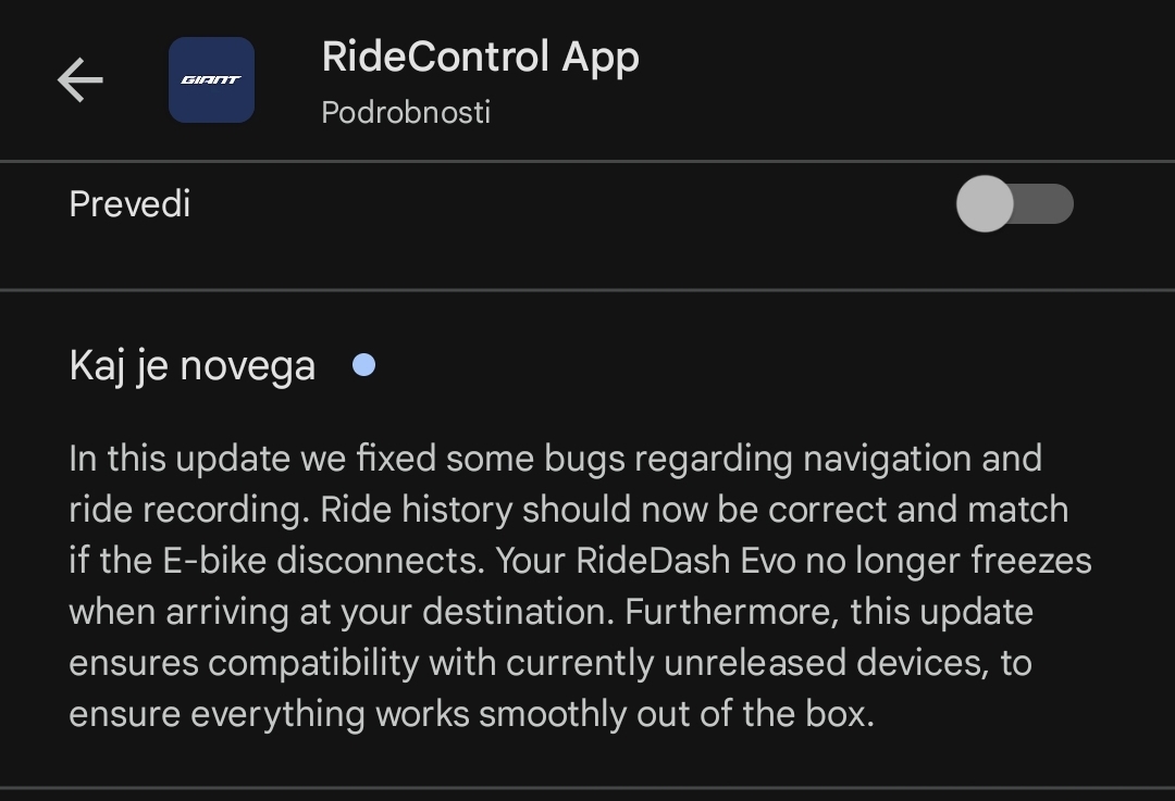

New firmware update for our smart gateway 😱
Did it but don't know what's new with it ... See you tomorrow 🙏😅

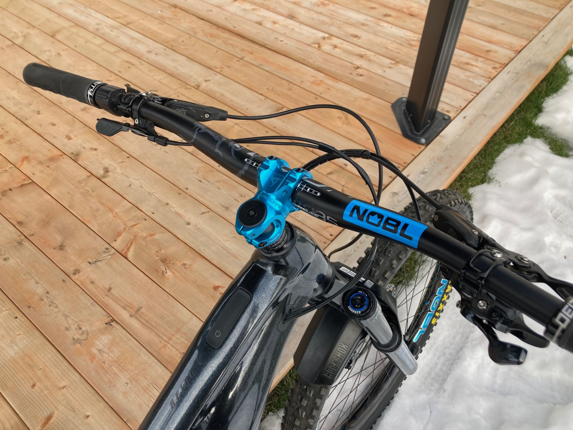

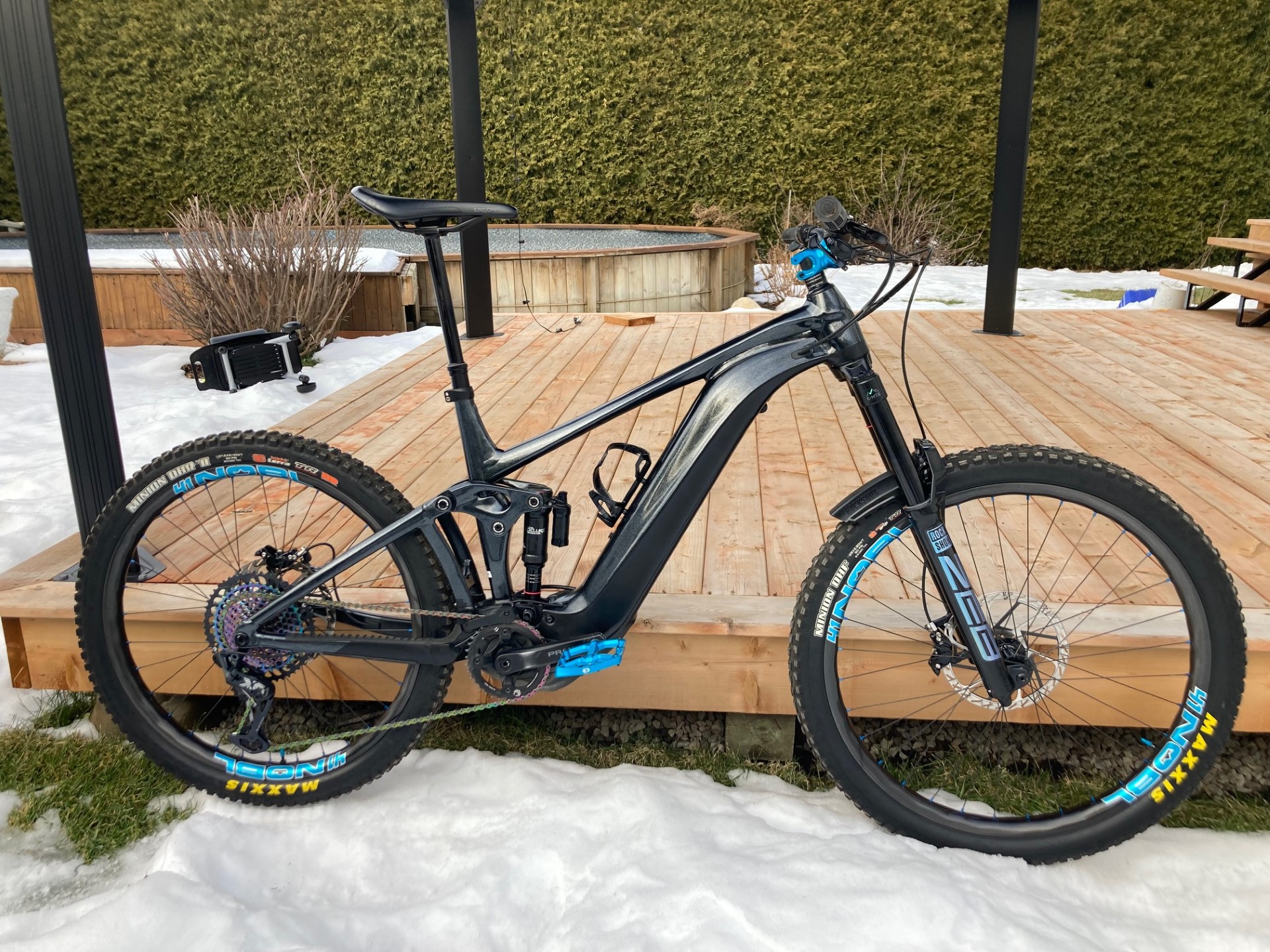

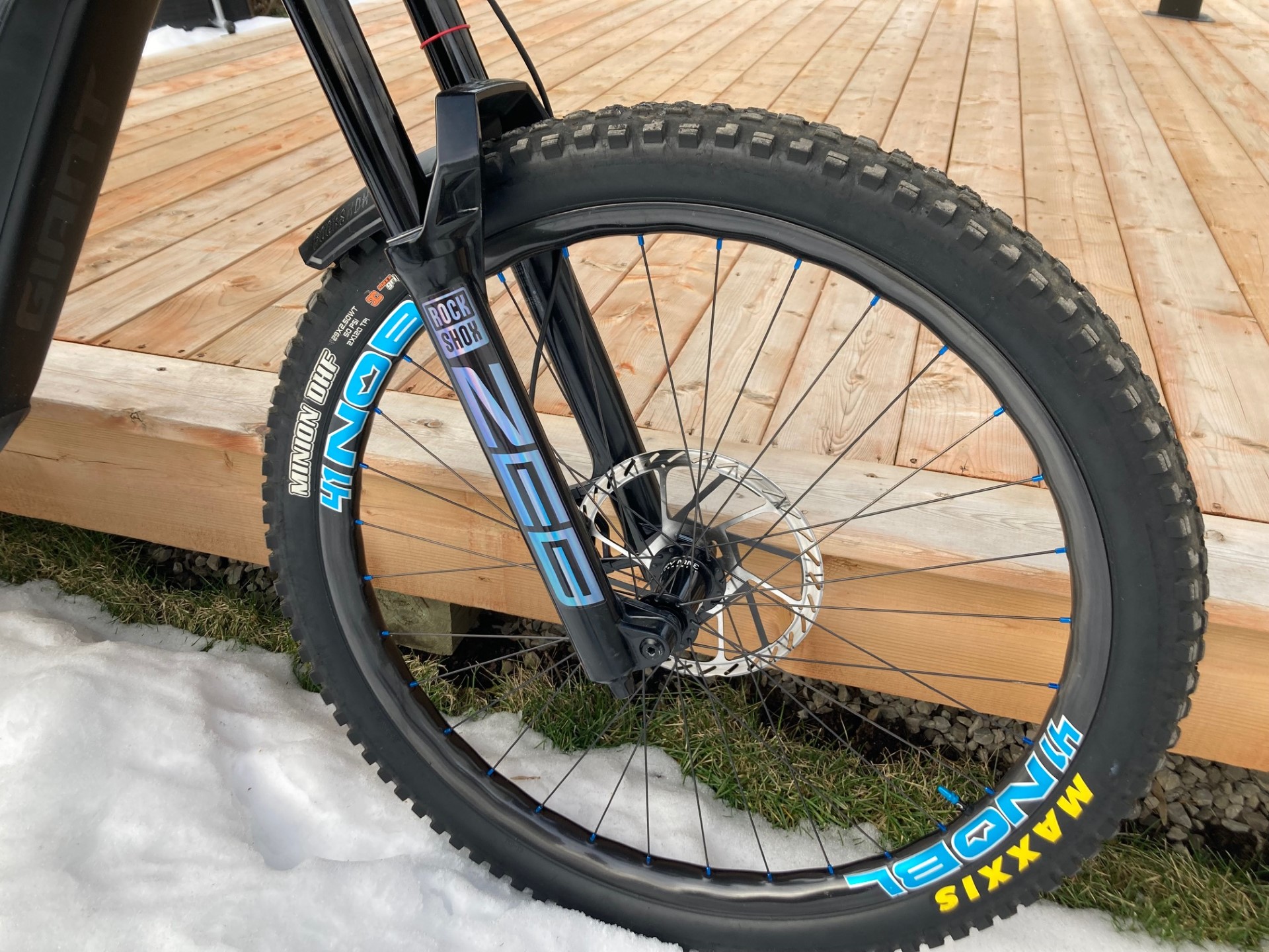

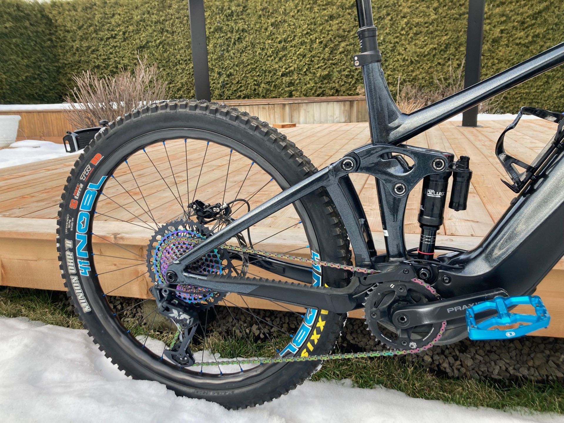

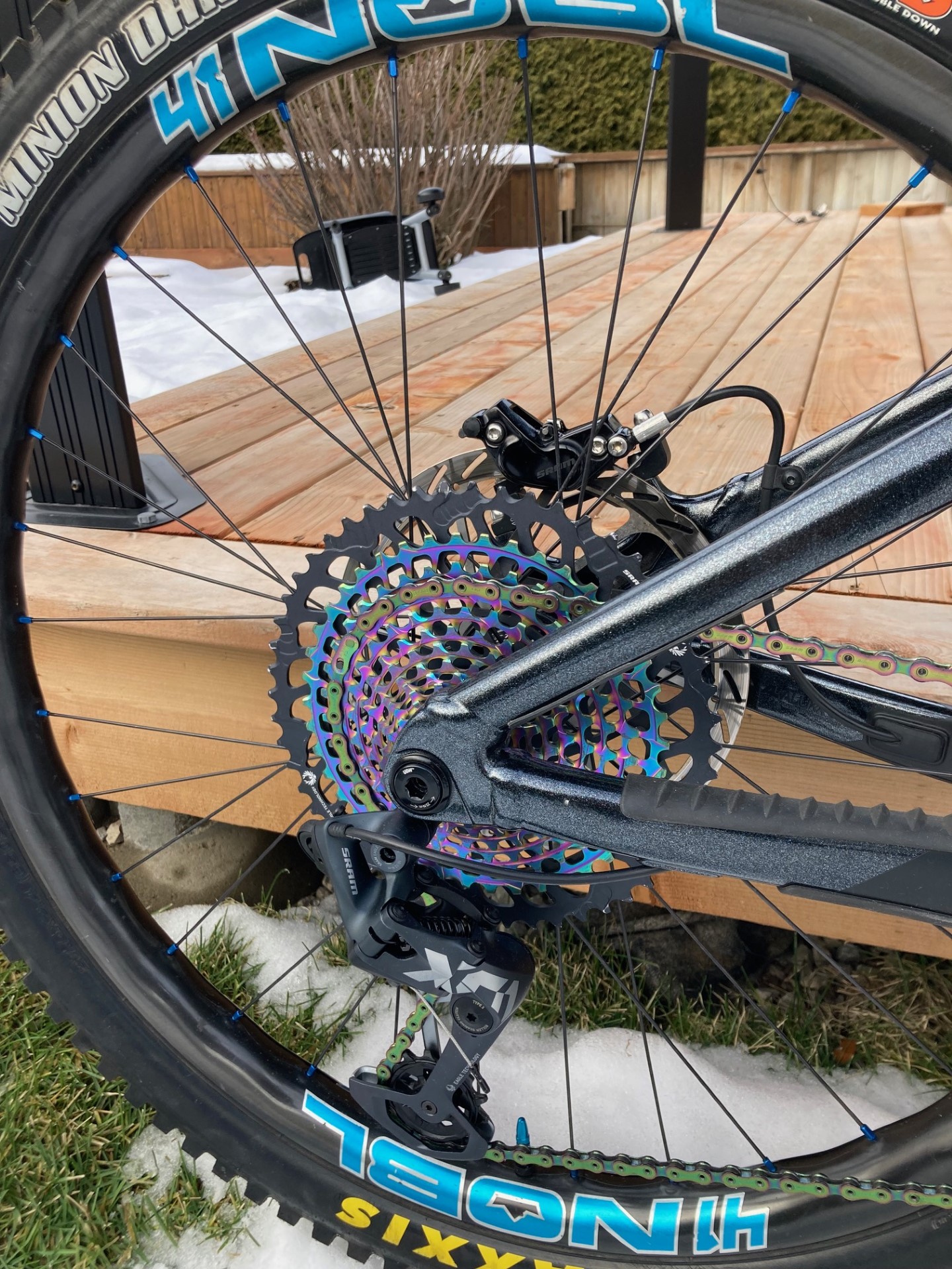

Got rid of my AXS derailleur & AXS dropper post after experiencing issues and issues, installed a new mechanical drivetrain for peace of mind & reliability, I'm done with AXS stuff for now. That GX AXS derailleur was also loud as hell and I prefer the quietness of the mechanical one that is not flopping around on impacts/rough trails.
2300km on the bike and if it wasn't for that cracked rocker link replaced under a week by Giant, no issues.
A good rear triangle/bearing service & suspension service also made the bike feel much smoother and quieter.
Installed the new parts below :
  • SRAM XX1 10-52 cassette (rainbow)
  • SRAM XX1 chain (rainbow)
  • SRAM X01 rear derailleur & shifter
  • Crankbrothers Stamp 7 Large electric blue
  • Raceface Turbine R stem turquoise
  • Oneup V2 210mm dropper with PNW Loam V2 lever
  • Custom ZEB chill chrome / rainbow decals

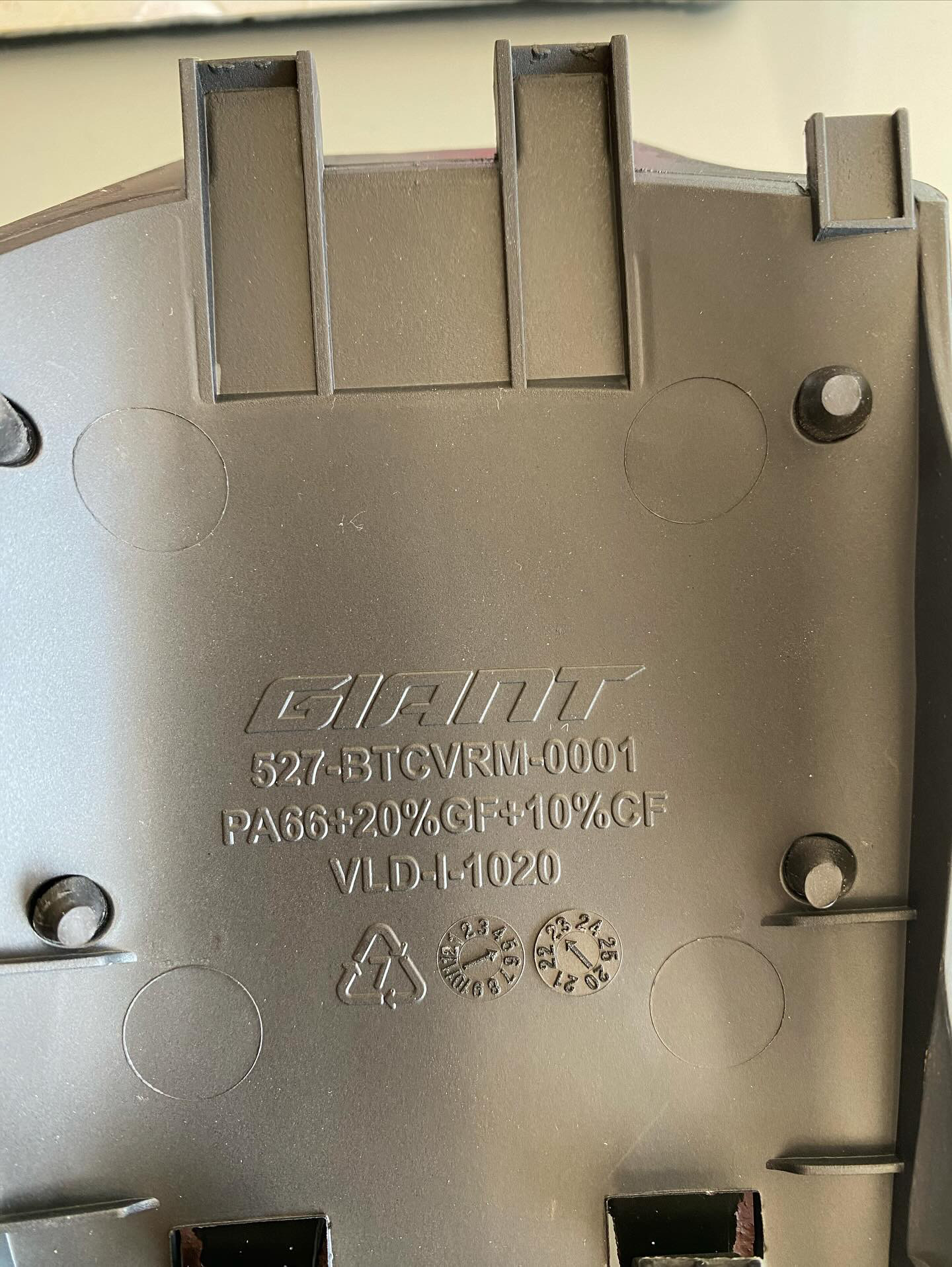

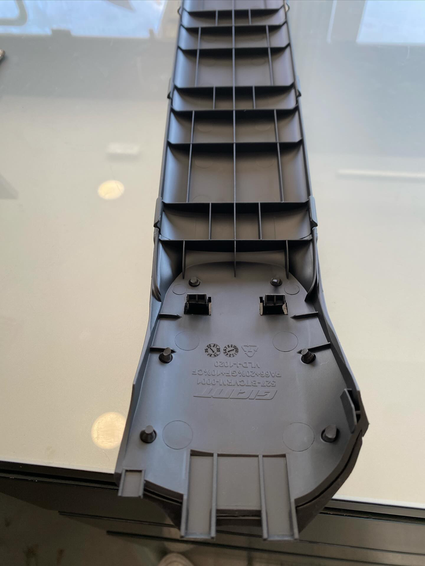

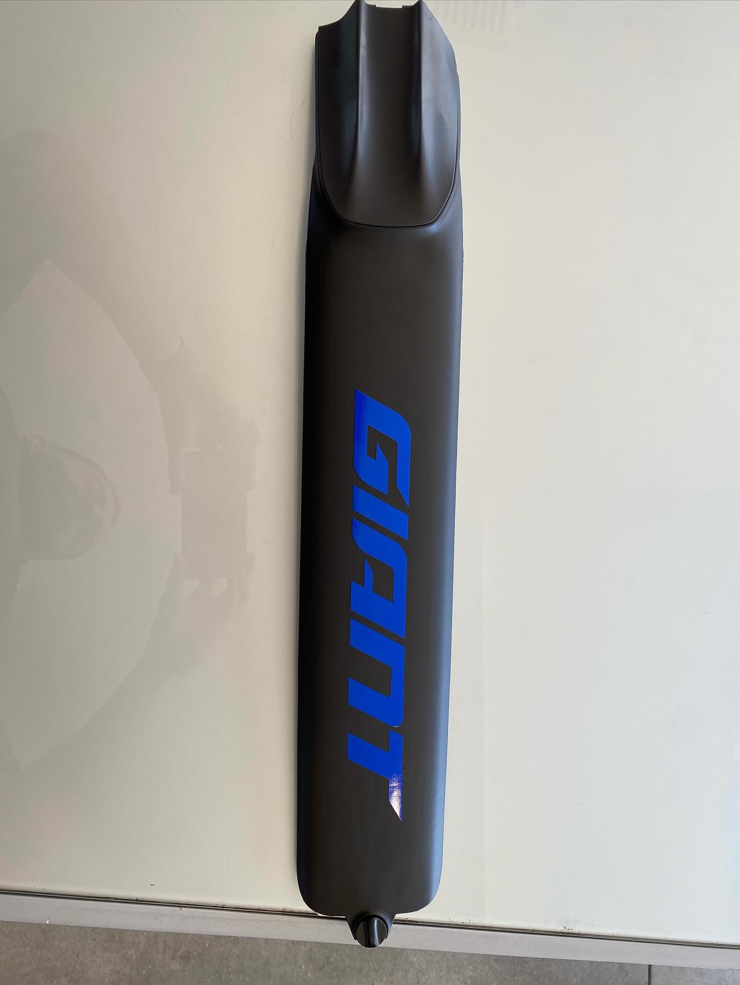

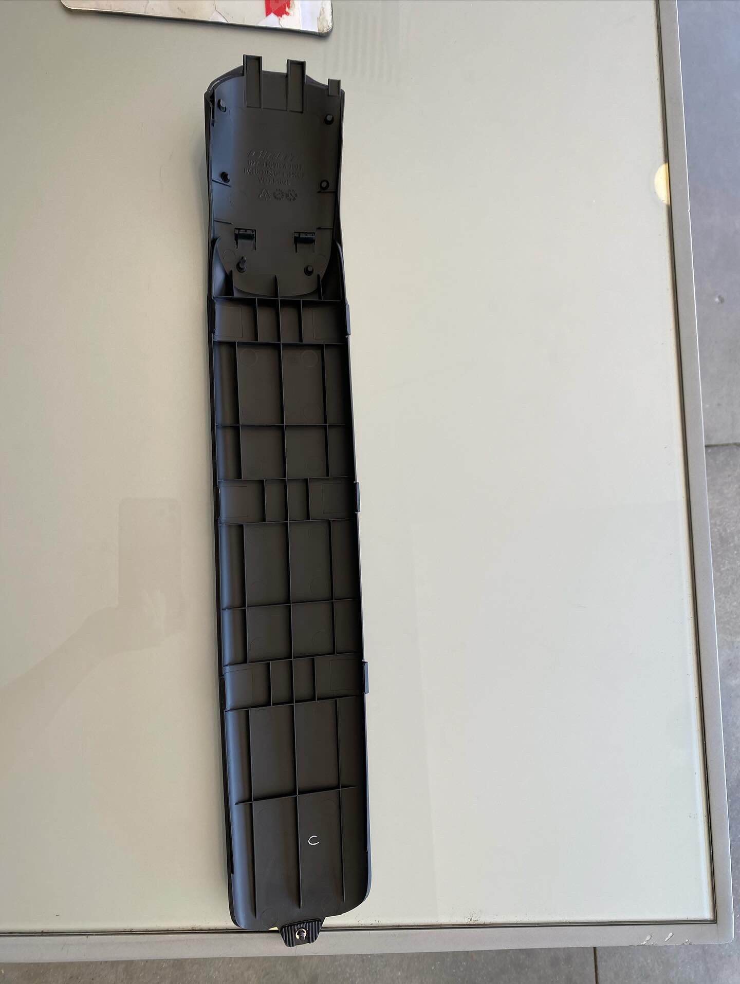

Hey all,
hope you've been doing some nice riding.
They've just fitted a new motor on my 22' reign e+2 after a 2month wait. The same day the motor broke down, I forgot to tighten the battery cover before loading the bike on the carrier and lost it while driving home, couldn't find it afterwards. I ordered a new one on the next week, which now, after the motor arrived, the lbs realized they'd ordered the wrong battery cover. Giant Portugal is now telling them the correct battery cover is out of stock. I asked them what the part number was, to see if I could search for it online, and they sent me the attached pics of the same cover from another bike. but the number shown (527-BTCVRM-0001), doesn't really return any hits on google.
Anybody know if there is another part number for the same cover I can look for? Or a shop abroad I could call for help, since in PT it's proving too much of an ordeal.
Grateful for any thoughts or ideas.
Have a great day.
