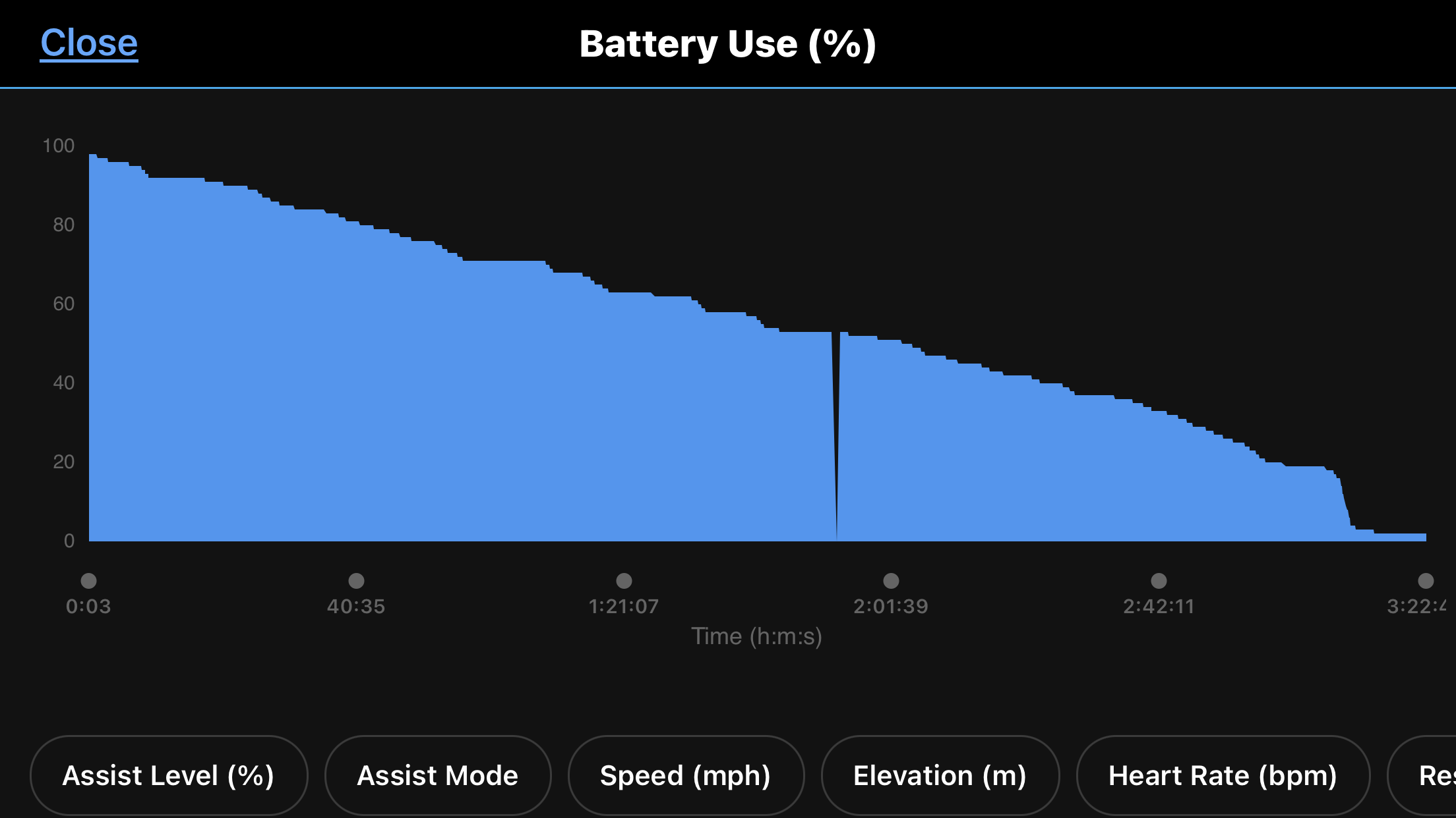

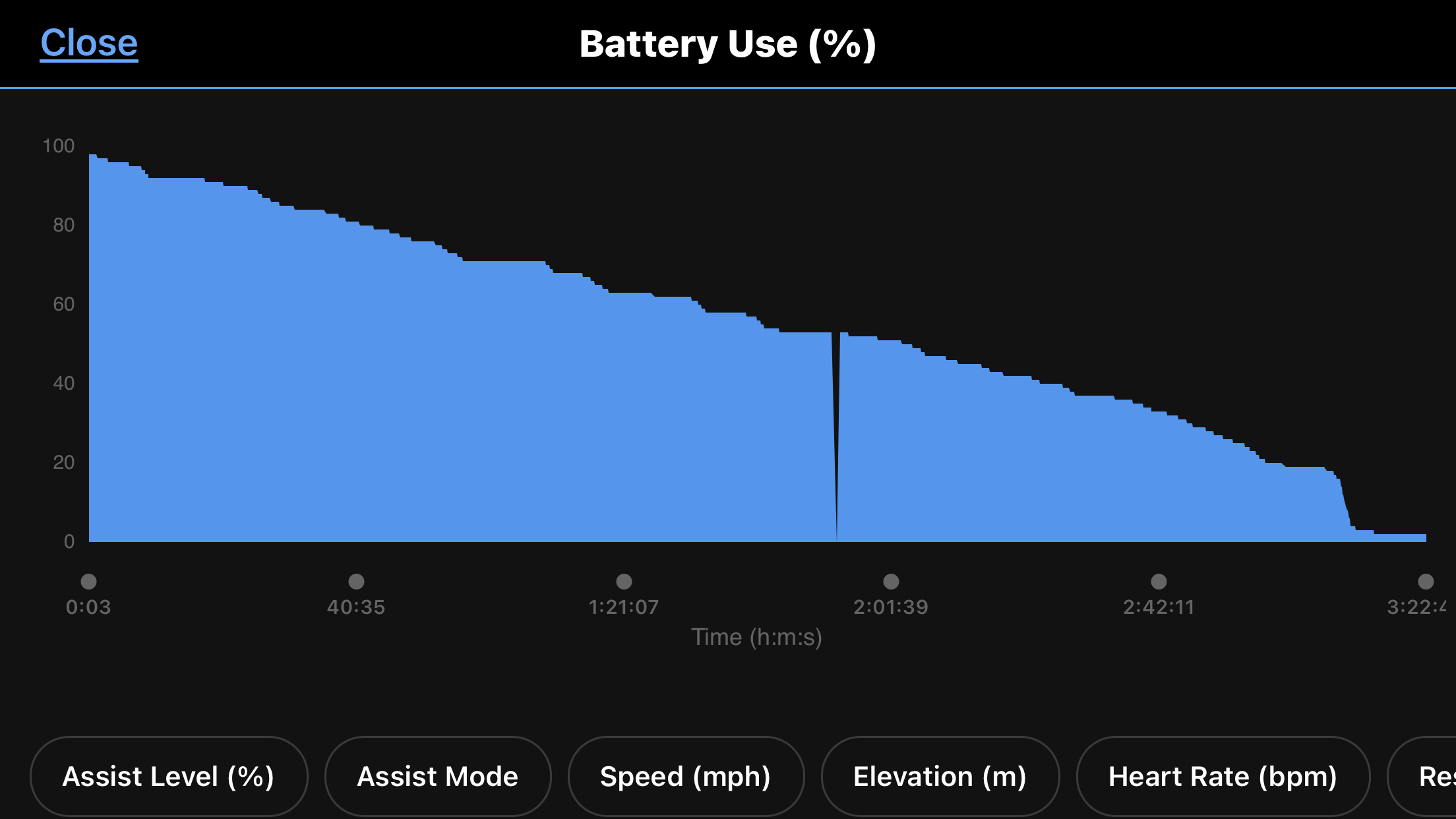

On the latest fw. Charging issue Seems solved Charged to 100% no issues after this ride previous outings it wouldn't go past 80% without power cycling charge
How do those usages look considering I was in tour 95% of the time also all my tunable options are on the lowest assistance settings
I am 120kg bikes likely 26kg

Noticed your average cadence is 48rpm. Soecialized has said that for their motors to operate efficiently its best to have a cadence of 75 rpm or more. Giant has not said anything that I have seen, but most likely the concept applies at least to some degree. Hope that helps out and congrats on your new bike.

Well, it's no secret that the first and last 10 percent of lithium batteries are not very good.
And without sharing temperature, assist level, elevation etc. your statement is pretty useless.
It was the ride back to the car park, temperature was same as rest of the ride assist was Auto and its NOT the last 10% issue as it was 17% as per the post Im familiar with the 10% faster drain this was a sudden drop as per the graph

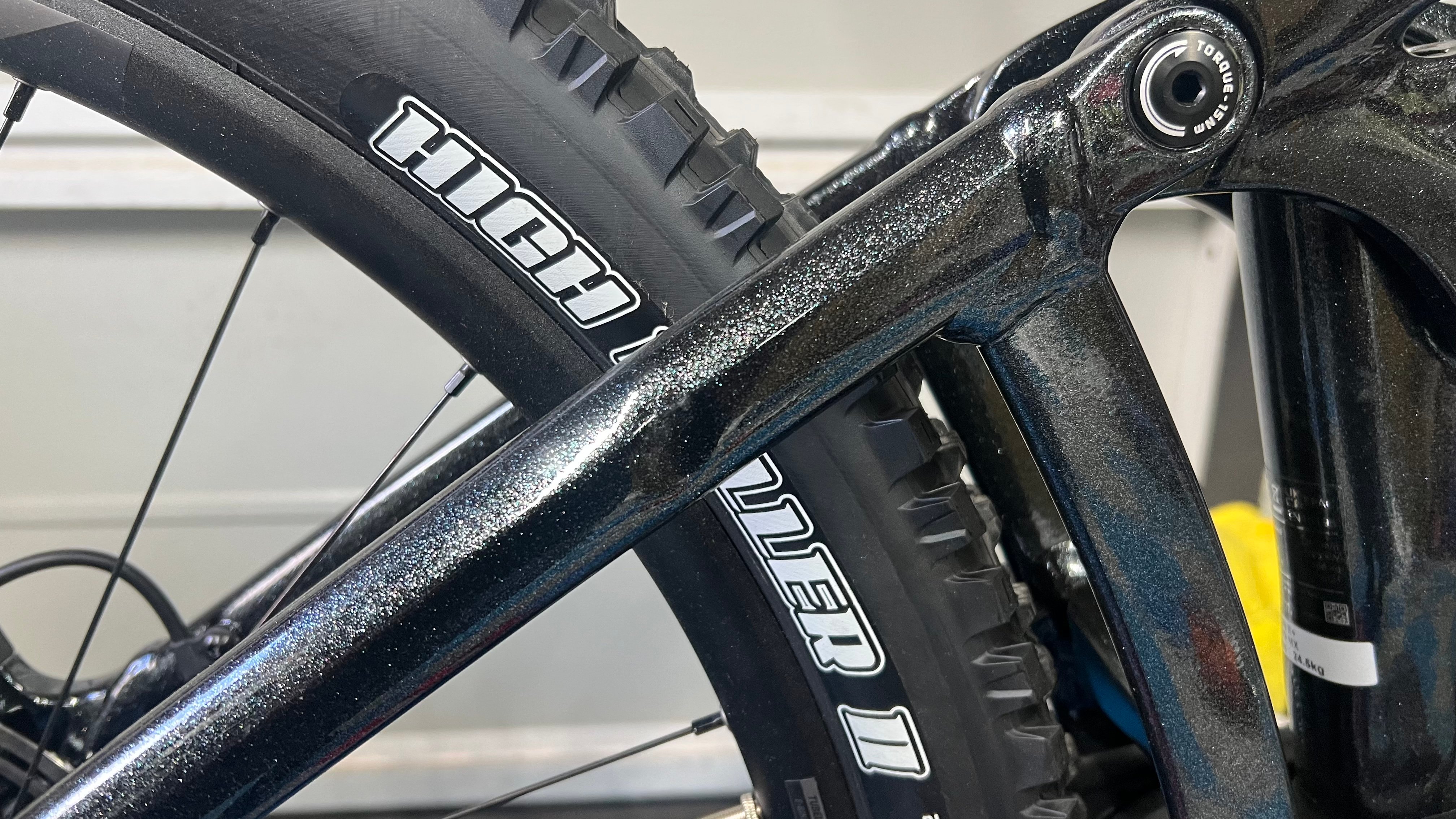

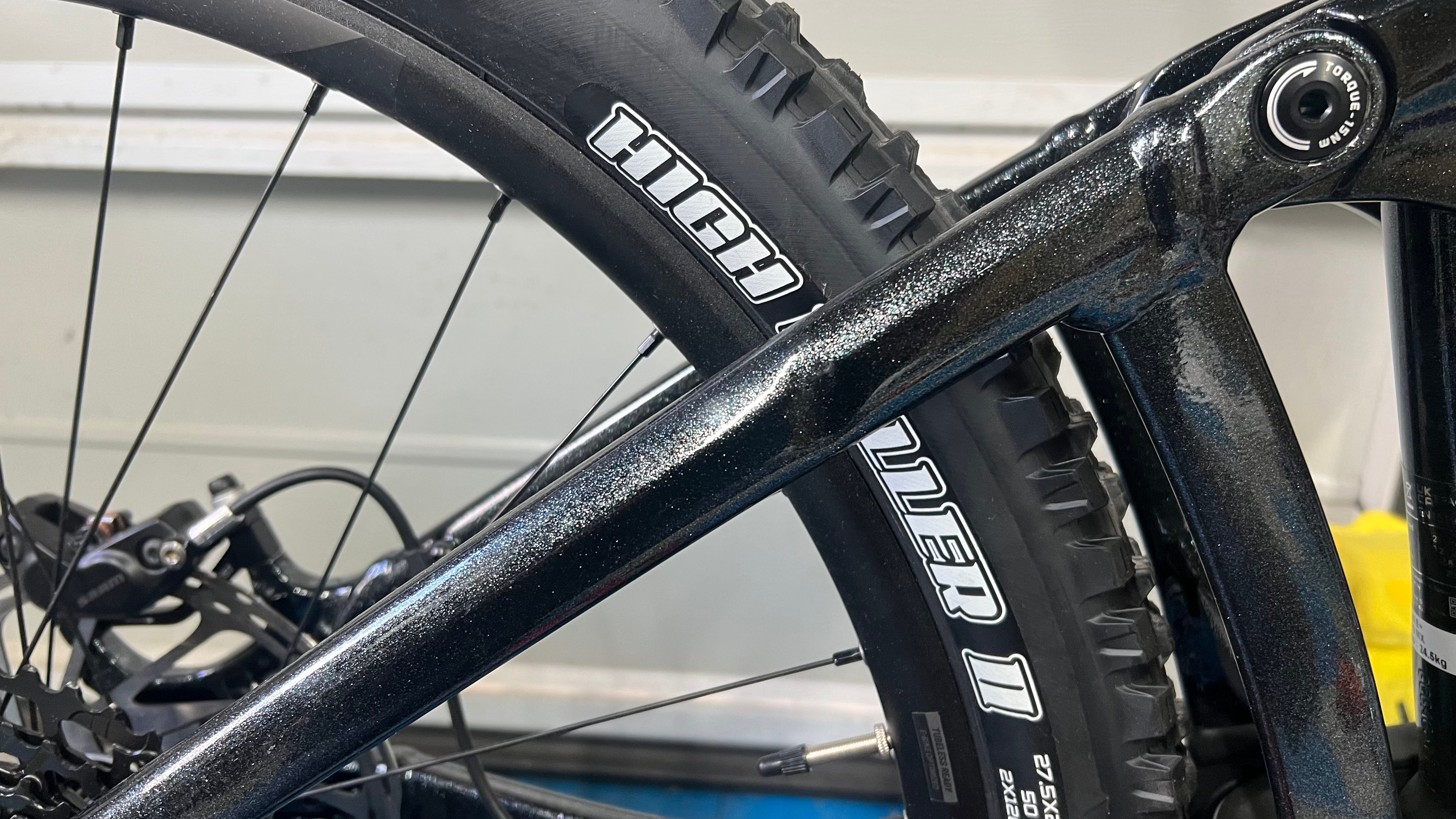

Bad paint job?
Anyway, I wouldn't accept or only with a very high discount 😜
Yea shown photos and waiting for response,idk what dpd had dropped on it..the box looked ok apart from a puncture just where the dent is…I can’t blame cjperformance either as every inch of the bike was covered in foam tube,it was even double boxed with a liv box inside over the frame and back wheel..I think next time I will drive to wherever to pick up as nothing is safe with disrespectful delivery firms.

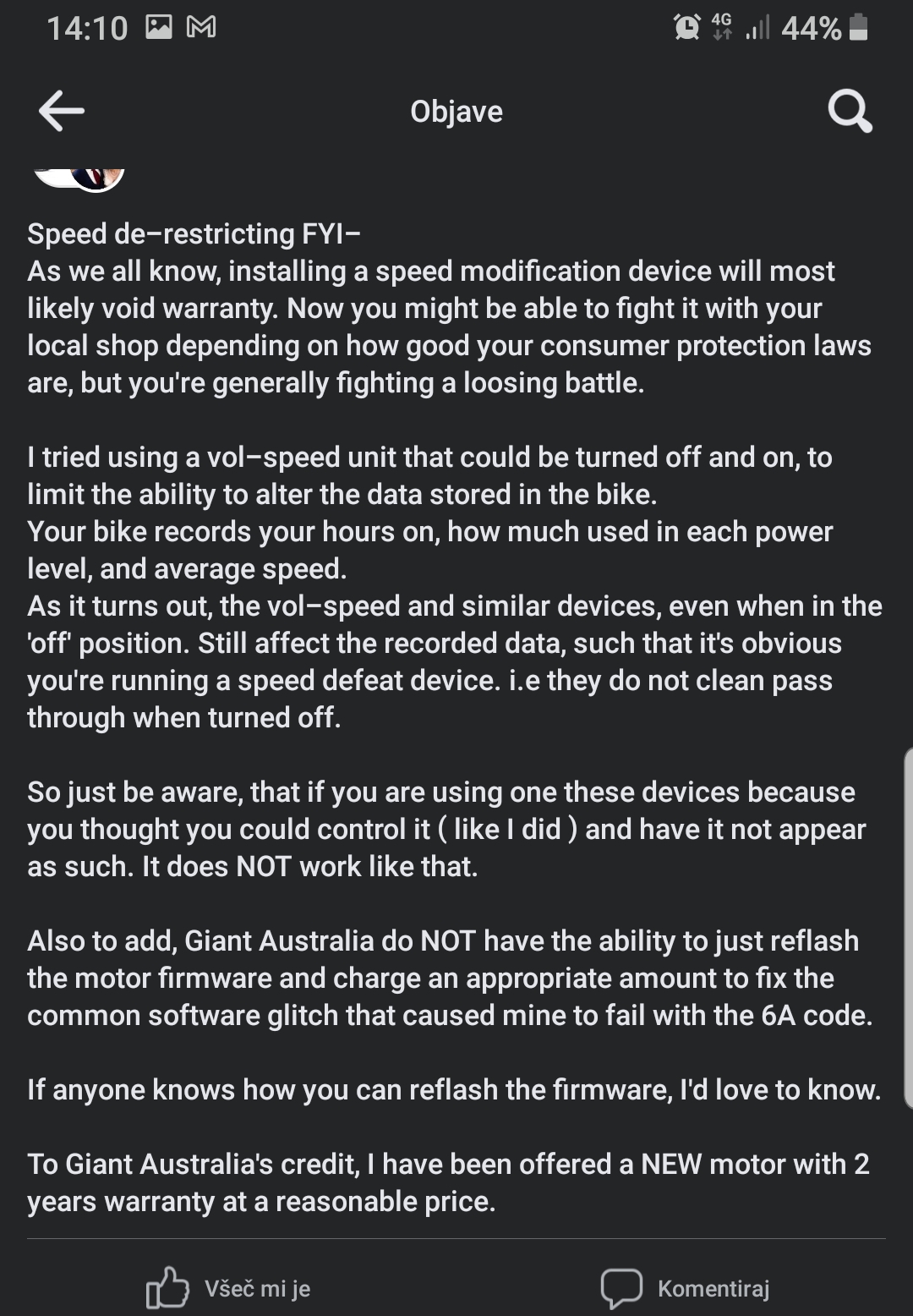

Hey guys, been gone for a while...winter here. Got some news that maybe interesting.

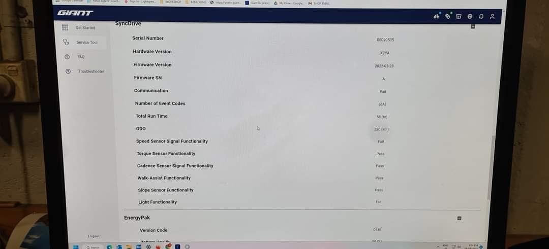

1. Been following the Giant ebike Fb group and recently there was a guy from AU with a 2022 Trance E+ saying he had a warranty claim refused as the motor software picked up his derestricting device(volspeed) showing in the service tool software as an event code 6A. So just giving anyone a heads up ✌ and if maybe someone had any similar experience that would be good to know for all of us.

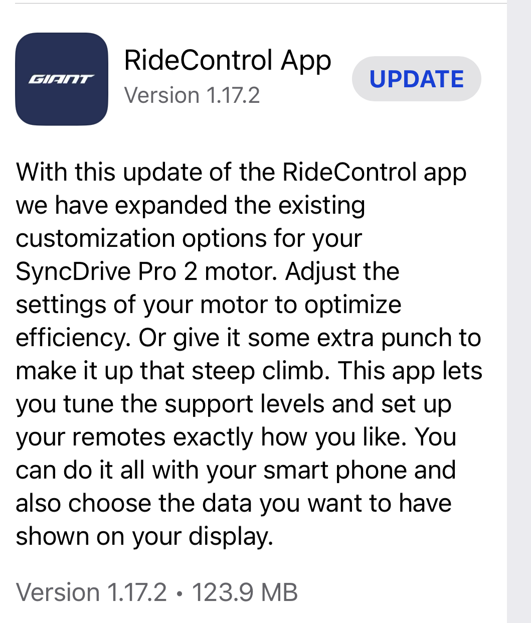

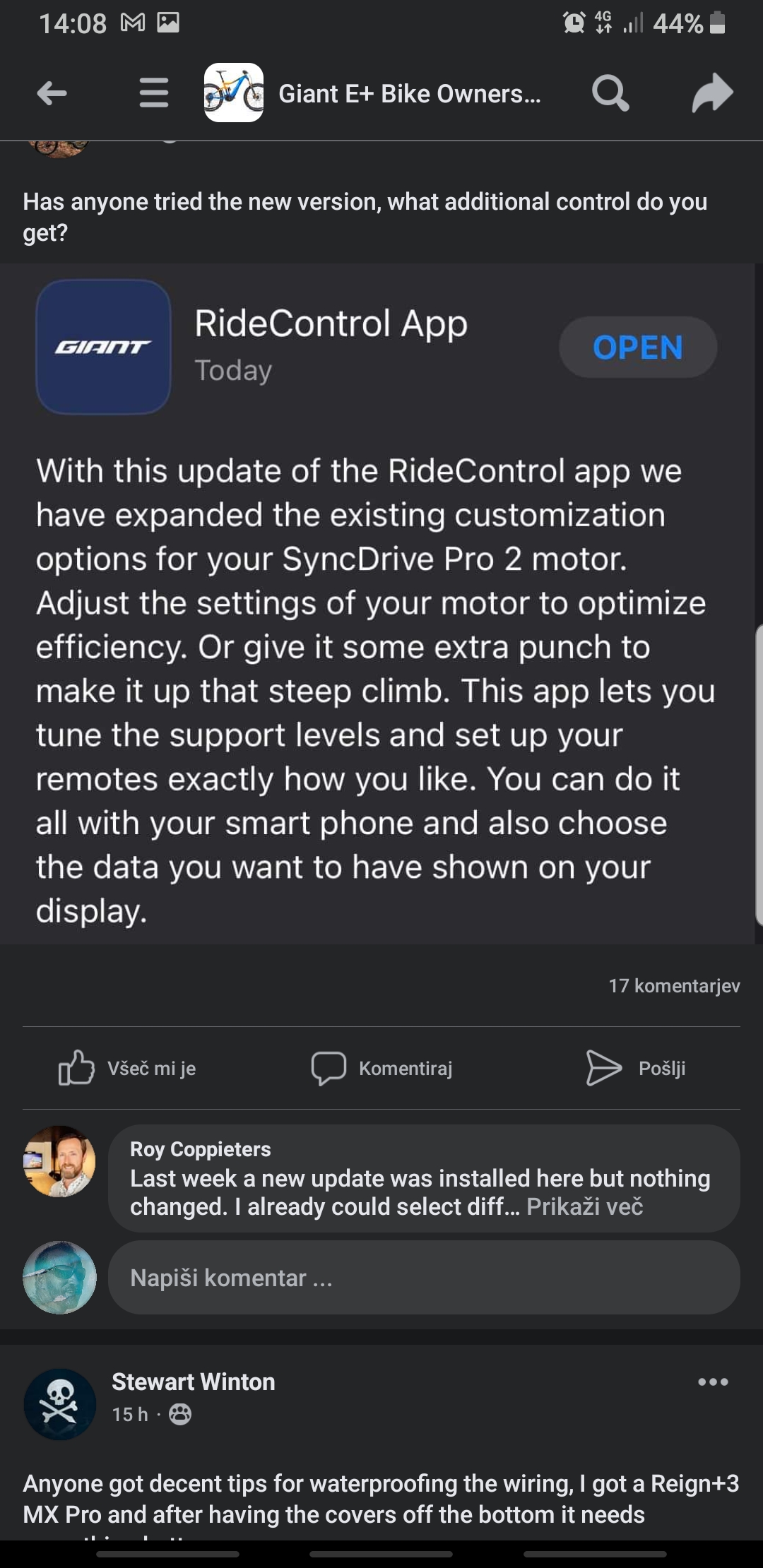

2. Also a few minutes ago There was/is a post in the same group about a new Giant Ridecontrol app update that is supposed to add a lot of new functionality to the owners of ebikes with the Syncdrive Pro 2 motor(2022 onwards). Haven't had a chance to try that out for myself.

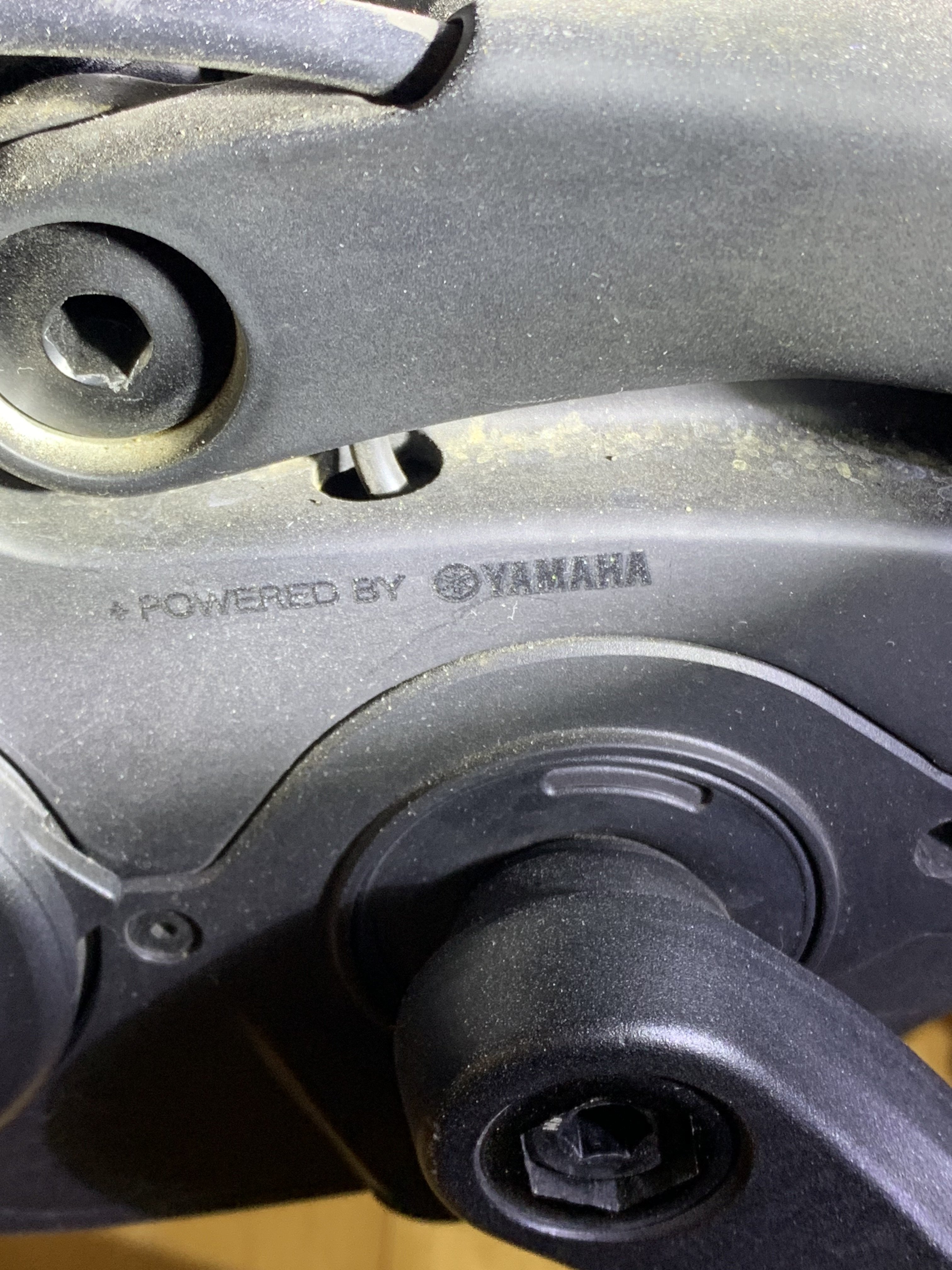

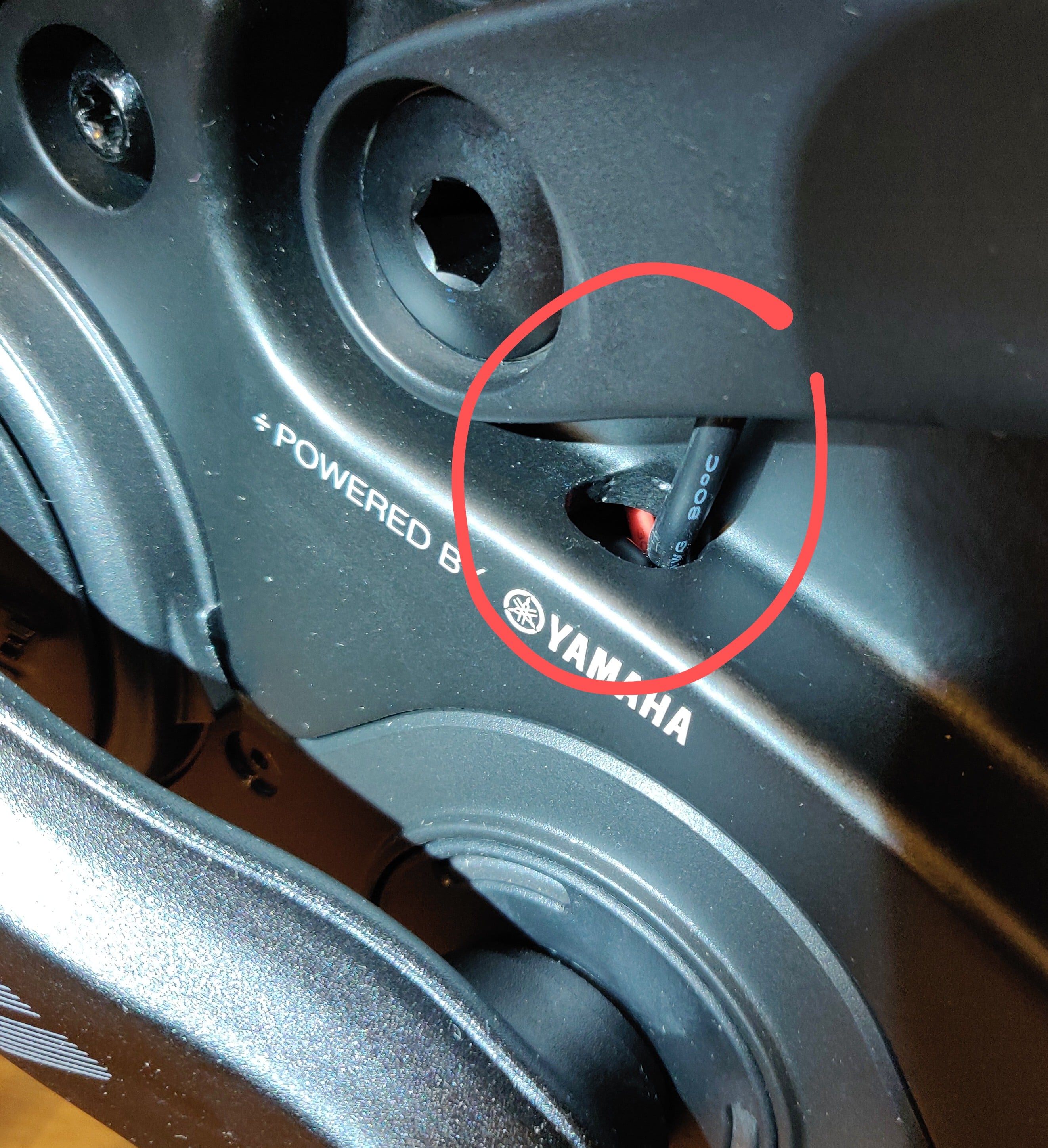

Hi, I received yesterday new Reign and noticed unsealed hole where speed sensor cable comes out from the motor and enters to rear triangle. Is this normal or missing the seal?
Yep, same here... I think (hope) it is meant to drain out from another opening at bottom, back of the crank... 🧐
