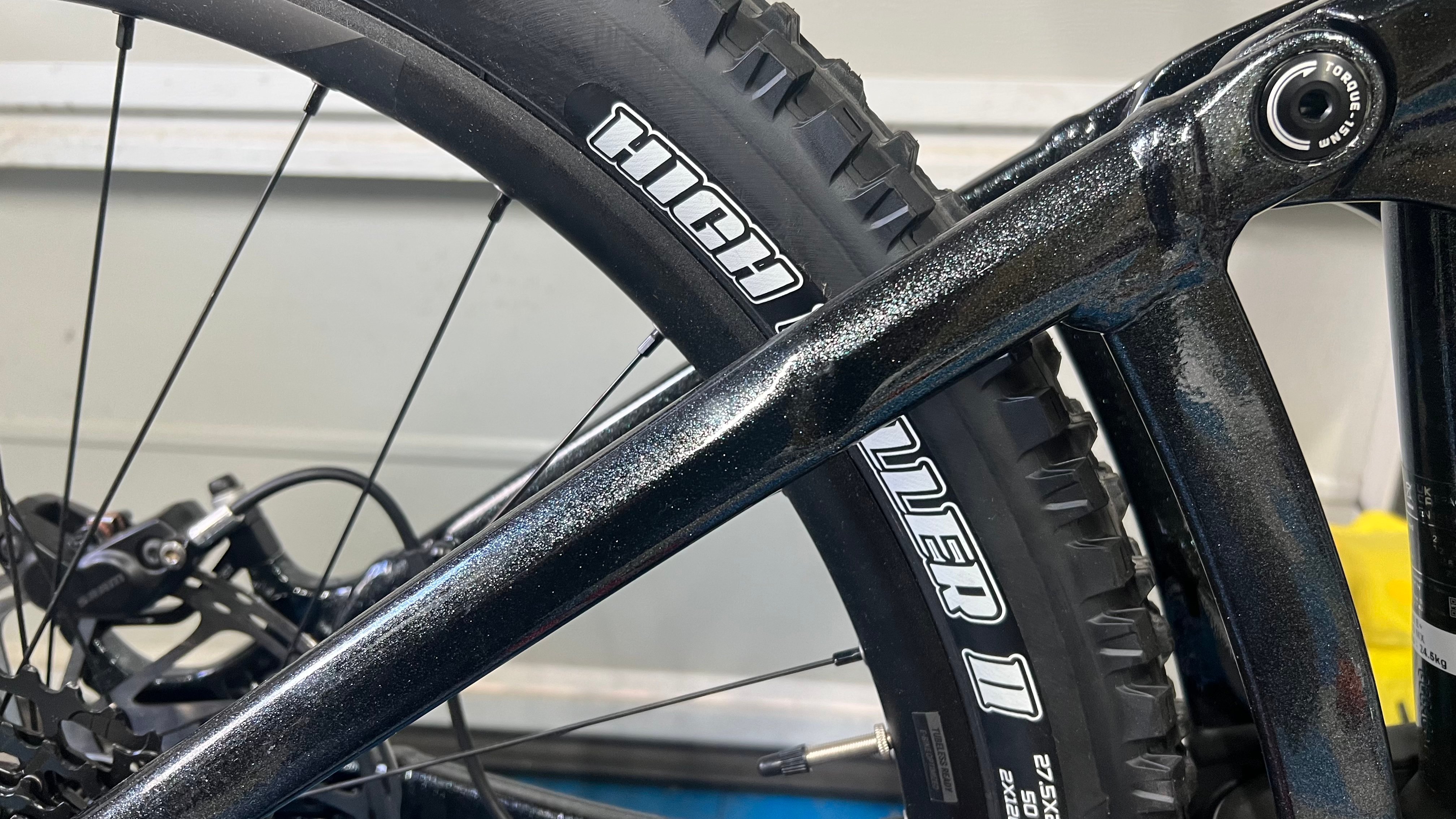

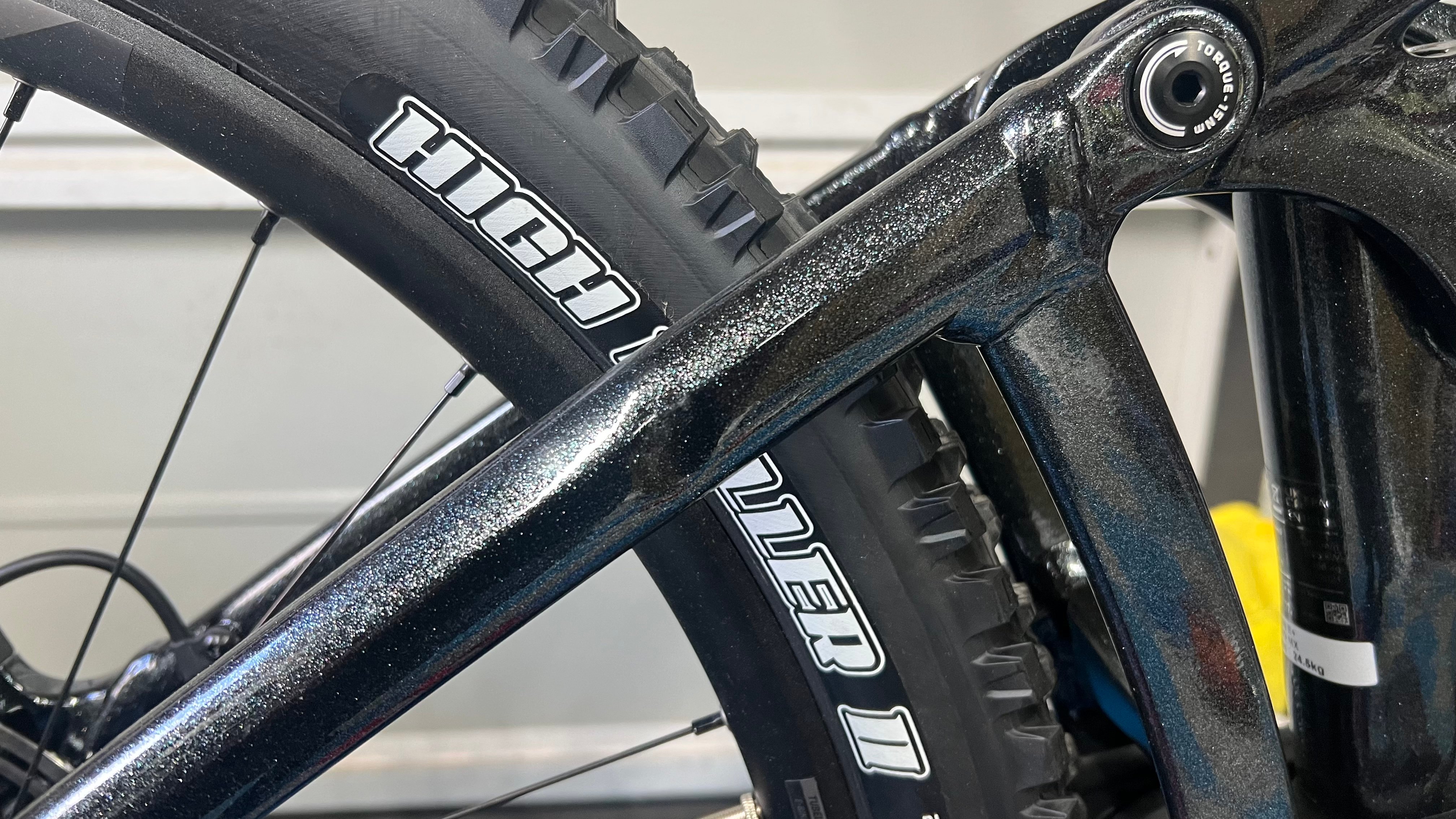

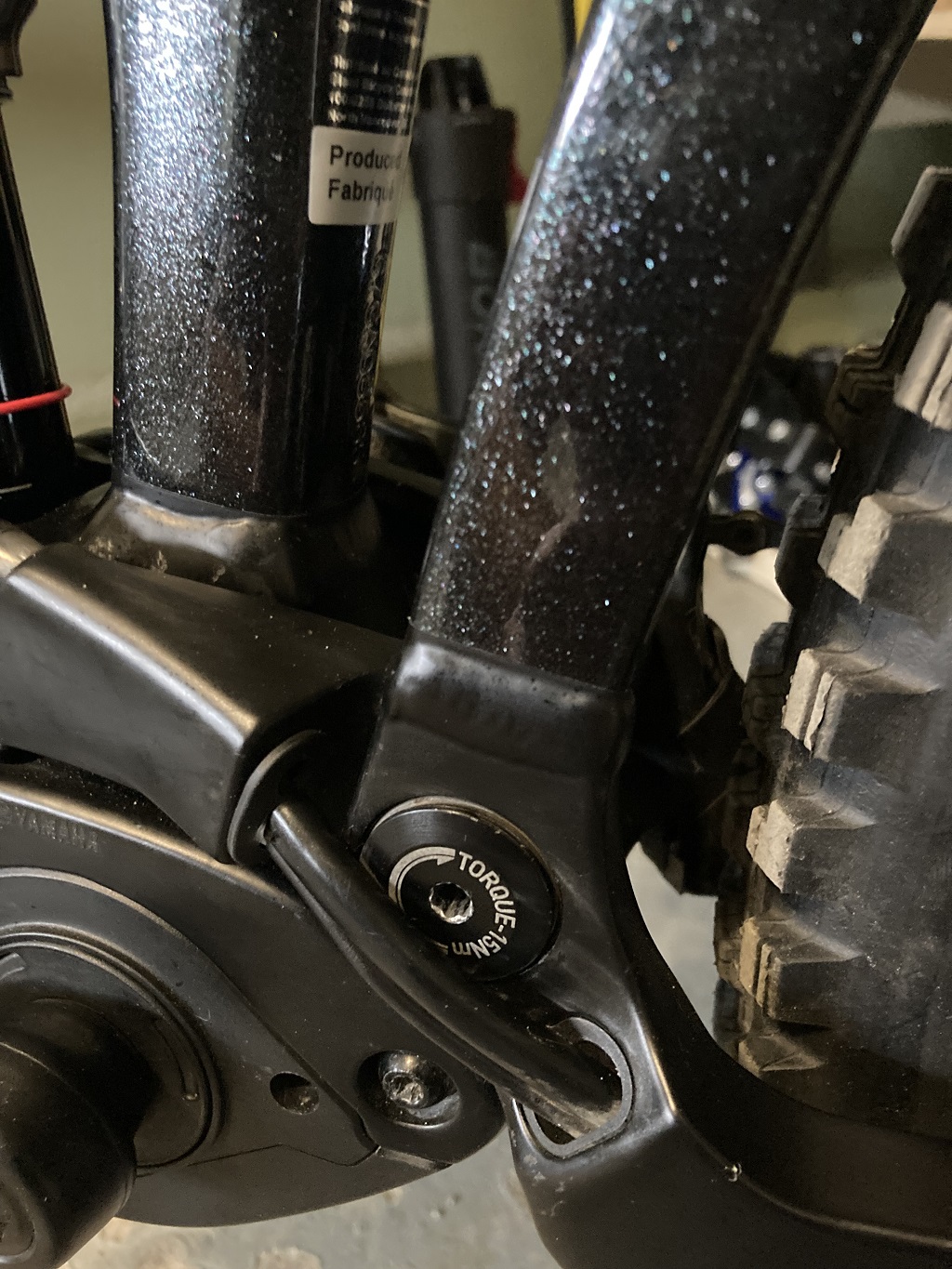

Just so you guys know what was at fault, I finally found it myself and it was the rear lower triangle pivot.
That thing is looking kind of seized and I'm not able to remove the axle (only the bolt). For an unknown reason that bolt is not flush with the bearing so water can get in easily, it was all rusty and orange in there.
I shooted some light lubricant on it and the creak immediately went away.

I would be asking for bearings to be replaced under warranty
Picked up my bike yesterday, bearings were all good according to the bike shop.
The axle in the pivot was however dry as hell generating the creaking. Giant is not greasing the lower triangle pivot along with the lower shock pivot, I would highly recommend everyone to grease these 2 axles located in these pivots before it's getting very hard to remove and creaking.
These pivots/axles should be greased day one when the bike is new.
