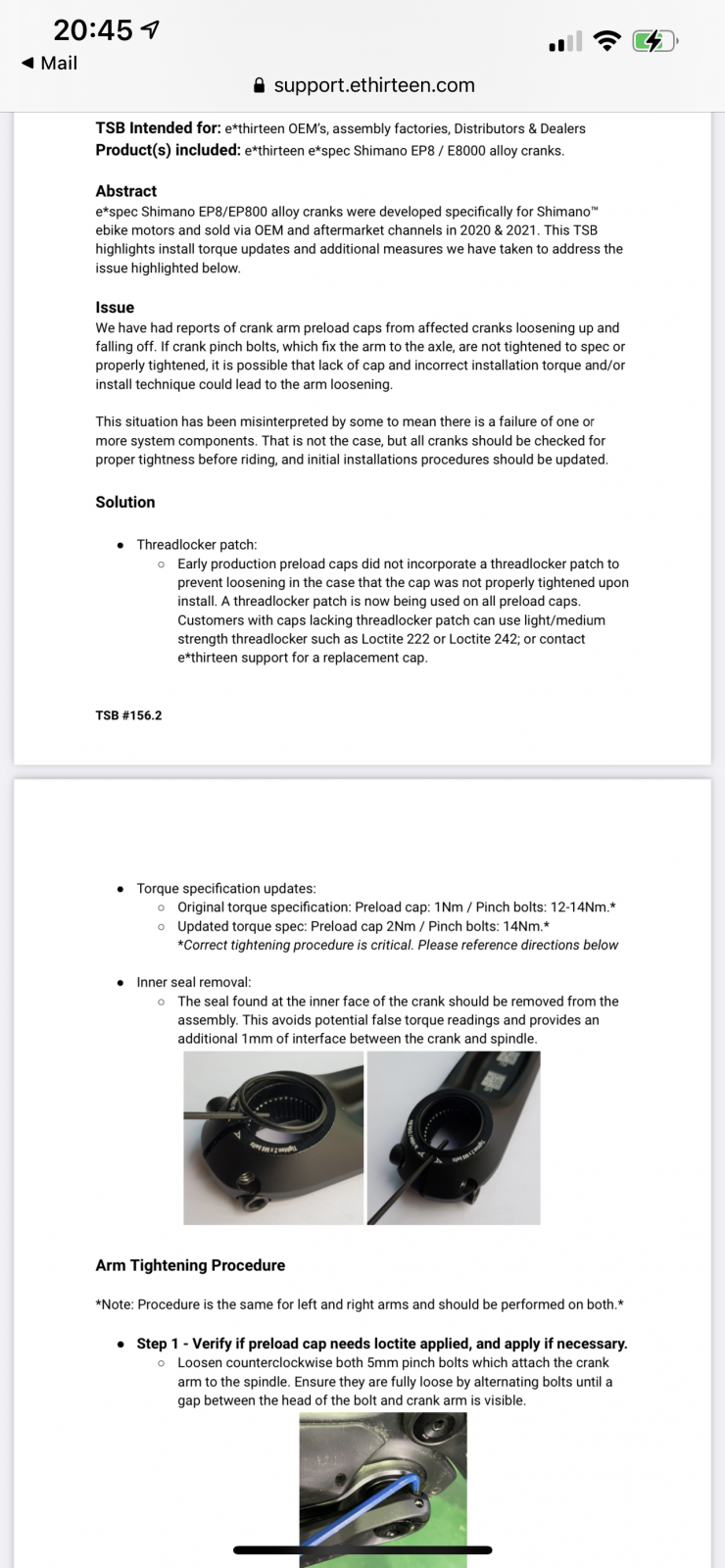

Got some thread lock today to do the crank arms before the weekend
just a couple is questions does this need to be done on the carbon crank arms or just the models with alloy arms ?
The bolt that need thread locking is this just the centre bolt as you look directly at the arm of the little one that goes through the side of the arm too ?

The tech update from Ethirteen is only for alloy cranks, but it sure couldn't hurt to check the carbon ones too. I don't know what the torque specs are for the carbon cranks. The locktite should definitely be on the pre-load cap. It's not mentioned if the pinch bolts need locktite, but it sure couldn't hurt.
CARBON TOO!!! My carbon arm fell off on my second ride.
You have carbon arms?!?! Sweeeeet!! Which orthopedic surgeon attached those? Which model did you get?
Just messing with you. I forgot you had the high end bike with carbon and unobtainium everything.;)
Do you know if the torque specs are the same as for the alloy cranks?
I actually have a prototype carbon exoskeleton of my own design. Still working out the kinks.
I ended up selling the stupidly light saddle that came with the LTD. No way my a$$ would comfortable on it. And after switching to a DPX2 and Fox 36 Factory, along with 4 piston XTR brakes, I basically ended up with a Rise Team. ;-) But the LTD shipped sooner.
Yes, the torque specs are the same (2Nm for preload cap, then 14Nm for the crank arm bolts). And blue/242 threadlocker on the cap and the bolts.

When you guys do the thread lock to the crank Adam it says one the ethirteen link that the inner seal has to be removed and discarded ??
did you guys leave this out or refit it ?
