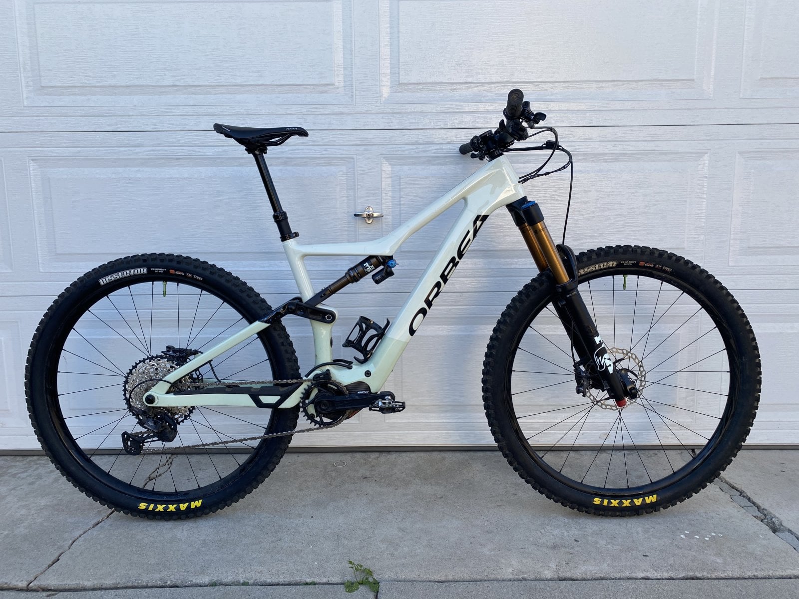

Any of you guys swapped the tyres out yet ??
If so what replacements did you go for
Running Assegai front, moved the Dissector to the rear. Probably go with good ol DHF/DHR2 combo when these wear out.

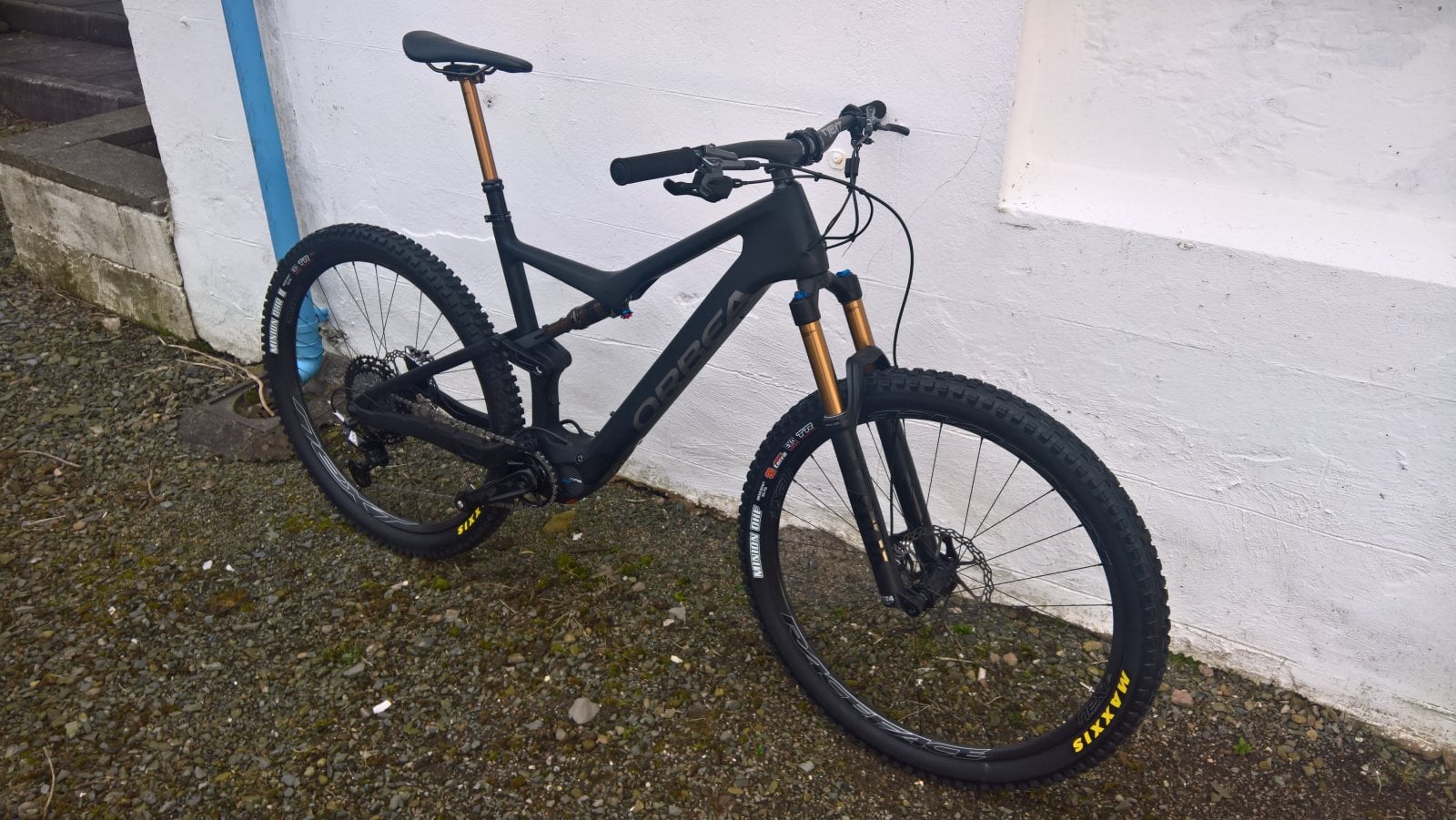

I wanted to try something completely different from normal, so swapped to some Pirelli Scorpion Trail tyres (medium & rear versions) - I kind of like the theory behind the way they only use one compound of rubber throughout - so as it wears down it stays the same. But have to see how they work out when I try some rockier trails in the wet :)
Would like to try some Dissectors at some point - I do like the EXO+ versions of the Maxxis tyres.

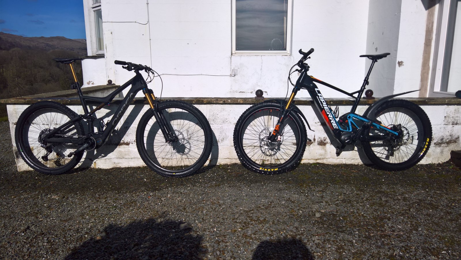

Managed to get 3 rides on my Rise so far - just road and light trails, but I went for the M-team version with the Fox 34, DPS shock and 2 pot brakes, so it suits the kind of riding I am doing recently. First impressions are it's marginally lighter than I expected for the XL frame, power is slightly higher and battery use better than I expected. Style and build quality are really fantastic. Have to mention the RaceFace components (stem, bar, rims) as these are just amazing quality and style.
Can only compare to my 2 year old E8000 Lapierre AM Overvolt (so that will have battery degradation etc - though I swap between 2 batteries) - and I'm just in the default EP8 profile on the Rise (probably the lower profile 1, but I haven't even connected it to the E-tube app yet to check ...)
  • Almost 8kg lighter than my Lapierre!
  • Trail assist mode on the Rise, feels like Eco on the E8000
  • Boost on the Rise, feels like the high trail assist mode on the E8000
  • There's a particular road hill near me which always uses 30-45% of a 500Wh battery on the E8000 in trail assist. On the Rise I've done the same hill on the way back each time and used 22%, 27%, 32% battery - probably depends on how tired I am, and seems to use more when the battery is lower. But it's definitely using less battery % for the same feel.
Shortest ride was 21km, 500m height (all road): used 28% battery (including 22% just for that hill)
Longest ride 59km, 1200m height (road & forest trail): used 80% battery (including 32% for the hill at end). Took 3h10m, compared to recent times on the E8000 Lapierre of 2h50m and 3h03m - so slightly slower overall, but felt about the same. Rode mostly in Trail then switched to boost for the end.
I've found I needed to put my saddle back (15mm) on the Rise (I'm 6'4" on the XL) due to the steep seat tube.
Had to reset the wire from the cable to dropper post as it became lose after one ride - I think it just wasn't properly seated at the dropper end when it was assembled. Really easy to slide the dropper cable in and out of the frame though without needing to touch anything else like the motor - no way I can do that on my Lapierre.
The 2-pot XTR brakes on 180mm rotors feel a lot weaker than 4-pots on 203mm which I'm used to (unsurprising!) - maybe I'll change these at some point.
The XTR gears shift amazingly well (as everyone seems to say) even under power. But I find myself hating the XTR gear lever ... wondering if it's possible to switch this for an SRAM one ...

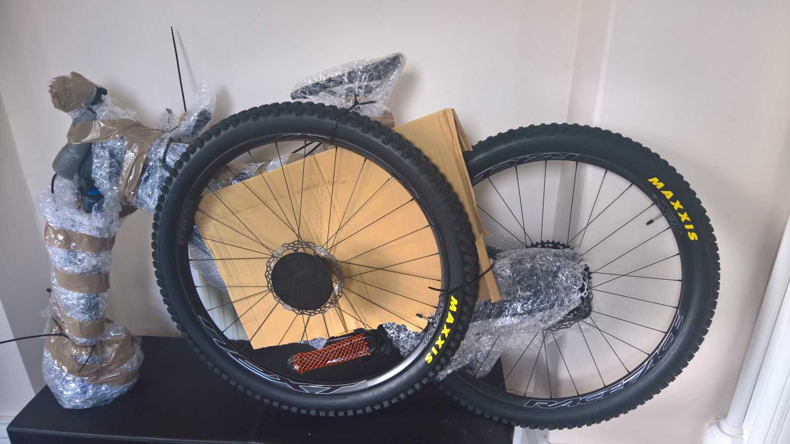

On arrival as stock (size XL, with tubes & no pedals):
Weight in packaging: 17.74kg (39.1lbs)
Weight with no packaging: 17.26kg (38.1lbs)
I've changed the saddle, added pedals & bottle holder, changed the tyres & tubes and it is at 17.41kg (38.4lbs):

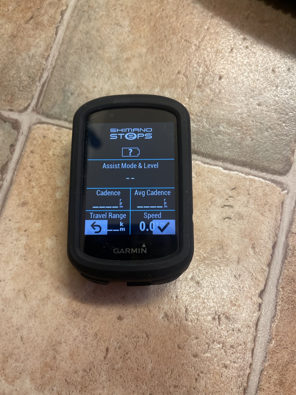

chrismechmaster
Dec 7, 2020
816
420
Newbury
Cheers guys for all the advice
So I am going to leave the rs toolbox for now ok and use shimano steps so I have the data screen all set up on the Garmin
The bike is on
But none of the data like battery level of assist mode is actully showing on the Garmin screen how go I get the info to show on the screen

Bigkatoomer
Feb 25, 2021
56
90
Surrey, England
RS toolbox: you have to bite the bullet and unselect/disable/invite the Steps screen for rs toolbox one to own the connection, you cannot have them both.
It means you'll lose the ebike data fields but rs the olbox is configurable through Connect IQ for data fields so it's not too bad.
The main benefit of RS toolbox over Steps for me is the stats that are captured on ebike mode, assistance level, battery level etc in the ride in Garmin Connect.
As said, it's a fricking pain, but keep trying! Once set up, it's very reliable. All this Levo 2022 display features and all I'm thinking is the Garmin which I would fit to any bike anyway, does way more than that in-built processor....

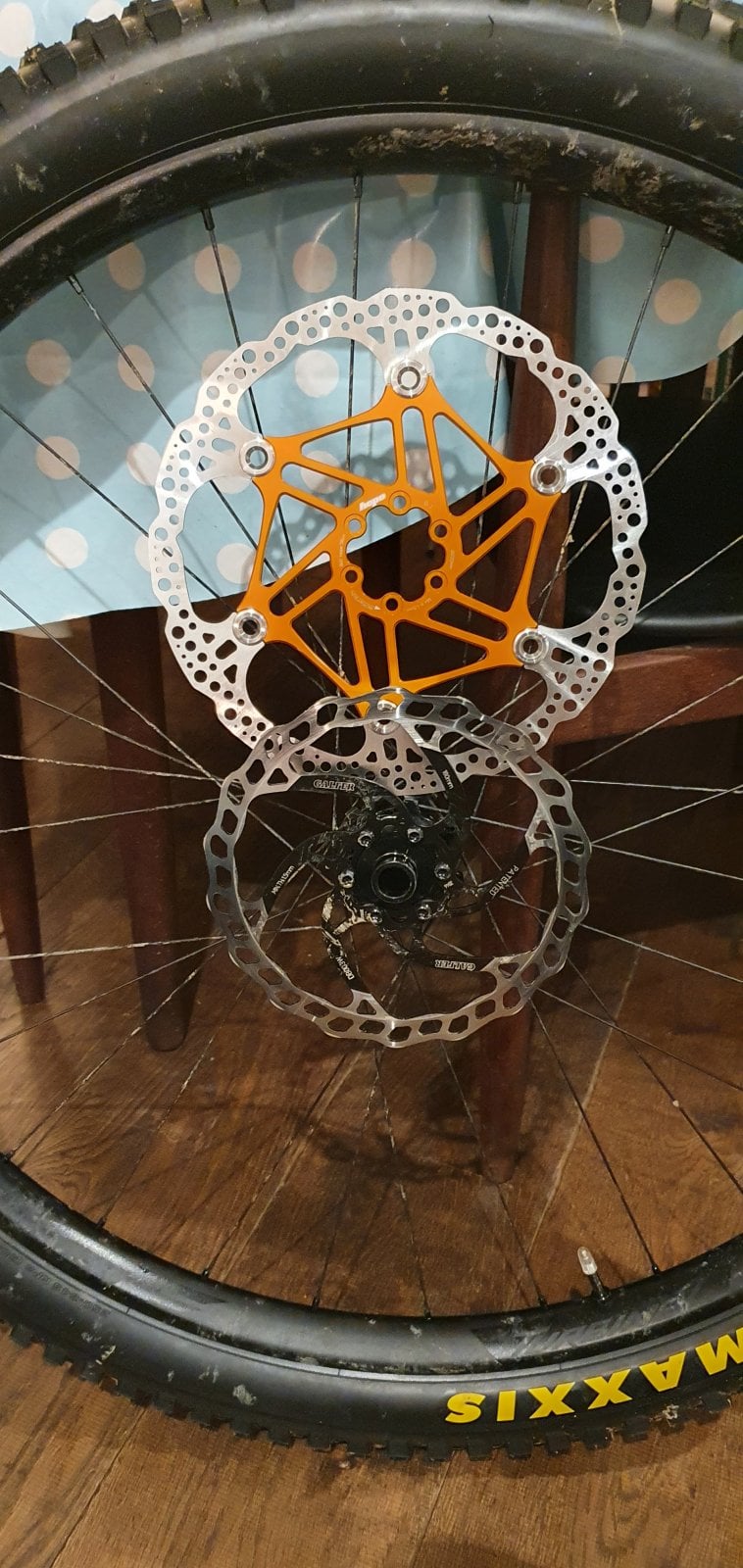

Brakes: Orbea did a deal with Galfer towards the end of last year and XT ice Techs rotors were ditched for Galfer 180mm front and rear. A poor choice in my view. My mate has an 1yr old Occam and the ice tech 180s are fine.
There's enough bite in the rear brake for me, so I left that as-is, but wanted a stronger front brake. Would love Magura MT7s but don't want to spend my life bleeding them, so I stuck with the XT caliper and swapped the rotor to a Hope 230mm and adapter. The result is brutal. Great control, great modulation, loads of power, no noise, £50, 10 minutes and 6 + 2 bolts.
Original weighs 123g
Hope and adapter weighs 221g

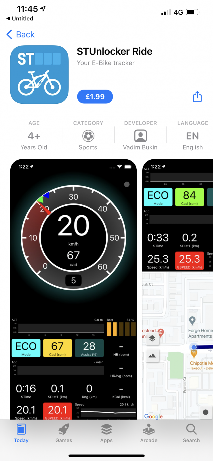

Does anyone know if this app will work with our rise / rs motor
It looks very similar to the belevo I have for my Levo View attachment 56685
The developer is a member on here, you can ask him in this forum
You have to be careful with the Rise as the RS versions have the later firmware updates which means it’s harder to erase a trace entry of any intervention. It’s best to change the firmware to an earlier version for the EP8. I would contact Markus at Emax who can give instructions on how to do this either via a smartphone or windows using the PCE1 interface.
