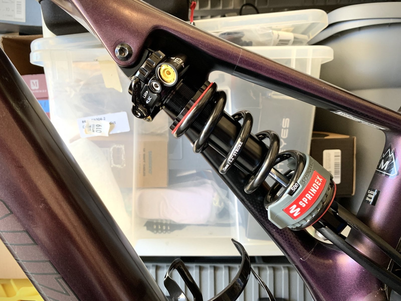

Installed Cane Creek DB Coil IL with Sprindex adjustable coil spring this morning and rode about 9 mile to quickly test it this afternoon. Small bump compliance is superb; smooth landing from small jumps. The adjustable coil spring adjustment is a great feature. Played the spring rate from 470 to 500 lb/in; adjustable through a simple twist; comes in handy specially when my riding weight or trail demands different spring rate. Really digging the adjustable feature.
It looks really good! Did you happen to weight the IL + coil?
How the mid stroke with the coil (i.e pop/playfulness)? That's one thing I love about the stock configuration on the bike (coming from a heavy, linear rate coil bike)

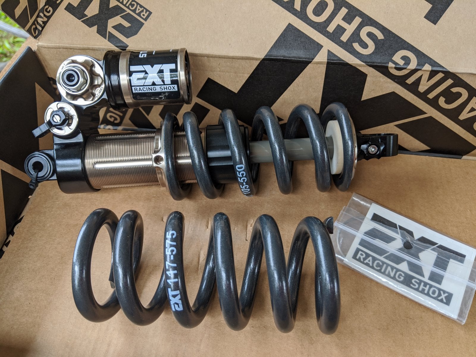

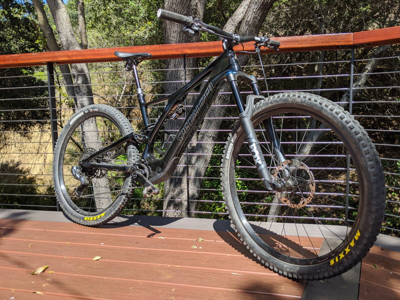

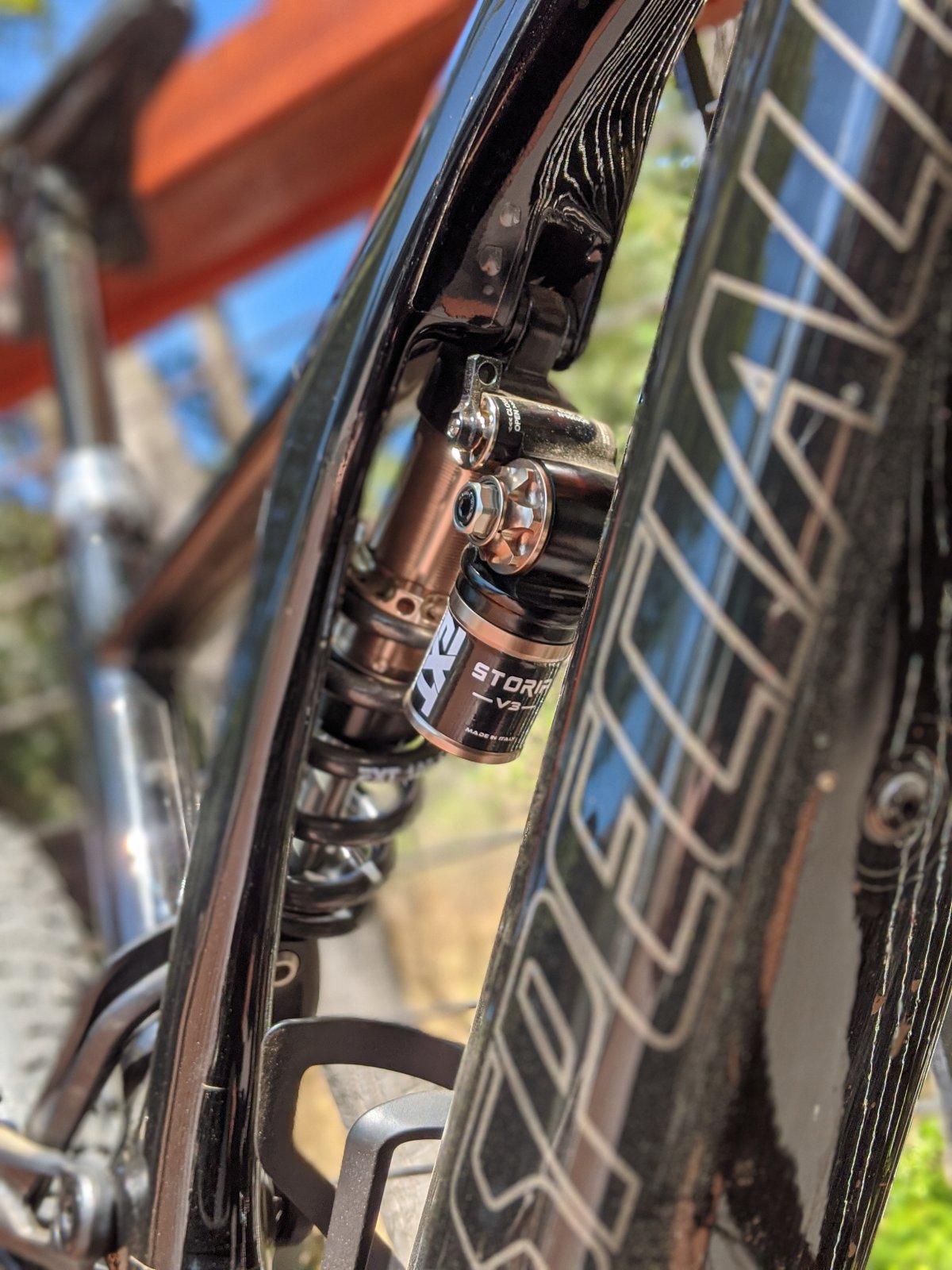

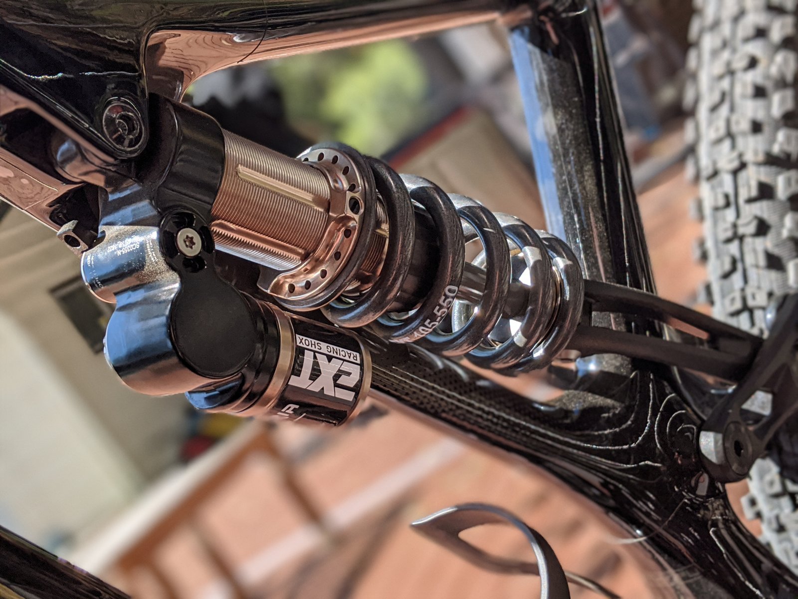

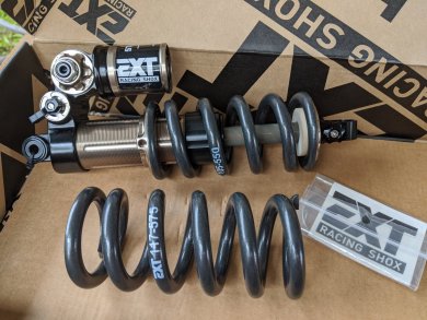

Update on the EXT Storia Lock 3 shock:. 210 x 55 with 550 lb spring. Bike size large flip-chip in low position. I'm 5'11" tall and weigh 195 lbs with all gear and water/pack on the bike.
Shock fits but the piggyback reservoir does make contact with the range extender or a tall water bottle. Will correct this by fabricating a small custom aluminum mounting tabs to drop water bottle holder a few millimeters toward the bottom bracket. Will use aluminum flat stock, cut off wheel, drill, file to make the mounting tabs.
The shock is just as poppy as the air shock probably within 95% or so and can easily pop off of lips, jumps, roots, rocks. Can easily bunnyhop the bike and that is exactly why the EXT Storia shock was chosen. It is different than other coil Shocks. You loose little to no progressivity with this particular shock. Small bump sensitivity is adjustable and unparalleled in providing tactile trail feel and enhanced grip by my experience to any other shock. Every click of the adjustment dials for HSC, LSC or rebound is noticeable and effects a tactile change. I still have fine tuning to do once I have access to more technical fast trails. Will report additional info when available.

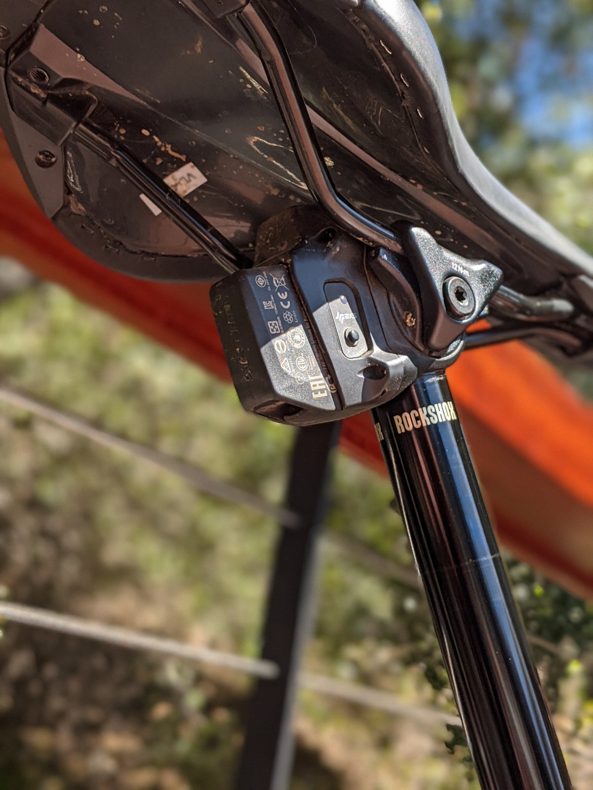

With my seat slammed the rear tire can make contact (with harsh landings off of jumps) with the battery pack on the AXS battery pack on the reverb post. I remedied this by raising my post a few millimeters.
Did not weigh as I do not have a weighing scale. From my one hour ride, better mid stroke than the stock shock and does not ramp up easily.
