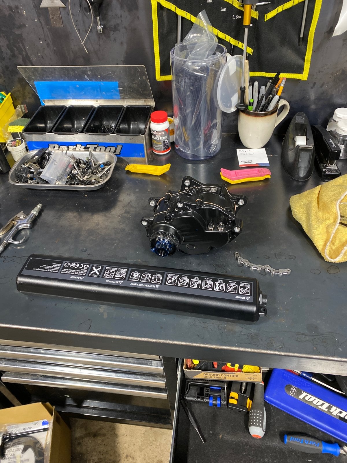

My son is a mechanic at a Specialized Dealership and he sent me this picture. He said the motor and battery were freakishly light. I thought you guys might like to see this.
Cool! Ask him how you get the chain ring spider off those splines!
tried to take mine off to clean but couldn’t get it to budge. Ended up having to undo the 4 bolts that hold the chain ring to the spider.

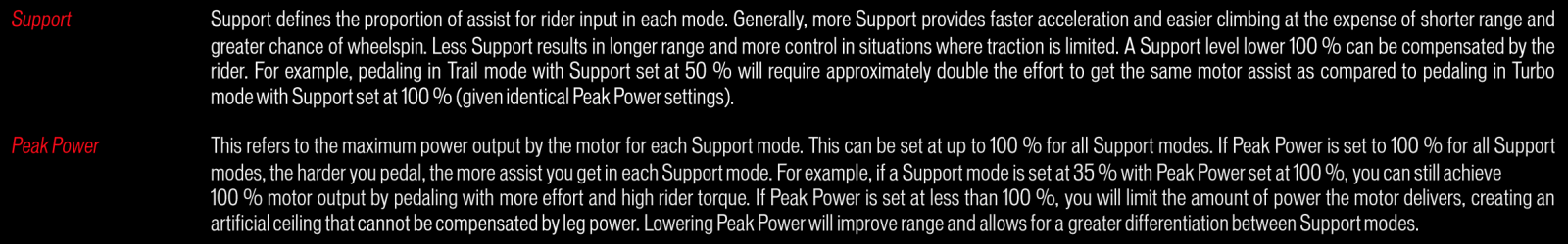

Also pretty sure that even if you have power at 100% with support at 35 you’ll never actually get 100% power anyway?
Specialized says it is possible. While 100% peak power refers to the maximum motor power, ie 240W, it is not totally clear what support is. It could be a % of rider input, if so then at 35% the rider would have to input 240 / .35 = 685W for the motor to be at max.
I wish Specialized would allow us to specify max rider power in order to guarantee that max motor power is within reach.
