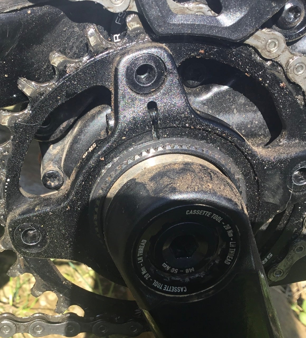

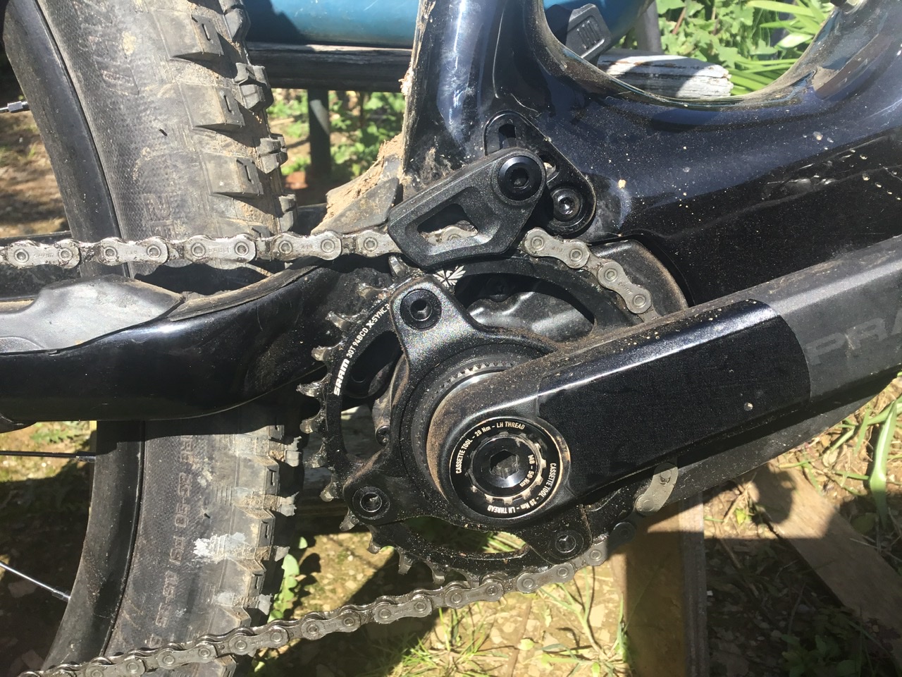

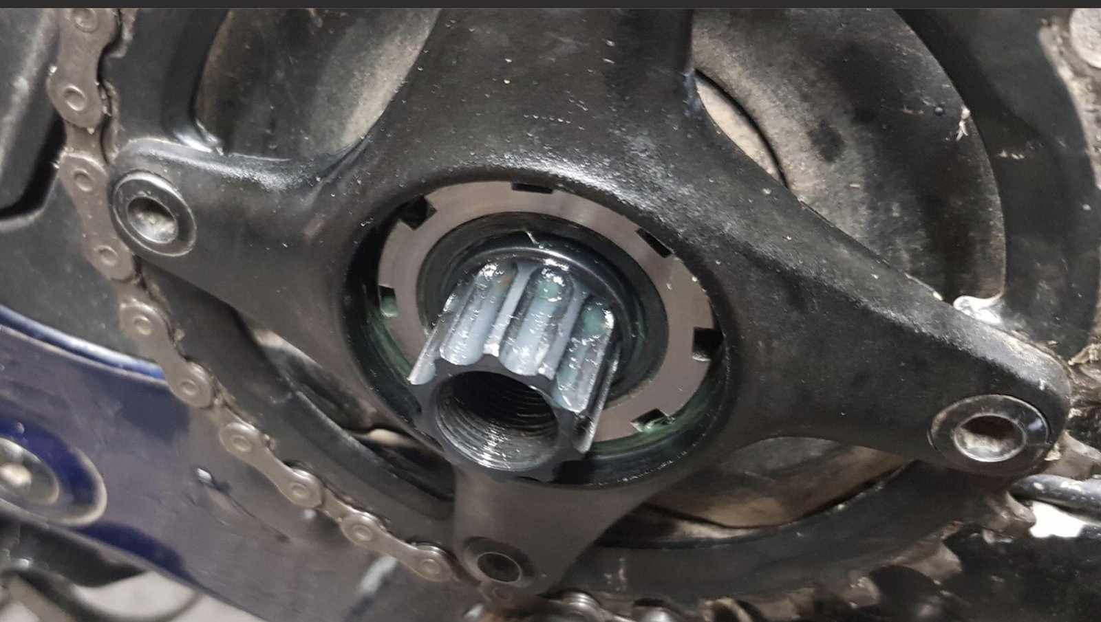

Took the chain and cassette off to give a good clean but couldn’t suss how to get the chain ring off. I slackened the pinch bolt on it but still couldn’t shift it. any ideas.
You need one of these.
You will also require the tool below to fit over the end of your ISIS crank.
Warning
Do not use anything else to do this task as you will risk pressing the crank shaft inwards which is NOT a good thing to do :(

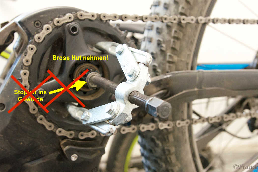

McInner1
Jun 8, 2019
228
173
Austria

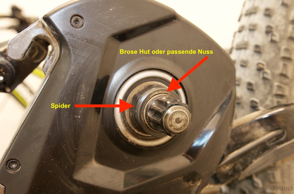

The extractor tool must not be placed against the crankshaft!
Use the so-called „brose-hat“.

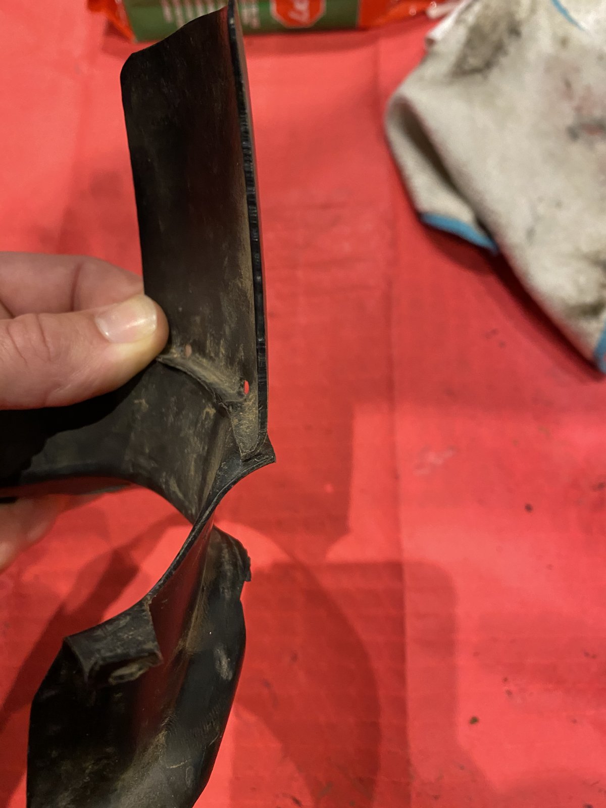

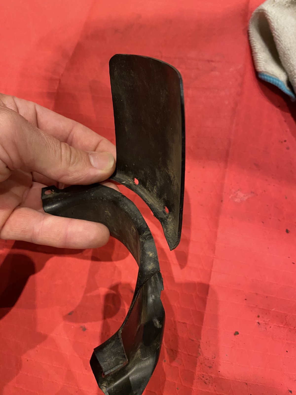

It would be cool to see a few photos to see how it looks. Tempted to do the same myself.
Sorry but it was on a hire bike. Forgot to take photos.
I basically cut the bottom section in the middle, moved it over and cable tied it down. Didn’t fit as snug as it does on the Levo/Kenevo but still functioned the same and worked a charm. Top section fits perfectly

Can you explain why please?
Is it because you could actually push/move the entire physical crank shaft sideways which is NOT a good thing to do?
If that is the case I need to buy the Brose cap :eek: and edit my post with the correct details.
I‘m sorry - I did not recognize that the SL spider is mounted in another way than the Levo spider.
My warning is for „normal“ Levo. (Maybe it is also valid for SL).
Levo: The danger is that by pulling the spider the crank shaft can be moved (pressed in).
Kiwi in Wales
Short cranks rule!🏴󠁧󠁢󠁷󠁬󠁳󠁿
Jan 24, 2018
1,241
1,589
Carmarthen, Wales
Thanks for confirming, that is very helpful and I will have to buy the Brose ‘hat’ as soon as possible. I will edit my post above too so it has the correct info (y)
