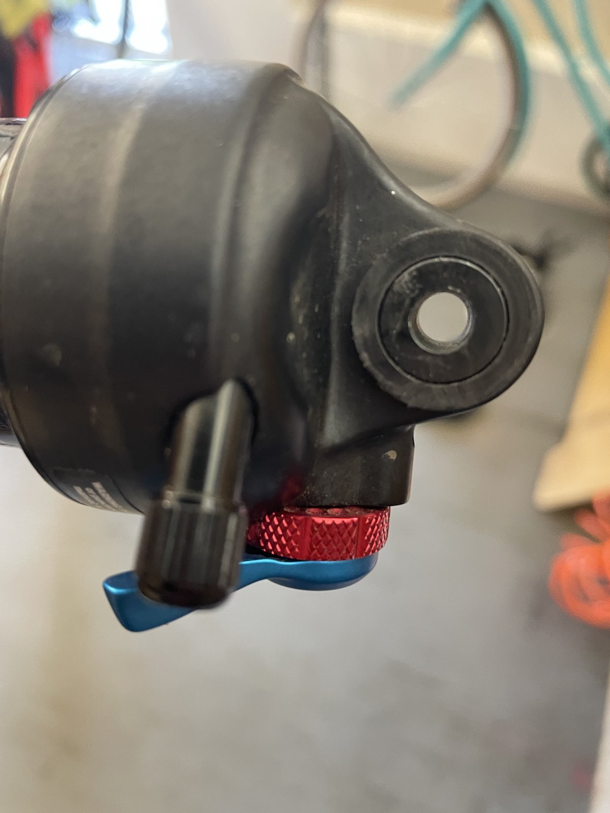

I have this one.
(I guess I just re use the flip chip on the lower part).

I have this one.
If you pull the black plastic rings off each side you'll see if beige IGUS type or press fit metal bushing. Yes reuse flip chip on new shock.
On my SL's DPS they are IGUS but on FF Levo metal press fit

Can I use the same shock bushings from my DPS on an X2?
its not the exact same size bushings as the DPS. If you use the DPS hardware your shock will have play. It needs bushings iirc that are 1mm wider on each side of the shock eye. I can't remember the exact size difference so please check. If you mount up the DPS hardware you'll see what I mean, you'll be able to push/pull the top end of the shock from side to side.

you mean slightly wider plastic rings ?
I'm not sure where I would check this?
Yes the outer plastic rings. I went to The Fox dealers Silverfish (was mojo) which is near where I live Hoping they had a couple of spares in a work tray. They didn't, and it cost me 18 effing quid for a hole new hardware set.😡

@apac I've just read some comments on the Marshall Mullin video and they say you can simply swap out the bushing from the DPS to the X2.
The X2 comes with the beige plastic bushings, so I will remove those and see if the DPS shock pin and bushings work. lol. I hope so 'cause I can't find any others to buy online?
Perhaps that will work, my DPS had the same beige bushing as the x2
Haven't had any issues of play here swapping hardware between DPS/X2. Running DPS now until X2 gets repaired. I have seen outer plastic washers with round tips so essentially slightly wider but can't find in stock anywhere.
Closest item in my area is this, but no metion of crush washers being varied or different between items, this dealer pretty extensive with spare parts

OK chaps, the X2 is on the bike, removed all the bushings from the DPS and put them on the X2, fitted like a dream.

Apologies if I added added any confusion over the hardware fitment. But I did have issues and needed wider spacers. Seems really odd that no one else has.
