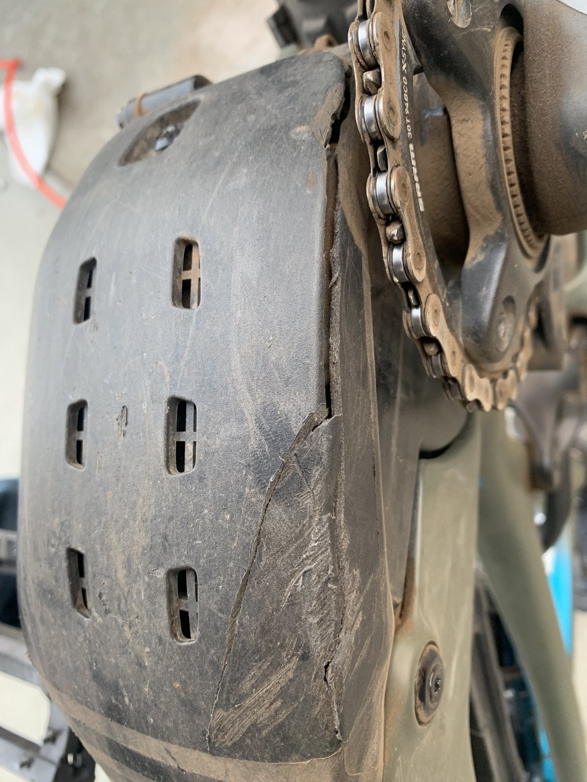

I have a 2020 SL Expert, and I ride some rocky terrain (new fav trail pic) and have cracked my bash guard (aka rock guard).
I'm looking at replacement options... weighing between just get a Spesh OEM replacment, or there are a couple aftermarket metal guards. I'm tempted to go aftermarket metal, but I'm wondering if anyone here has run one longer term and how it has gone. It occurs to me that the design of the OEM version might be semi-fragile on purpose.... meaning, breaking it is part of the design to keep the frame safe, vs having something unbreakable and transferring the shock energy to the bolt holes or elsewhere. or maybe I'm over thinking it. :)
thoughts?

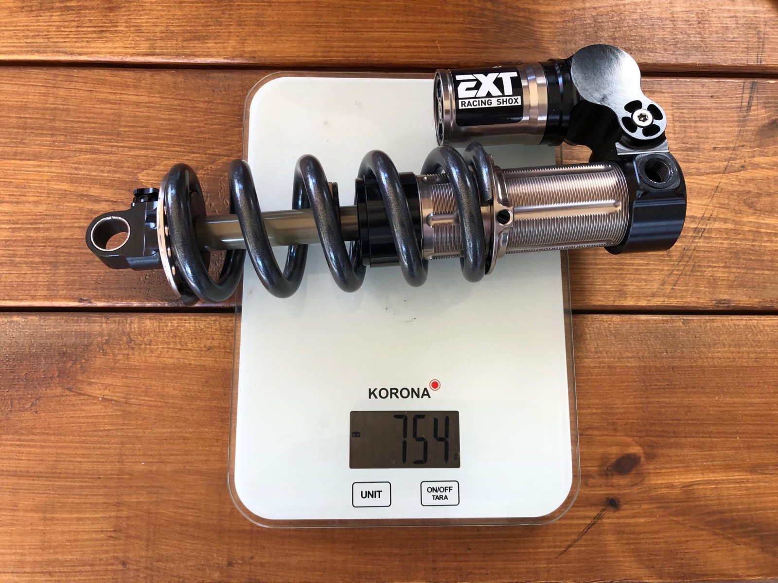

Hey guys, I found few inconclusive posts about shocks that fit with Range Extender, but majority of them not in size I will have, Medium SL.
Does RockShox Super Deluxe fit with RE on Medium ? Does Fox X2?
Also, did any of you buy those super cheap RS Super Deluxe that come as brand new take-offs from other brands? Lot of e-shops sell Deluxes that come from Santa Cruz and they seem to fit and you already have mounting hardware from existing shock. So only thing is the tune, but I can't see this being too different as both SC and Specialized use very similar linear kinematics (the shocks doesn't care what system is used, the compression is compression), at worst, reshimming is matter of 20 minutes.
I have an XL sized SL with an EXT Storia shock. The RE does not fit on mine so unlikely to fit on yours if you had this setup. But...I simply bought one of those little brackets that moves the water bottle mounting holes off centre to the right, and the RE fits straight in. I think it was this one: B-RAD Bottle Shift
Genial :- ) I thought I saw someone with similar solution but it was re-drilled holes instead of adapter, this is much cleaner.
And I presume it might even look better being more tucked-in.
Yeah Storia Lok 3 is def one of the main contenders as well :- ). This being wife's bike I wanted to keep it as lightweight as possible but Storia is still quite lightweight. Any chance you weighted up yours before mounting?
IF helps, this is from my specialized enduro (205x60) with relative heavy (550lbs) spring
