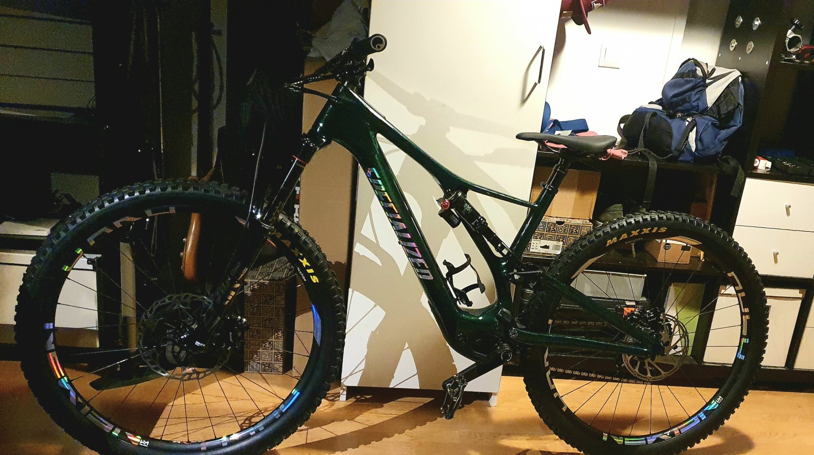

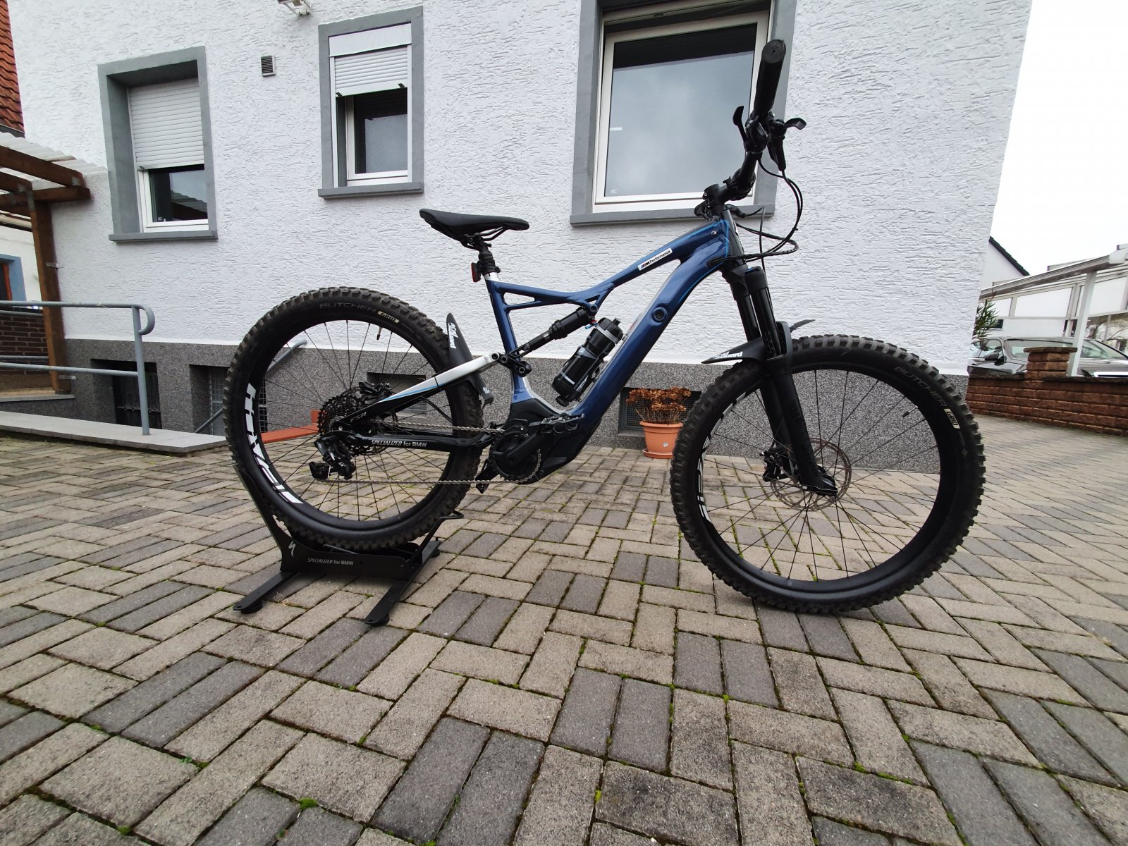

conversion finished!
can hardly wait to test the SL in the field ...
SL Comp Carbon
weight + -
SL Comp Carbonoriginal18160
shockdpx2170
forkLyrik RC2150
levergx 110
derailleurgx 11-90
casettee13 trs+-215
chainpc x10
brake adaptersram20
brakedisc FWGalfer 223mm30
brakedisc BWSram 200mm50
wheelsnewmen SL EG30-450
tireprotection FWcushcore250
tireprotection BWtubolight90
handlebarenve m6-180
stemnewmen 40mm-40
gripsErgon GE10
F tireMinion DHF 2,50
B tireMinion DHR 2,420
pedalsxpedo spry270
frame protectineasyframe20
mudguardmudhugger10
multi toolwithout cage-80
18185
the scales show 18.2 kg, so the table is pretty good...
kg.r. g.

Nice build! Regarding the inserts, why did you put Cushcore on the front wheel and the Tubolight on the back wheel?
gimmick_82
Oct 6, 2019
44
36
Vienna
i had chushcore in front and behind on ff levo at first, but wanted to save weight. tubolight has proven to be sufficient rim protection. I use cushcore on the front tire because it provides more lateral support. a friend had the problem that he pulled the tire off the rim when moving the rear wheel (curve with endo, don't know the right expression for it in english) with low tire pressure (17psi) I've been using the setup on the ff levo for 1 year without any problems. that's why I installed it on the SL too
... today i was able to move the bike in the terrain -> ingenious, awesome. agile and also smooth-running. feels great, I am very happy!

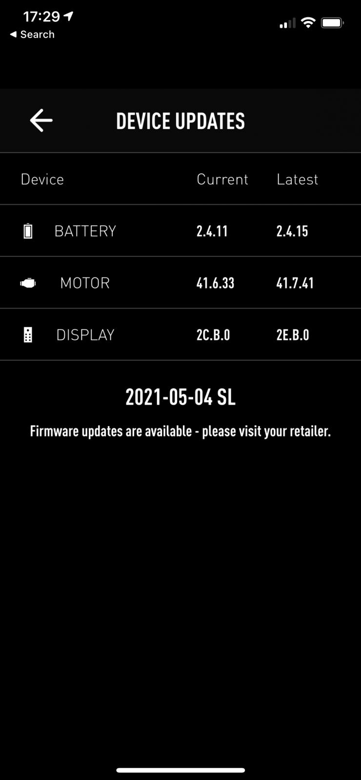

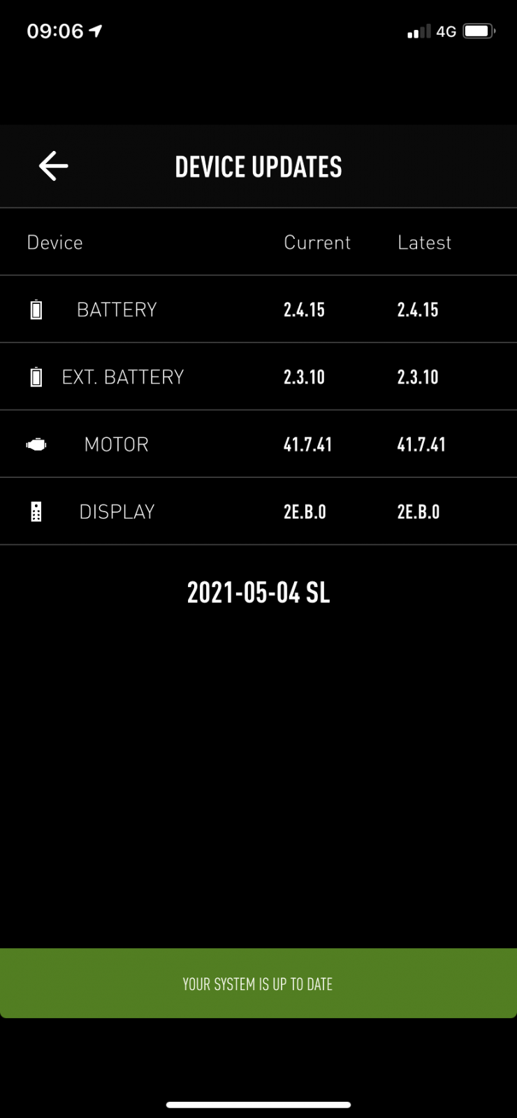

Has anyone updated yet? Trying to work out if it’s worth the trip to the bike shop as would prefer to take it to Berkshire Turbo (about 1.5 hours away). The time is the first concern, the bigger concern is I’ll buy another bike whilst I wait…..
Updated 26/05/2021 at the bike shop; took them under 10 minutes to do whilst a waited. Seems a decent upgrade to me.
E759
Jan 20, 2021
16
West Sussex, UK
Can you explaine motor surge
More power ? Torque ?
When riding at slow speed on minimal gradient power could be delivered too quickly causing the bike to surge forward at an excessive acceleration. I.e. acceleration needs to be tamed depending on conditions (rider input, gradient, etc.).

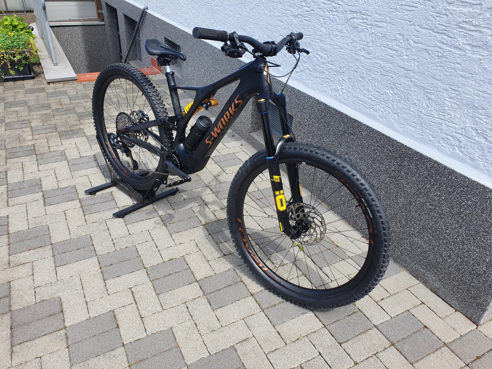

Rotzi
Jun 5, 2021
Hello there,
I'm new here, 30 years old from Germany.
I have got this 2 levos (bmw version and the expert), mondraker, the heckler and levo sl comp carbon over the last years.
The sl was and is the perfect bike for me and I enjoy every ride. Don't need the full power of the normal e-bike.
Now I have had the chance to get an S-Works sl for a good price and couldn't resist. I ve got it from Itali and after riding the first hours Unfortunately, a very loud rattle from the motor can now be clearly heard, even at a low cadence.
Have any of you already experienced how Specialized deals with such a case? A local dealer said he could remove the engine and complain for warranty, but would take a service charge of € 200. Find it a little too much to be honest.
So maybe another dealer would take it over, but just because he complains doesn't mean that Specialized would accept it. The noises are clear, I've driven several levos and the engine occasionally cuts out.
I can also send the bike to Italy and the dealer would take care of it, but if possible I would like to avoid that.
Sry for the long post and thank you for ideas how to move forward.!

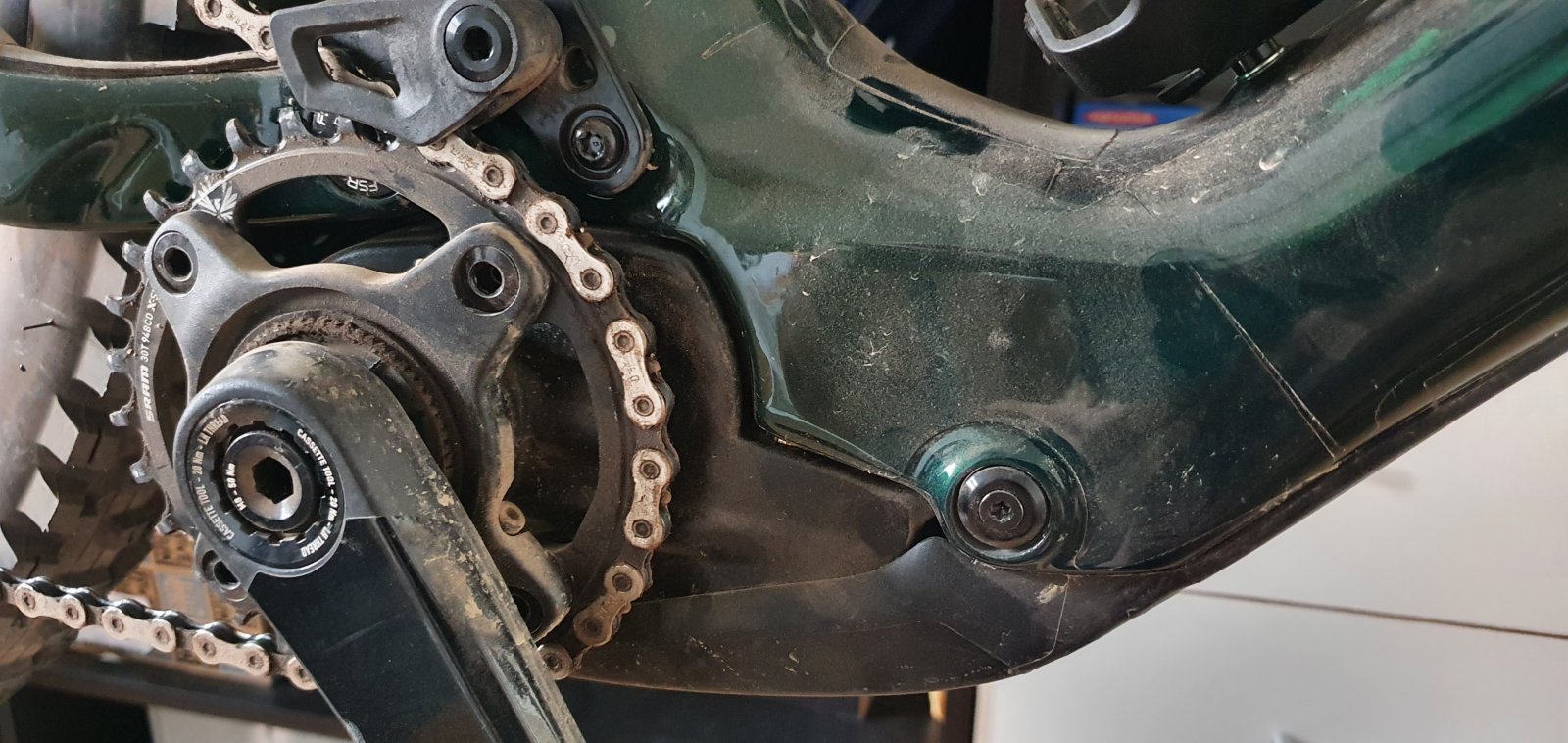

Hi,

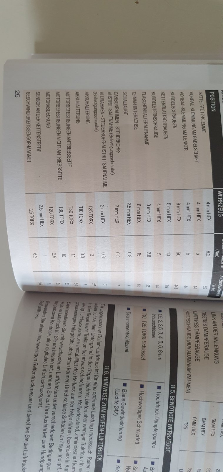

I wanted to check the torque on the motor mounting bolts today. It occurred to me that there was no T30 on the drive side as described in the manual, but rather T20 and T25 screws. The instruction manual does not seem to be up to date.
Where can I find up-to-date instructions and how much torque should the screws be tightened with?
