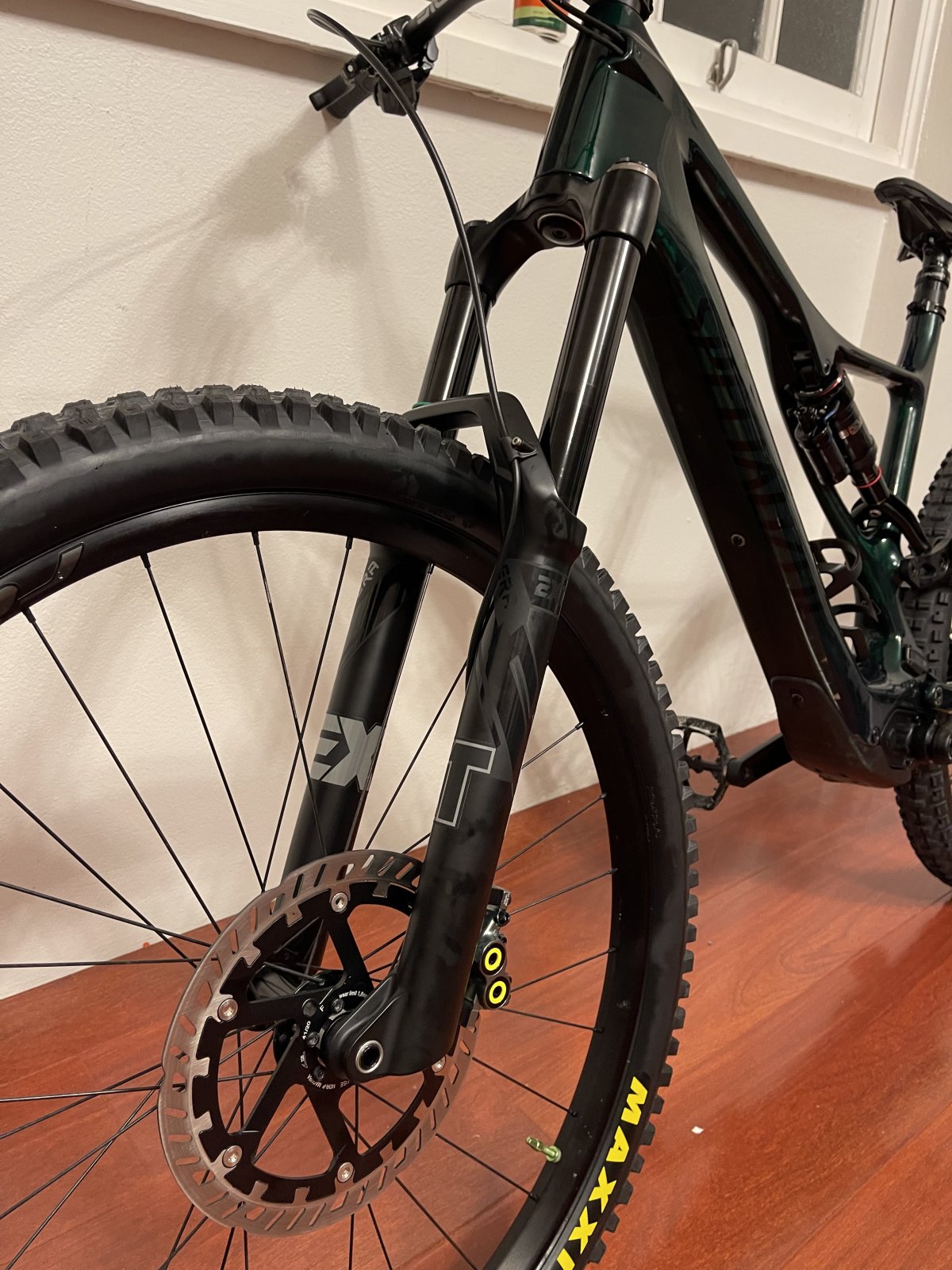

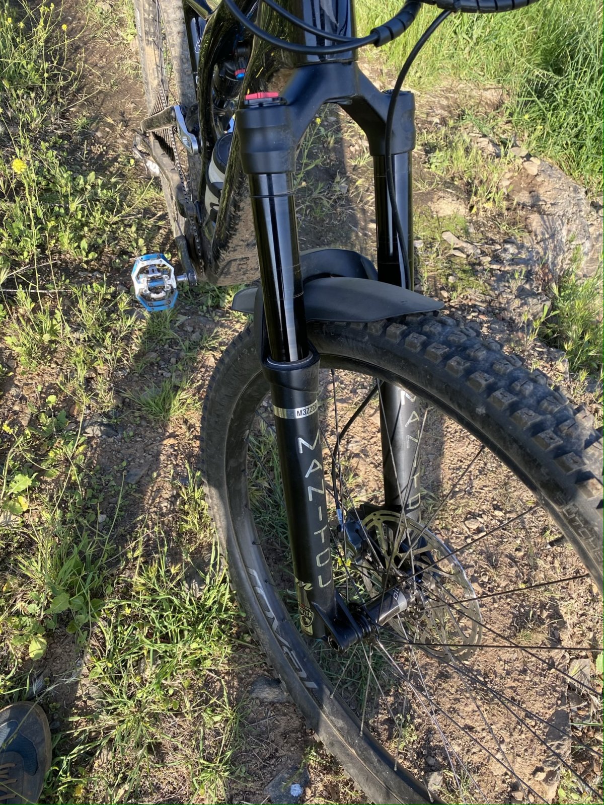

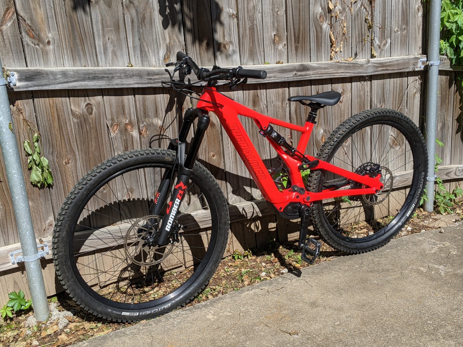

A bit of an update - got a Manitou Mezzer to replace the stock Rhythm 34. The 34 wasn't bad, but I was hankering for bit more travel and big hit capability. Plus, I am a fan of the dual positive airchamber setup after running it on my Kenevo's Lyrik for a year or so.
First run was yesterday. Damper is a bit firm, but the fork is STIFF, composed, and plush when it gets rough. Going to tweak the settings a bit for small bump, but I like it so far. Oh and it's only 80 grams heavier than the stock fork after steer was cut. I can also adjust the ride height internally from 180mm to 140mm, and I may play with that as well. Got the fork for $800 which was the kicker given it's capability View attachment 29542 !
How are you finding the mezzer a year on? I’m very tempted to replace my 34 with this
It’s great. Easy to service and tune at home. I haven’t compared it to latest and greatest from fox and rs, but really the only fork I would consider other than this is the ext era
Just to chime in here. I went from the Fox 34 to a Lyrik (SL Carbon Comp). Upgraded the Lyrik to a charger 2.1 damper. Found a good deal on a Mezzer Expert so decided to give it a try. I am very impressed with the Mezzer. Plush yet supportive and easy to setup and adjust. Very happy with this fork.

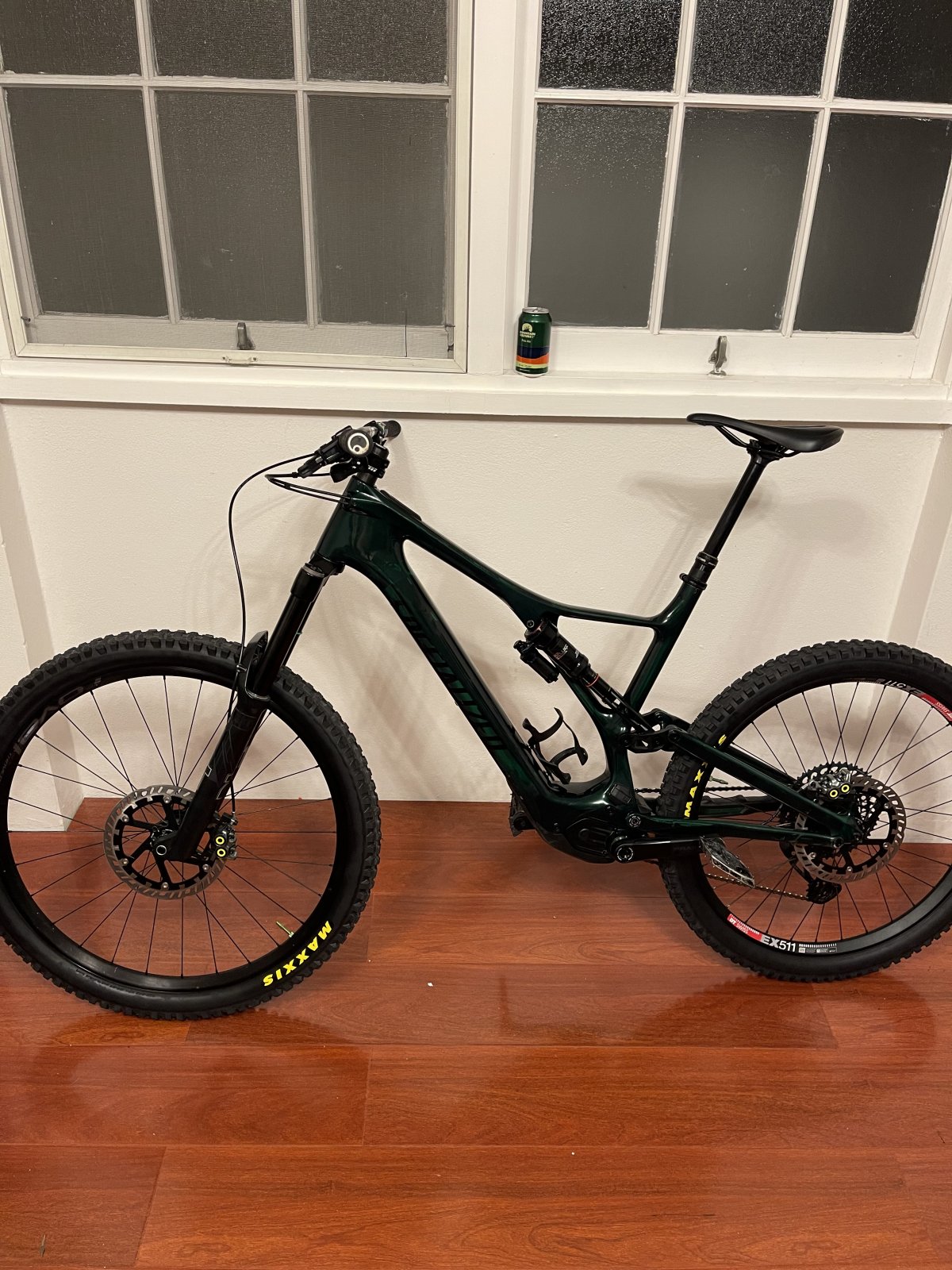

Just got my SL back from the LBS. Mullet, GX AXS, EXT Era 170mm, Magura MT7, 220m rotors, 165mm cranks, Cascade Link. So good. Thank you very much @Christian for the advice.

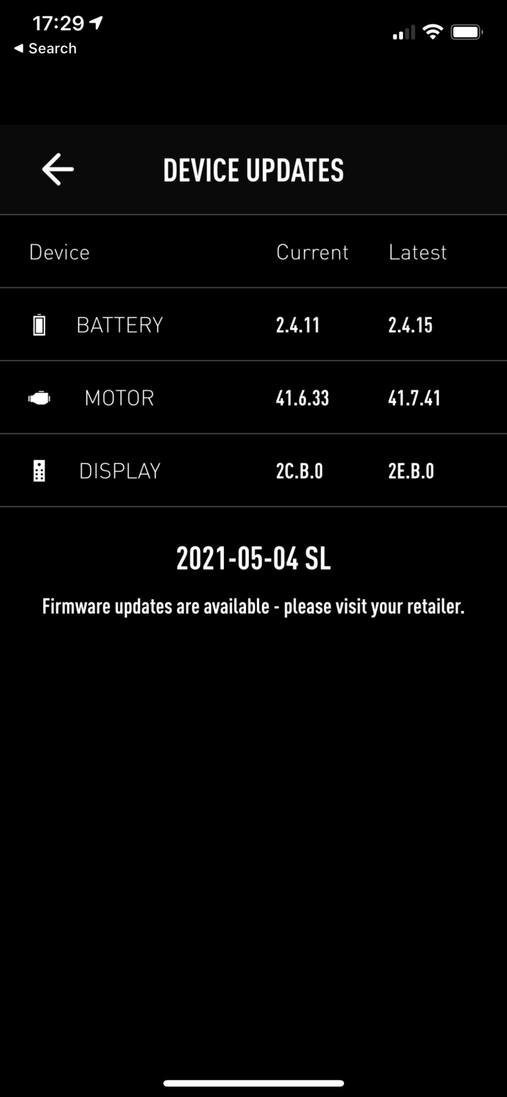

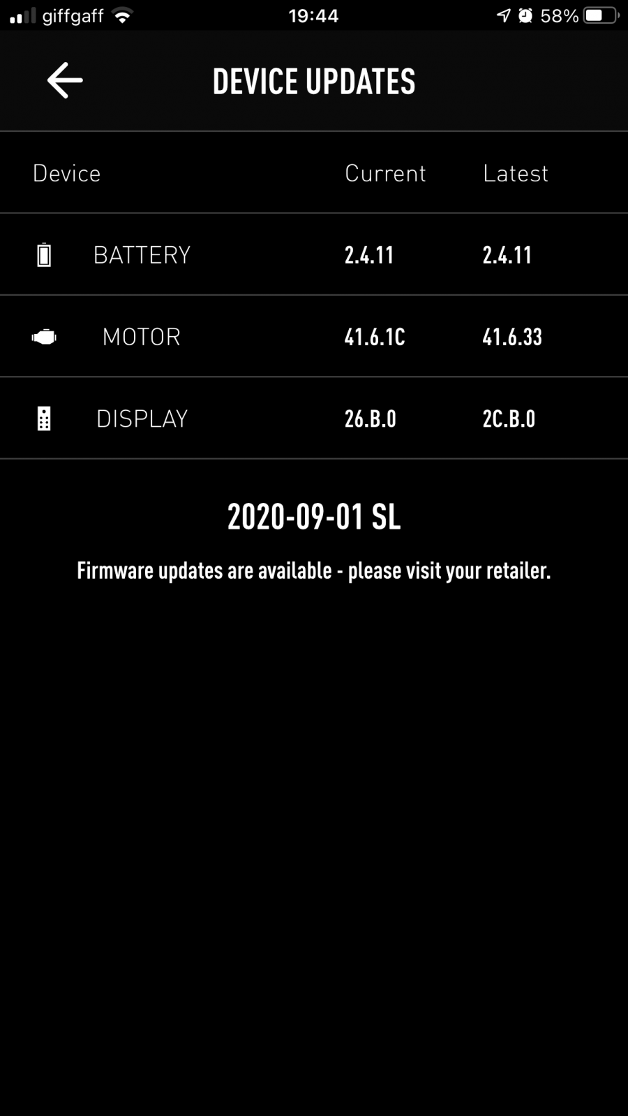

Apologies if this has been covered, what’s the deal with getting firmware updates for the SL? The shop I bought from is definitely not local, is it worth getting it done and who has paid/been charged what and where? Cheers
ridingintheoc
Dec 15, 2020
7
California
My local shop did mine for free. I was surprised because it was not the shop where I purchased the bike.
It was well worth taking the time to do the update. The motor feels much more smoother.

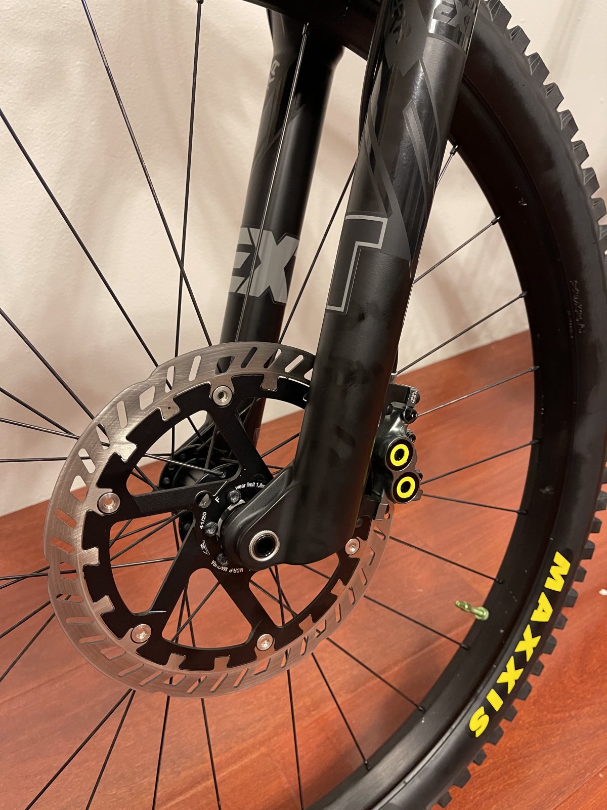

Swapped the fork for a Zoke Z1 coil. 44mm offset and 160mm travel. Awesome fork. Put a 220mm rotor on the front and moved the 200mm to the back.

Has anyone updated yet? Trying to work out if it’s worth the trip to the bike shop as would prefer to take it to Berkshire Turbo (about 1.5 hours away). The time is the first concern, the bigger concern is I’ll buy another bike whilst I wait…..

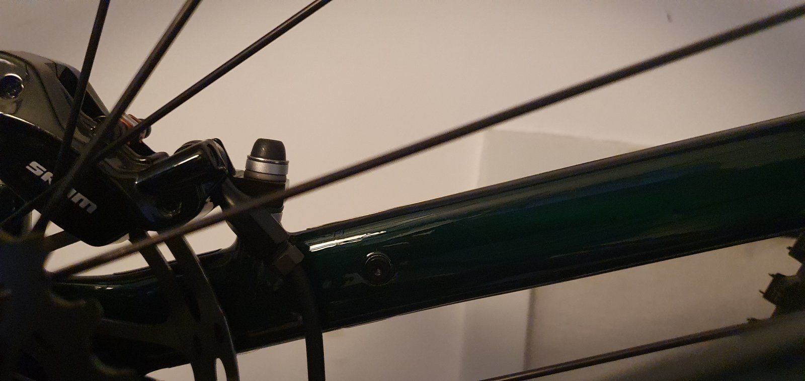

Hi folks,
yesterday I swapped my fork on my SL and was surprised that the lower ball bearing of the headset sits directly in the carbon frame. So there is no metal sleeve or something like that ... is that ok so..? Is that normal?
and one more question: on the seat stay there is a screw on which, I guess, there should be a fastening for the brake line, (picture). Is that always missing on the SL? Or should there be such a fastening as on the Levo...

Pretty certain that my bike has a bracket attaching the brake line to the frame using that screw. There are two brackets and two screws from memory.

My SL doesn’t have that bracket, my two Kenevo’s I had did have them.
Also no sleeve in the headset.
