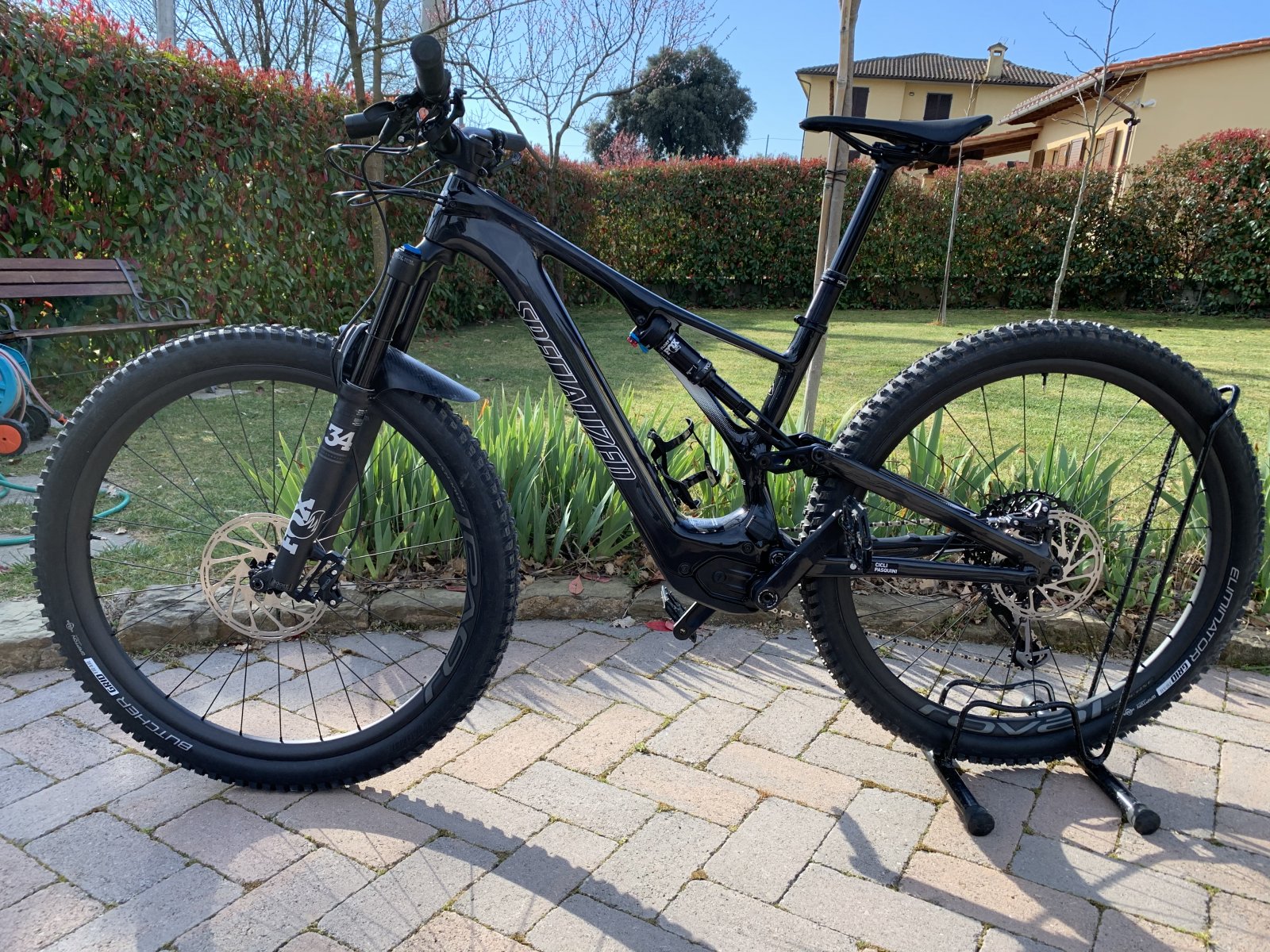

Guys, joined the club this week. Rode 40km: amazing!
just 2 questions:
i've seen that you put the mudguard on rear, no concerns about the carbon frame with the zip ties? (My first carbon frame)
i've the xt at home from previous bike. I feel the difference with actual g2. I can not decide if repalce them with xt or let them change my opinion..
some mudguards come with the zip ties as well as protective film, you definitely want to use the tape not just because of the zip ties moving but the whole guard might move a bit , ask me how i know
as for the brakes, i like the g2 as they let you adjust the lever all the way out with firm initial lever travel, not spongy

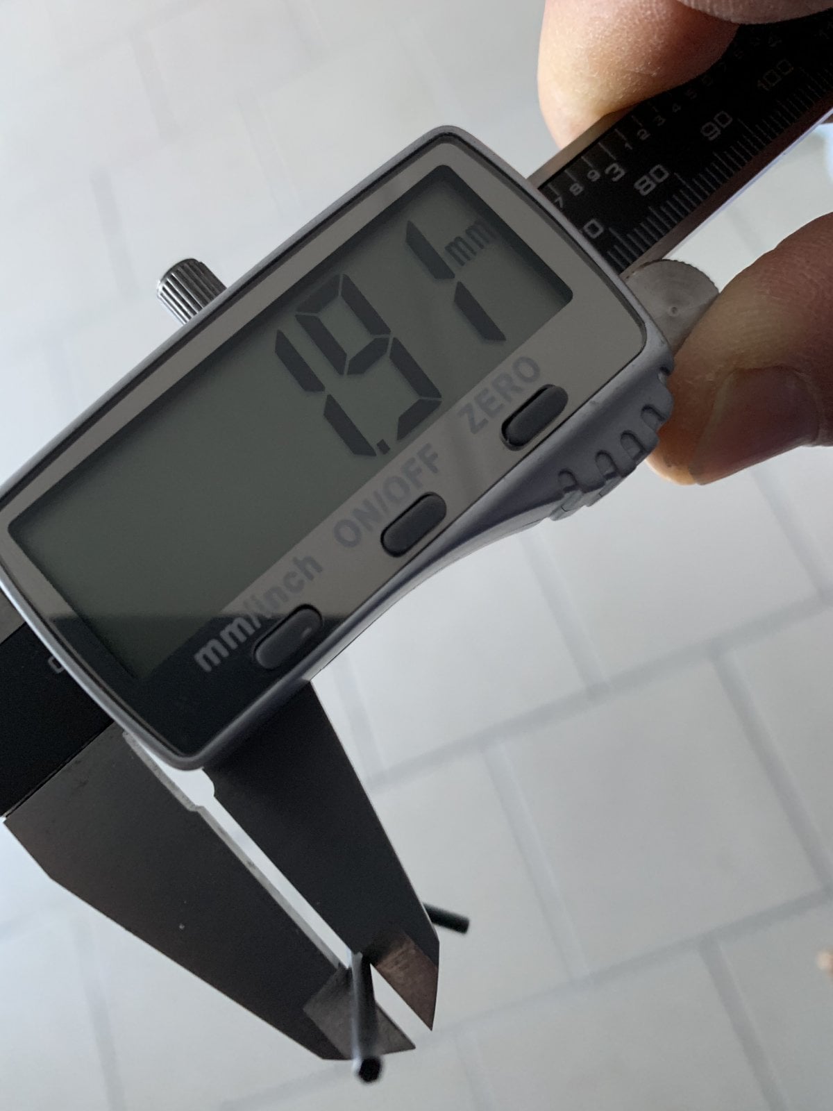

It’s not any size of Allen key... it’s a Torx T10 head on the screw. Using an Allen key will damage it.
It seems that you are angry for something and you need someone to relax... if i post a picture with a measure (accurate!) do you mean it's “any allen” and you put a disagree also to my post! Wow man you have to solve your internal conflicts.

It seems that you are angry for something and you need someone to relax... if i post a picture with a measure (accurate!) do you mean it's “any allen” and you put a disagree also to my post! Wow man you have to solve your internal conflis.
Apologies... I thought the controller you were referring to is the TCU. Too many people have been handing out mis-information about this advising it’s an Allen screw when it’s actually a Torx.
