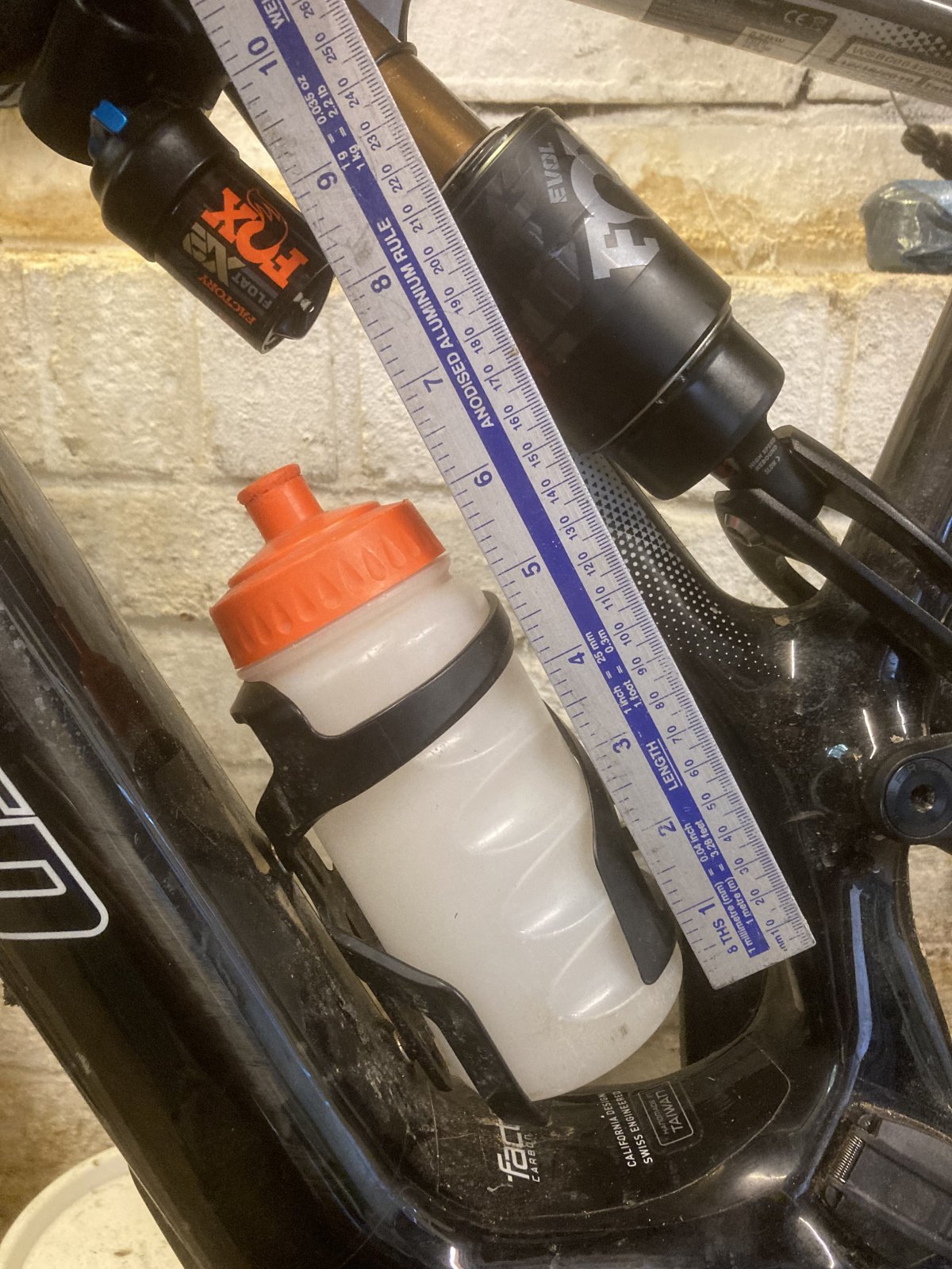

I have an XL sized SL with an EXT Storia shock. The RE does not fit on mine so unlikely to fit on yours if you had this setup. But...I simply bought one of those little brackets that moves the water bottle mounting holes off centre to the right, and the RE fits straight in. I think it was this one: B-RAD Bottle Shift
Is this another solution?

RE fits with X2 210x55, size M using wolftooth b-rad to get a little extra clearance. Also 24oz waterbottle fits with about a 1/4" to spare, 8.5" H. I like the X2 a lot, similar feel to coil but better all-arounder for both trail and descending.

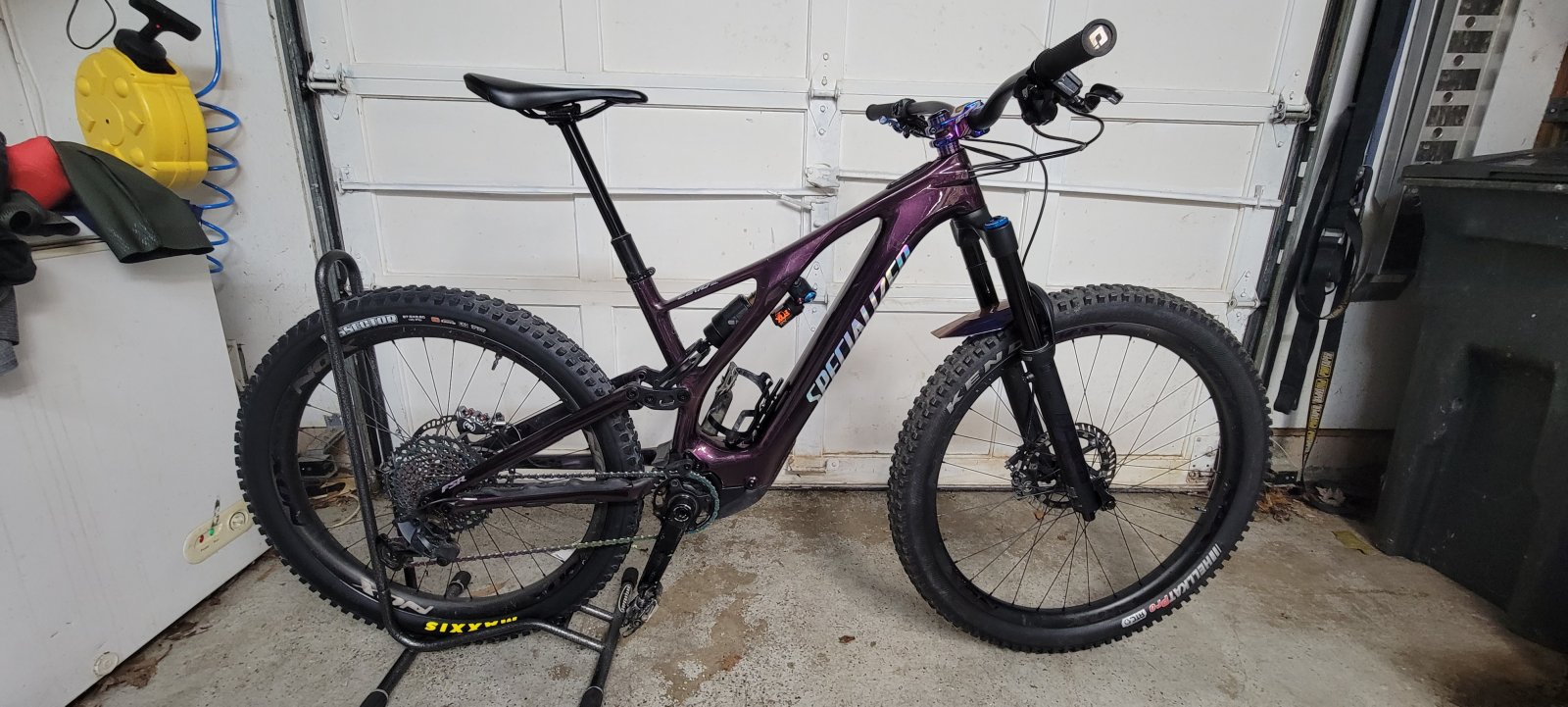

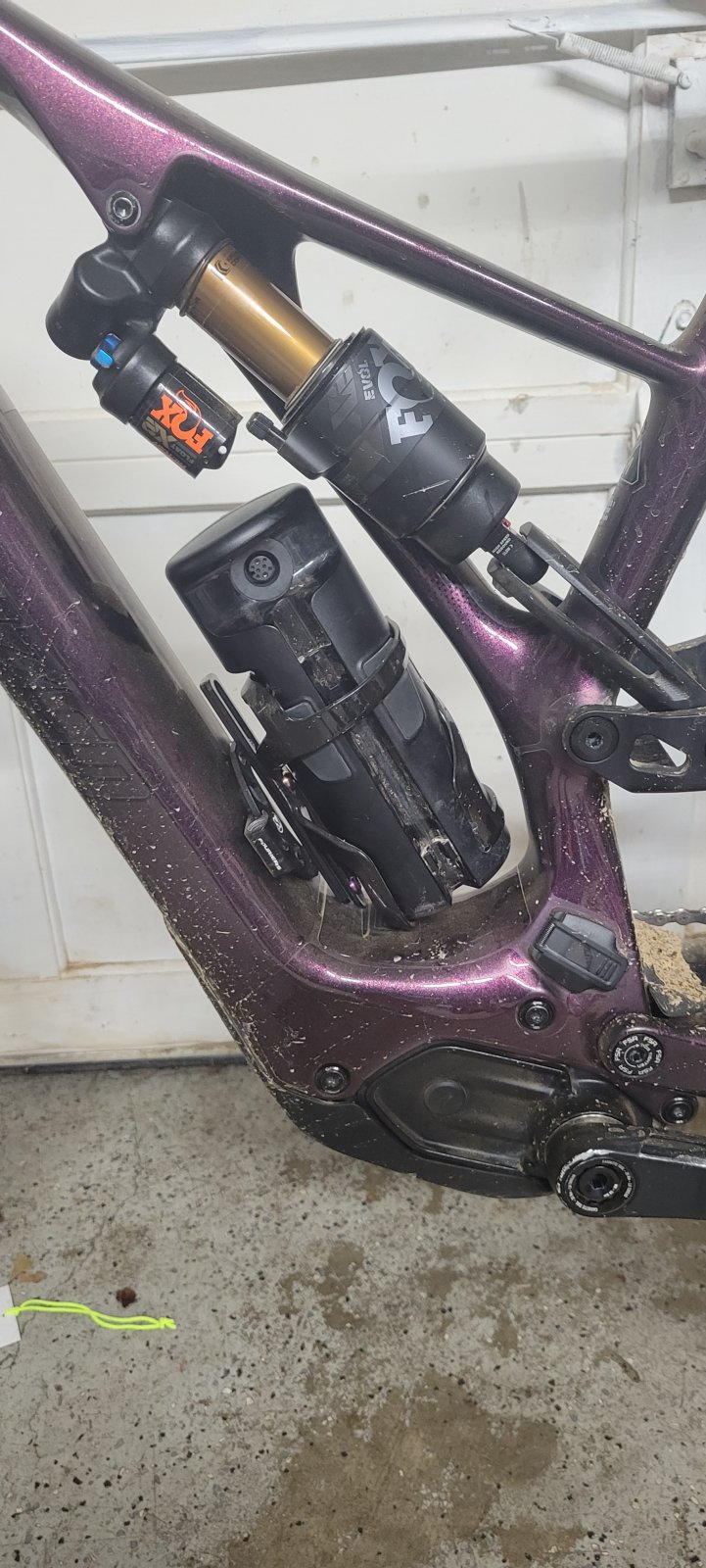

I've been running cascade link + 210x55 X2 for months on M comp carbon, there's no frame interference. No offset bushing but running mullet wheels.
Do you have a photo of your setup somewhere here? Would love to see this combination (X2 + Mullet in Medium), we also have Medium Carbon.

And it's 34.9 or shimmed 31.6? I can't tell, but looks like the former right?
If so, how much can you slam it into the frame? Or is that already a maximum? I would be very grateful for the minimum distance between bottom of collar and top of frame.
