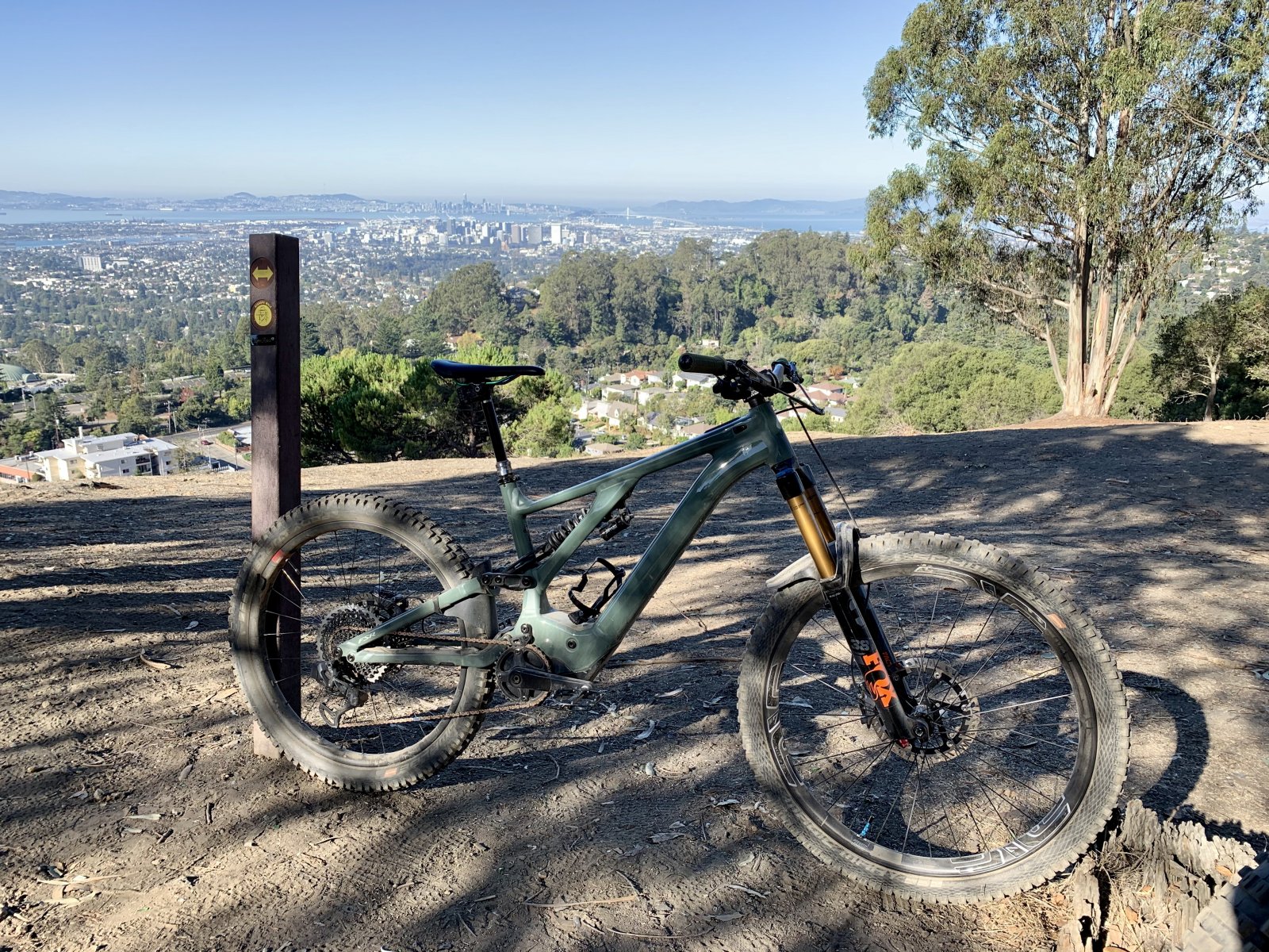

Did you measure the bottom bracket drop on the new set up at all? I'm looking at doing the same but concerned the longer 29er fork with make the bb drop too small.
did not do actual measurements, just in my head
going to ride and go by feel. i'll measure after the bike feels right on all the types of terrain on my regular trails. also will see if i'm faster on strava
if it's an improvement i'll keep the set up
it's an extra fork i already had. i sold my Enduro it was previously on so it was easy to try out
for the purpose of providing info in these forums, i'll measure and post info soon as i will be doing a lot of rides this weekend

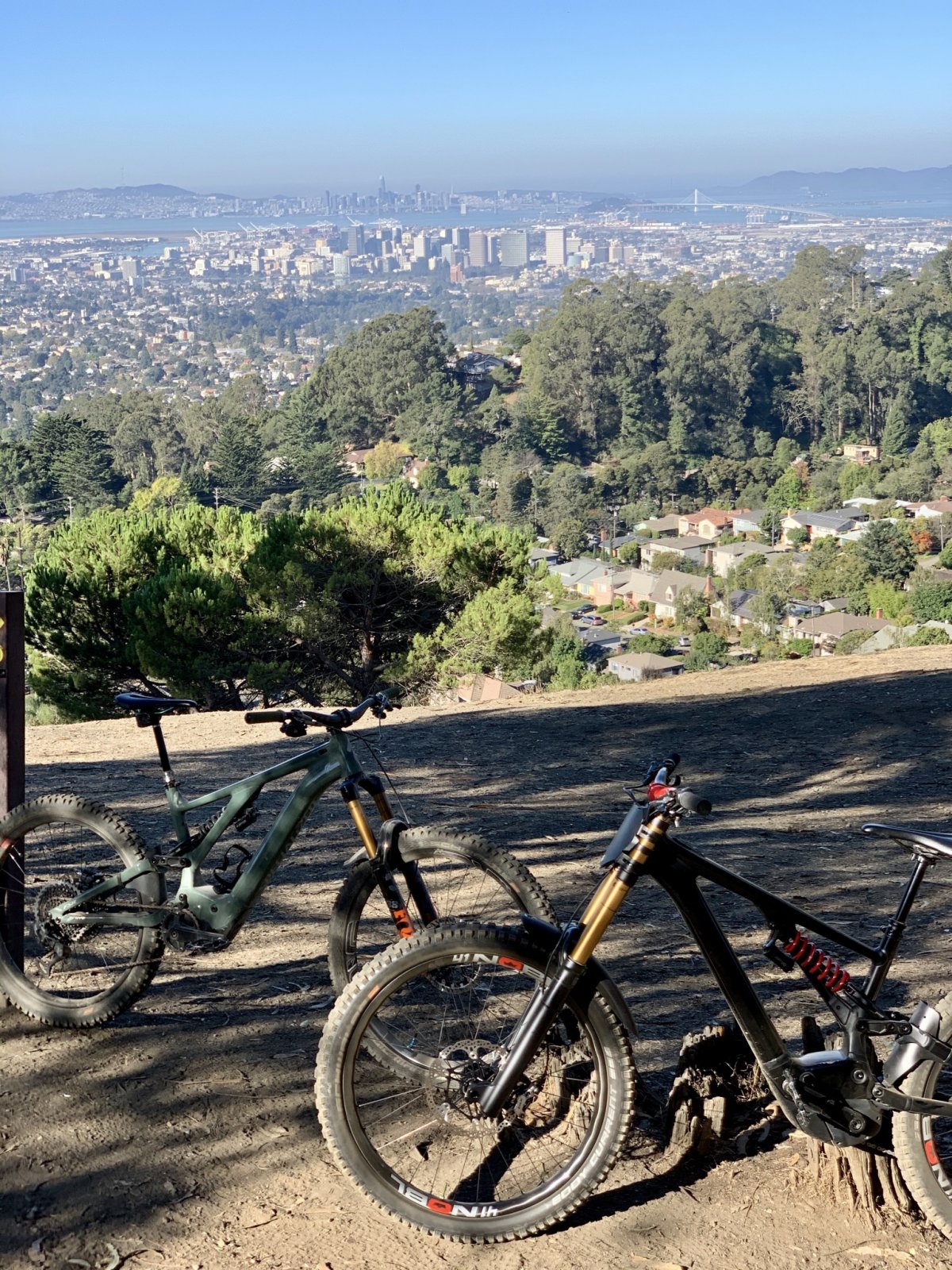

I guess all i had to do was flip the rear chip to the high position in order to get it to turn better
It’s a more playful and livelier set up with the 38
Even though the dual crown boxxer plowed through everything the ride felt dead
The 38 with 29er wheel still tackles the terrain with ease. I do have to fling the bike around more on turns with the big wheel up front, but it’s fun
Fox Factory dampening is real good. So much more comfortable than the boxxer select. I know it’s not an equal comparison, just comparing from stock set up. I like how it’s easier to pop the front with the lighter fork
I need to add more air to the fork since the psi is still set to the analog bike it came from. Currently have 1 token and may need to add another
Definitely going to keep this set up until my fox 40 arrives in December. Ordering SC Reserve DH 29er wheels to replace the borrowed front wheel.

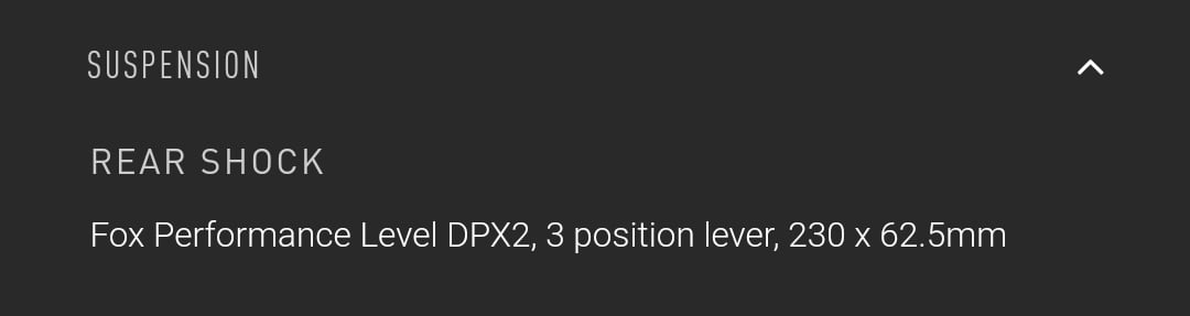

Actually since we are on the subject, I do have an odd experience.
I have mounted and unmounted the shock a few times now to try different springs. I have noticed now that when fully extended, the shock doesn't actually fit the gap on the bike. Holes don't line up to get the bolts in place, eye-to-eye on the shock is a couple mm too long. This is with zero spring tension. I have to set the damping to max, then compress the shock and push the upper bolt through before the slow rebound makes the eye-to-eye too long again for the bolt to go in smoothly.
Anyone else ever have that experience? Once in place the bike rides fine, but it's weird for removal and installation.
Stormhard
Oct 8, 2019
18
Uk
Does the shock still measure 230mm, eye to eye?

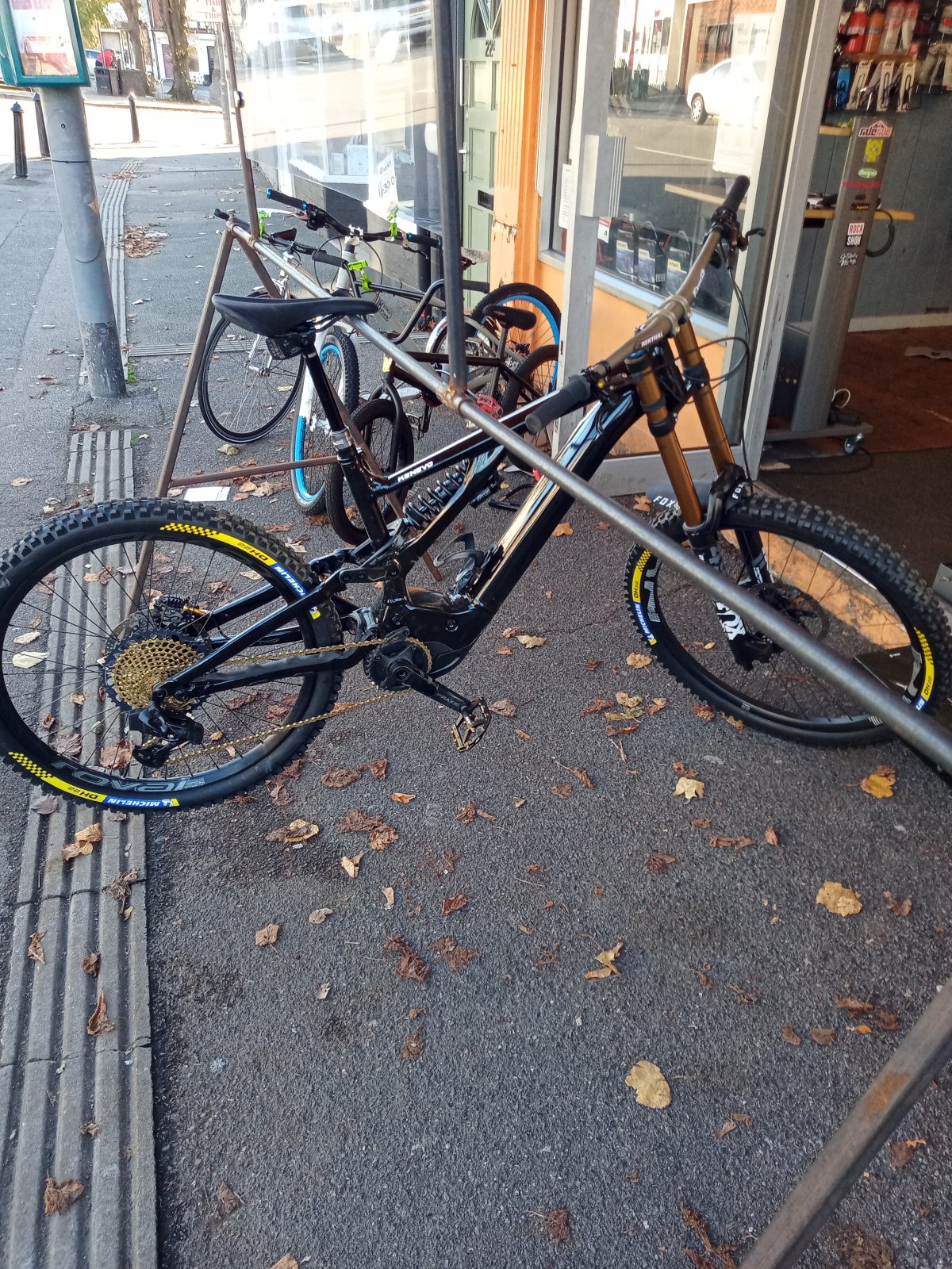

Neil Grady
Nov 6, 2020
8
southampton
Shimano saint brakes
sram eagle axis wireless drive train
eagle wireless dropper
240 watt battery range exstender [ i now have 940 watt for long rides]
rental bars
deathgrips
e thirteen race dh front wheel
michelin dh 22 tyres 27.5 rear 29ner front [tubeless]
ht evo me03 pedals
fox 49 fork
custom wrap by Essential wraps
levorapter tuned
Love it
Gonna change bars to black tinker a few other bits here and there and shes done
