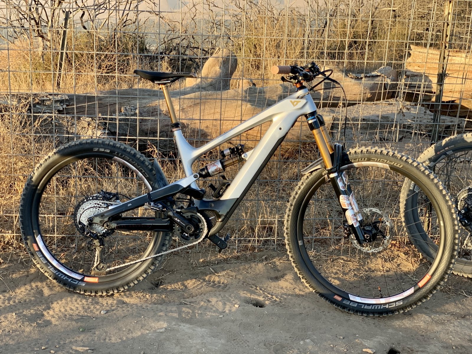

I’ve been riding Levo Comp mullet, 160mm Lyrik Ultimate and coil shock. Love it!! Trail, bike park. Anything. I am considering the Kenevo Comp 2020. Anyone has Ridden and compared back to back Levo vs Kenevo Comp? I am considering shifting to a Kenevo but no sure how sluggish would be on rolling/technical trail riding where I ride most of time. Thanks.

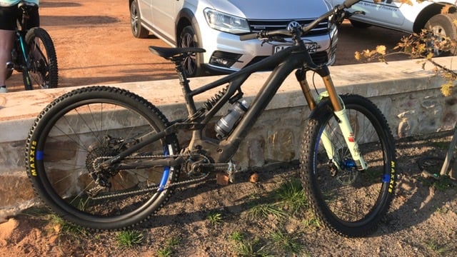

Just wanted to intro myself as I’m new to the forum . I purchased a Kenevo expert after riding a Levo and absolutely enjoying the ride . Didn’t like the stock expert ride so decided to do a few mods .
2021 Fox 38 pistachio 180mm
220mm sram front rotor
50mm Lyne stem
800mm cSixx carbon End bars
Cane Creek lower race mod
160mm Lyne dropper post
Hope Pro4 hubs 28hole
South Carbon enduro 30mm rims 28 hole
Maxxis 2.5 Assagai DH casing tire front
Maxxis 2.4 Dissector DH casing tire rear
cSixx extra thick Foamo insert rear
2021 Fox Float X2 230mm x 65mm
still waiting for bits
Sram AXS Eagle upgrade kit
10-50 cassette
Ride Wrap tailored frame and fork wrap
The mods so far have transformed the bike into an absolute freeride beast , no more pedal strikes in rock gardens and it rolls through just about everything I care to put it through .
I have found myself using eco mode with 5% assist on most climbs and turbo mode on the decents for getting out corners quicker .
I am riding more now then I did when I was racing full time in my 30’s.

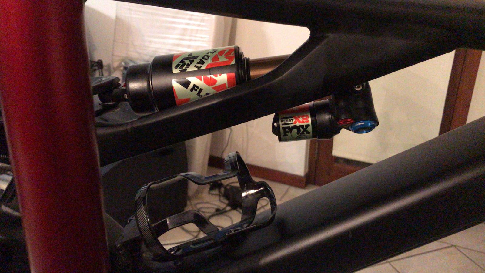

I had sent you a PM , but maybe is interesting for others . I had try to mount an X2 2021 and in full compression the main reservoir slightly touch on the side of the frame ( where all the cables go trough ) ... I have a 230x65 as yours . Let see if you had experience this problem and how did you solved it :)

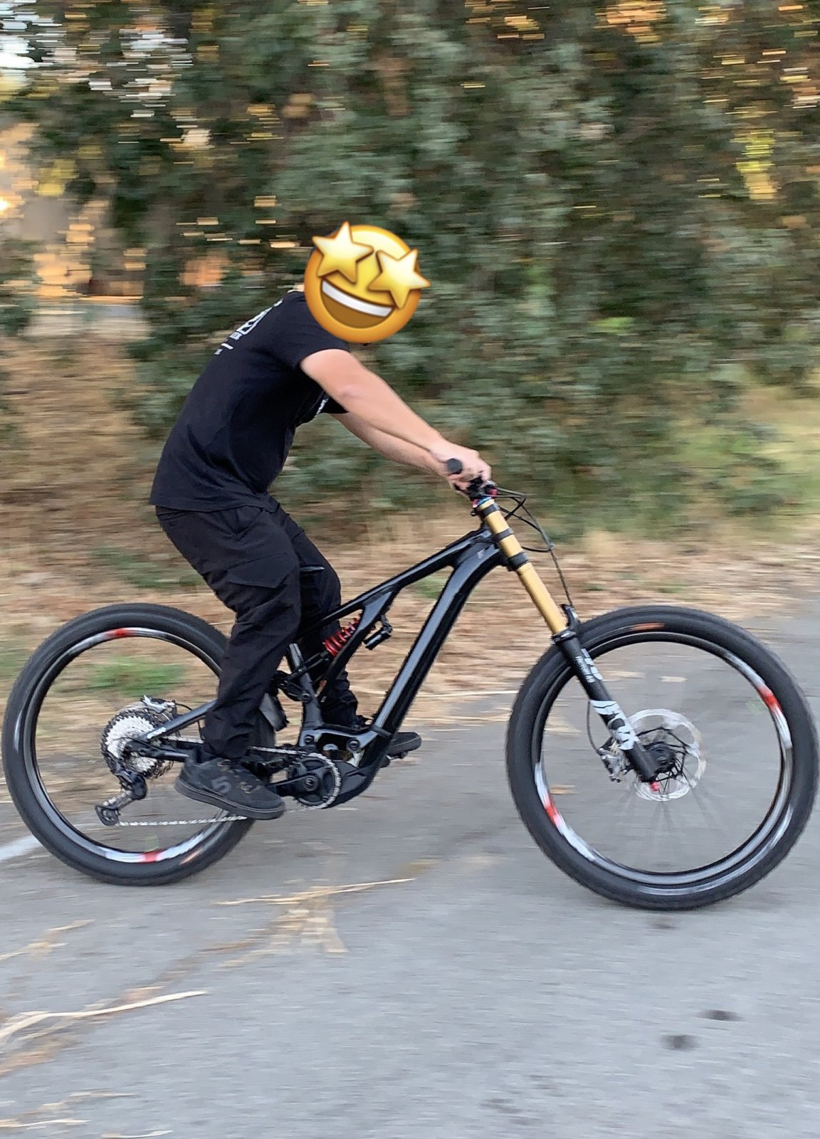

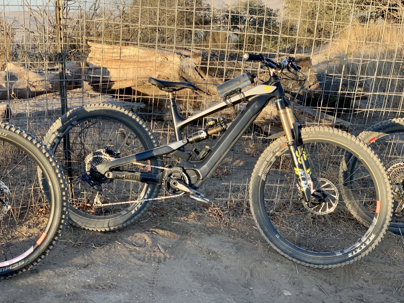

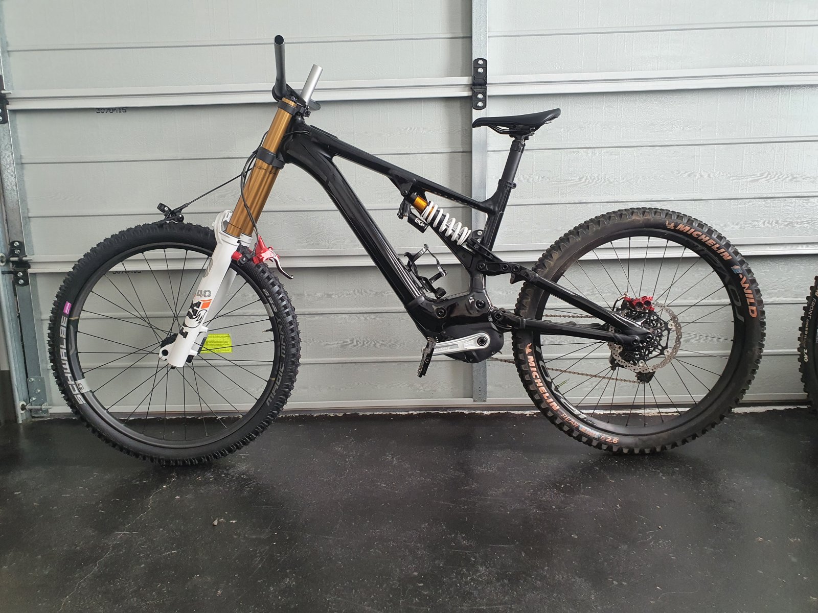

My 2020 Kenevo mid transformation. Size S4 with 200mm front and rear.
Going to run a XO1 DH drive train.

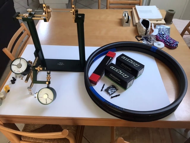

Waiting for the rear wheel to be built kind hub with crank brothers synthesis carbon DH rim.
Waiting on axs dropper.
I just wanted to get it rolling to check for clearance, HA and BB Heights.

2020’s Kenevo Comp vs Levo Comp.
Hi Spangol , yes you will get the air can touching , you need to remove around 2-3mm of the edge of the side stay where the can touches with a file , it is very little metal being removed over a 10mm area , you are basically rounding off the edge , then the X2 fits perfect .

Danrodcr , I ride both bikes , in a previous post you will see the mods I did to my kenevo , I did put 29” wheels on it , so it rolls very much like the Levo , it does have a longer wheelbase so if you’re not to good a tech rider you will feel the difference on tight tech trails , but in general I prefer riding the kenevo as it just soaks up anything and rides well on all terrain . The stock kenevo is very low and with a very linear rear end and a coil spring , it peddle strikes everywhere which the Levo doesn’t do much , the Fox 38 and X2 air shock and 29” wheels transformed my Kenevo into a bike Specialized should have produced imho
That ride is a beast , you are going to enjoy it a bunch . No more pedal striking either . You may find the coil shock will run a little deep in its travel because of a very linear kinematic on the rear suspension, I went to a 2021 X2 air shock and it transformed the bike into a much better balanced bike . I don’t like a bike that doesn’t have a good front to rear balance because it lays out the front to much on big hit landings which makes for a floppy front steering .
Just my two cents .
Enjoy the ride
Thanks man, yea I have ran it with the 2021 x2. It go alot of stiction with it and the air can hits the cables/frame. Definitely pedal better though.
Im also running a cane creek progressive coil and it feels completely bottomless.

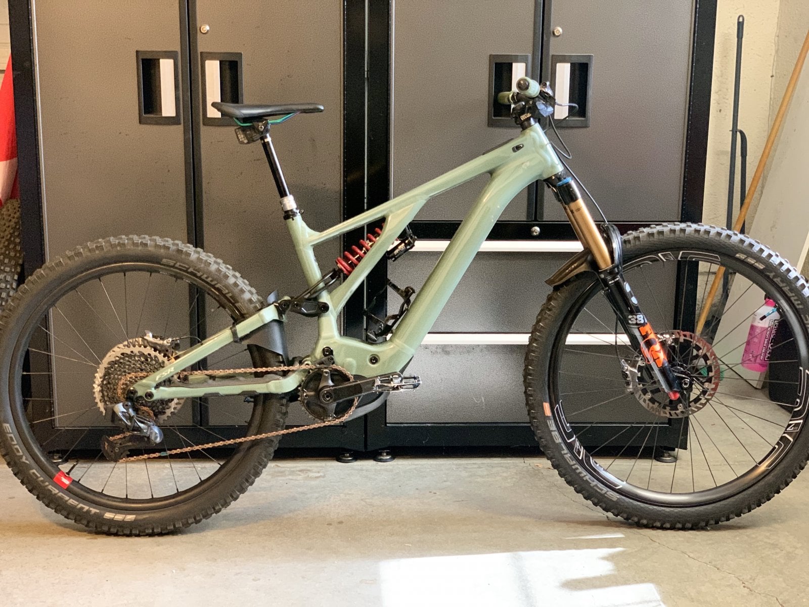

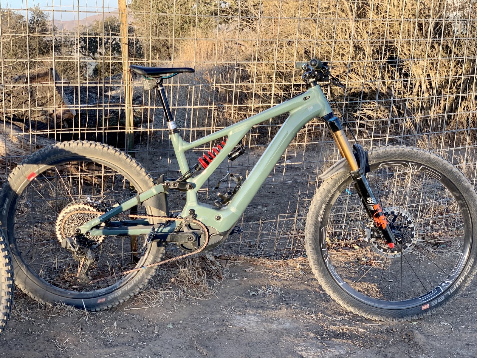

Still getting used the mullet set up
steering feels way different with this fork and 29er wheels
It was more sensitive turning. It had oversteer at first and I found i had to lean the bike more to correct
going to switch to a longer stem and drop the bars a little
As far as suspension goes the 38 feels so much better than the boxxer select it came with. Add 29” wheels to the mix and rolling over chunk at speed is a breeze
I’m going to play around with this set up and keep it this way. I think I could get it to be more agile
Then I’ll get a matching front wheel and return the enve to my SL
Went riding with the mullet crew
Did you measure the axle to crown between the old and the new? And yes, move some spacers under the stem, it might help. At least it helped for me.
Did you measure the bottom bracket drop on the new set up at all? I'm looking at doing the same but concerned the longer 29er fork with make the bb drop too small.
i did not measure but i did place the forks side by side
the 38 axle to crown is just a little bit higher. it's less than 10mm difference
i flipped the rear to the high position and see how it rides with the changes
