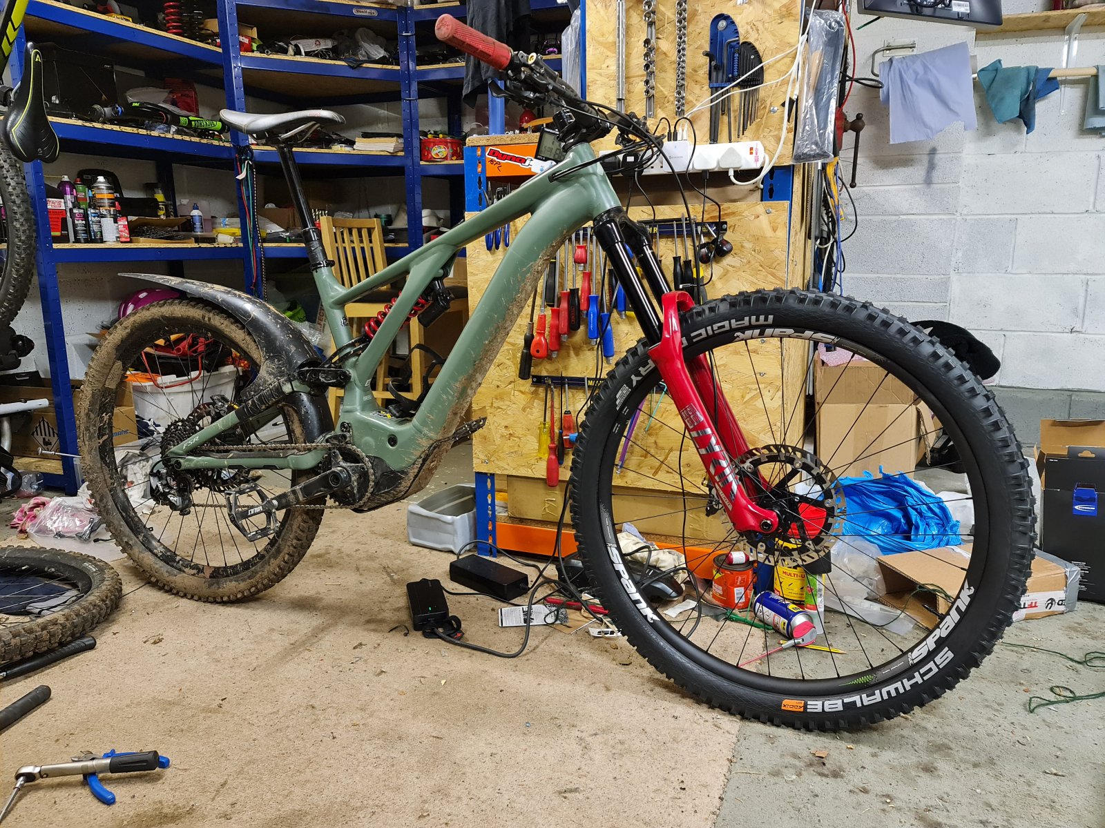

OK you brilliant people, with little else to do my mind turns to next upgrades, and with Christmas coming up I might be able to do some of them legitimately rather than telling my wife "they have always been like that" (new discs) or as per my golf life - "I won that driver in a comp"
I'm on a 2020 Kenevo Expert, S3.
So far all I have done is:
  1. tubeless,
  2. cut bars to 780mm
  3. 220mm Hope floating discs front and rear
  4. Levoceraptor
Bike is currently having the Hope Tech3 V4s fitted, some Deathgrips and the Michelin DH22s
Given the state I came back in last week I'm think about some mudguards so recommendations for those would be good, and perhaps a bar change - a carbon one from Hope/Oneup/Raceface/Nukeproof? Anyone seen pros/cons from changing bar geometry?
Also thought about shorter cranks to reduce pedal strikes.
Think the mullet conversion with the Fox40s will have to wait....
Thank you!

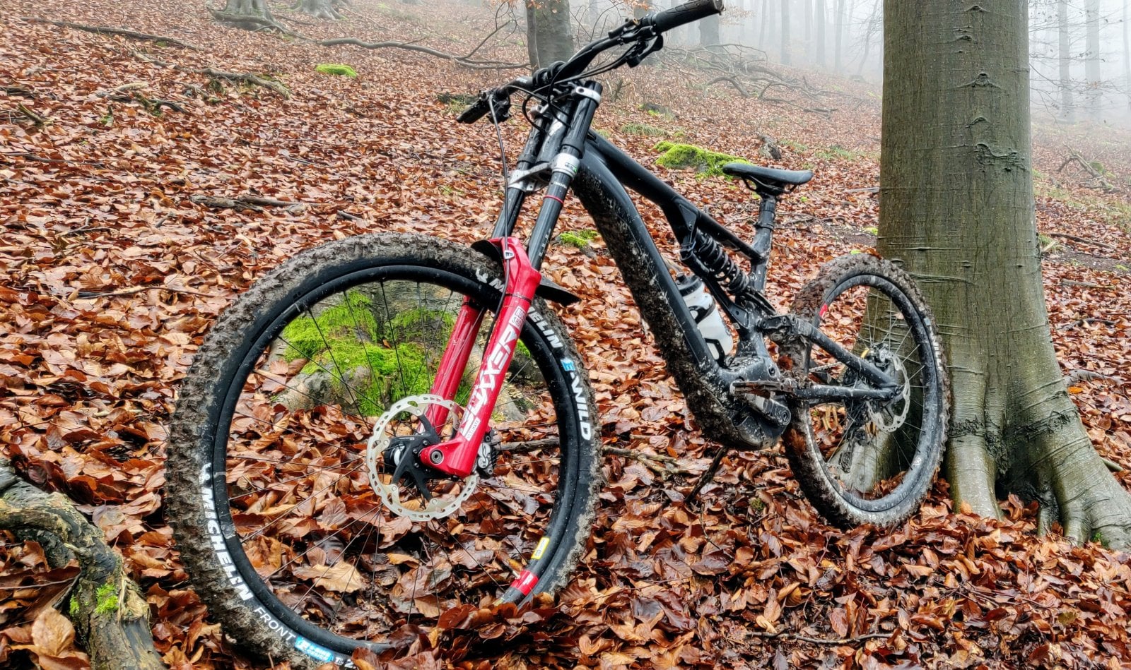

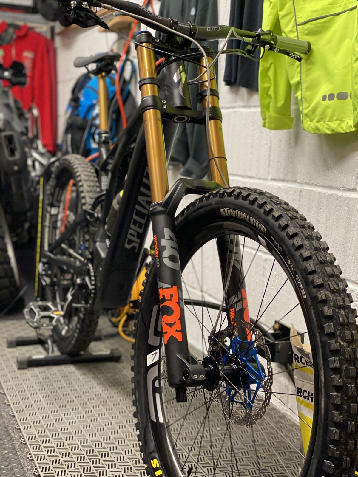

Though I would add my mullet info here being the main place for info as it will get lost in the other thread
First test today but with the bikeparks shut and the local trails consisting of wet chalk and roots covered in wet leaves it's not the best conditions.
Bike rode great though, no regrets but looking forward to trying it at my usual riding spots.

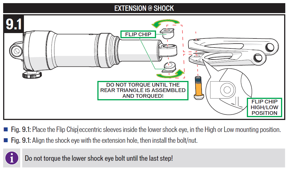

Another Kenevo Mullet here. I'm still not sold on it. Its bloody slack and the BB is higher even with the flip chip swapped around. Front feels floppy as its stuck out so far! I'm sold on a 29" front wheel though, thats for sure. Just not sure it works on this frame. I probably should have gone 170mm to bring the BB and head angle back towards stock a bit. In my head it seems wrong having more rear travel than front though. It'd be easier to get a feel for it if it the weather wasn't being so british as Its hard to push in the slop right now to really guage the difference.
What size shock are people using if switching back to air? Or who do you get progressive coils from. I either blow through the travel too easy or have it too hard. Can't find a middle ground.

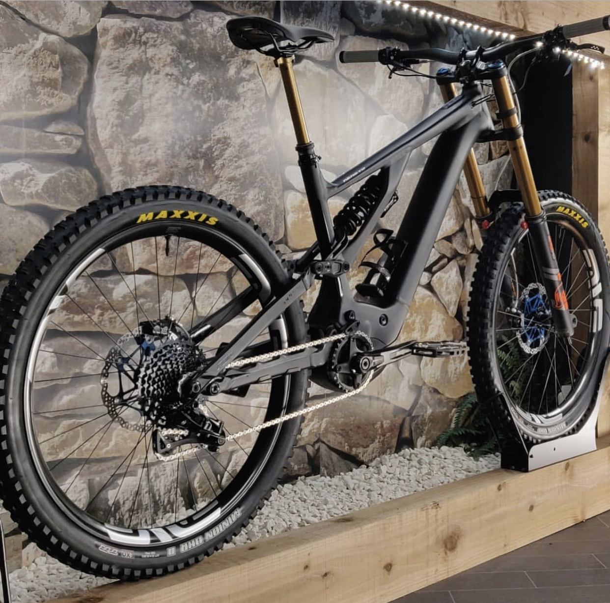

Good day all!
My feedback/update/recommendations regarding suspension on my Kenevo 2020 Comp. If anyone is interested, go ahead and read below:
As I have posted earlier in this thread, I have upgraded the Marzocchi Bomber CR rear shock to a Fox Float X2 2020, size 230x62.5, custom tuned by J-tech suspension specifically for the Kenevo as well as my weight and riding style. I have also upgraded the oil side of the Marzocchi Z1 with a Fox 2020 Grip2 damper and serviced the air side as well. Lastly, I have been using the Shockwiz to fine tune the suspension of the bike and keep things balanced front and rear. The rear shock setting is in slack position and the wheels are kept to original 27.5".
The tyres, in my opinion are directly related to suspension. I am still using Assegai MaxxGrip DH tyres front and rear, no inserts, 26psi in the back and 23psi in the front. Perfect grip, plenty if support, no flats. Longevity is very very bad though. I've lost count how many tyres I've changed since I bought the bike a year ago...
Based on all the above, what I can say is:
  1. Service and custom tuning your suspension at specialized workshops (such as J-tech and TFTuned to name a couple) is totally worth it. I would most definitely prefer to pay custom tuning and/or custom upgrade (Andreani piston upgrade on my Grip2 damper for example) of my existing suspension rather than paying for new. Brand does not really matter in my opinion as long as the product chosen is holding up to the task. For example, in my opinion, the original coil shock failed on me twice. I now have a brand new one replaced under warranty and I am not installing it back on the bike...
  2. Using suspension tuning aids such as the Shockwiz is also very helpful and especially with e-bikes, you can have a lot of data very fast and perfectly tune the suspension. The tuning guides that come along with such aids is also a must read in order to understand how to use them. More expensive setups that work on coil systems as well should be great! Price is steep though. Again, I would prefer to buy such aids than buy new suspension.
  3. Fully service your suspension at least annually, keep the lower legs fresh on that fork. Some nice products for cleaning stanchions exist such as the WPL ForkBoost Lube that I am using, these seem to work nicely.
  4. Keep monitoring your pressures both in the suspension and the tyres. I would really like to buy the TyreWiz if I can find a nice deal on it.
  5. Use the best tyres you can find, weight does not matter here. Just protection, support and traction.
Lastly, for those looking to convert the Kenevo to mullet setup, see Marshall Mullen's YouTube channel and especially his own Kenevo setup. He goes through the setup in detail, how he changed the size of the rear shock, what fork he used, what travel adjustment did he make etc. very good videos. Needless to say that he knows what he is talking about...

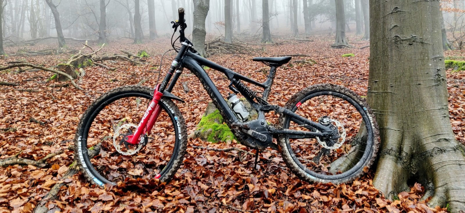

It looks awesome mate

What’s a flip chip

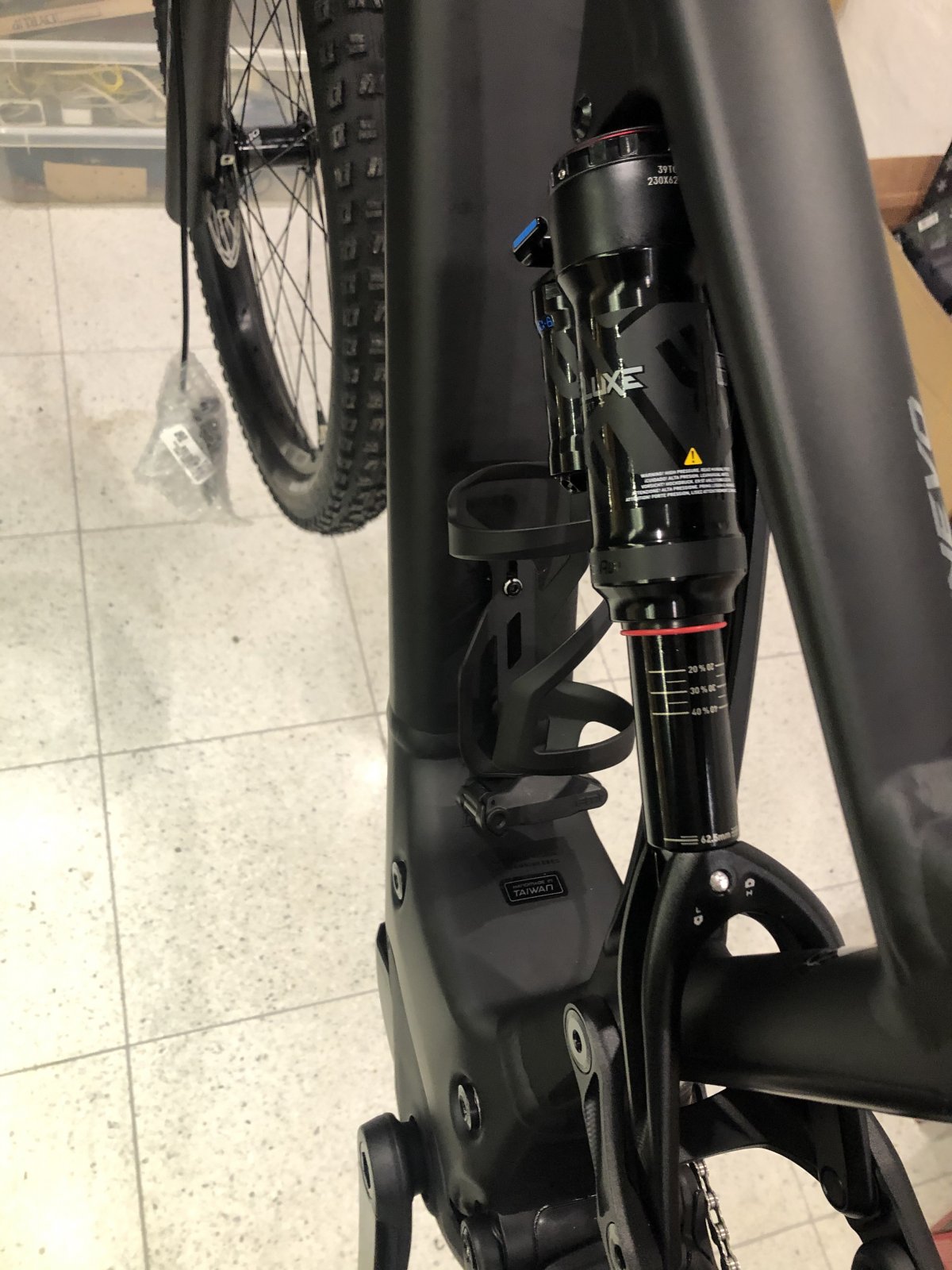

Hey all og you.

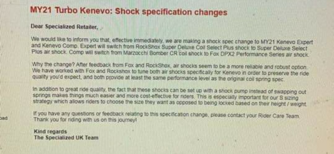

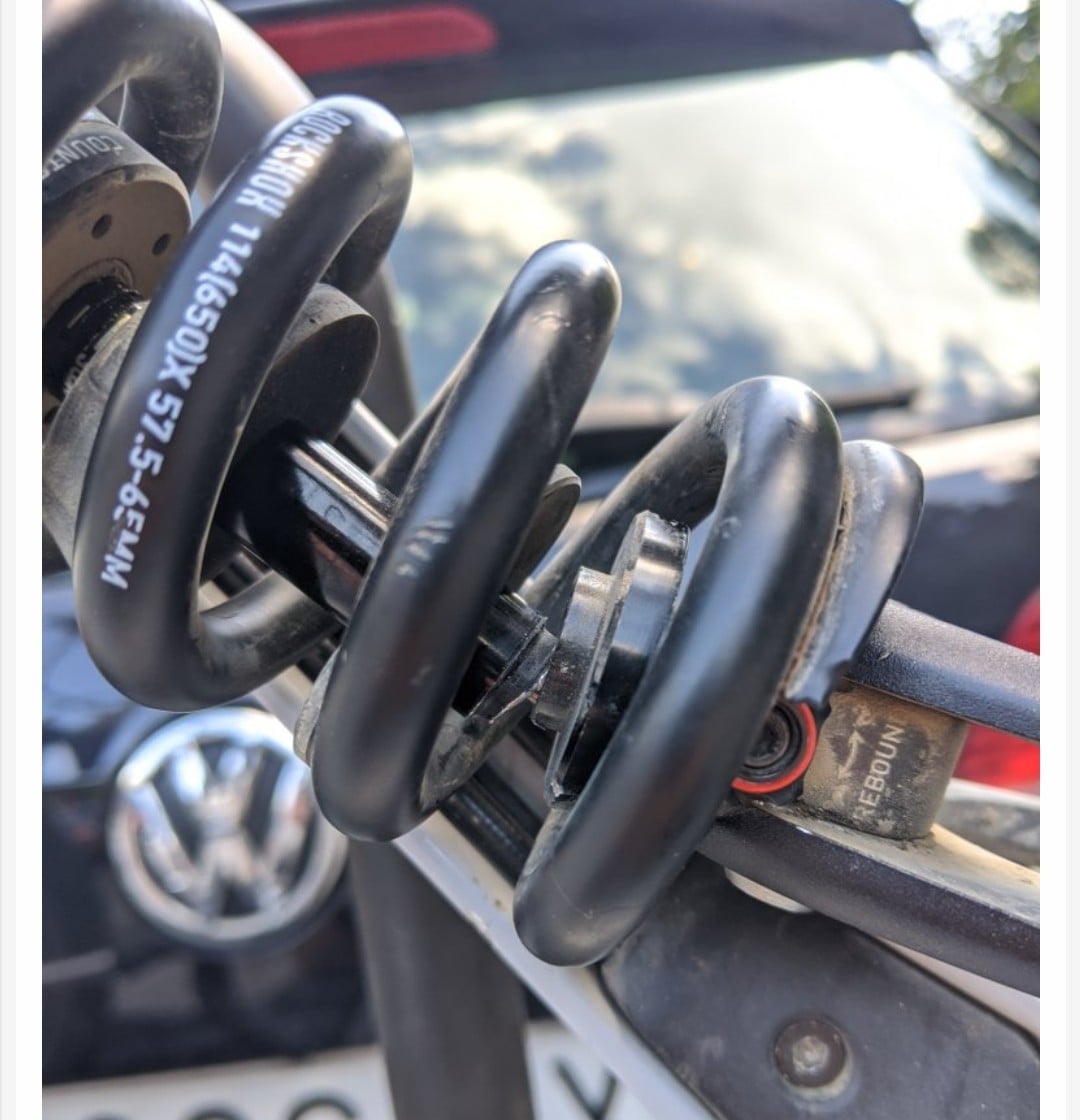

i have a question abort my new kenevo Expert i Pick up to day.
It have a rockshok super deluxe select +
But it is a air shok an not a coil shok
cozzy
Aug 11, 2019
980
1,116
Hampshire UK

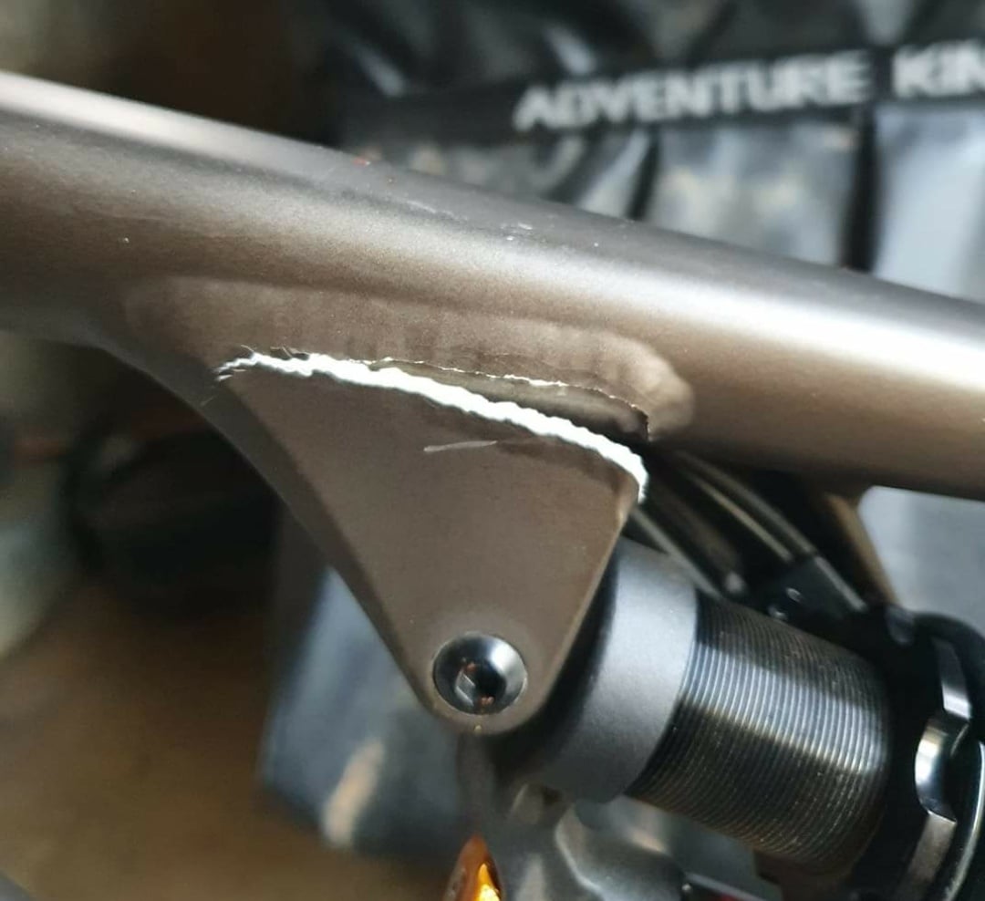

It's the new standard. I've seen quite a few busted Marzochi coils but only one rockshox coil snapped on a German website.
I guess specialized have decided air is more suitable, either due to a stronger shaft or more likely to be set up correctly for the riders weight.
I wouldn't want an air shock either. I've never had one last more than 12 months without having the damping fail.
I partly blame specialized for not providing a suitable spring chart for riders weight like they did for the 19 kenevo.
I would hazard a guess a spring that bottomed hard here! Or even coilbound. Look how much preload has been wound on.

They should be sold with a progressive spring imo. I bottom out what should be the correct spring so I've had to go bigger at the cost of some initial bump subtlety.
I'm still deciding between air and a progressive spring. I prefer a spring if I can too.
