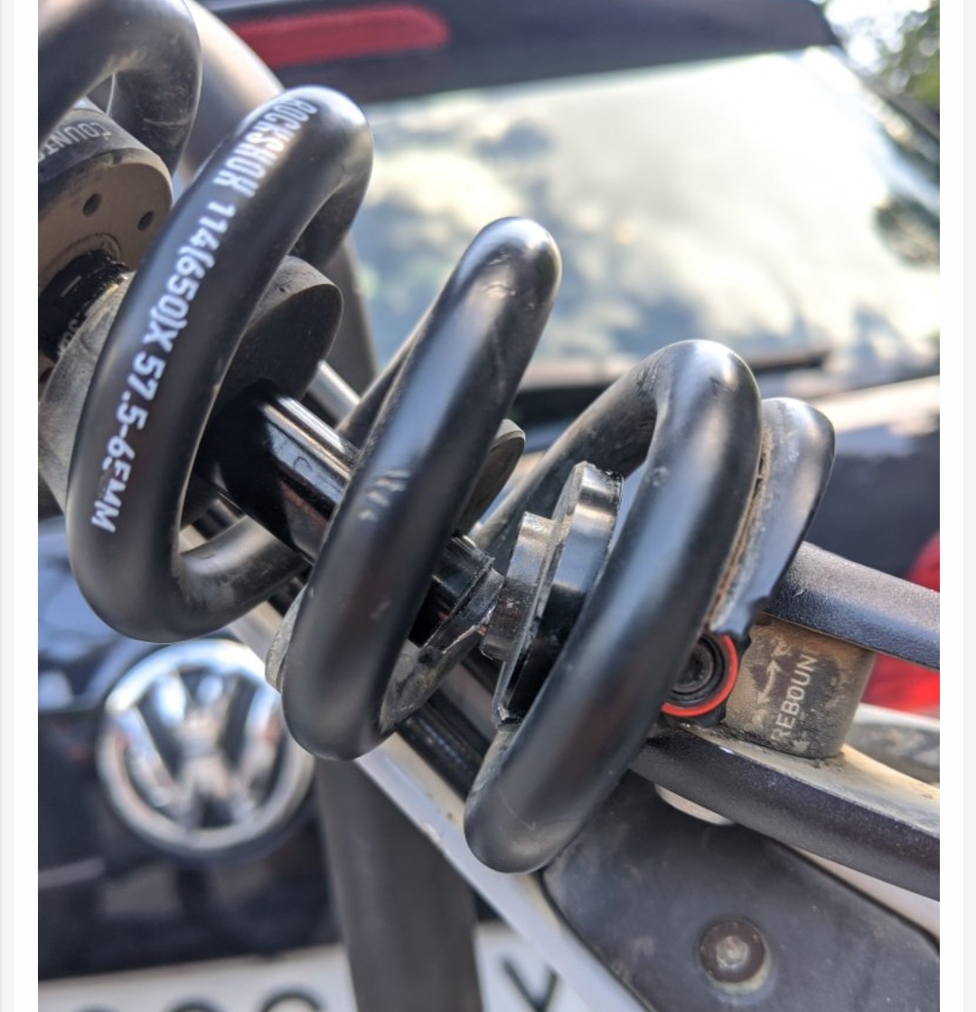

It's the new standard. I've seen quite a few busted Marzochi coils but only one rockshox coil snapped on a German website.
I guess specialized have decided air is more suitable, either due to a stronger shaft or more likely to be set up correctly for the riders weight.
I wouldn't want an air shock either. I've never had one last more than 12 months without having the damping fail.
I partly blame specialized for not providing a suitable spring chart for riders weight like they did for the 19 kenevo.
I would hazard a guess a spring that bottomed hard here!

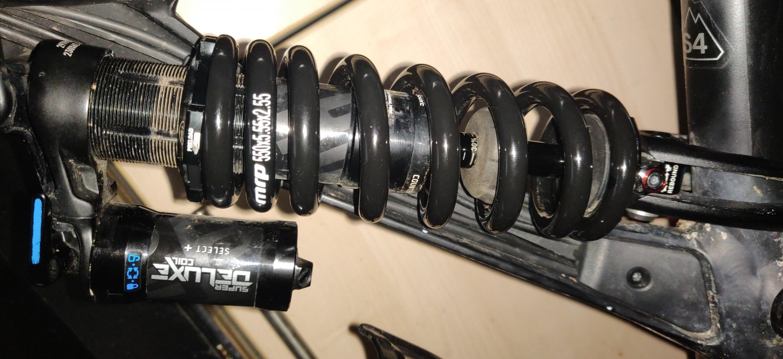

MRP progressive coil fitted today.
At about 93kg the stock 550 gave me the required 30% sag but did suffer the occasional harsh bottom out.
With this just tightened enough to stop rattle its just over 30% sag, so pretty much perfect.
Hopefully be dry enough at the weekend to test it.

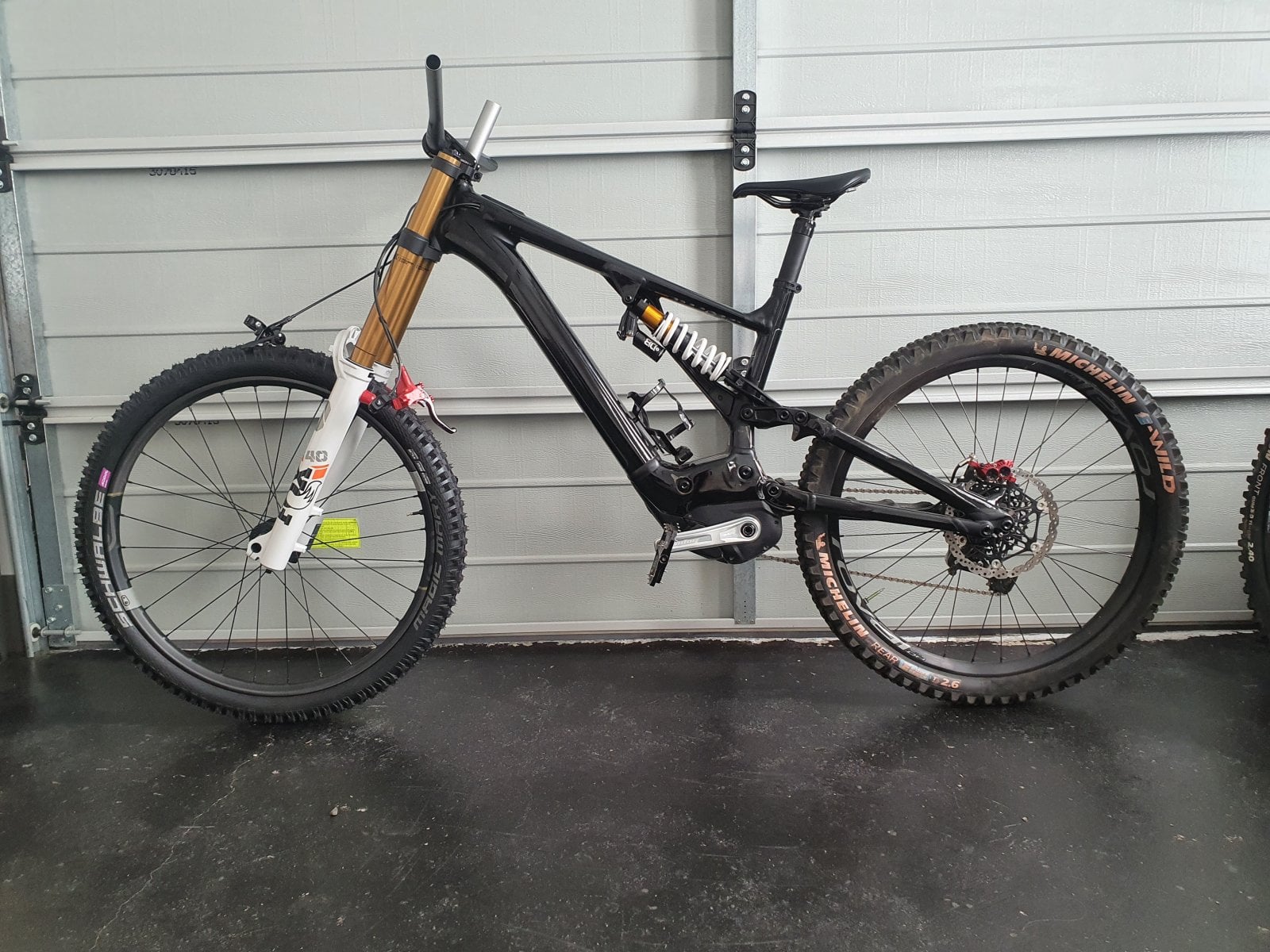

My 2020 Kenevo mid transformation. Size S4 with 200mm front and rear.
Going to run a XO1 DH drive train.
Waiting for the rear wheel to be built kind hub with crank brothers synthesis carbon DH rim.
Waiting on axs dropper.
I just wanted to get it rolling to check for clearance, HA and BB Heights.

Danrodcr , I ride both bikes , in a previous post you will see the mods I did to my kenevo , I did put 29” wheels on it , so it rolls very much like the Levo , it does have a longer wheelbase so if you’re not to good a tech rider you will feel the difference on tight tech trails , but in general I prefer riding the kenevo as it just soaks up anything and rides well on all terrain . The stock kenevo is very low and with a very linear rear end and a coil spring , it peddle strikes everywhere which the Levo doesn’t do much , the Fox 38 and X2 air shock and 29” wheels transformed my Kenevo into a bike Specialized should have produced imho
How do you get a 29 rear wheel to fit mate ?
Nice bike.
what sice is you shock from Cane Greek
Kenebeau
Jan 10, 2020
15
26
Nice bike.
It was originally a 9.5 x 3 but I made a few custom bits for it but cutting the piston shaft by 6mm and re-threading it. To bring it down to 233mm eye to eye. Then using an offset bushings and the flip chip in low got it pretty close to stock geo.
