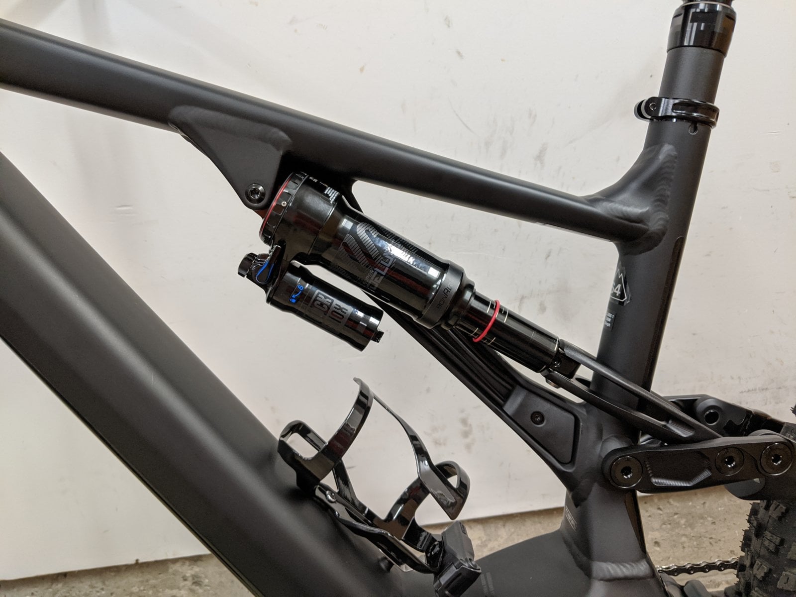

Does anyone use an air shock on the rear of their Kenevo? My Bomber CR just died and I'm thinking an air shock could liven up the bike.
Yes. RockShox Super Deluxe RCT. An air shock will definitely liven it up, but she is not as plush as the coil.

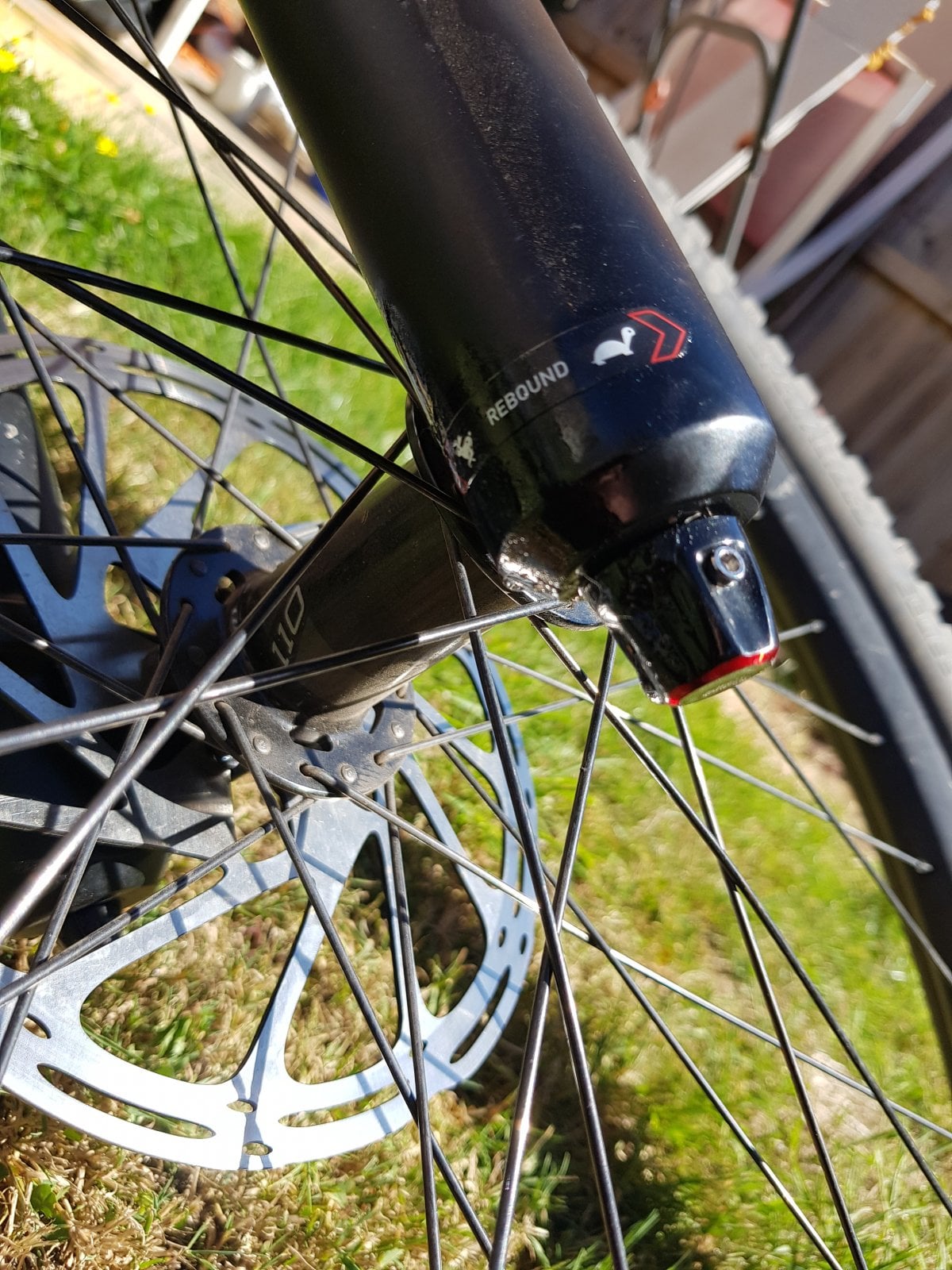

After fixing creaking from from forks I now have fluid leaking from the rebound adjuster after riding my local trails today.is it an easy fix .ta

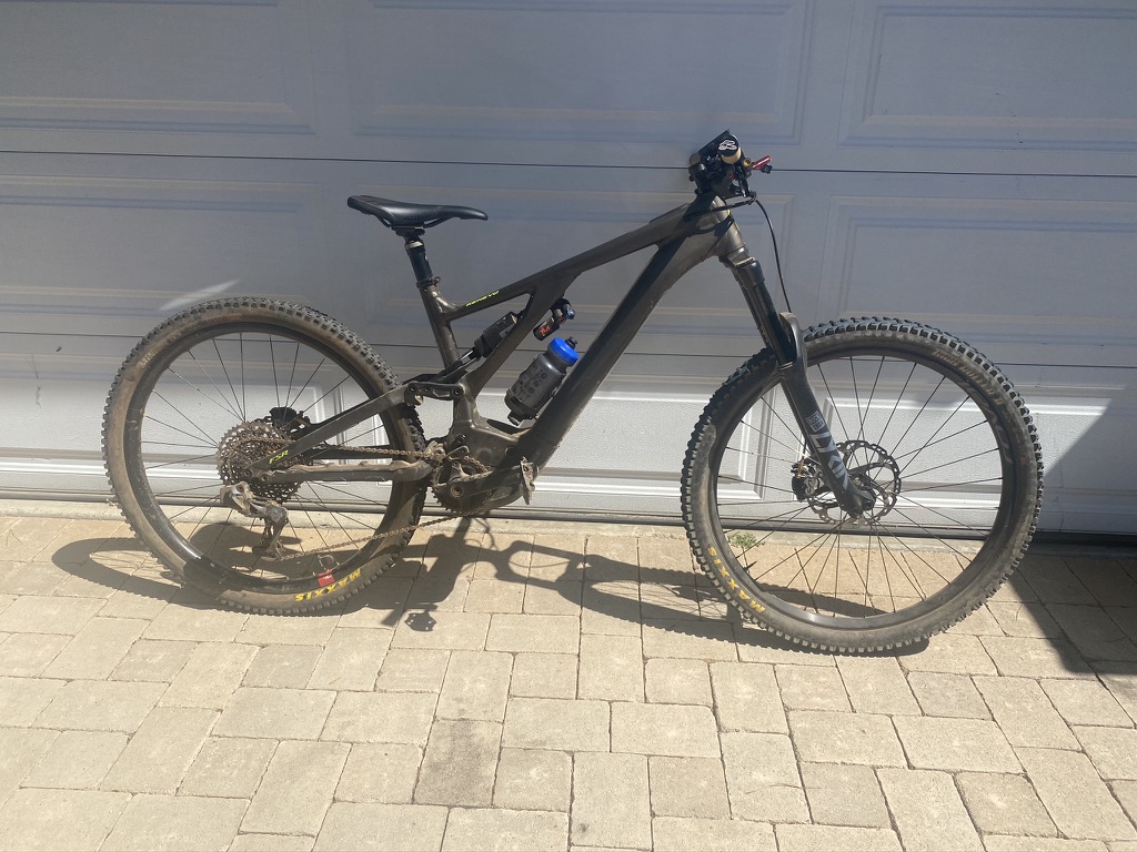

Quick intro since I am new to the site. Been riding MTB since 1988 (yes I am old) and have owned multiple Levo's and both versions of the Kenevo.
Current setup is getting pretty dialed now. Build is a 2020 Kenevo frame, upgraded 700wHr battery, 2020 Lyrik Select fork (temporary to test 29 wheels), Fox X2 Factory rear shock, Roval 29 Carbon wheels (temporary for testing), Renthal cockpit, PNW Bachelor post, WTB Silverado saddle, Saint brakes, CushCore front and rear, full AXS XX1 drivetrain.
Planning on building a new custom wheelset now that I am now that I am sure about the 29 wheels. I have done a lot of experimentation so happy to answer any questions on the multiple iterations I have gone through. View attachment 36788

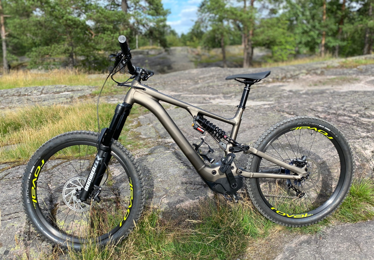

Maybe have to buy a new 29 fork, because the original Zocchi 27,5 has so little clearance for a 29 wheel.
What lenght of 29 fork you installed and what is the rake?

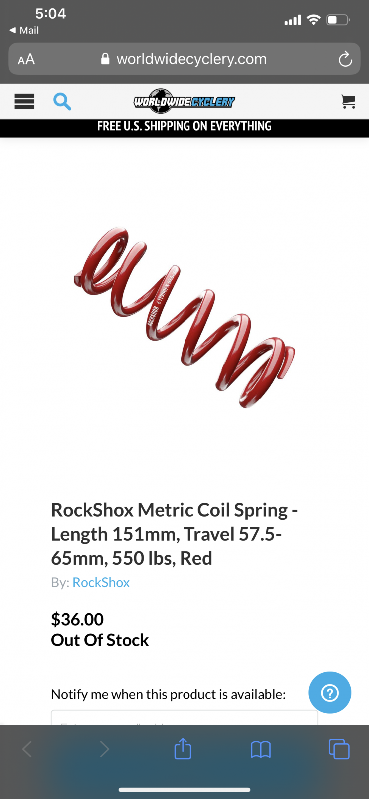

I weigh 235 lbs.
RockShox Metric Coil Spring - Length 151mm, Travel 57.5-65mm
i got the 550lb from worldwide cyclery for my s3 then i sized up to an s4 which has it so now i have an extra. Turns out my nomad 4 used the same coil so i have 3 of the exact same in black. I can sell you one if you’re interested. $20
heading out to downieville today....
Yep, I've got a float X2 and it is really good. I ended up with a 600 spring on the CR and it would still bottom out on fast flatish landings. I think the Kenevo benefits from a shock that can be more progressive.

I weigh 235 lbs.

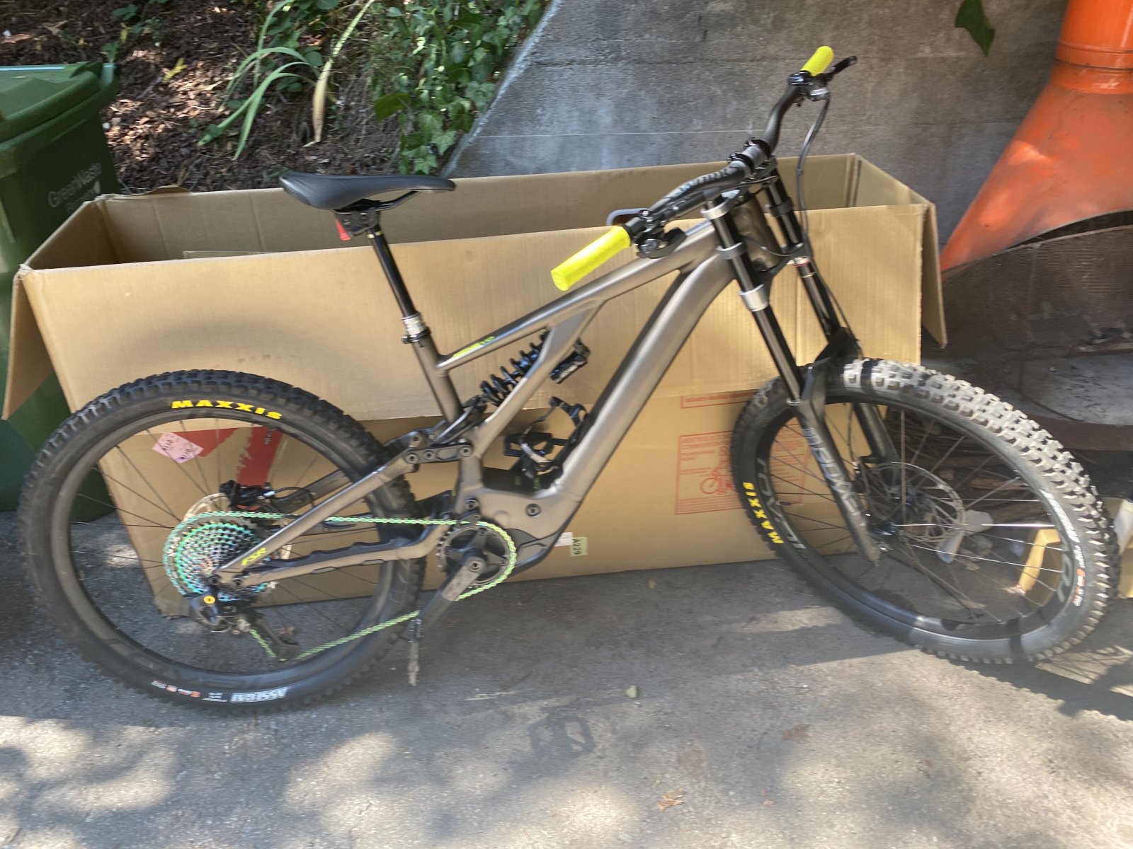

My new (sort of) Kenevo: I bought a 2020 Expert a few months back, and accidentally damaged the upper shock mount threads - entirely my fault, overtorqued a dirty bolt out on a ride. Threw myself at the mercy of my LBS, and they ended up working out a solution - they couldn't find a single S3 Expert Kenevo to replace it with, so we agreed on a Comp with all my Expert goodies (suspension, battery, etc) and upgrades swapped over. Couldn't be happier with my LBS or Specialized HQ. Ended up with a pretty unique bike!

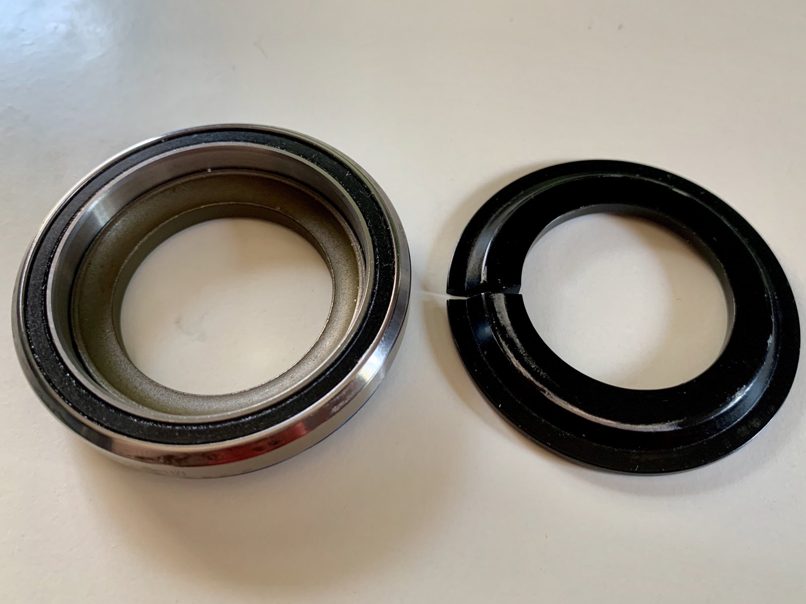

Change the crown race to a cane creek 40 Series 52/30 1-1/8.
i agree
the stock bearing seats perfectly on cane creek and fork stays centered when reinstalling

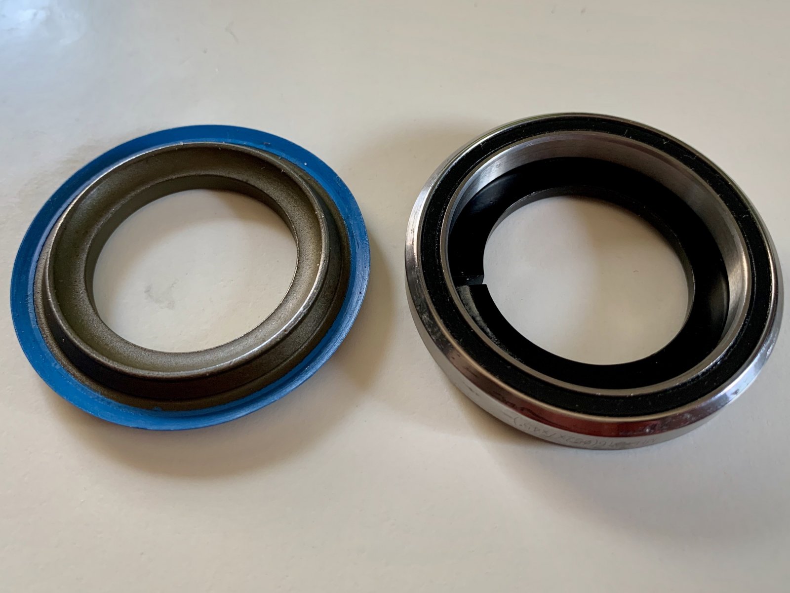

the bearing always slid on stock crown race. had to eyeball to make sure it was straight before applying torque on top cap
as you can see the stock crown race (right) shows uneven wear. probably from not being 100% centered with bearing
cane creek eliminates that issue
i got the heavier 40 series steel. there's also a 110 series made of alloy
Oh good, this makes me feel much less insane. I struggled for a while getting the headset and crown race mated properly.
