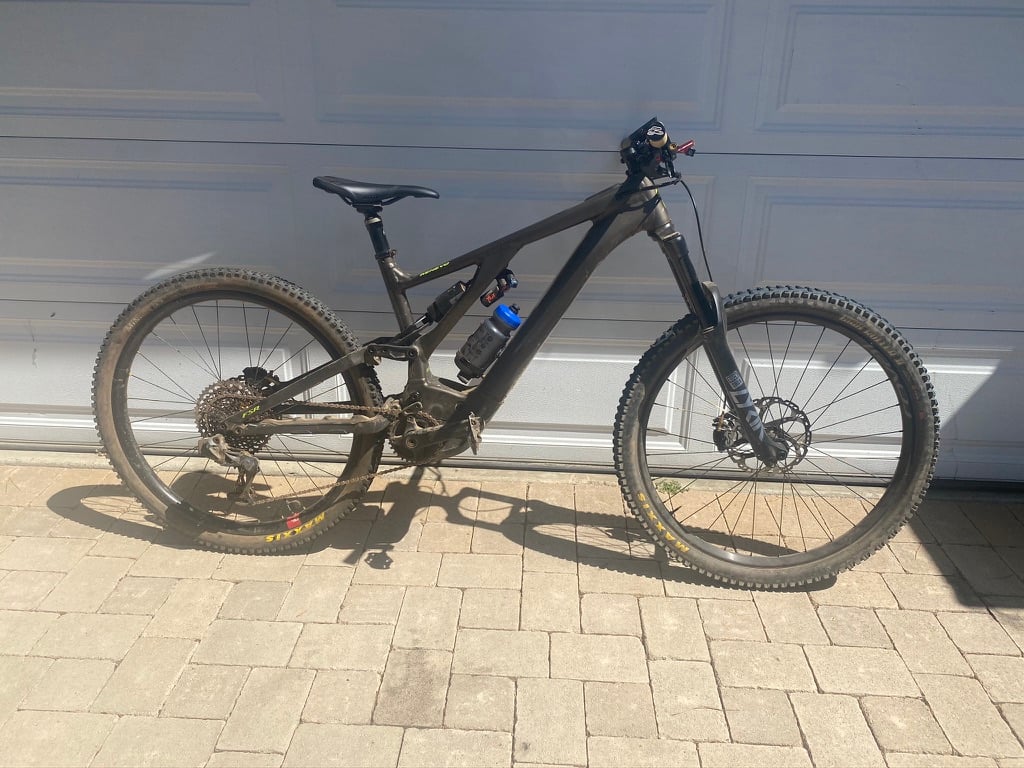

chin.surf
Jun 25, 2020
14
kent

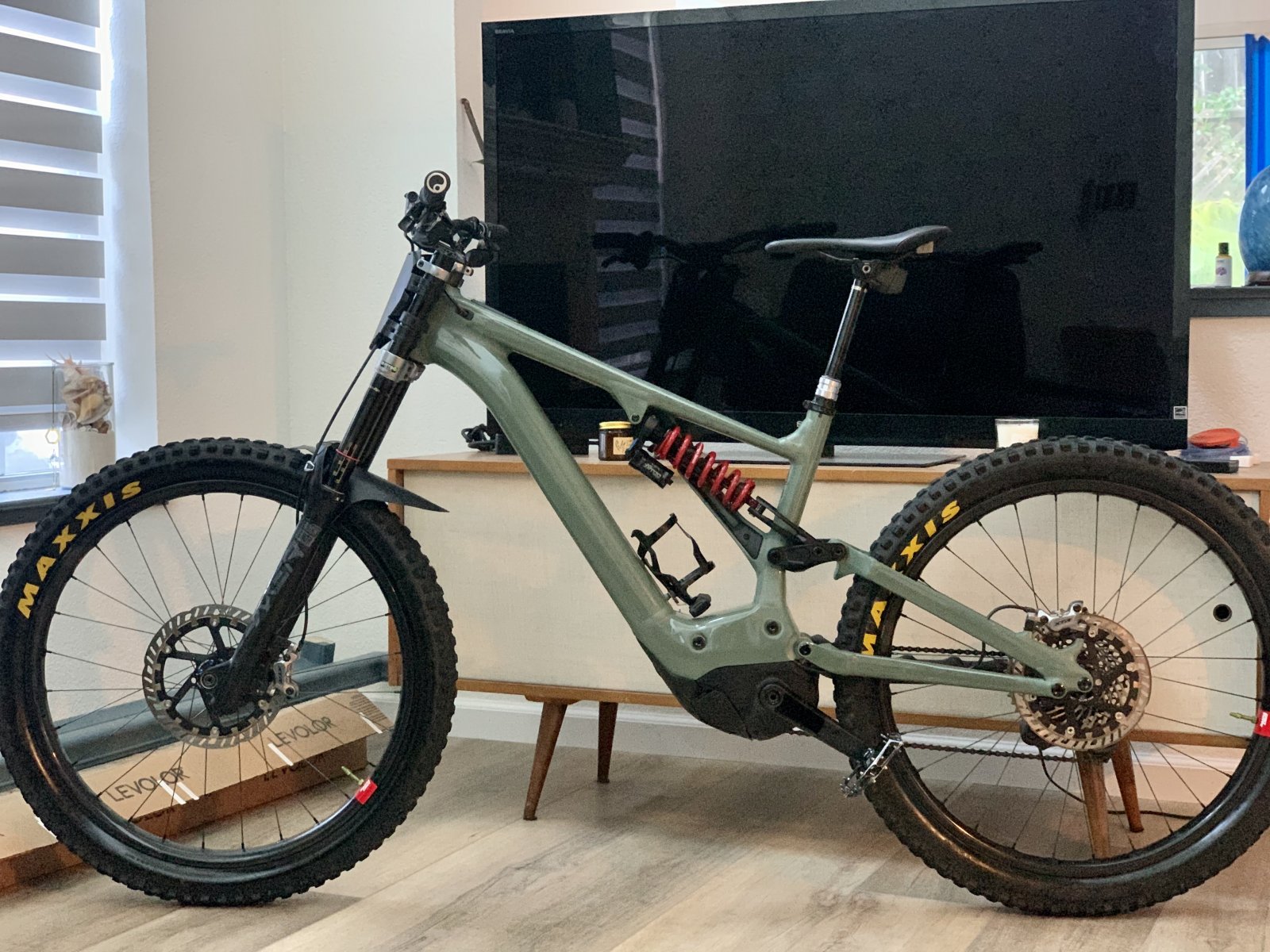

really pleased with s5 , it rides great. good uphill , good down hill and jumps nice, its stil pretty much stock, just dmr pedals and a bit of rubber zip tied on rear for motor. it has also started creaking in the fork area.
ScottWest
Oct 17, 2019
126
76
Oregon
really pleased with s5 , it rides great. good uphill , good down hill and jumps nice, its stil pretty much stock, just dmr pedals and a bit of rubber zip tied on rear for motor. it has also started creaking in the fork area. View attachment 36652
Nice looking bike. I have been fighting the creak too. Cleaning the stantions, clamps on the crowns, and steerer tube seem to stop it for a bit. I think the top crown/steerer tube/top cap interface might be the big problem. Just my .02

Not necessary but a few people have had issues with the standard split bearing race failing or making strange sounds. For the price, I just change it to be safe.

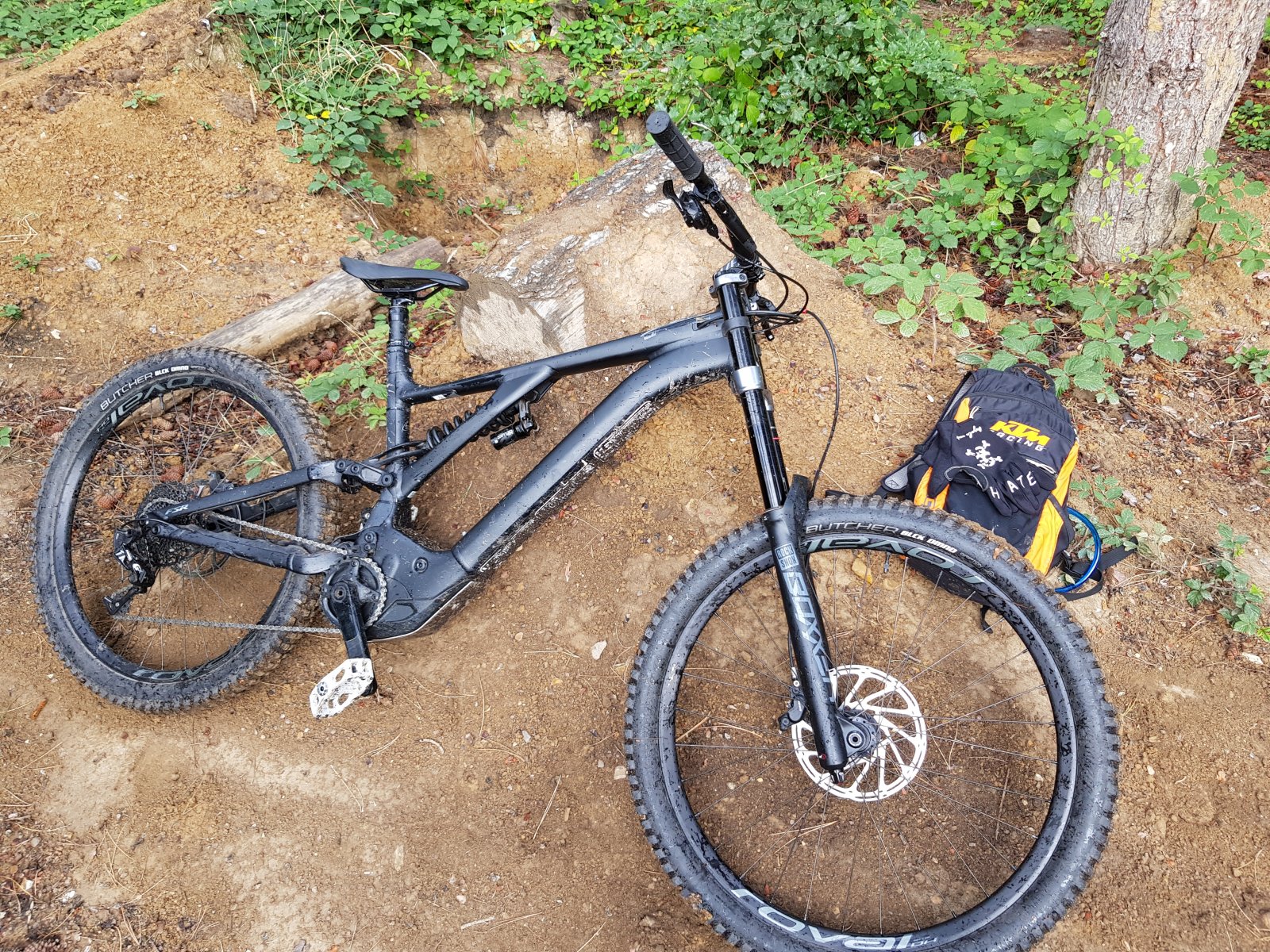

Salespunk
Jul 27, 2020
107
144
Encinitas, CA

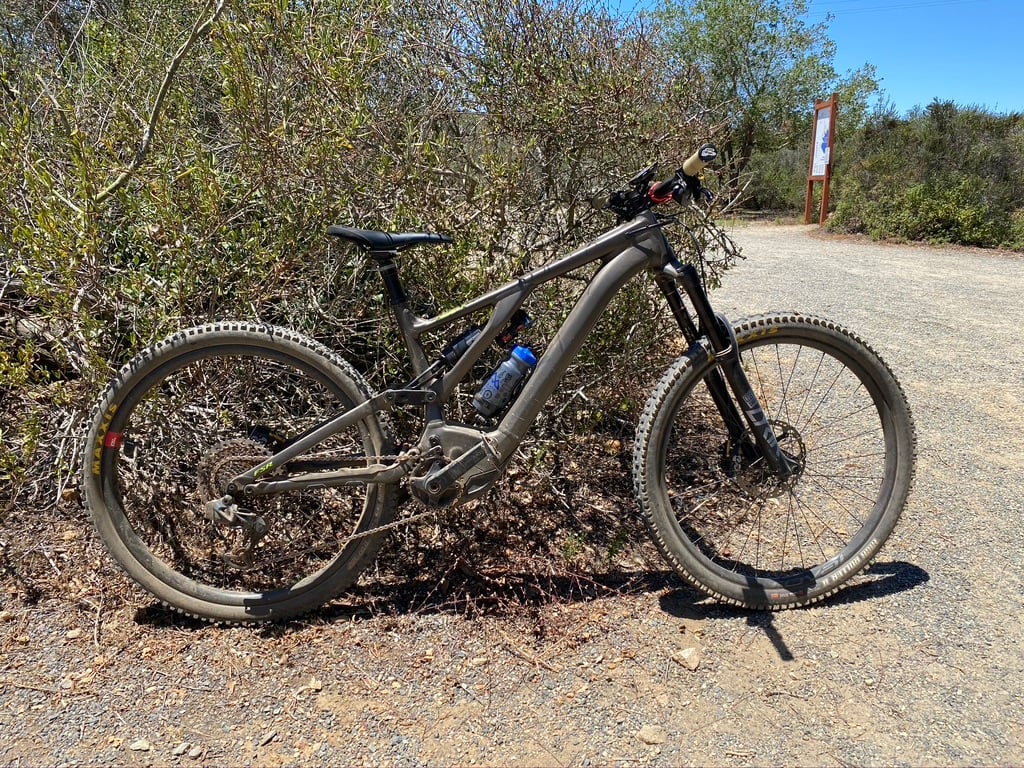

Quick intro since I am new to the site. Been riding MTB since 1988 (yes I am old) and have owned multiple Levo's and both versions of the Kenevo.
Current setup is getting pretty dialed now. Build is a 2020 Kenevo frame, upgraded 700wHr battery, 2020 Lyrik Select fork (temporary to test 29 wheels), Fox X2 Factory rear shock, Roval 29 Carbon wheels (temporary for testing), Renthal cockpit, PNW Bachelor post, WTB Silverado saddle, Saint brakes, CushCore front and rear, full AXS XX1 drivetrain.
Planning on building a new custom wheelset now that I am now that I am sure about the 29 wheels. I have done a lot of experimentation so happy to answer any questions on the multiple iterations I have gone through.
CjP
PRIME TIME
Jan 1, 2019
1,671
2,394
Everywhere
Planning on building a new custom wheelset now that I am now that I am sure about the 29 wheels. I have done a lot of experimentation so happy to answer any questions on the multiple iterations I have gone through. View attachment 36788
It’s rude not to post pictures
