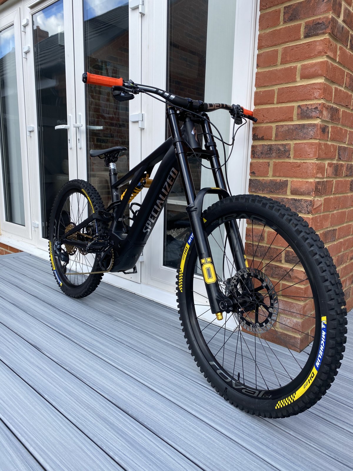

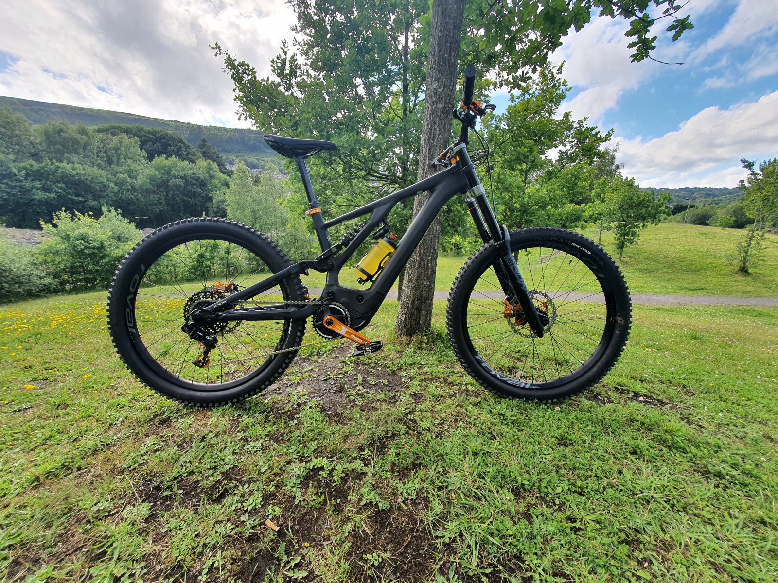

Picked mine up on Wednesday:)

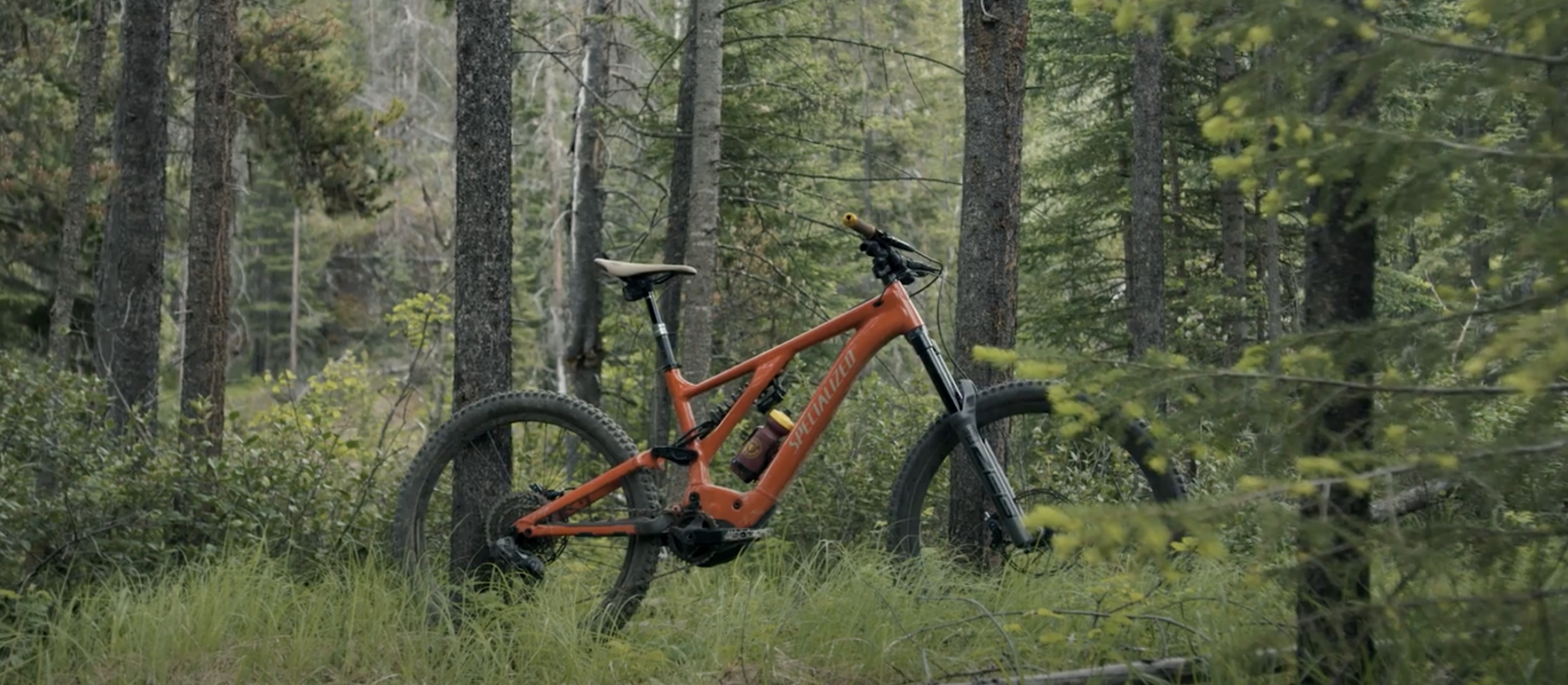

Yeah its a screen shot from the RS ZEB launch vid, still in my mind a similar build would make sense in the Kenevo Line up

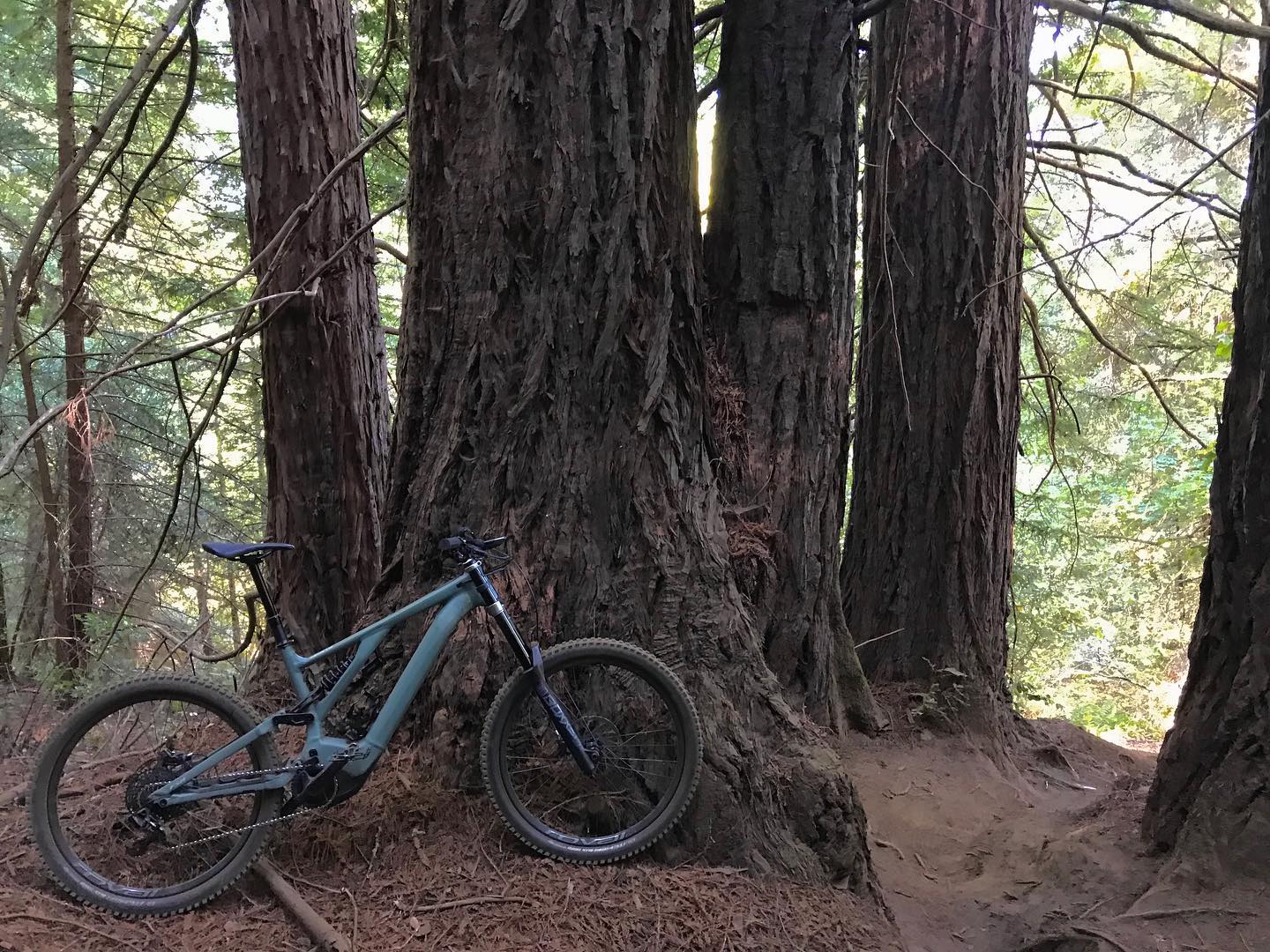

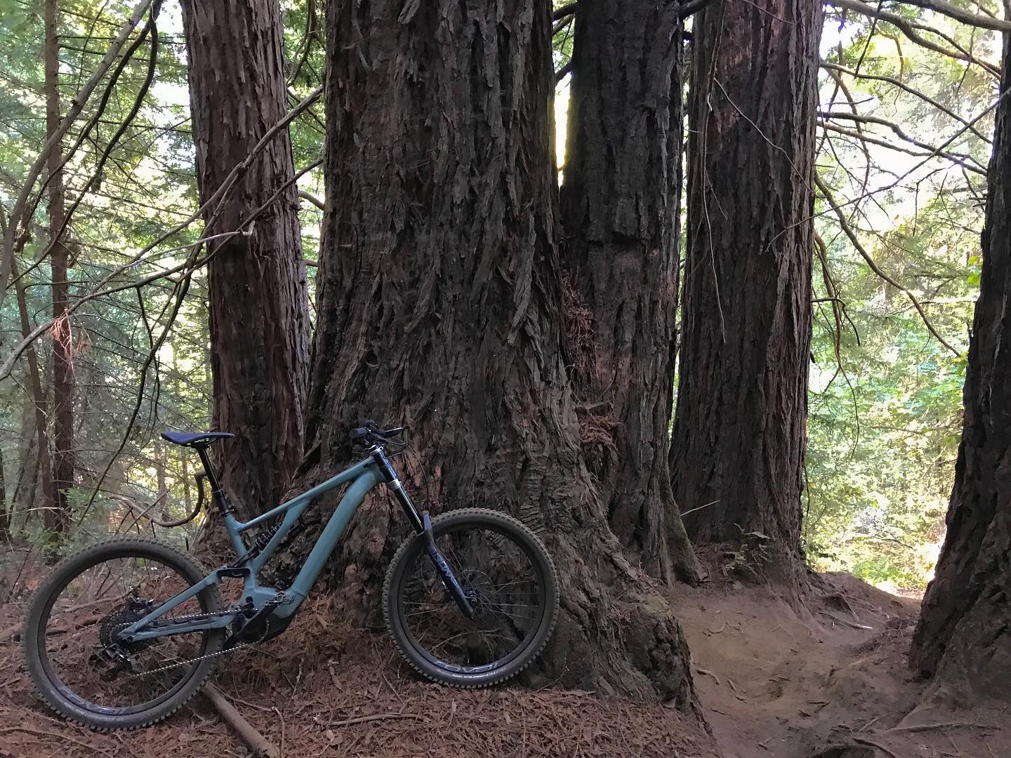

I always rode Specialized, but then went to Santa Cruz bikes. When I recently started consider the eMTB option, this beastie was an obvious standout as I’m a big guy. This is also a big bike, and yes the brakes do feel a little overburdened currently! I was thinking XT, but leaving it at rotor swaps sounds budget friendly!

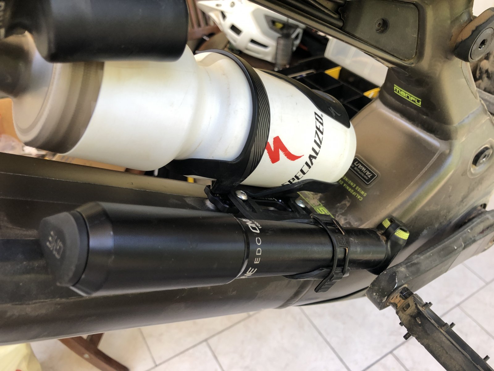

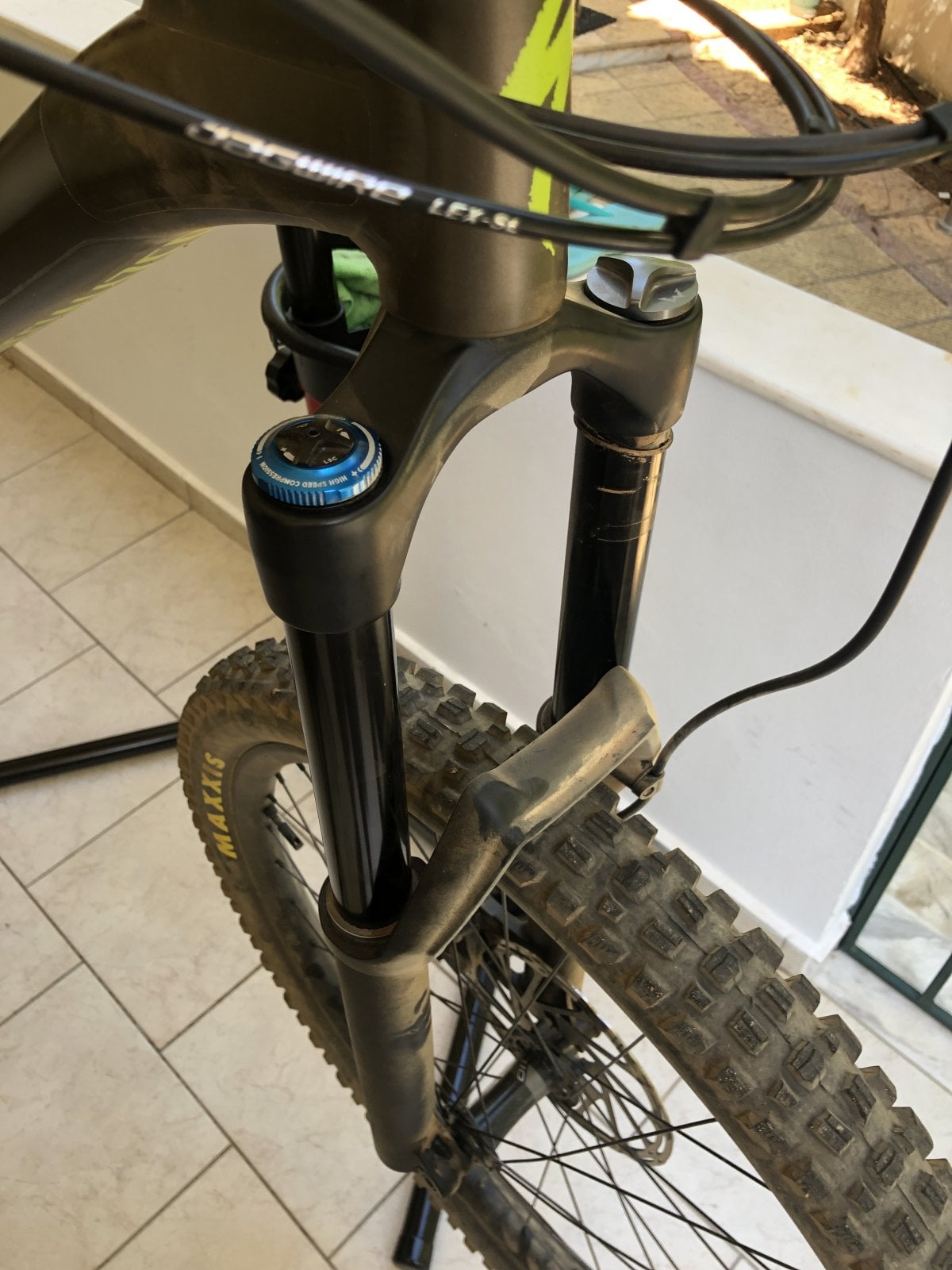

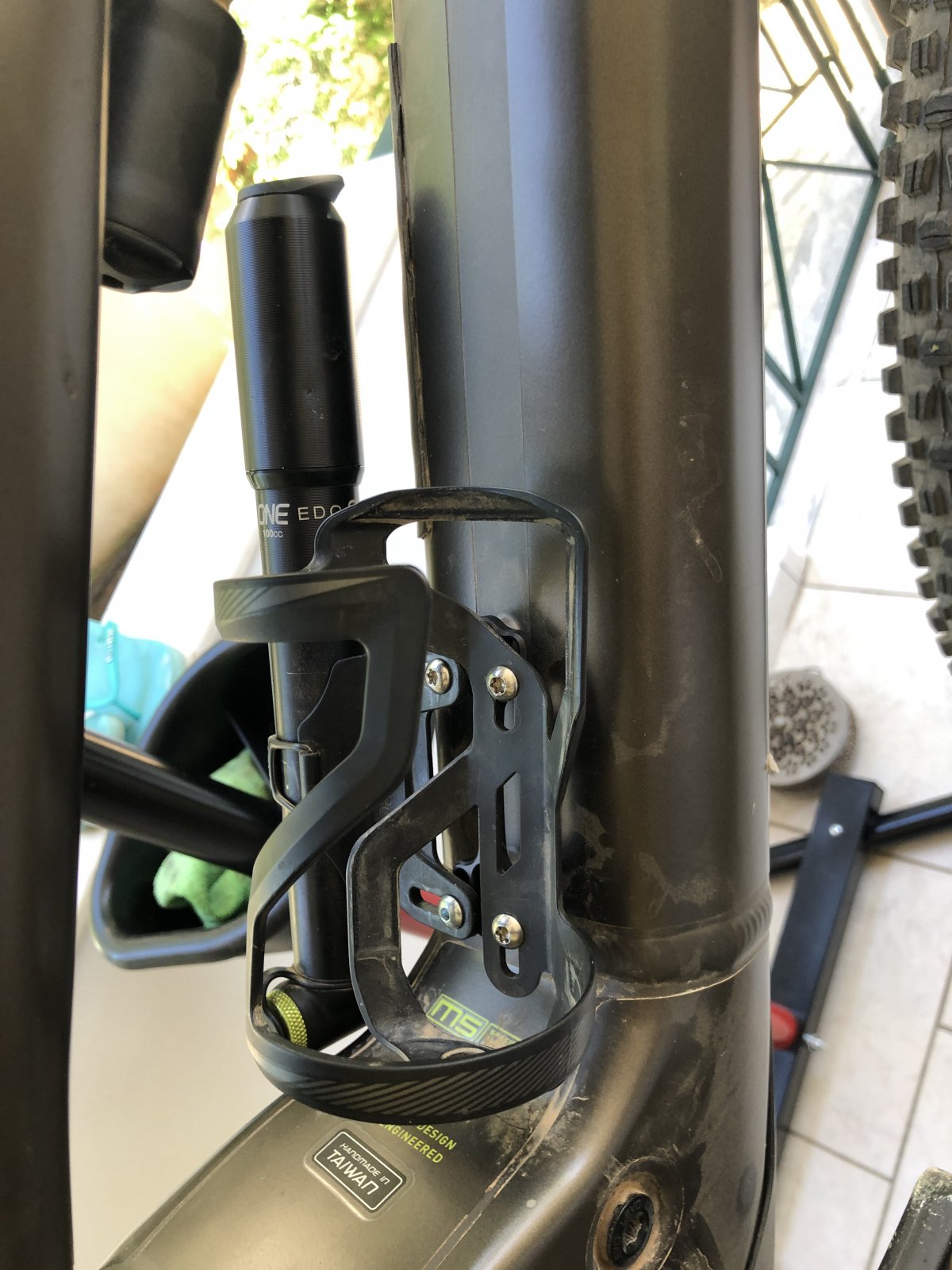

Good day all!
In case any one is interested, I fitted a Wolftooth B-Rad bottle shift on the bike in order to install properly a OneUp pump and multitool. The setup is great and it even fits a bigger bottle. I did not use the SWAT bottle cage though, there was no need. The cranks clear nicely on both sides.
The GRIP2 damper has also been installed on the fork, needs more tuning though. Unfortunately it takes time to tune in the fork especially since the Shockwiz I have failed and is back for warranty claim... Hopefully I will have it back soon.
Next weekend we go racing!!
