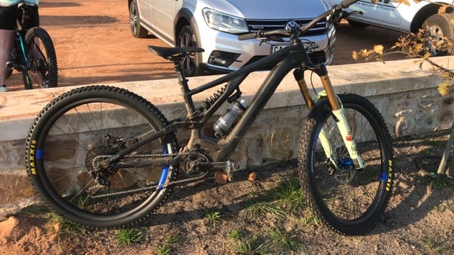

Hey All,
Just wanted to intro myself as I’m new to the forum . I purchased a Kenevo expert after riding a Levo and absolutely enjoying the ride . Didn’t like the stock expert ride so decided to do a few mods .
2021 Fox 38 pistachio 180mm
220mm sram front rotor
50mm Lyne stem
800mm cSixx carbon End bars
Cane Creek lower race mod
160mm Lyne dropper post
Hope Pro4 hubs 28hole
South Carbon enduro 30mm rims 28 hole
Maxxis 2.5 Assagai DH casing tire front
Maxxis 2.4 Dissector DH casing tire rear
cSixx extra thick Foamo insert rear
2021 Fox Float X2 230mm x 65mm
still waiting for bits
Sram AXS Eagle upgrade kit
10-50 cassette
Ride Wrap tailored frame and fork wrap
The mods so far have transformed the bike into an absolute freeride beast , no more pedal strikes in rock gardens and it rolls through just about everything I care to put it through .
I have found myself using eco mode with 5% assist on most climbs and turbo mode on the decents for getting out corners quicker .
I am riding more now then I did when I was racing full time in my 30’s.

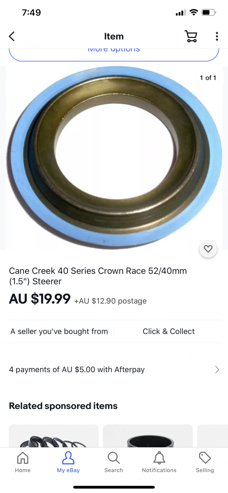

So I've sifted through the previous posts regarding the Cane Creek crown races but I can't make much sense out of it. Is anyone able to tell me exactly which one would be needed to fit the Marzocchi fork on the Comp? I'm getting petty sick of having to clean and re grease my headset every 10 rides. Thanks in advance.

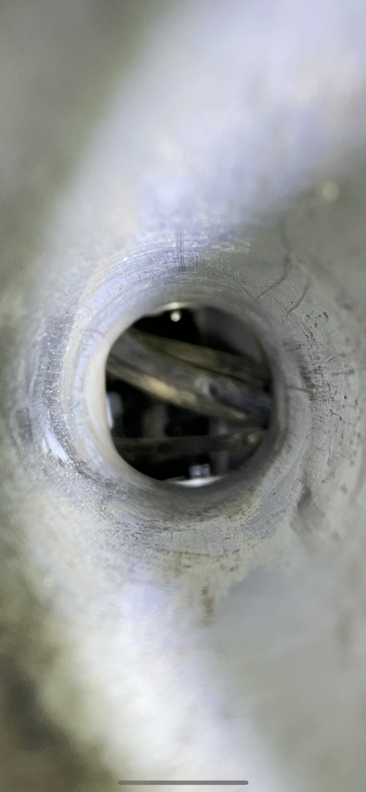

Anybody know the max length of the seatpost insert possible for an S4 Kenevo?
The 150mm that came with the bike is quite short and in order to fit me, the insert is about 90mm out of the top tube.
so looking to get a longer one.
looking at One Up 180mm or best 210mm if it would fit all the way down the tube ..?
CjP
PRIME TIME
Jan 1, 2019
1,671
2,394
Everywhere
Hi,
240mm to the small pieces you can see in the top and bottom. These are the bolts that fix the shock link to the frame. For some reason the Kenevo has these kittle extensions on the end of that bolt. The Levo/SL has the same bolt but without the extensions.
What I’m saying is you could grind them off and then you have 260mm of clearance to those wires.

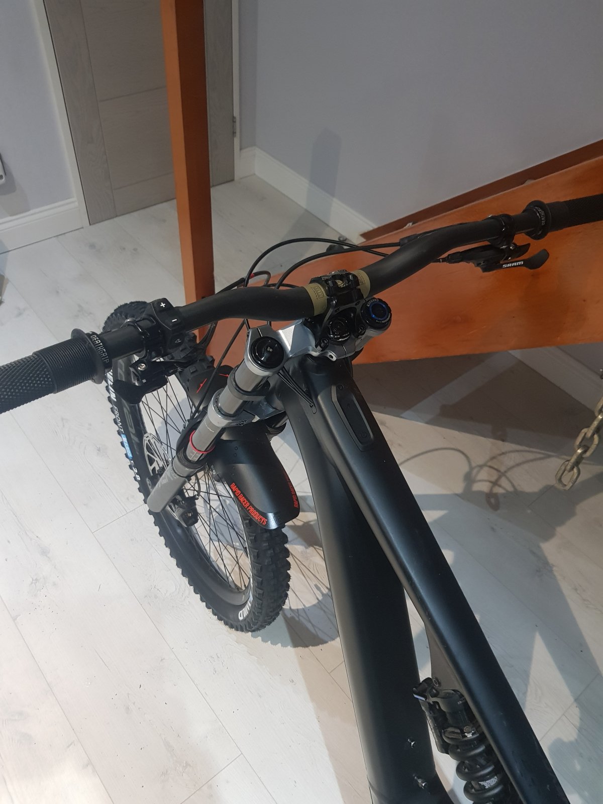

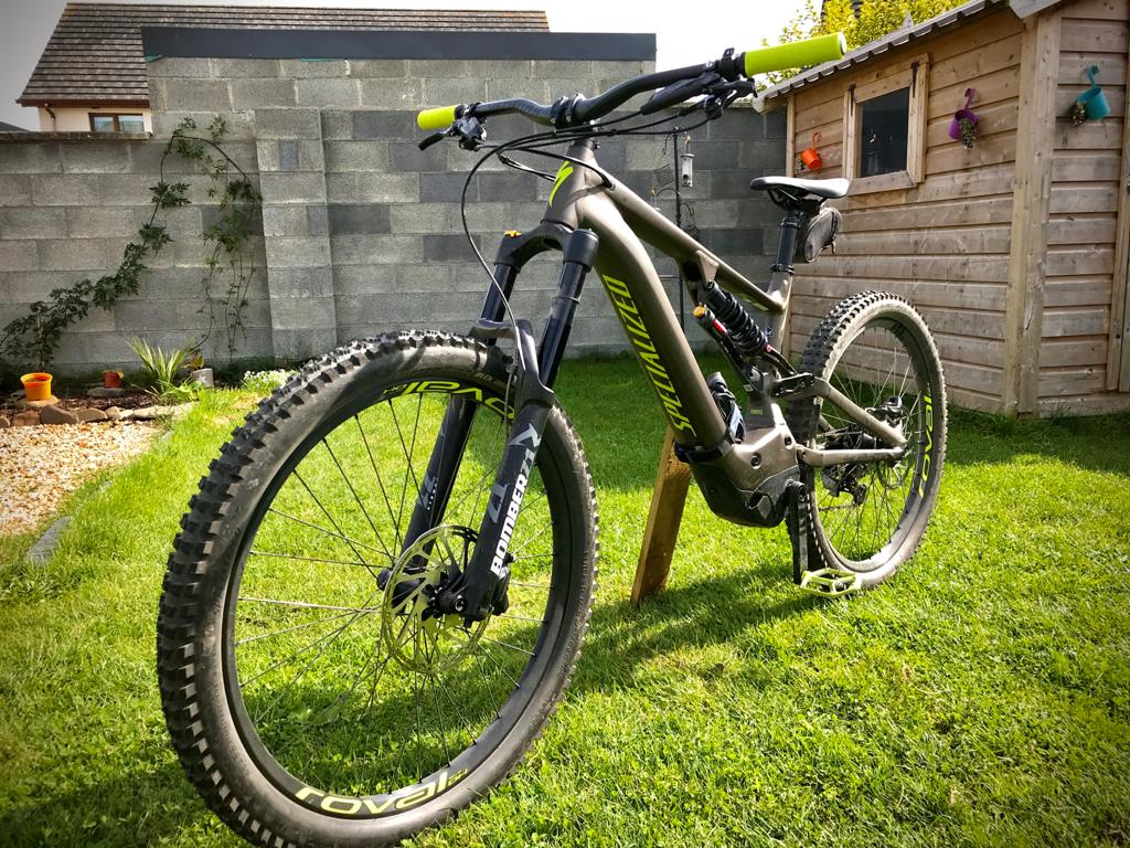

Here is my new baby on it's first day:
Went for a quick 20km blast around a trail center near the shop, and so far so good! loved it !!!!
Got PRs everywhere! On the ups that was sure, but even on red trails going down.
The brakes need to bed in to give a realistic feed back, so won't comment on that yet.
Rear shock was perfect, but the settings on the front weren't right ... I had it 11 click from close and could not really place the front wheel where I wanted and got a few scary moment coming out of a fast twisty berm ... Also felt very hard on bumpy surface and got bad armpump. I just changed to 8 clicks from closed, so will see.
I actually thing it could be due to the tyres as well as these are big 2.6 (was on Maxxis DHF/R 2.4 3C on my Mega), and there was probably too much air as I am not sure yet how puncture (pinch) resistant they are yet. I also found the sided knobs to be "not enough on the side" if you know what I mean.
Other than that, although it is a long bike on paper, the fit is perfect! 64 degrees HA is very confident inspiring but the Mega wasn't far from that. Just that seat post that is too high is annoying me, but it will be my first big mod.
And lastly, the saddle ... what a dream! Probably the comfiest saddle I've had !
So managed 2 loops of the trail center: 19.5km - 653 Elevation +, and went back home with 56% battery left !
Happy days!
Edit* The gear shifter on goes up one gear at the time ... that is shame on a bike at that price ...

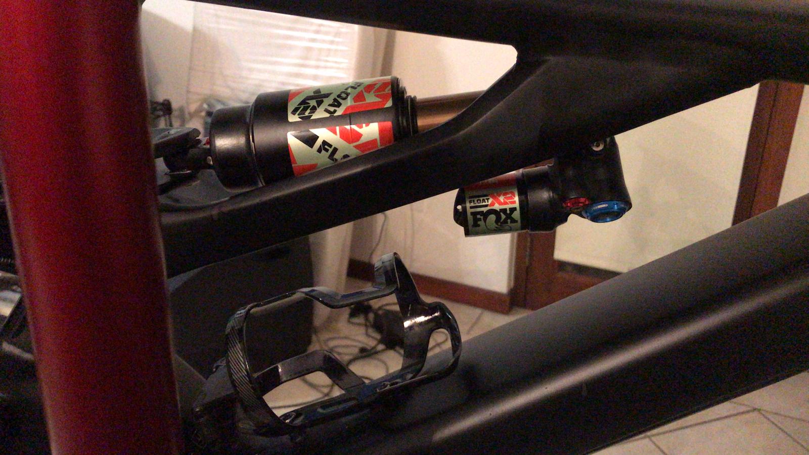

I wanted 200mm travel back and front and I already had the fork from my last Kenevo so that was an easy swap. I think from memory it was a 46mm offset?
With this fork and a 29er front it slackens out to around 62 degree HA. Defiantly noticeable but still climbs no problems.
For the rear shock I wanted to keep it ohlins, they had a 242/76 so I had them reduce that by 6mm to give me 236/70. This gave me 201mm travel at the back and I initially ran two offset bushes to give me a 230 overall eye to eye measurement.
As the bush was solid without the thin outer bush it had no movement and the top bolt was always loosening itself. I decided to go back to a centre bush with the outer bush which raised my bottom bracket. No big deal as the bikes so long and slack it’s fine. Works out the same measurement as flipping the chip in the original shock.
I also checked by removing the spring and cycling the suspension to make sure there was clearance in the frame which there was.
As for the ride? Well it’s fine, I’ve taken it down some sketchy trails and take a few decent hits, drops and it loves it.
Not one problem so far, just lots of fun and I finally have my eDH.
