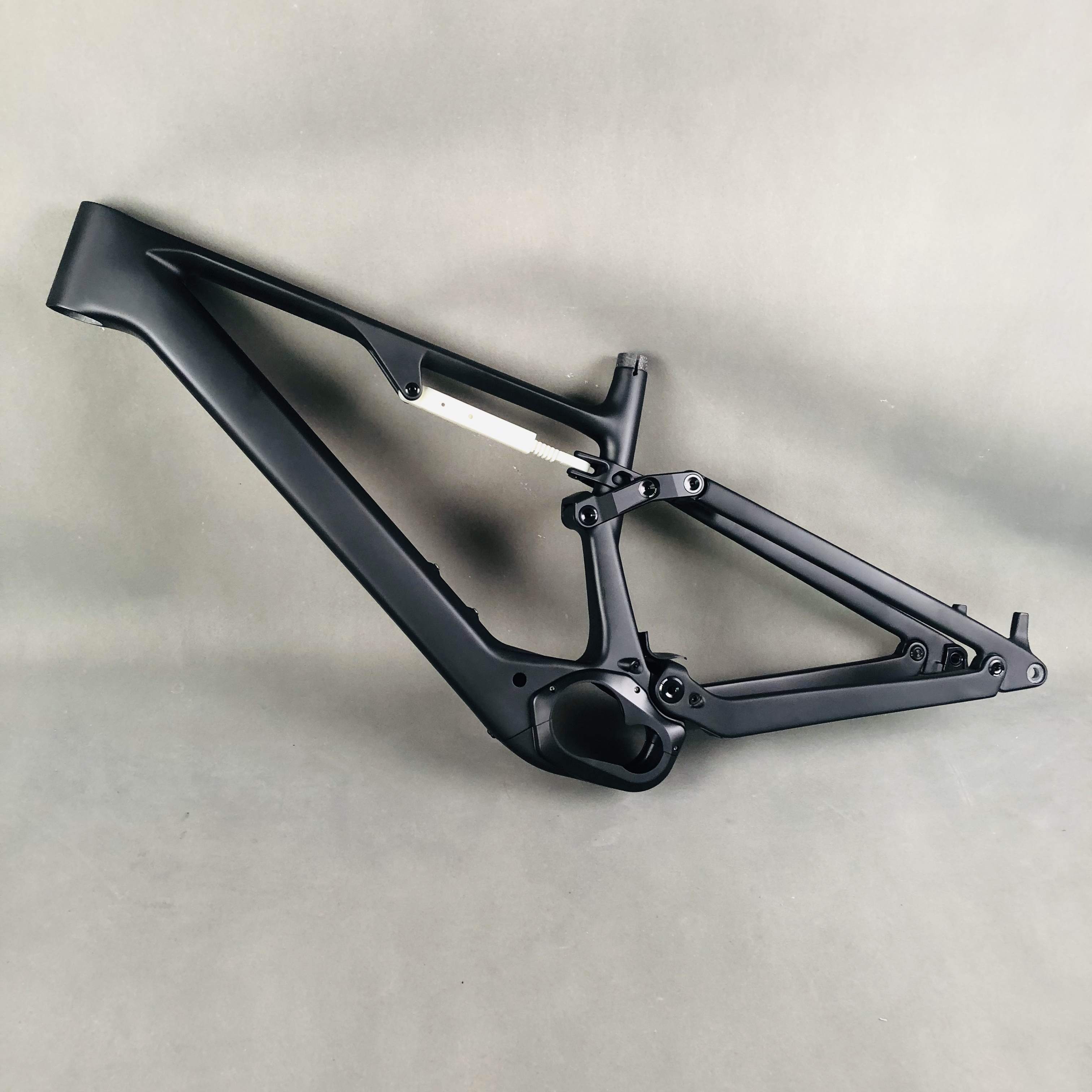

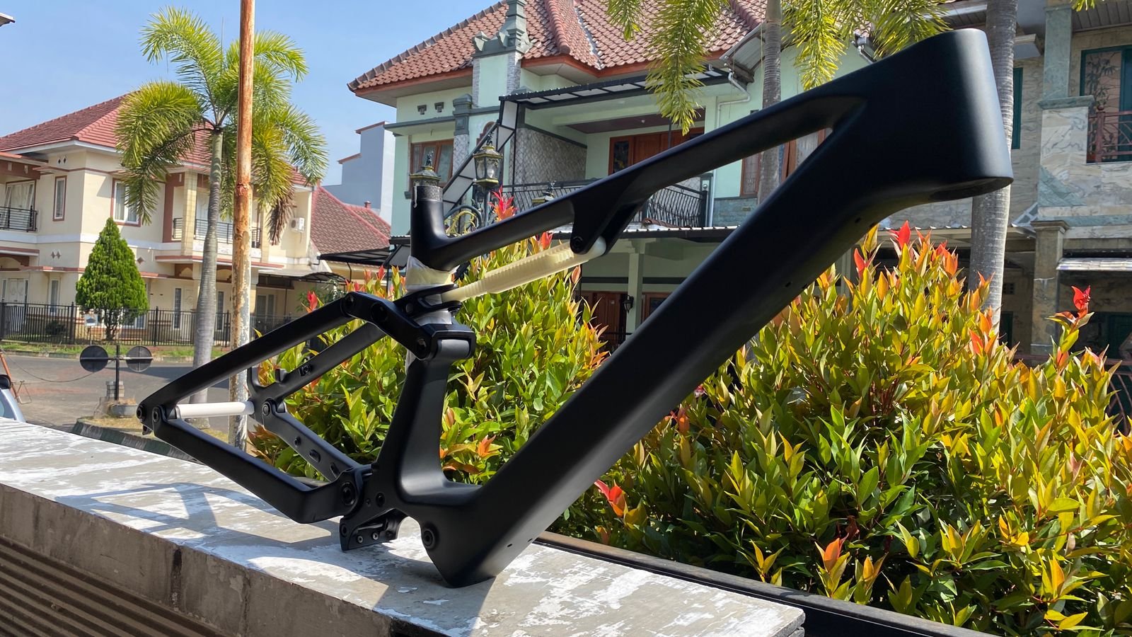

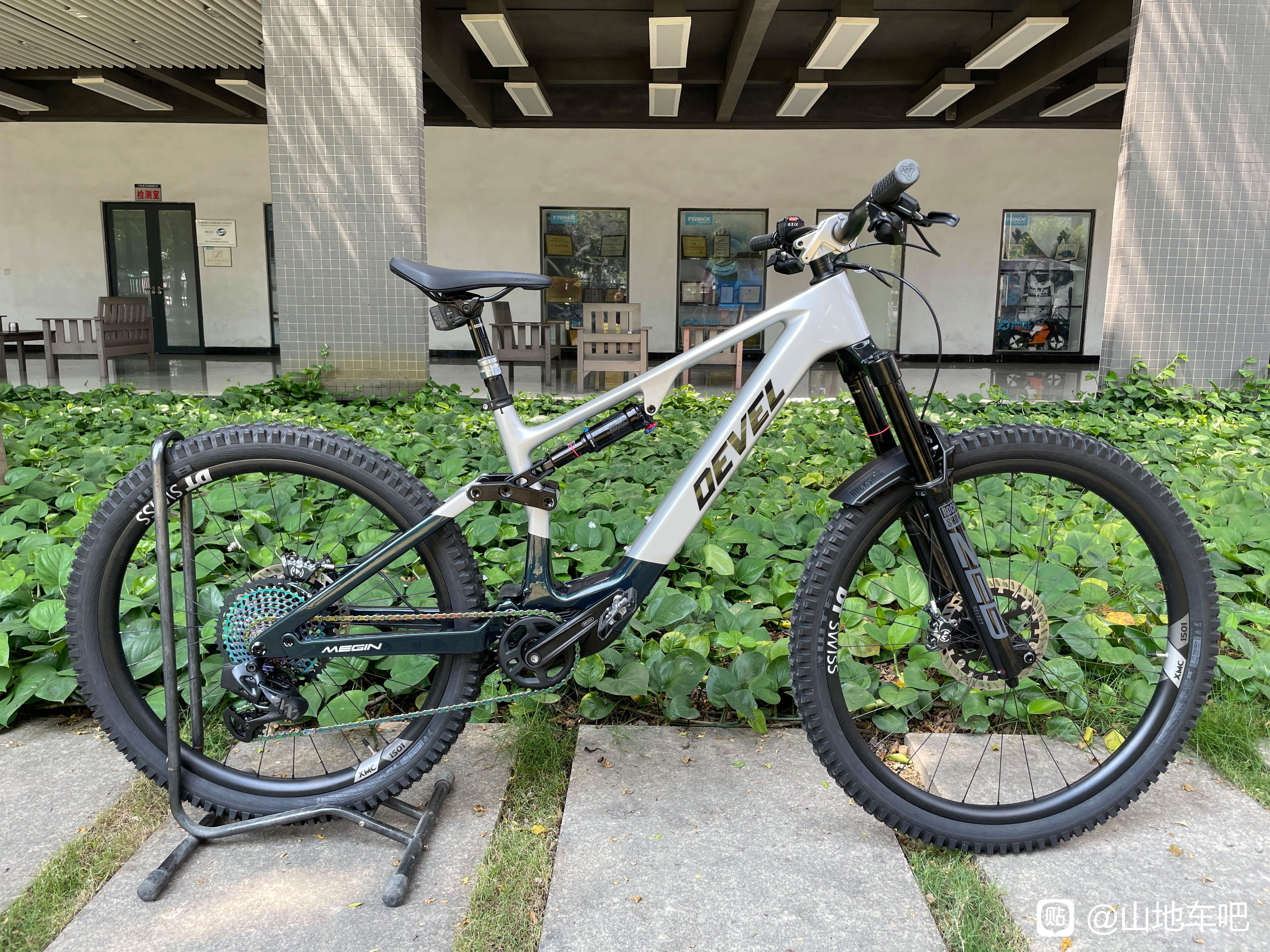

Just saw a post from Seraph bike company about a new M820 frame. Can't really see the travel numbers, but looks like a long travel enduro frame. Good to see a growing supply of different frames. Still waiting for a shorter travel option.

They made another m820 frame that they sold the exclusive rights to pretty quickly. The geo numbers look good to me on this one, could be a solid option for an all mountain lightweight E-bike. It doesn't look like it has a UDH though.

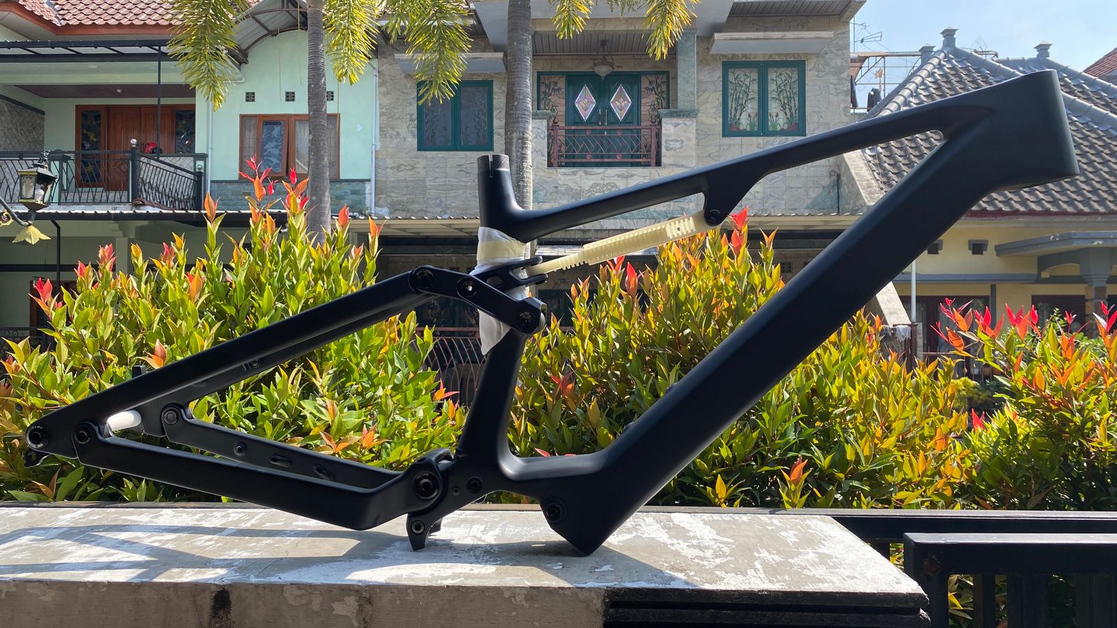

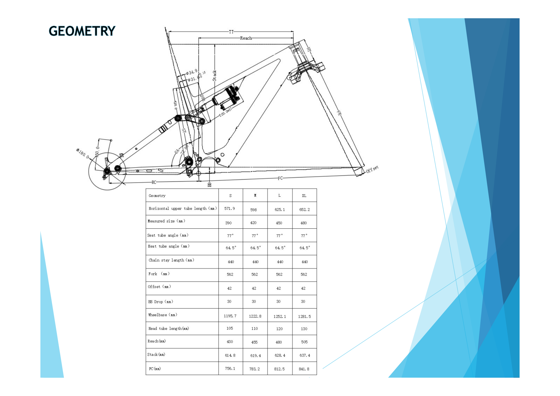

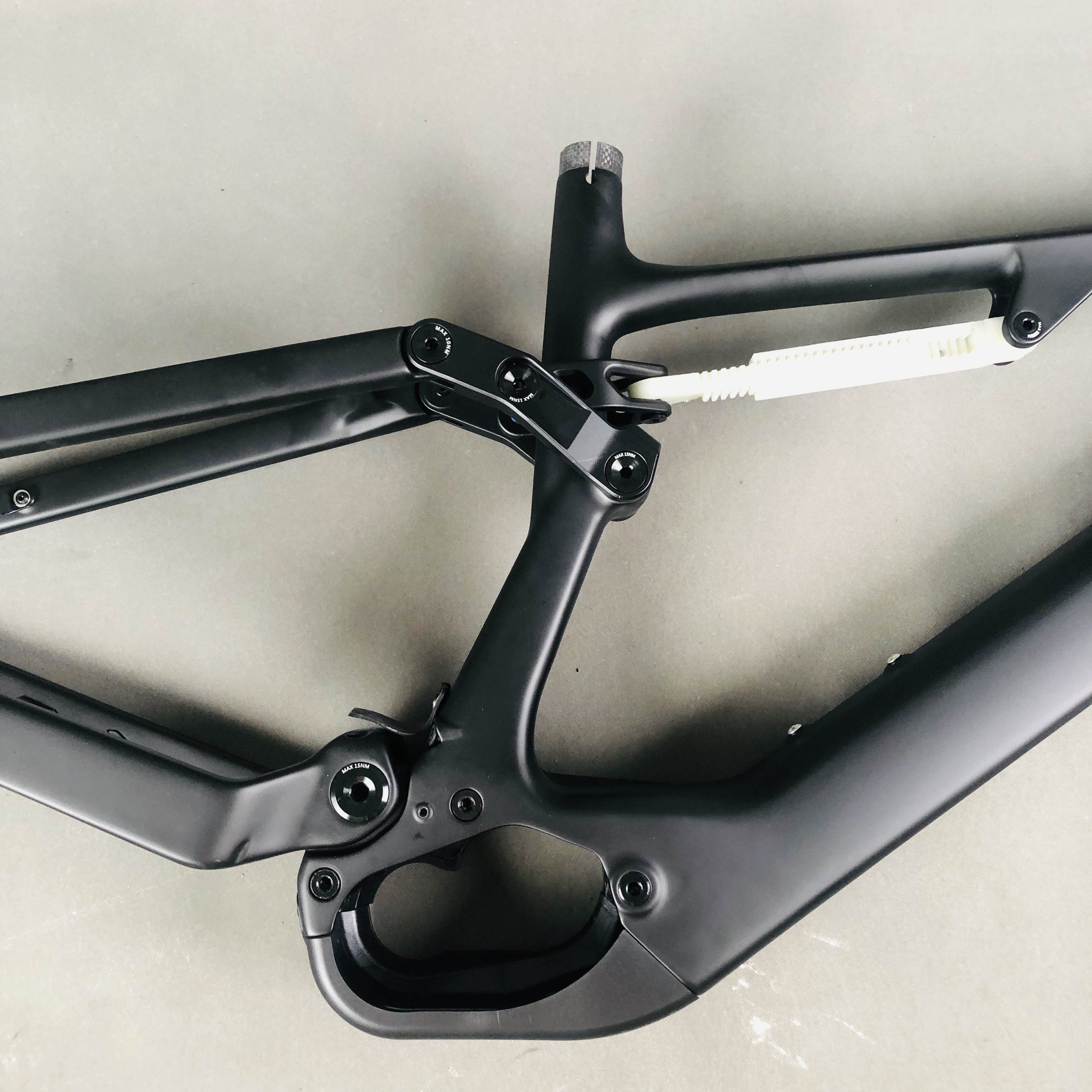

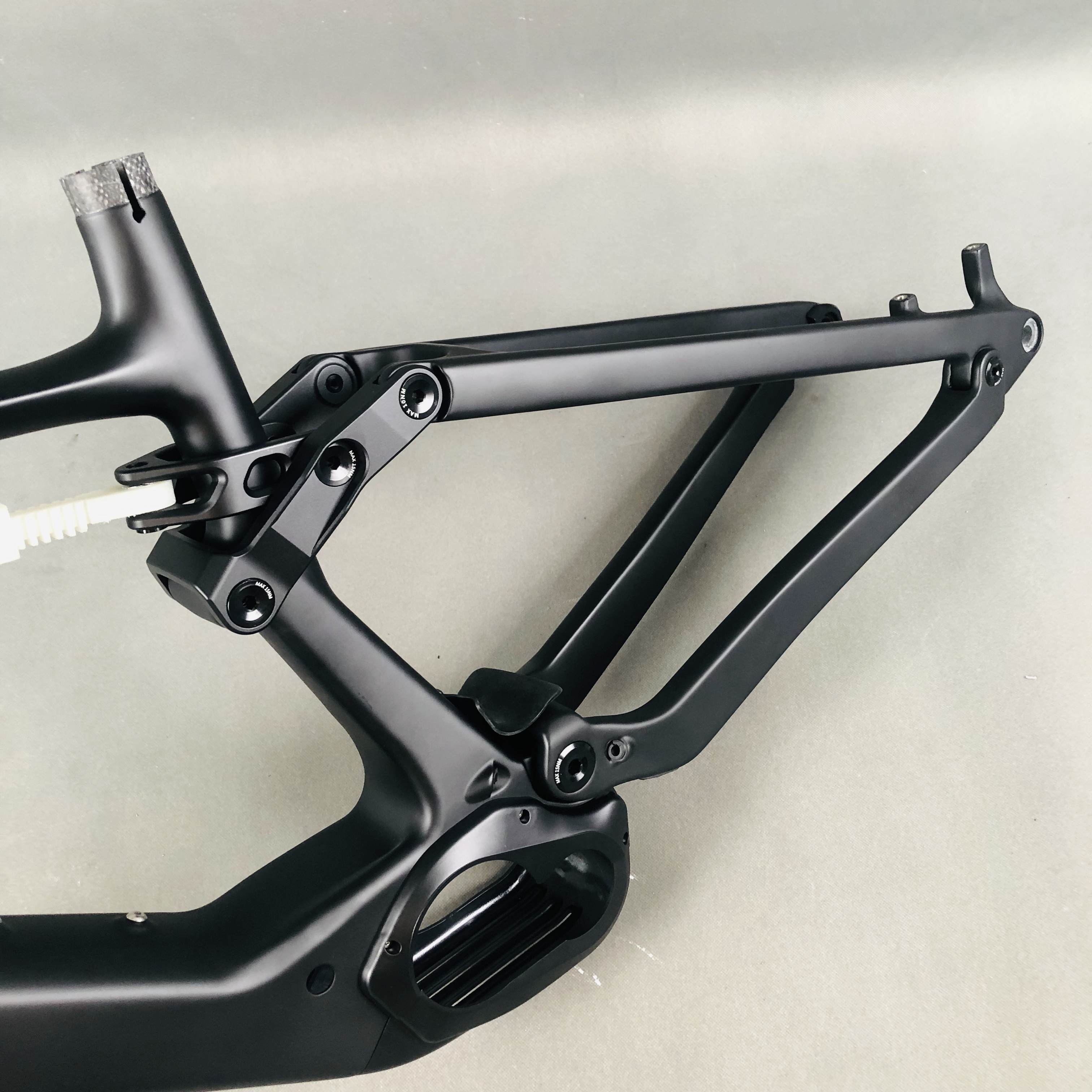

What is interesting, is that front triangle of this frame has EXACTLY the same dimensions/angles as an LCE930 from ligthcarbon. They must have co-develope it together.
Another interesting thing is, that chainsty length is listed as 440mm, whitch is 17mm shorter than LCE930, but overall wheelbase is only 10mm shorter. THere must be some error (here or on LC site), considering front triangle has the same dimensions.
Just for the lulz, I overlayed two geometries together, and as you can see, the front triangles are exact match:
The motor mounting holes, chargint port, chainstay mounting point, rocker mounting point, seat tube and head tube are in the exact same location. Chainstays and seatstays are a bit different. And ofcourse, shock is driven via the yoke, instead of the rocker arm.
Or they measured with different fork lengths / offsets or something.

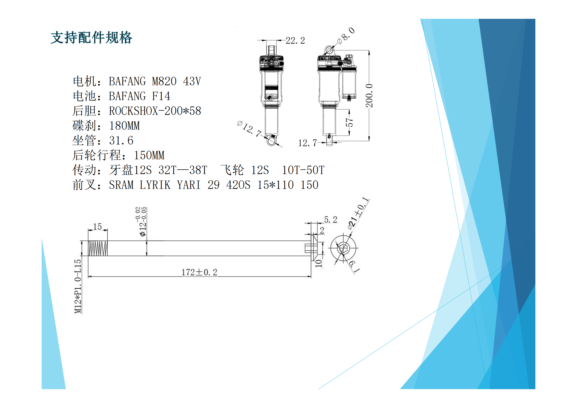

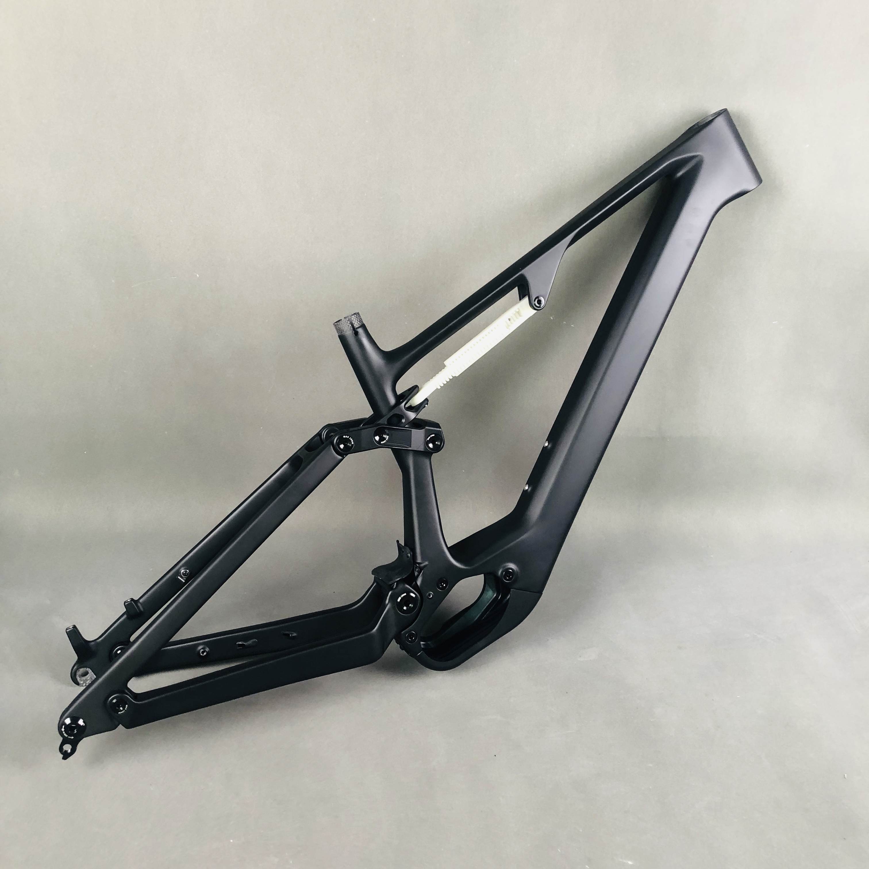

Interesting frame! Basically same as LCE930, 150mm travel is pretty good for do-it-all bike, especially ebike. 563mm A2C seems to suggest 160mm fork. But that shock size!! Why would they ruin it with an old standard??

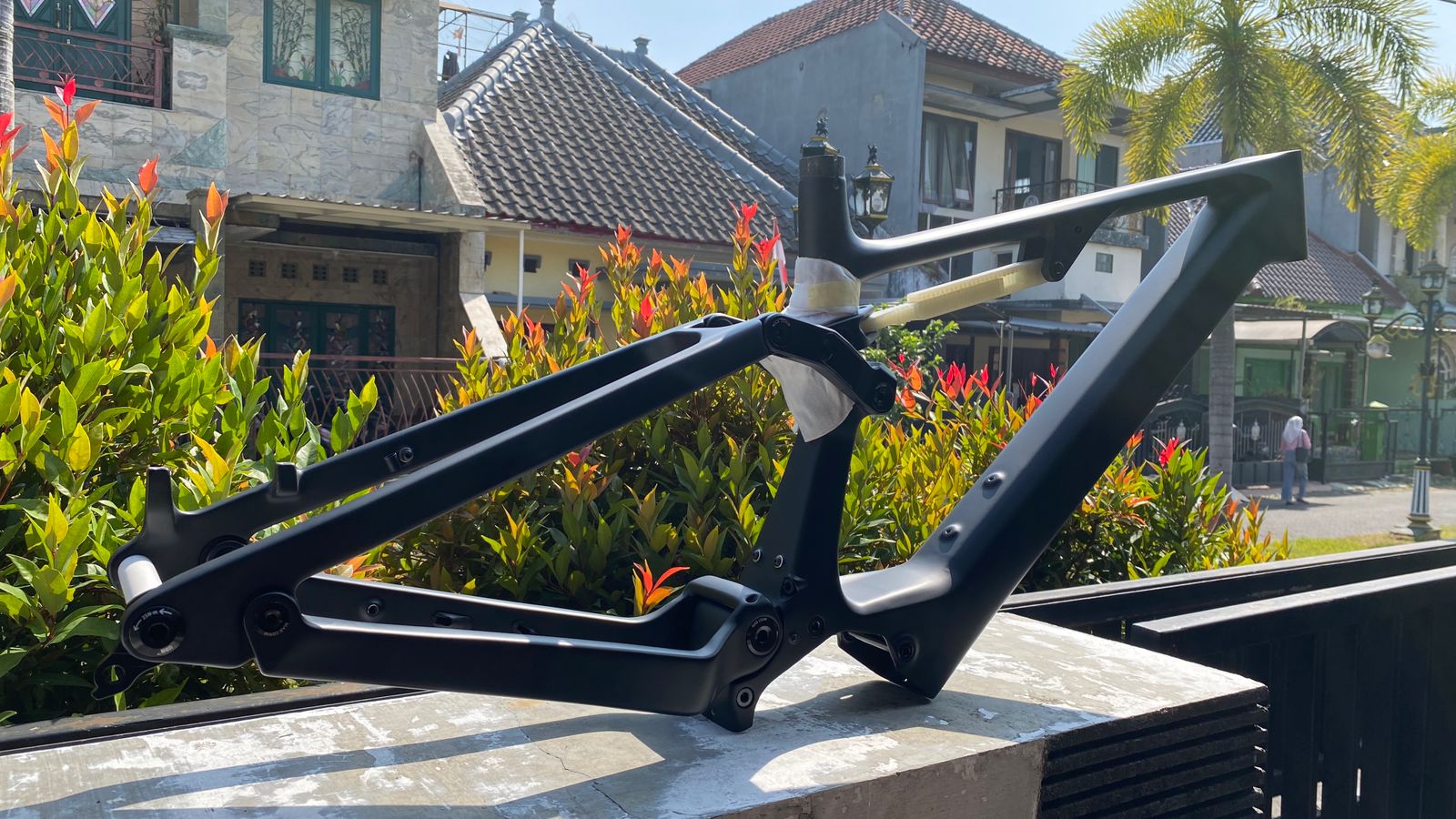

wow, looks really good!
@Lehr, do you maybe know what headset is used here? It looks better than the one with LCE930, but should be cross compatible.
