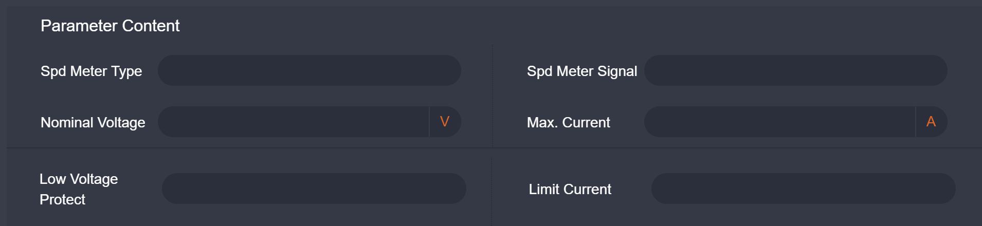

Intuitively, I'd say that the nominal voltage and max current are hard-coded in the controller.
So if you take a 43V - 13A firmware -> 560 W
If you power it at 36V, the max current is alway 13A...
So your Pmax will be 36 x 13 = 468 W.
-> You lose 100W of nominal power on your motor... What do you think of this resonance? Wrong?
Well, this is why the 36V firmwares have higher current than 43 and 48V. So the max power remains the same.

360w is 360 w. As noted with 43 it is 8.37 amps and with 36v it is 10amps. So the 43v could have smaller wires that would be lighter, slightly. That would be the advantage of the higher voltages but does Bafang actually change the gauge of the wires in the motors or batteries? For lowest cost I would guess no. But the max current is different for the two motors in question.
Once again... You don't take into account the maximum current programmed in your controller. But I have my answer thanks @Freda

You can't program in max current. You can only limit it by clamping it. These are controlled by a pulse train to the speed controller. The motor is going to pull what it pulls at a certain assist setting based on the resistance of the windings. The only thing the controller is programmed to do is limit the assist level after the voltage drops to a trigger level.
