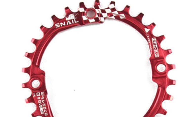

I have not tried with this spider, but on normal 104bcd crankset a 30T chainring is minimum. It has threads in the chainring instead of using bolt with counterpart, to get it to fit.
return from somebody who have tried needed.
I find that chain is very close to the speeder, i doubt that it fit with 2 teeth less. but may be with few adaptation ?. the other problem is chain position in regards of swing arms, with the E10 i needed to install protection to avoid that chain eat the swing arm. Most space available on the CEF50

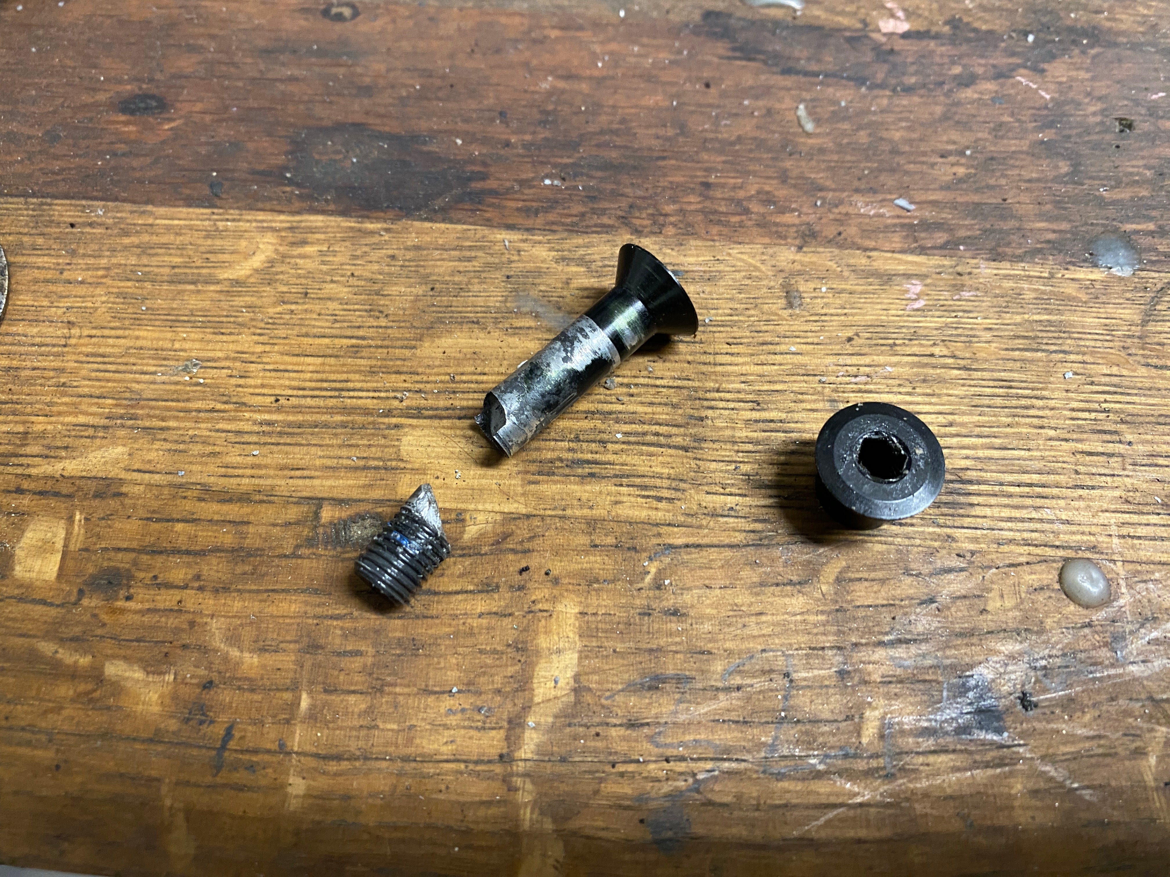

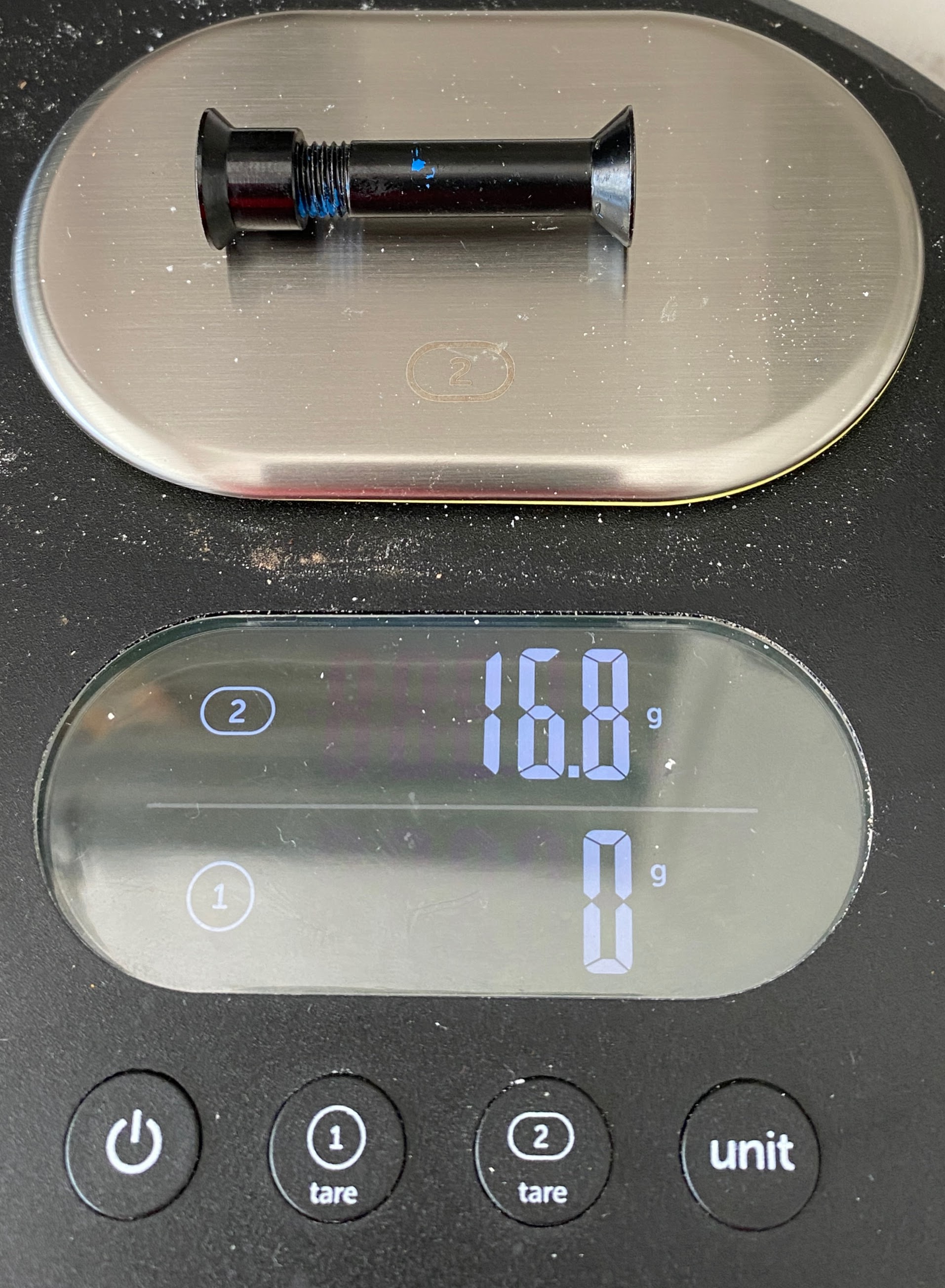

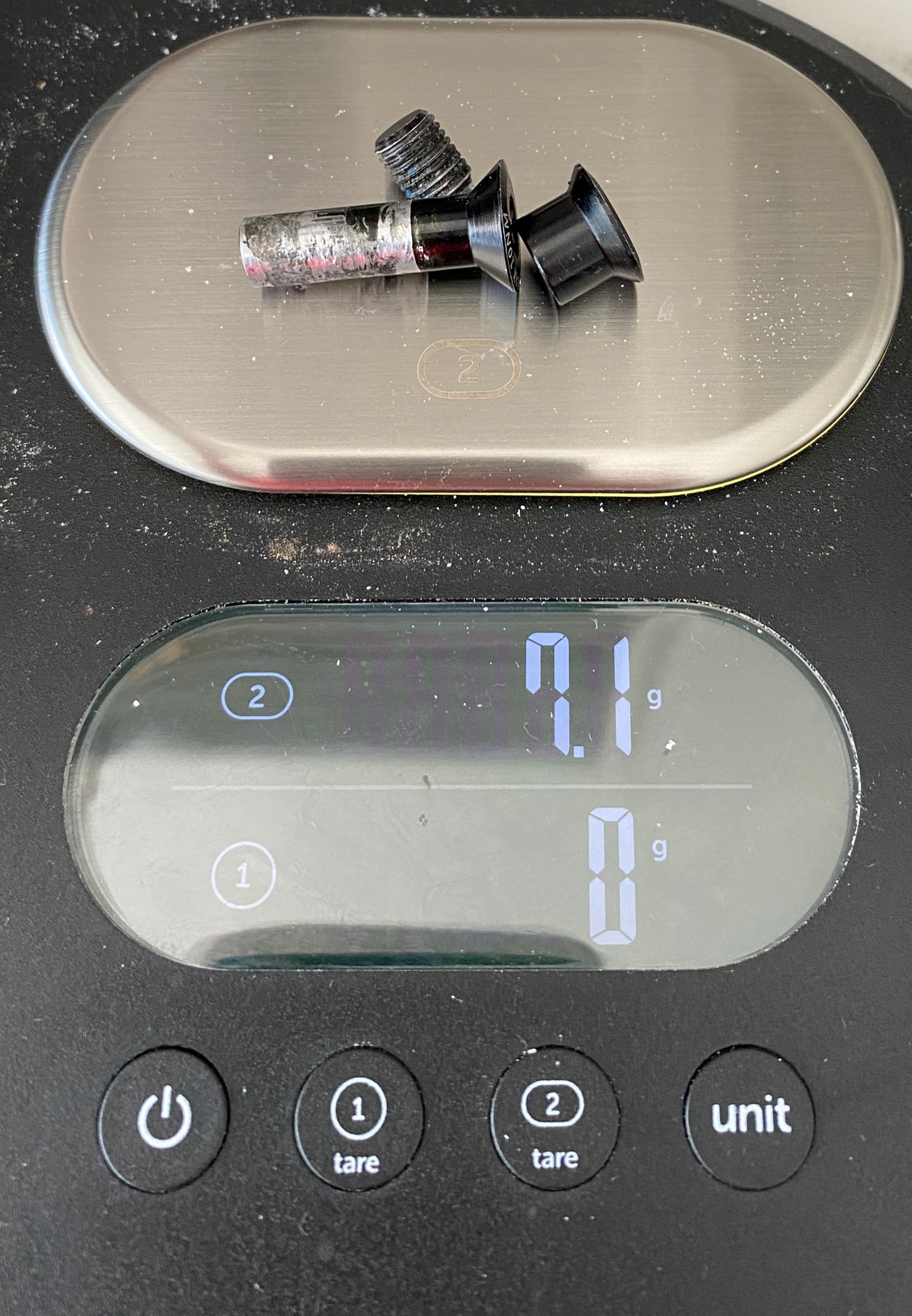

So I had an issue with the lower shock bolt. After a ride I noticed something was loose and when I tried to tighten it, it came off just by touching it. It had snapped off where the threads start.
I contacted Lightcarbon, who were helpful enough and sent me two new bolts only for shipping costs. They say it has been redesigned. I don't know how, it looks the same, but weight is higher. It feels therefore more solid. Lets hope it lasts.
Thanks for sharing! You are lucky that it didn't fall out during the ride, that could be scary. I wonder when they redesigned it, when did you order your frame? I am going to remove and weigh mine.
Freda
Feb 5, 2023
168
146
Vaasa
Yes I was thinking the same. I don't know how it didn't fall out, because it was not attached to anything, also I didn't notice when it broke.
I ordered in September.
D
I had a similar problem with the CEF50, I got some TI bolts from AliExpress and they've been awesome.

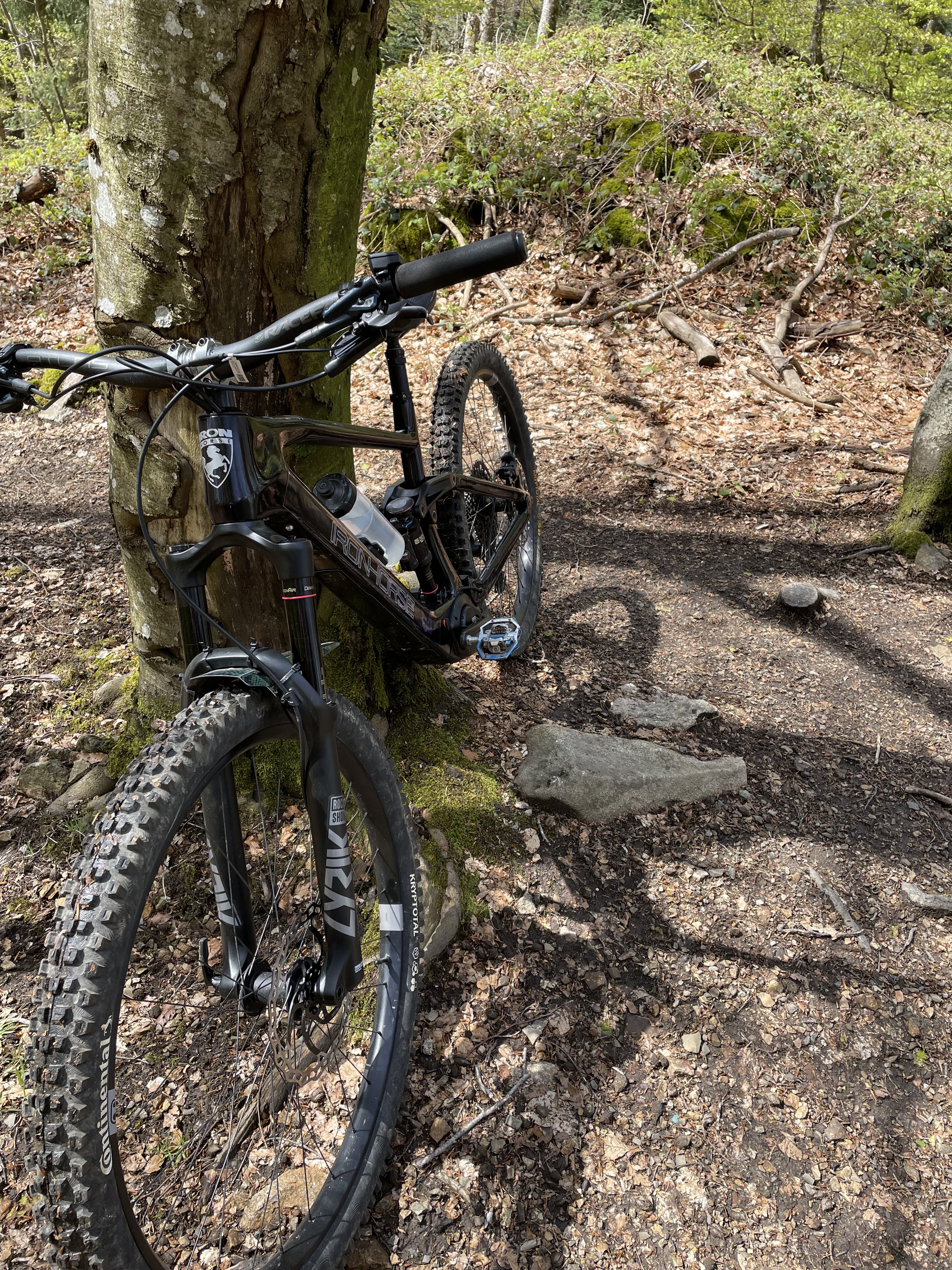

hello
I have finish my built. 150 front and 150 rear with mullet wheel.
this is 2 youtube videos to setup my suspension.
next step is to change 34T to 32T chainring, 170mm crank to 160mm and 245HMI to use use GO+ to custom the bike.
I use my Besst Tool to decrease 10% of each path before to assembly the bike and my first ride. I don't would like to disassemble my fork, stem...etc to use my Besst tool another time 😁. I think the original setup is better

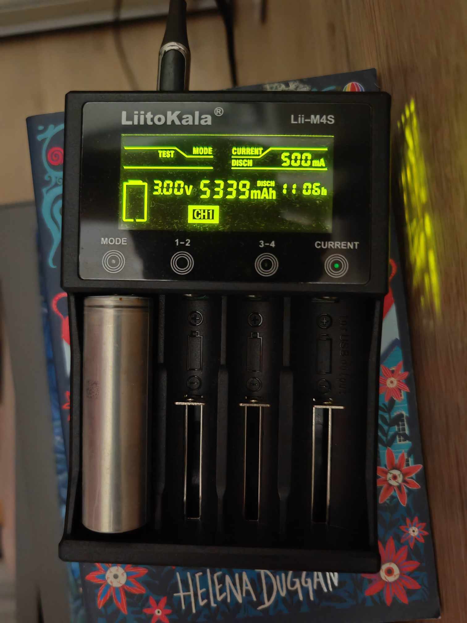

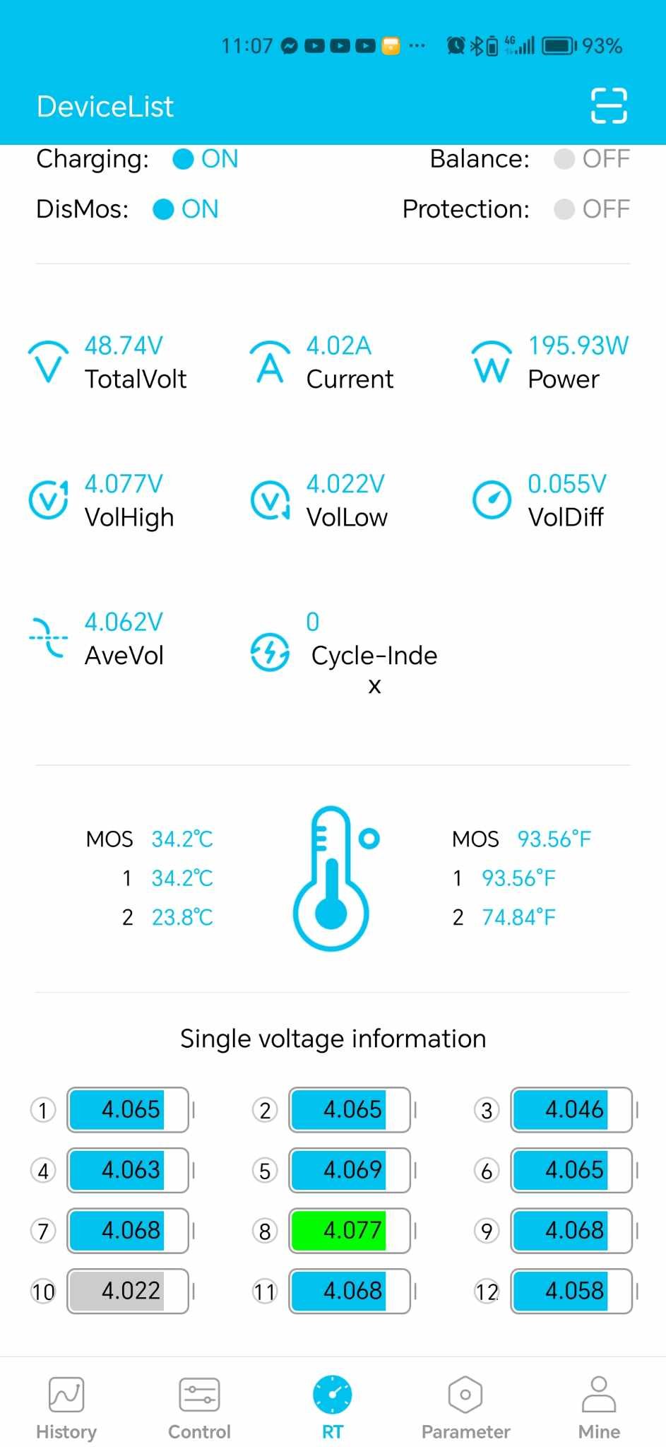

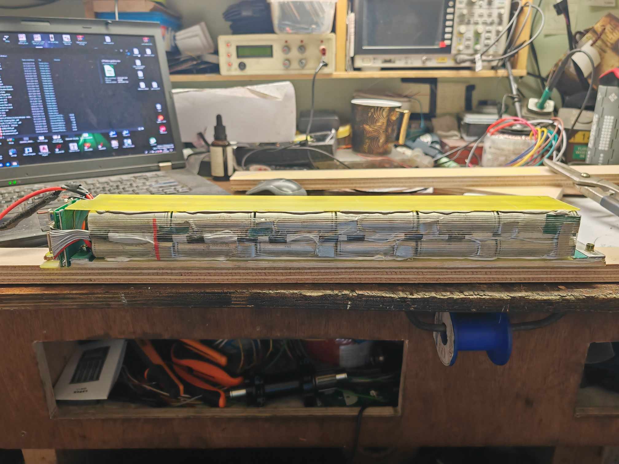

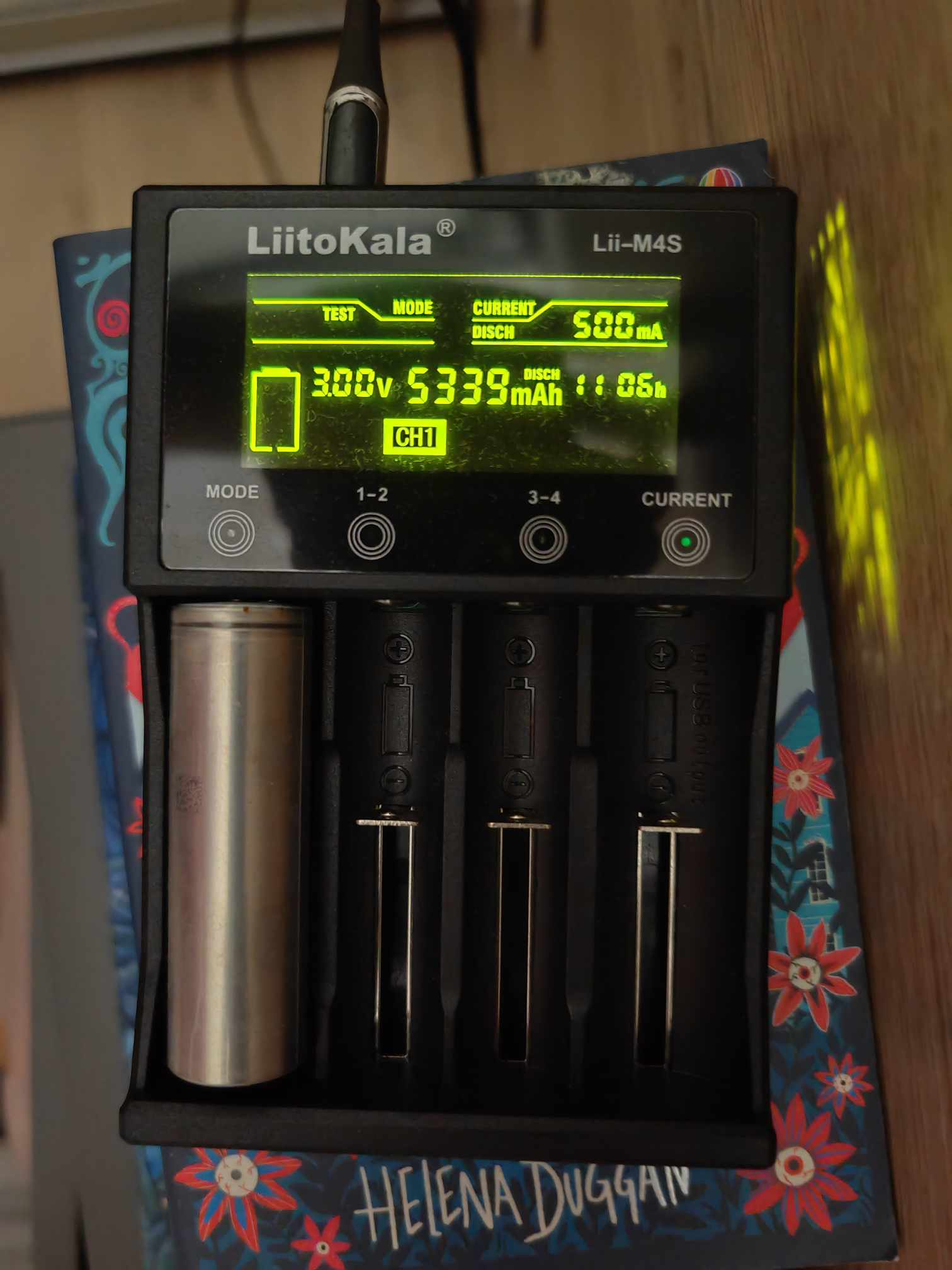

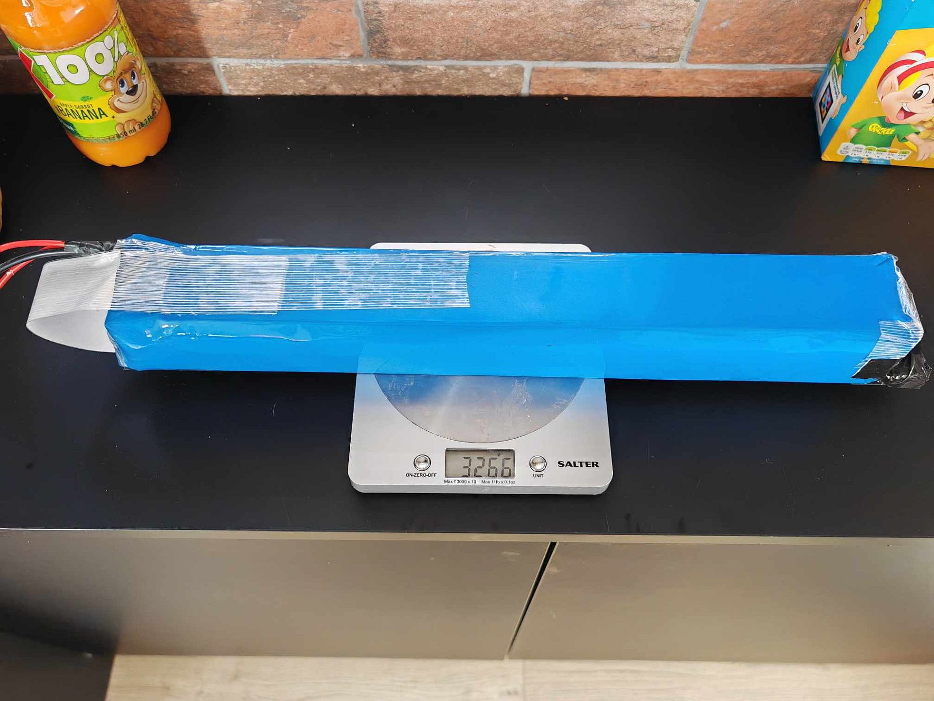

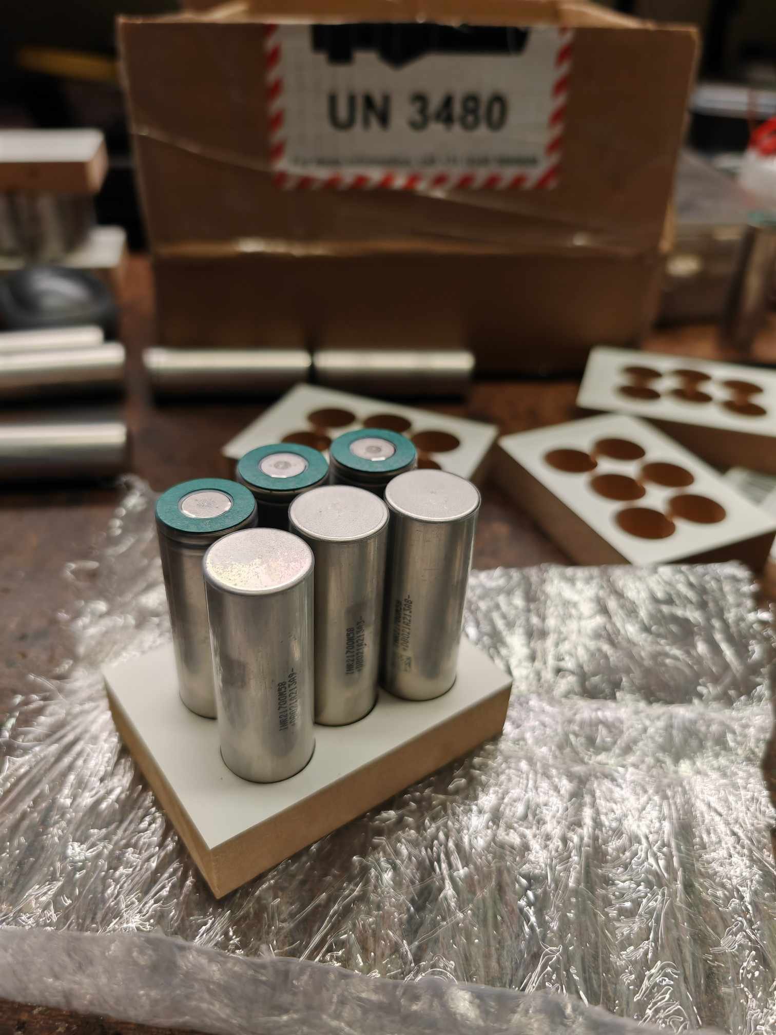

Finally. Big battery went into the frame. 12S3P done with LG M58 cells (same as new gen2 Orbea Rise).
External battery size is 65mm x 55mm.
I have measured cells with 500mA discharge from 4,2 to 3,0V, all about 5,33Ah. Discharged fully to 2,5V with 500mA showing 5,81Ah, IMHO pretty good.
Marketing bullshit capacity - 43V*3*5,8Ah = 748Wh
Real life capacity at discharge to 3,0V (@1,5A=ECO mode) - 43V*3*5,3Ah = 680Wh
Bike weight went up a bit but not so bad, with pedals and fenders bike weights bellow 20kG.
And this is the correct approach to the battery capacity! and to be honest, at the moment I am planning exactly the same 12s3p configuration using exactly these LG cells.
I'm waiting for the frame and I have no way to check, please tell me:
1. the battery cells must be slightly offset from each other to fit into the frame? is the maximum external size of the battery max 65x55mm? (can You send the finished design/drawing of cell arrangement?)
2. Did You weld with 0.2 mm pure nickel plates? or others?
3. How did You attach the package to the frame?
4. Which BMS company did You use? - I'm considering BeMuchSafer or JBD and I think I'd like something with Bluetooth.
If You can, please send more photos (or all) of your battery pack implementation.
borysgo2
Feb 1, 2023
122
201
Ireland

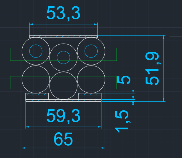

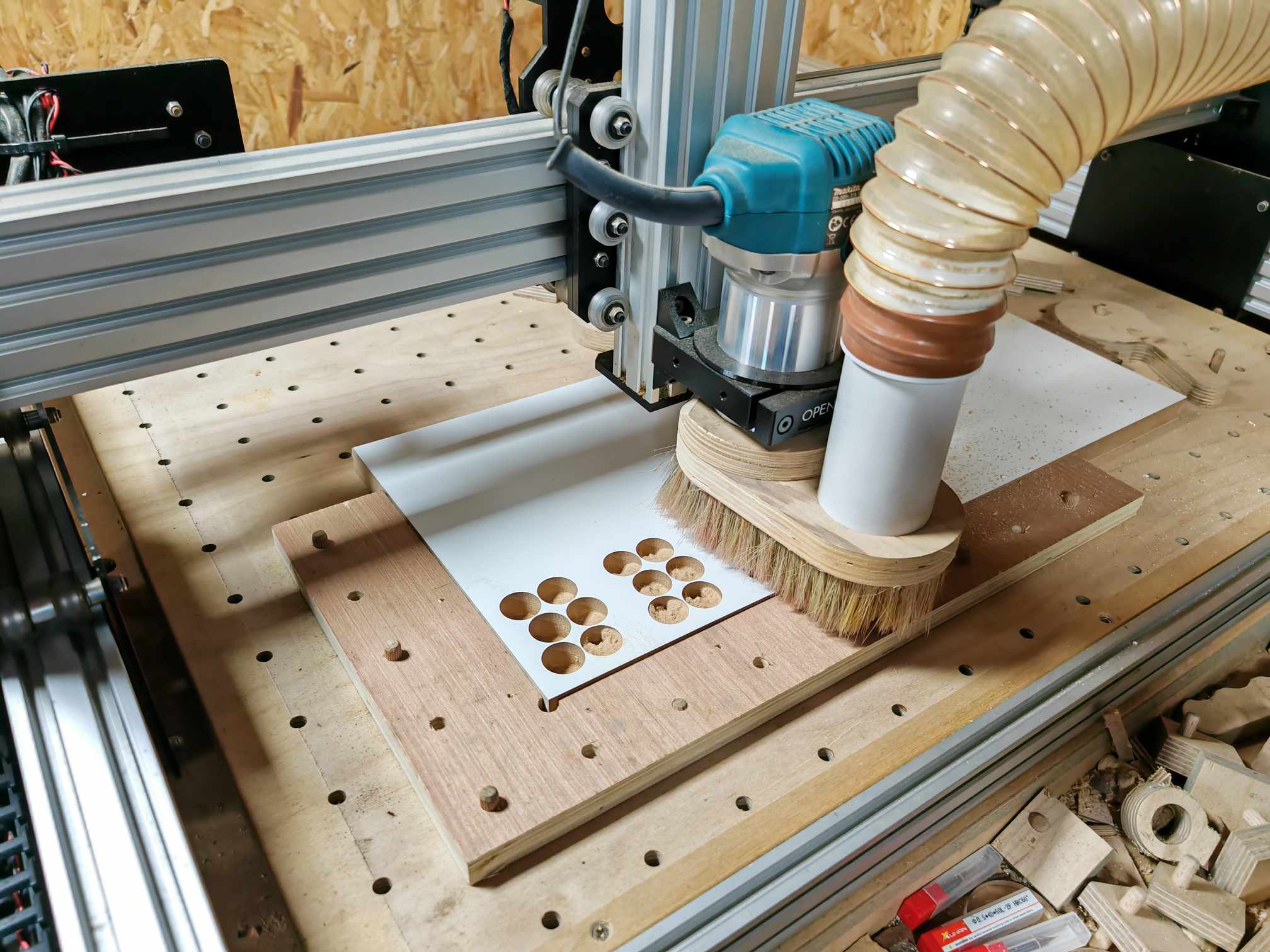

1.
2. I have soldered 0,2 nikel strips at the + side (easy to solder), the negative side is spot welded.
3. Look carefully at the end of the base of the battery, there is aluminium plate with threaded M5 rivet. Base of the battery (also the top) is made with 1,5mm laminate (no copper). In the bottom section there is 4mm plywood strip sandwich'ed in between two layers of laminate. That kind of composite forms light and very stiff platform for the rest of the battery.
Gap in between the cells is 0,5mm. All cells glued on the CNC'ed template with strong fast bonding adhesive.
4. BMS
BMS is JBD, very nice with a lot of features, load detections, safety options, auto balancing cells when charging or static approach, all setted up in the app. BT connectivity is a bit finicky, but IMHO BMS is very nice.
Only extra thing I have done is, I placed ideal diode in series with + charging cable, so when the bike is not charged there is no risk of shorting the pins at the charging port.
